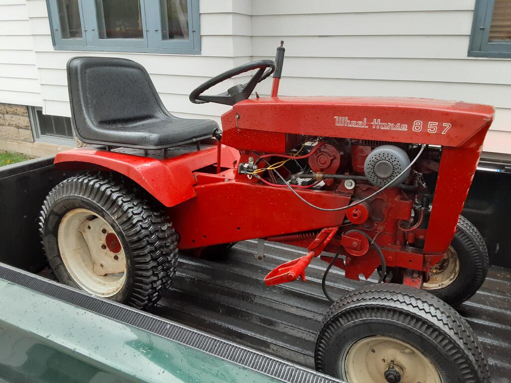

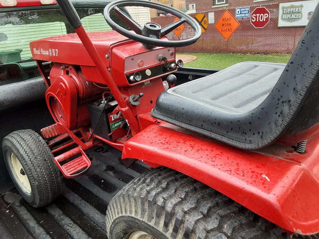

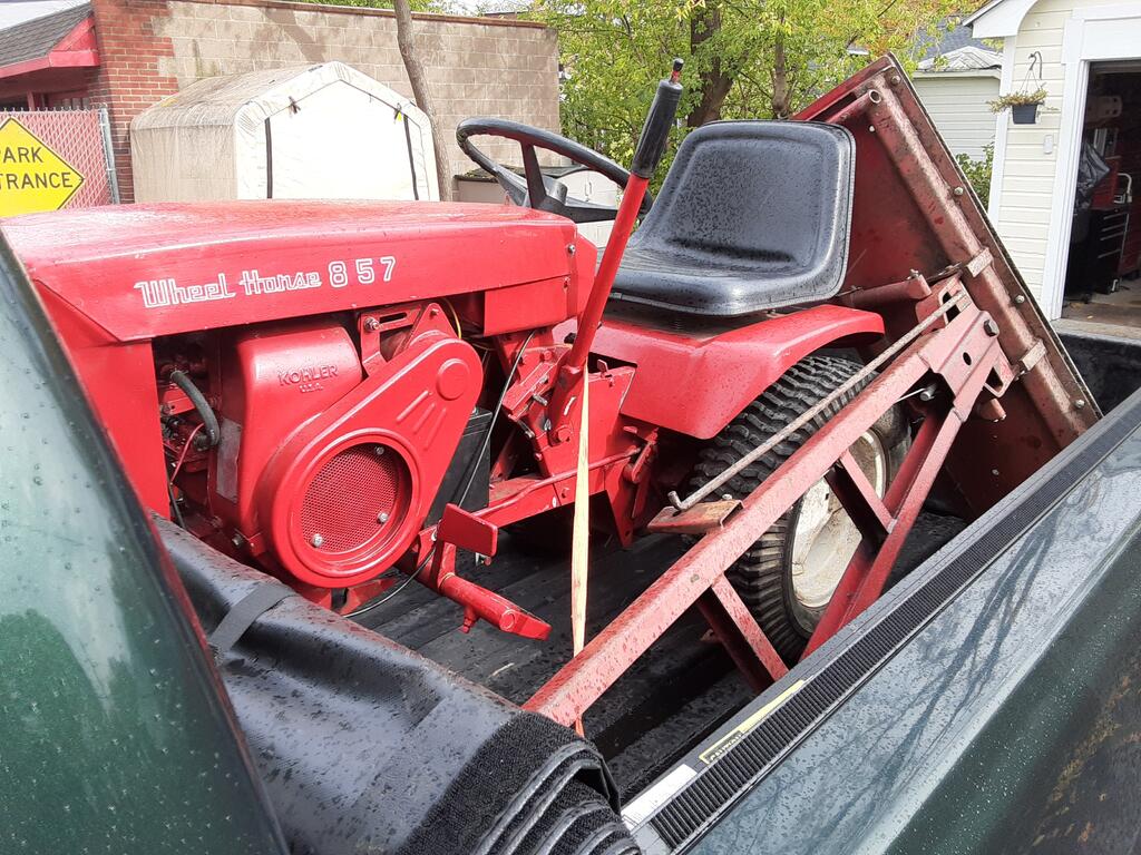

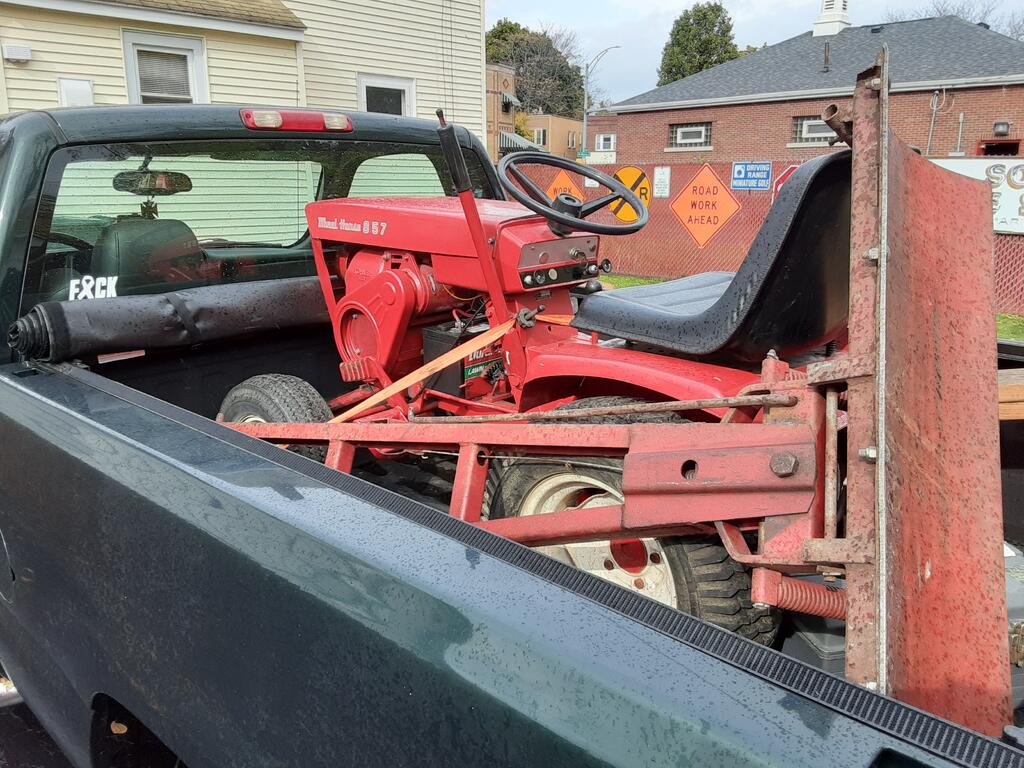

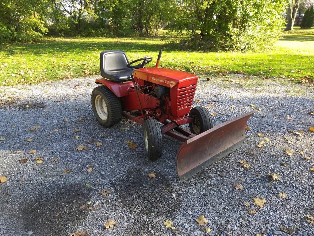

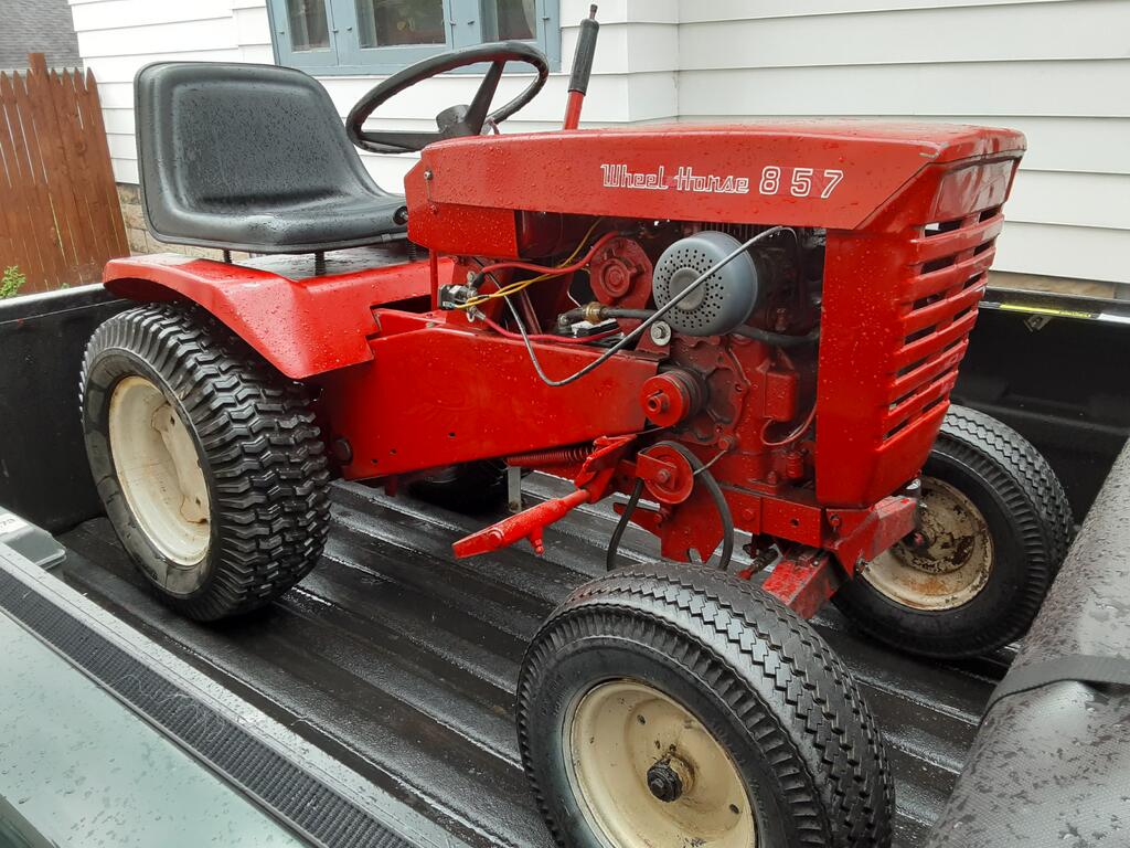

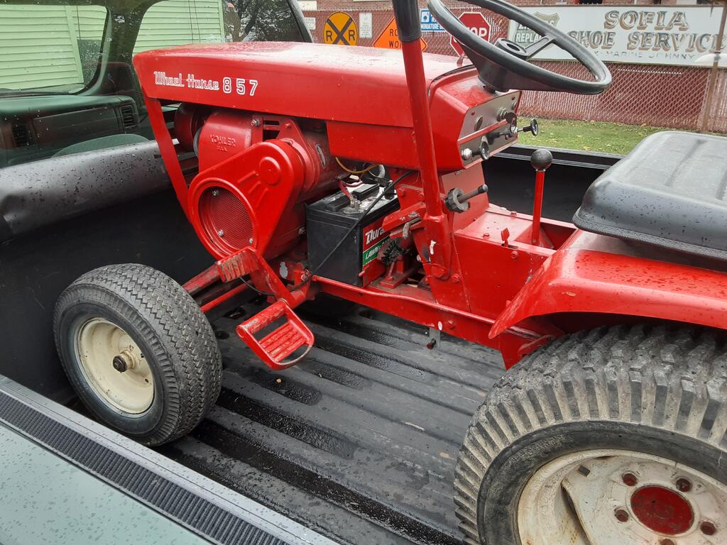

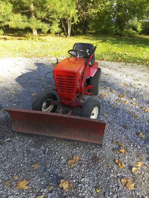

D_Mac 9,339 #1 Posted November 1, 2020 Just went to pick this up. Seems fairly decent. I know the seat and steering wheel have been changed. I dont like where the solenoid was mounted. I dont like how the throttle cable is a foot longer then it needs to be and hangs out the side. Both the throttle and choke cables are hard to pull/push in or out. Seems to have wrong fuel line on it as it leaks by the carb. Did not come with a deck but has a plow in pretty decent shape. Also has chains for the tires that are under the seat. I am assuming they fit on the tires, we will see. Someone painted it. Wasnt done recently. Plus side is that it starts right up and runs good. Steering seems tight. Whats here is in good shape. Dont know to much about this model. Seems to be a little small for me. Not sure if they are any good pushing snow. I gave 250 for it. Figured it was worth that. Let me know what you think ! Look forward to your replys. 4 5 Share this post Link to post Share on other sites
Sparky-(Admin) 26,898 #2 Posted November 1, 2020 Nice! The short-frame/ square hoods are my favorites. Doesn’t look neglected so it should clean up real easy . I’m 6’1”....I fit this size machine. I do like installing my seat on a pair of “U” shaped seat springs. Maybe that extra height is why I’m comfy. 1 Share this post Link to post Share on other sites
D_Mac 9,339 #3 Posted November 1, 2020 (edited) 5 minutes ago, Sparky said: Nice! The short-frame/ square hoods are my favorites. Doesn’t look neglected so it should clean up real easy Thank you, but I am 6'5 so I am not so sure I like the short frame. I do like the tractor though. Question, where is the solenoid supposed to be mounted ? Same spot but on the inside? Edited November 1, 2020 by D_Mac Share this post Link to post Share on other sites

squonk 48,429 #8 Posted November 1, 2020 857’s didn’t come factory with a solenoid. Mount it where ever you want. 4 1 Share this post Link to post Share on other sites
rjg854 13,454 #9 Posted November 1, 2020 That's a great little tractor to plow with. Same as my Commando 8. Especially for you and that tight driveway you've got. It's nice and nimble, with a small turning radius. Looks to be in nice shape, I think you got a good deal on that tractor with a plow. 1 1 Share this post Link to post Share on other sites

Achto 32,964 #11 Posted November 1, 2020 @D_Mac That's a sweet little tractor!! Your dislike issues are easy to fix. The throttle & choke cable can both be shortened easily. The solenoid can be moved to the inside of the dash tower or you can pop for a 60amp key switch and get rid of the solenoid. The short frames are great for maneuverability, 4" shorter may not seem like much but it does make a difference. As far as pushing snow, I think that you will be surprised. They are very capable. The price you paid was very good 1 Share this post Link to post Share on other sites

D_Mac 9,339 #15 Posted November 2, 2020 5 hours ago, squonk said: 857’s didn’t come factory with a solenoid. Mount it where ever you want. You know I am no mechanic. I know even less about electrical things. What would have been in place of the solenoid or why was one added if it never had one? Not sure what my plans are for it. Since it has already been painted some time ago I dont feel I am the guy to do a full restoration. Most likely I will just repaint the wheels. Maybe @Vinylguy can sell me just the decal that goes on the grill. I hear we are supposed to get some 60 degree weather later this week. Maybe then I can spray the plow frame and blade with a new coat of paint. I dont think I will use it to try and do my driveway with it. We get a lot of snow around here and it seems using that would take me 10 times longer then using my snow blower. I will fix the cables, adjust the parking brake/brakes,change the oil, put the chains on the tires and give it a good washing. I wont get into it like I did on the 416-8 or the C-161. Because I dont have a deck for it I dont feel the value is there like those other two. I am having a hard time trying to sell that Simplicity I have because that one dosnt have a deck either. Maybe once we get our first few inches of snow it will sell. Anyways as usual my garage is full so I had to drop it off at my buddies house until I make some room...... ughhh I need a bigger garage !! 1 Share this post Link to post Share on other sites
Achto 32,964 #16 Posted November 2, 2020 1 hour ago, D_Mac said: You know I am no mechanic. I know even less about electrical things. What would have been in place of the solenoid or why was one added if it never had one? At some point a PO replaced the Cole Hersee key switch in your tractor with a cheaper Indak key switch. The original Cole Hersee switch had a 60 amp starting circuit which was heavy enough that it did not require a starter starter solenoid. The Indak switch would not have a heavy starting circuit and would require a starter solenoid to carry the amperage during the crank cycle. 2 1 Share this post Link to post Share on other sites
Vurge 158 #17 Posted November 2, 2020 Disclaimer: I'm completely new to these machines and just got introduced to starter generators (S/G). I've spend many hours trying to learn how to wire one. From what I've read, if the tractor doesn't have a high amp keyswitch, that solenoid should be a continuous duty model (in order for the S/G to send power back to the battery while the engine is running). The one in the picture looks like a standard starter solenoid. I'm still wiring up my own machine so if I'm off base someone please let me know. 😁 Share this post Link to post Share on other sites
squonk 48,429 #18 Posted November 2, 2020 2 hours ago, Vurge said: Disclaimer: I'm completely new to these machines and just got introduced to starter generators (S/G). I've spend many hours trying to learn how to wire one. From what I've read, if the tractor doesn't have a high amp keyswitch, that solenoid should be a continuous duty model (in order for the S/G to send power back to the battery while the engine is running). The one in the picture looks like a standard starter solenoid. I'm still wiring up my own machine so if I'm off base someone please let me know. 😁 Continuous Duty just means it's designed to be engaged for more than a couple of seconds at a time and has contacts to handle the load. (Think snow plow electric lift solenoids) 1 Share this post Link to post Share on other sites
squonk 48,429 #19 Posted November 2, 2020 (edited) I wouldn't worry about replacing /moving that 857 solenoid. You're gonna sell it anyway so why bother. If it works leave it alone. Edited November 2, 2020 by squonk 1 1 2 Share this post Link to post Share on other sites
Achto 32,964 #20 Posted November 2, 2020 (edited) 4 hours ago, Vurge said: From what I've read, if the tractor doesn't have a high amp keyswitch, that solenoid should be a continuous duty model (in order for the S/G to send power back to the battery while the engine is running). Power is only sent through the starter solenoid when the key is in the start position. Power to the battery from the generator is sent through the voltage regulator when the engine is running. Edited November 2, 2020 by Achto 2 Share this post Link to post Share on other sites

953 nut 70,661 #22 Posted November 2, 2020 17 hours ago, D_Mac said: Not sure if they are any good pushing snow. They will push snow just fine! 1 2 Share this post Link to post Share on other sites

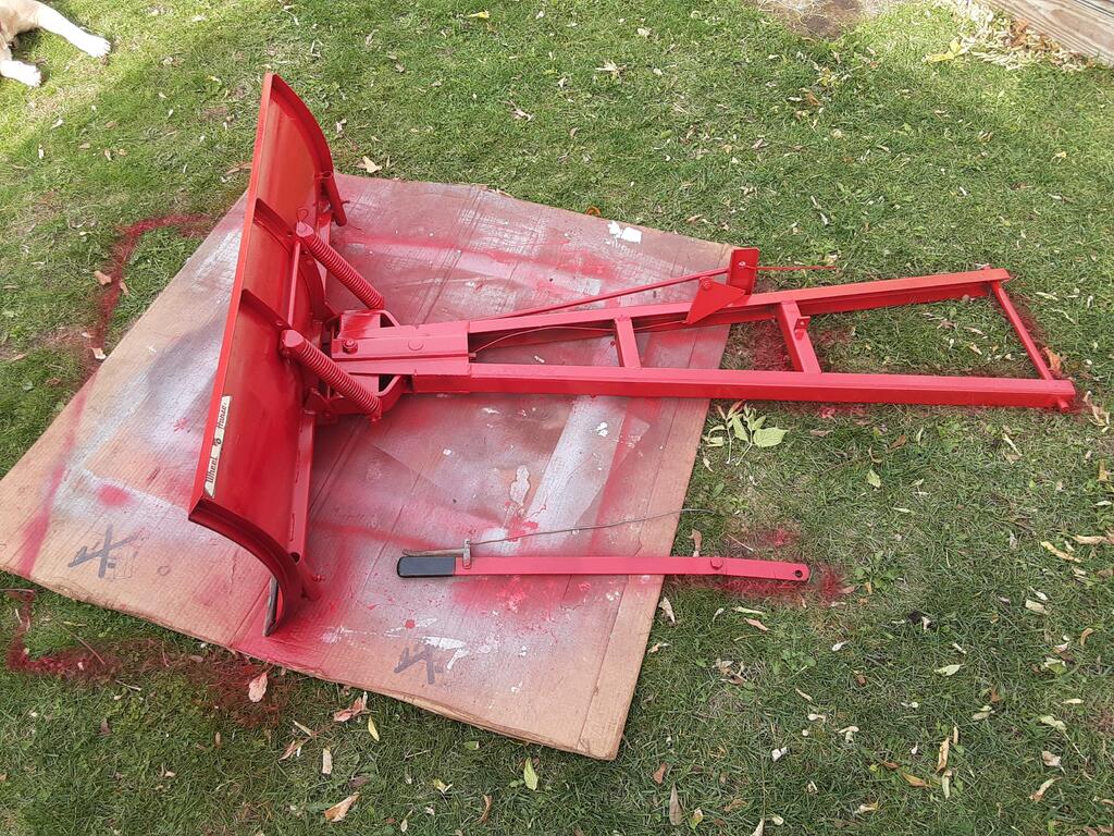

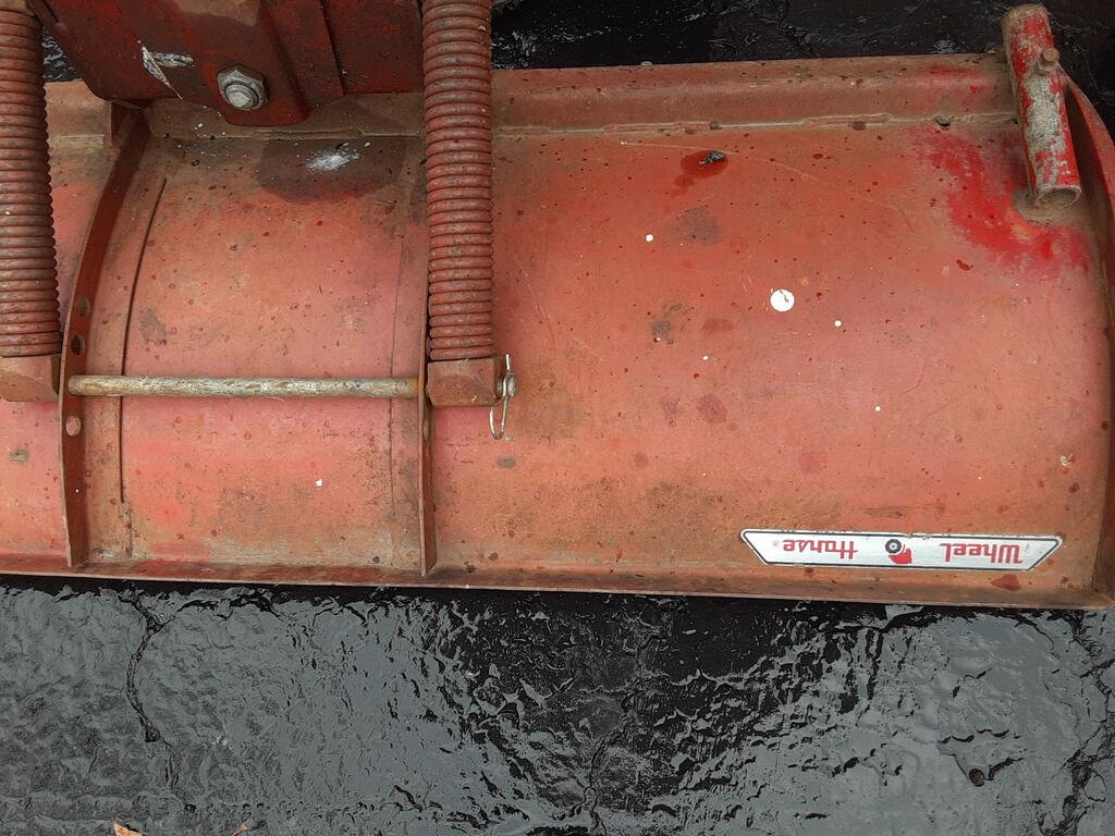

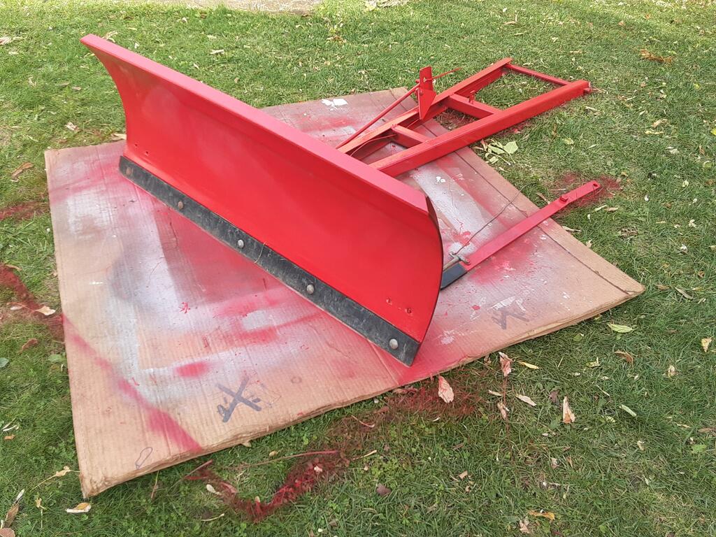

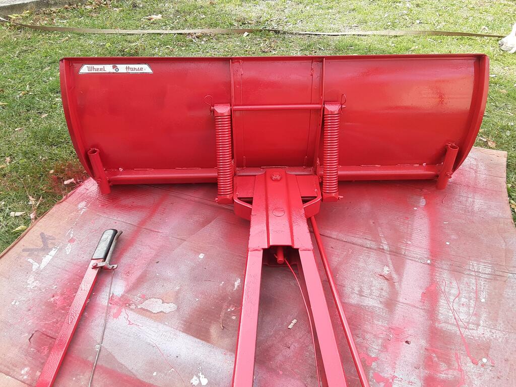

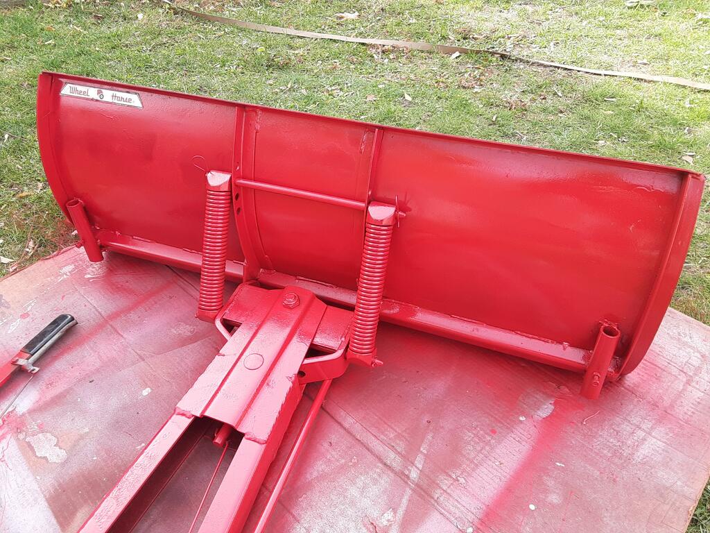

D_Mac 9,339 #25 Posted November 5, 2020 So I thought while the weather was good here in NY I would put some paint on the plow blade and frame. Never owned one before so I am not really sure what those round brackets are supposed to hold. They are on the backside of the blade on each side. Are they supposed to hold skid shoes .... markers ??? Maybe someone can help me out. 1 2 Share this post Link to post Share on other sites
