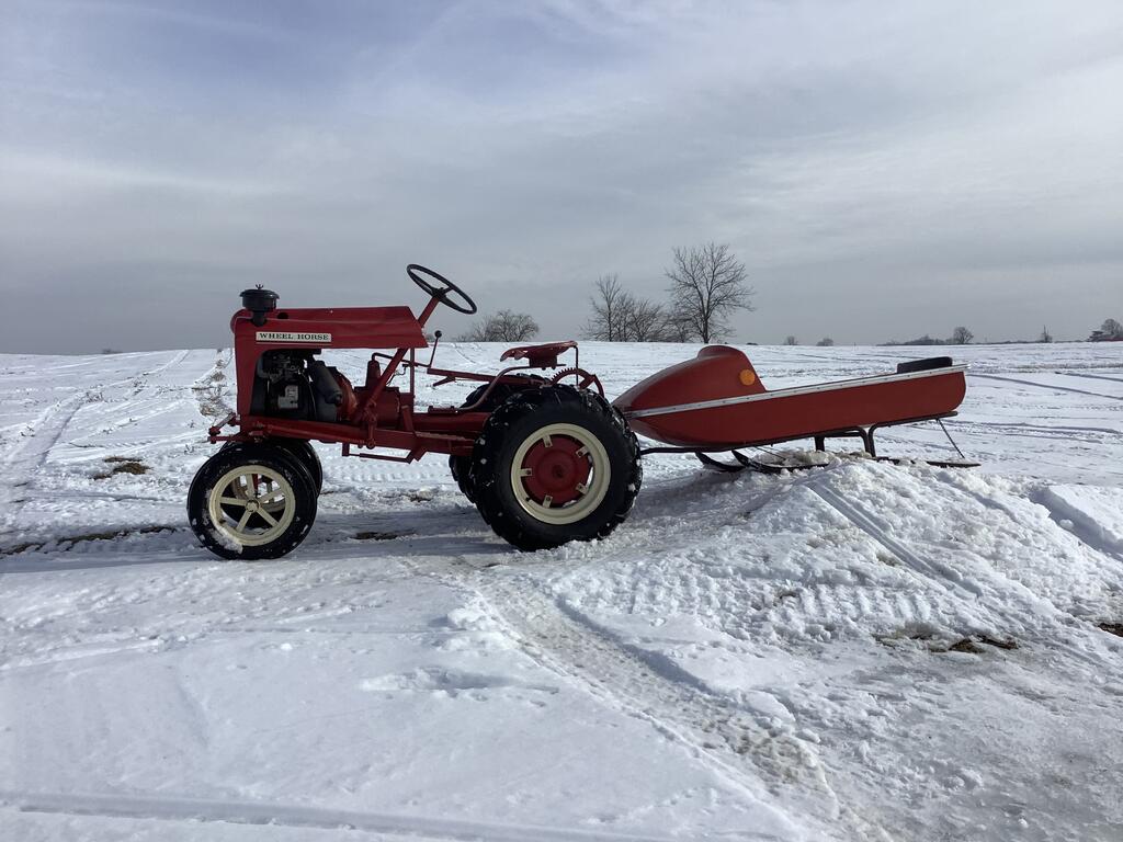

Pullstart 71,564 #109 Posted July 11, 2021 A HUGE thanks to Rob @oldiron613 for some carb advice this weekend... he tweaked “Jackie’s” carb and got the little hiccup out of it... then suggested a 1/4 turn more fuel on the Senior. Now, they are both one pull cold/no choke runners! 4 4 Share this post Link to post Share on other sites

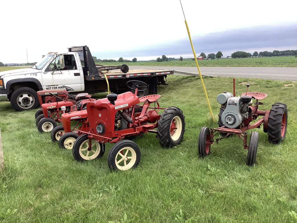

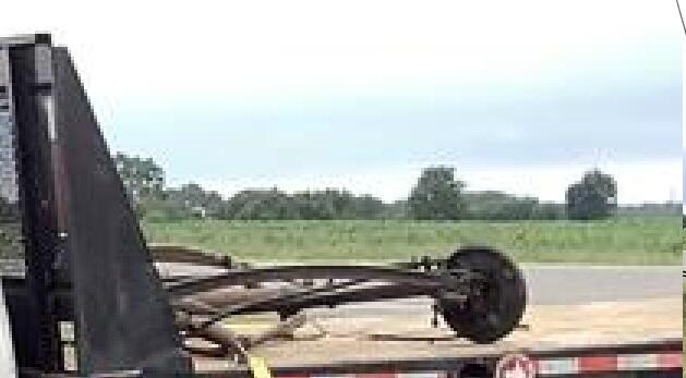

953 nut 70,662 #110 Posted July 12, 2021 OK Kevin, so what is the next project? Looks sorta like a Model A Ford front axle there, you holding out on us. Share this post Link to post Share on other sites
Pullstart 71,564 #111 Posted July 12, 2021 14 minutes ago, 953 nut said: OK Kevin, so what is the next project? Looks sorta like a Model A Ford front axle there, you holding out on us. Spare parts $10 for the pair at auction, now I have a spare differential, lever steer handle, and maybe tie rods too. I get to kind of reverse engineer things to see if more than just transmissions and rear ends were scavenged 5 Share this post Link to post Share on other sites

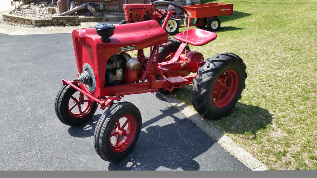

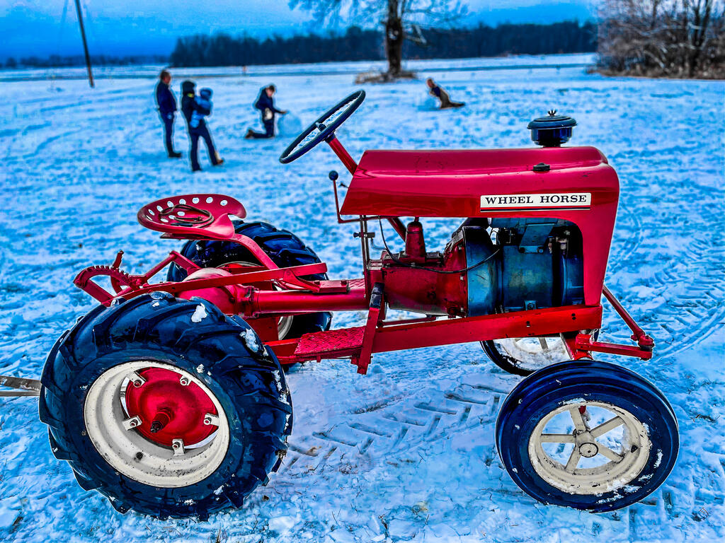

Pullstart 71,564 #112 Posted April 28, 2022 I entered this machine into Steiner Tractor’s photo contest. Here’s a link to the contest.. http://wshe.es/IwZAsBnK 4 7 Share this post Link to post Share on other sites
WHX?? 58,388 #113 Posted April 29, 2022 You might have a shot. Had mine out last weekend... second pull after long winter nap. 2 5 Share this post Link to post Share on other sites

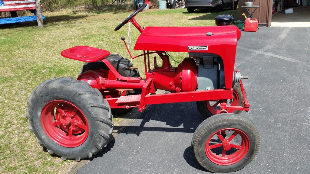

Pullstart 71,564 #114 Posted August 5, 2022 Momma’s got some brand new shoes! 4 Share this post Link to post Share on other sites

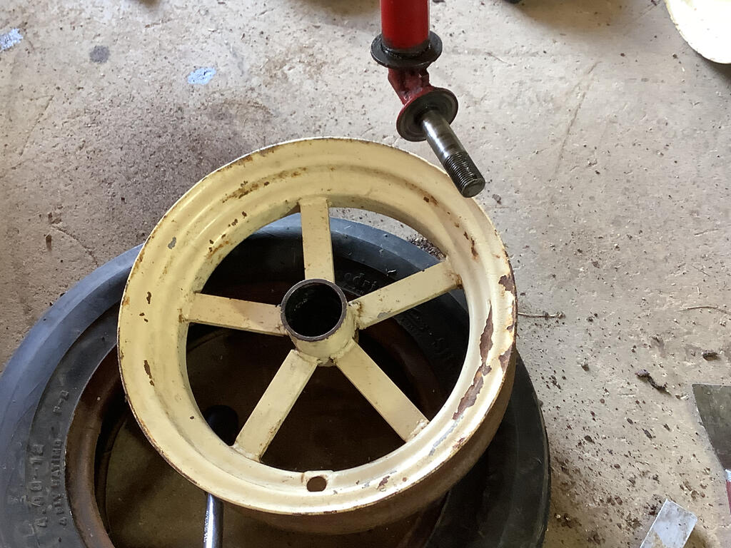

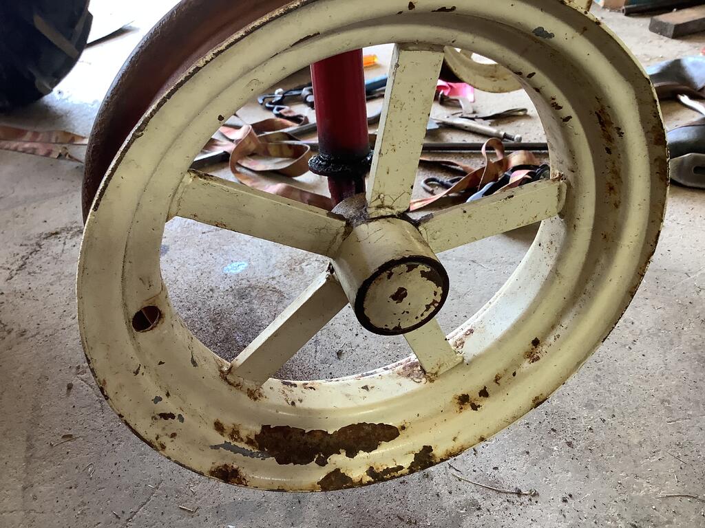

Pullstart 71,564 #115 Posted August 6, 2022 I want to thank @Wild Bill in VA for the guidance in this next step! I decided to e-tank the front wheels and repaint them inside and out. The rears will be cleaned, sanded, high build primered and block sanded, then primed and painted to match. I was hung up on how in the world to pull that pretty much flush mounted cap without wrecking it. To quote Bill, he said “ What you're going to have to do to remove the bearing cap is take a metal putty knife (or scraper whatever you call it) and tap the blade in between the wheel and cap and work the blade all the way around till it comes out. Remember the cap is thin but malleable and can be formed back into shape .... but don't hit it too hard.” Here’s what we’re up against: 4 Share this post Link to post Share on other sites
Pullstart 71,564 #116 Posted August 6, 2022 The caps are basically inverted automotive freeze plugs. They need to be tapped in on one side to rotate the other side out! Share this post Link to post Share on other sites
Handy Don 17,735 #117 Posted August 6, 2022 23 minutes ago, Pullstart said: Here’s what we’re up against: While tapping away carefully from the back edge with a thin, blunt tool, a gentle persuasion using a belt-style oil filter removal tool wrapped around the outermost end would give you a way to apply some twist at the same time 1 Share this post Link to post Share on other sites
Pullstart 71,564 #118 Posted August 6, 2022 Before assembling, I’ll give the front end the ole’ Greasy Pete and clean/repack the bearings too. @peter lena you’d be proud, I even found some vertical slop in the right side spindle I can shim out! 2 1 Share this post Link to post Share on other sites
Pullstart 71,564 #119 Posted August 6, 2022 2 minutes ago, Handy Don said: While tapping away carefully from the back edge with a thin, blunt tool, a gentle persuasion using a belt-style oil filter removal tool wrapped around the outermost end would give you a way to apply some twist at the same time There’s no back edge to speak of… but both sides are apart, cleaned and ready for fresh reassembly! 1 Share this post Link to post Share on other sites
Handy Don 17,735 #120 Posted August 6, 2022 Just now, Pullstart said: There’s no back edge to speak of… but both sides are apart, cleaned and ready for fresh reassembly! Seeing it disassembled, I realize that the cap is inset into the hub. What were they thinking?! Nice job getting it out! 1 1 Share this post Link to post Share on other sites
Pullstart 71,564 #121 Posted August 6, 2022 1 minute ago, Handy Don said: What were they thinking?! Simplicity, strength and longevity apparently 3 Share this post Link to post Share on other sites

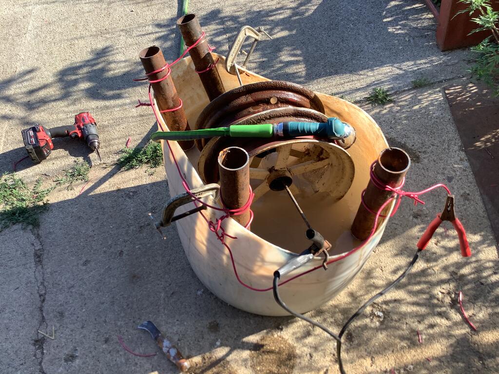

Pullstart 71,564 #122 Posted August 6, 2022 (edited) Found the E-tank! Remember when setting up an electrolysis tank, keep your cookin’s in a well ventilated space (outside) and polarity matters! Always keep your anodes POSITIVELY charged to PULL the garbage away from the NEGATIVE charge! Edited August 6, 2022 by Pullstart Details 2 Share this post Link to post Share on other sites
ineedanother 2,885 #123 Posted August 7, 2022 3 hours ago, Pullstart said: Found the E-tank! I have to say, those are the BIGGEST anodes I've ever seen in an e-tank 1 Share this post Link to post Share on other sites
