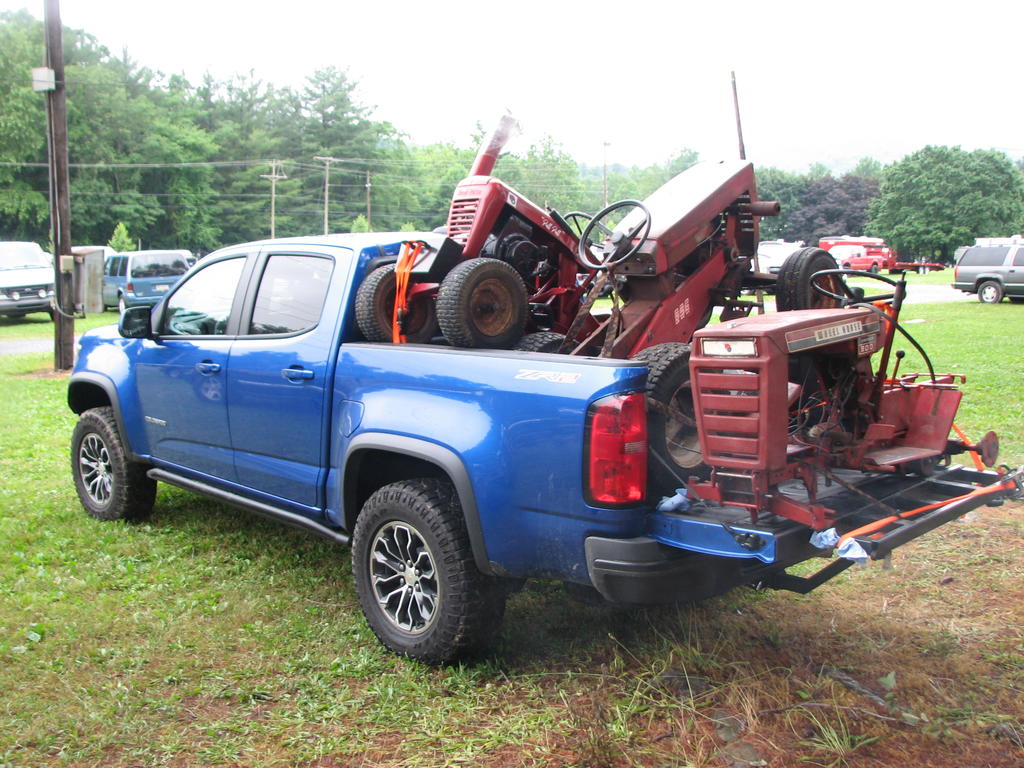

Pullstart 70,025 #1 Posted June 25, 2018 I had done some work for Barry on his trailer and he rewarded me with some shopping money on Thursday. I picked up this complete Commando 800 from @12 hp Kohler Robbie for the same amount as Barry gave me, so I've got a few hours of work into it. The tractor would not run when we were jumping it, so I ran to Walmart Thursday night and grabbed a battery and some random chemicals, sealants and supplies to see if I could get it going on Friday. I ended up getting the 656 and playing with that, so I started on the Commando tonight. I've been up 20 hrs, time to come in from the garage for the night. But first, an update. On Friday I did figure out that the intake valve keeper cup had split, and the valve was just bouncing around in the block when it was rolling over, so no compression and firing/backfiring out the carb and exhaust simultaneously. I found a valve set for $5 from one of the vendors and put the spares in the truck. The engine was pulled along with the wheels and tires and it was tossed on the tailgate of the Colorado. Thanks random guys that I stopped and asked for help! I dragged it into the garage tonight in hopes of making it back into a roller, but I got to work on the engine instead. The long block is assembled, I just need to torque the head bolts and put the cooling tin on the top. Then I'll have to get it back in the frame, then try to give it a whirl! 10 Share this post Link to post Share on other sites

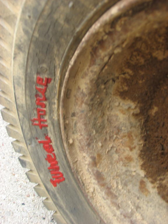

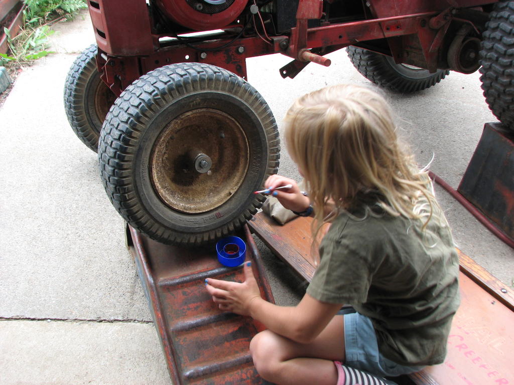

Pullstart 70,025 #18 Posted June 26, 2018 Yeah, no fun here! Nope not a bit! On a whim, I tried cleaning up the head on a flat plate with some 400 grit sand paper, then I put a film of copper RTV on each side of the head gasket and set it all back together with the bolts in place, but not tight... for about an hour. Then I torqued it and fired it up. Runs great, no head gasket leak and the smoke is starting to clean up after her running around the field for a while. Best part - really the best is that both the girls told me they love me at random today, playing on the tractors! Gotta love a girl who loves Wheel Horse Right now we're working on that shorter pedal and Rylee is painting the Wheel Horse logos on her front tires. 3 4 Share this post Link to post Share on other sites

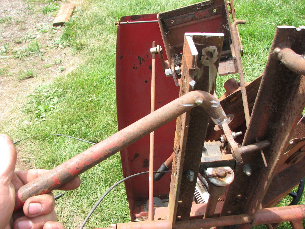

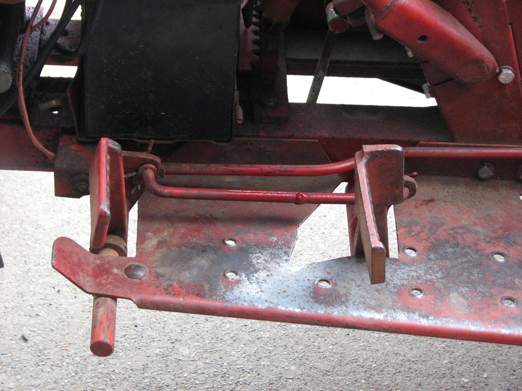

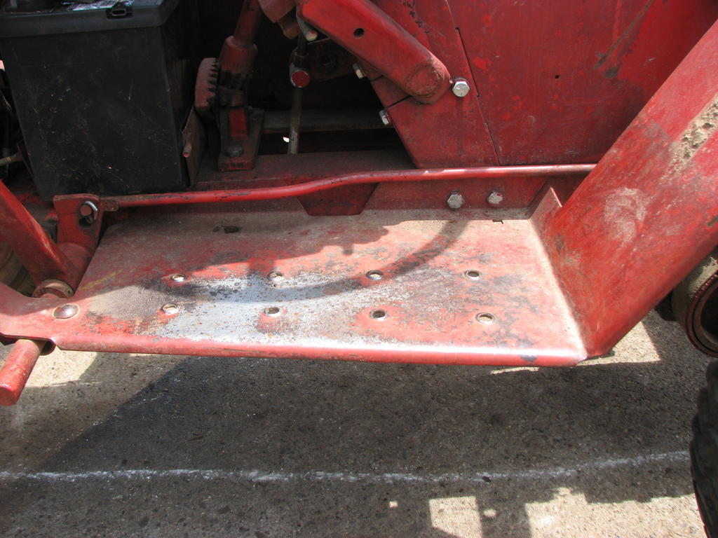

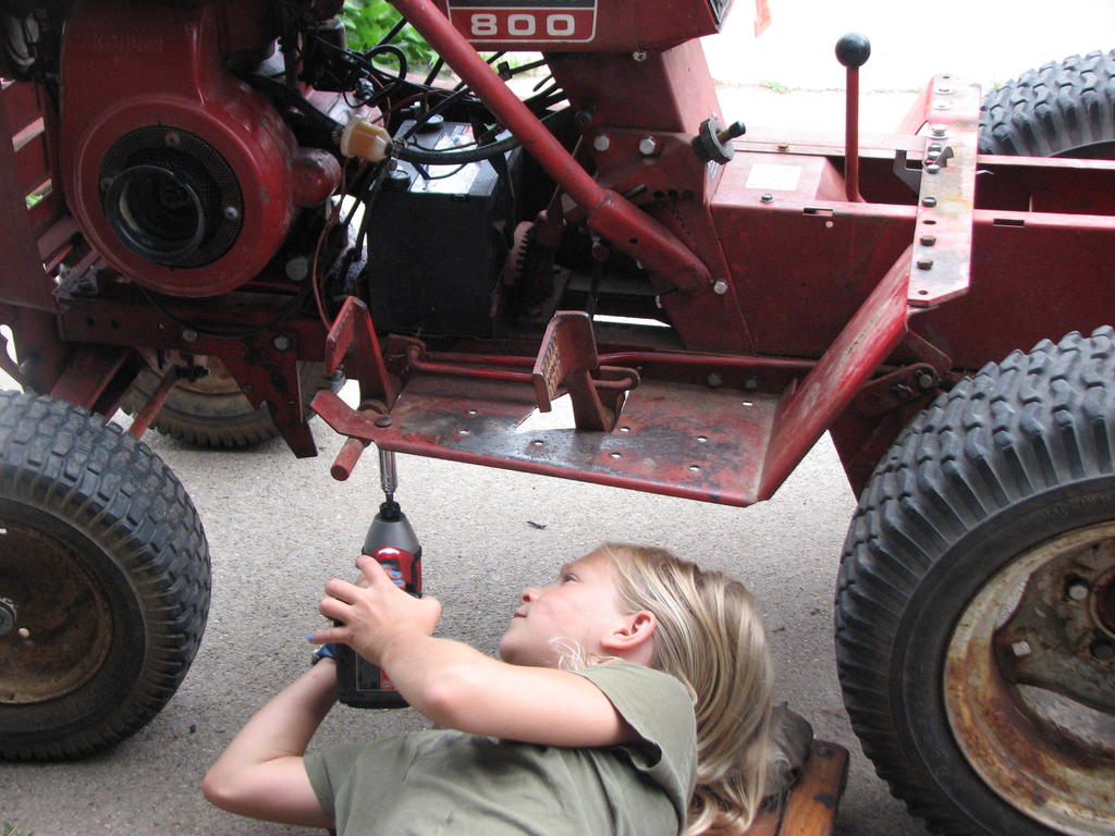

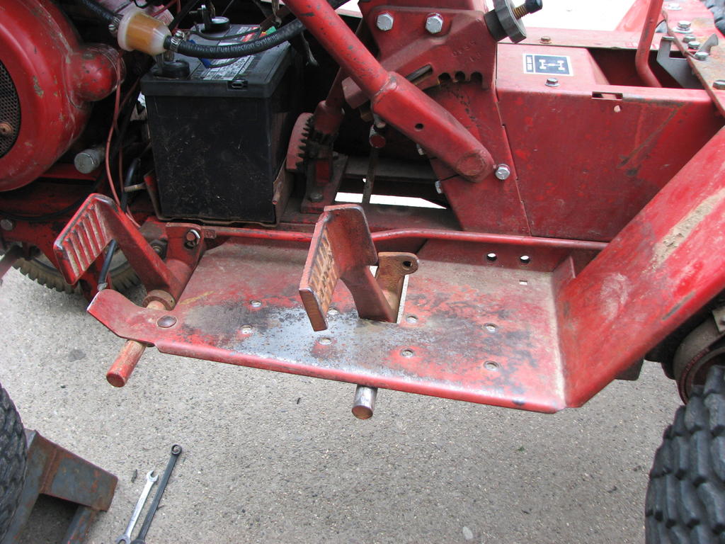

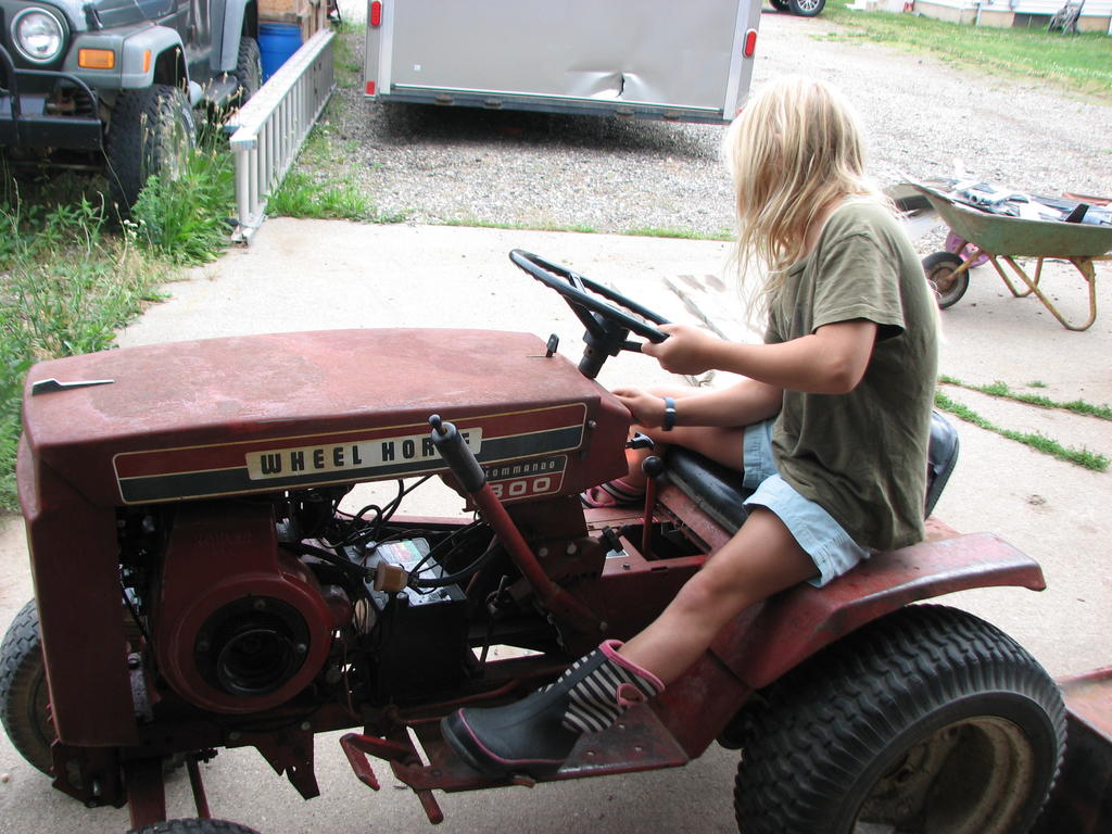

Pullstart 70,025 #20 Posted June 27, 2018 Finished up the dual pedal yesterday, now Rylee can start/shift without having to slide totally off the seat! 1 6 Share this post Link to post Share on other sites

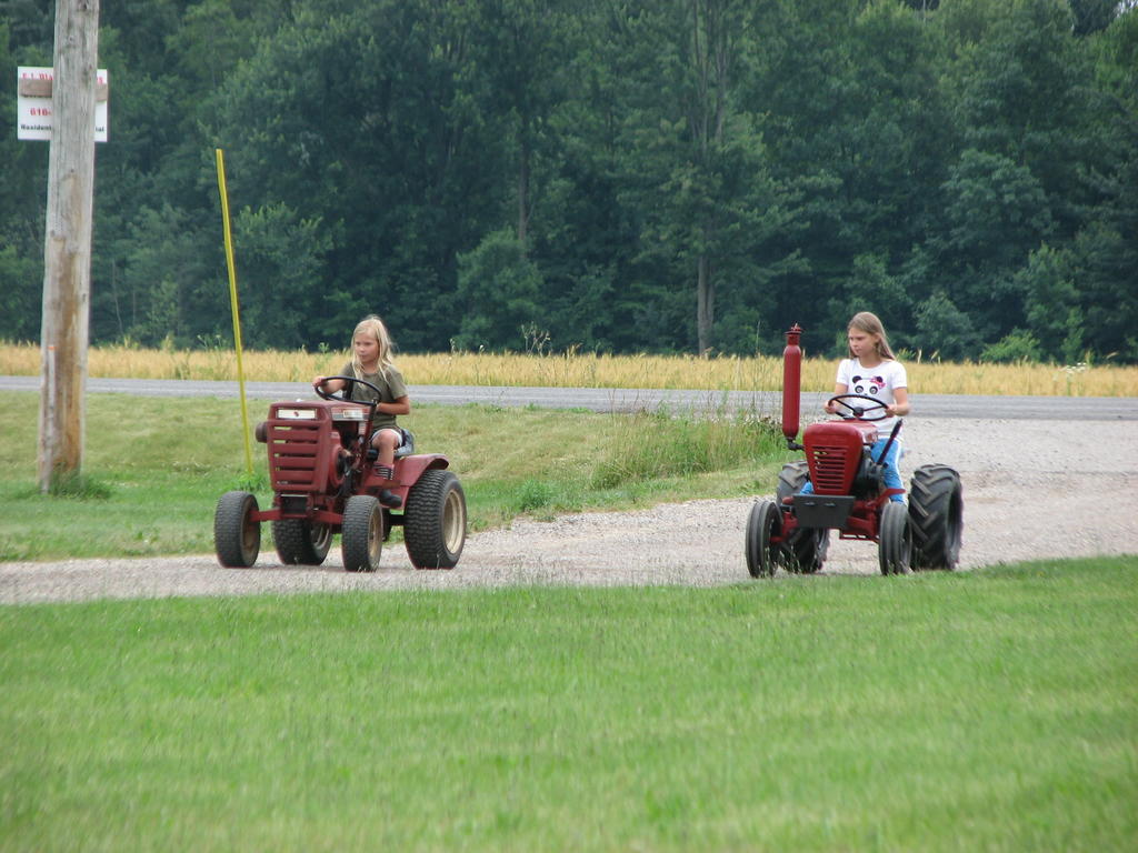

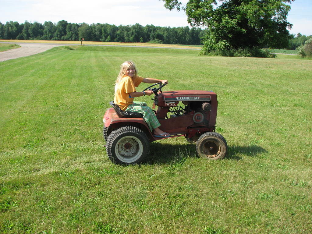

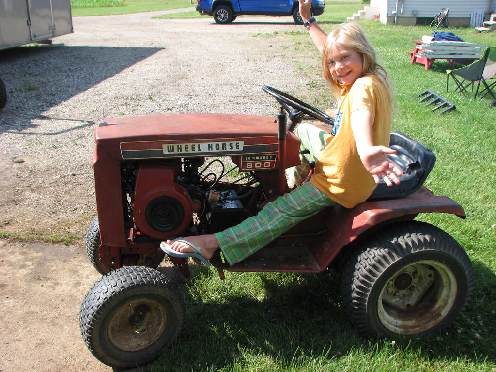

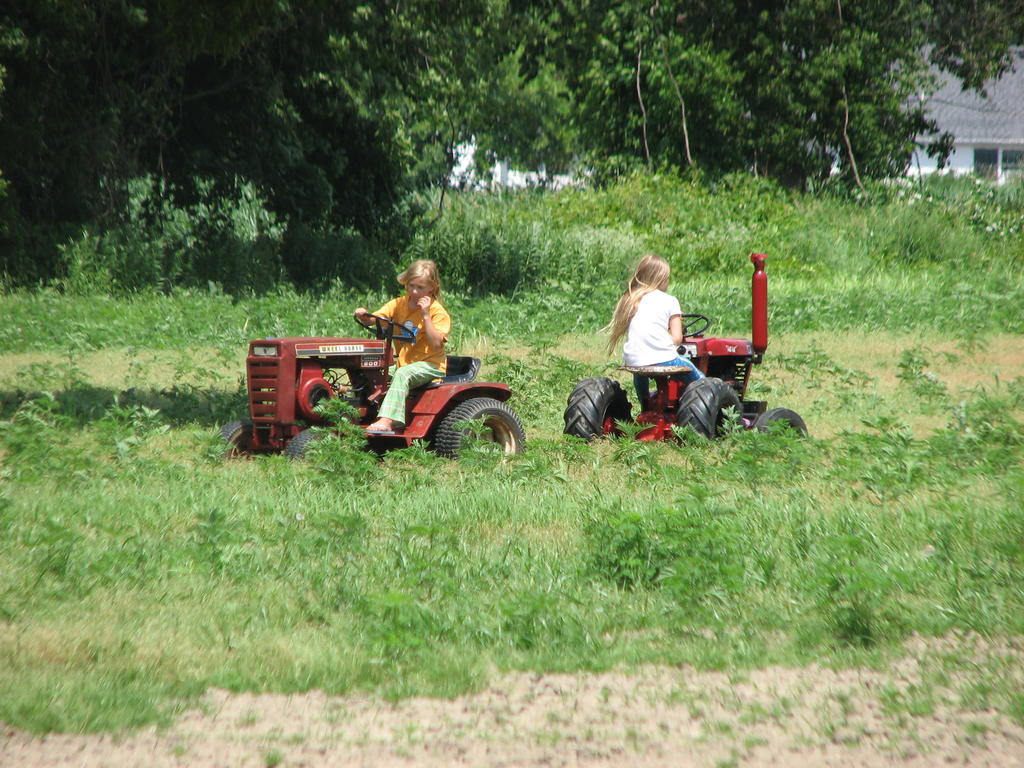

Pullstart 70,025 #21 Posted June 27, 2018 Jada on "Putt Putt", Rylee on "Screamin' Jimmy". That 8 horse Kohler sings them rpm's just like an old Detroit Diesel. I tuned the governors the same on both engines, but the Commando just plain runs. I might tune it down one way or another so we don't throw a rod. 1 5 Share this post Link to post Share on other sites
Sarge 3,471 #22 Posted June 27, 2018 Great pics, nice to see young kids getting into the hobby. That last pic shows a bit of jealousy - evidently one is faster than the other or something? Sarge 1 Share this post Link to post Share on other sites
Pullstart 70,025 #23 Posted June 27, 2018 Yeah, Putt Putt likes to idle down, Screamin' Jimmy... well you can imagine how it got that name! It's like a run-away once you start bumping up the throttle. But all in all, that's just Jada's focus face, not anger face. They were both having a blast, drag racing in the driveway and exploring the field. 2 minutes ago, Sarge said: Great pics, nice to see young kids getting into the hobby. That last pic shows a bit of jealousy - evidently one is faster than the other or something? Sarge 1 Share this post Link to post Share on other sites
19richie66 17,888 #24 Posted June 27, 2018 (edited) Just plain awesome there. That pedal setup is just too cool! Edited June 27, 2018 by 19richie66 2 1 Share this post Link to post Share on other sites
Pullstart 70,025 #25 Posted June 27, 2018 1 minute ago, 19richie66 said: Just plain awesome there. That pedal setup is just too cool! It's all C-101 donor parts. I told her that some day when she is big enough to reach the far pedal, we'll take off the pusher setup but probably leave the hole in the floorboard - and some day far away when she has her own little kid wanting to drive her tractor, then she can put it back on for him/her. She was all smiles, plus it keeps her foot away from that recoil cup for now. 2 3 Share this post Link to post Share on other sites
