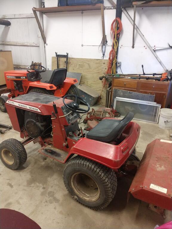

She needs good bath. It came with a 42" deck, plow, rototillerand 2 part cultivator. 1 owner
That ingersoll is a nice machine!
That Ingersoll is my pride and joy!

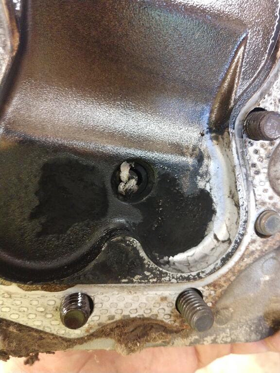

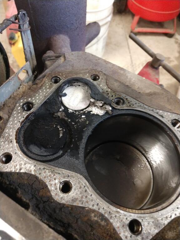

Well I think I found the culprit. This morning I went out to the barn and turned the flywheel by hand. I couldn't even tell on the rotation where the compression stoke was.
Might be worth your time to take the cylinder head off and resurface that. Decarbon the engine while you're in there.
R Scheer
The Kohler has ACR (automatic compression release?), unless the engine is spinning fast enough it will release the compression.  I understand that's to make life easier on the starter.
The ACH lifts the exhaust valve a slight bit off the seat momentarily just prior to TDC but you would feel compression as the piston went up. I agree with Eric @ebinmaine, pull the cylinder head off and see what you have going on. Could be a small chunk of carbon holding a valve open.
windish62
Well that's what it looked like with the head off. Lol
