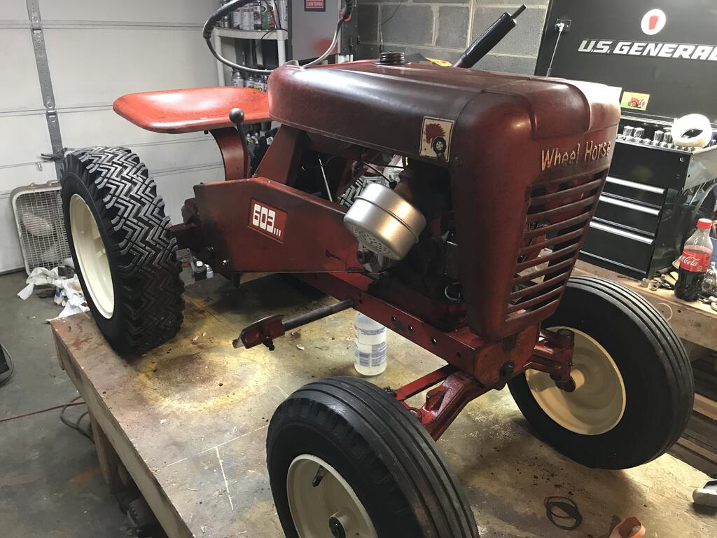

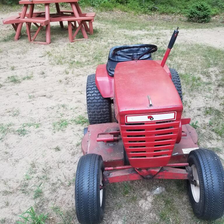

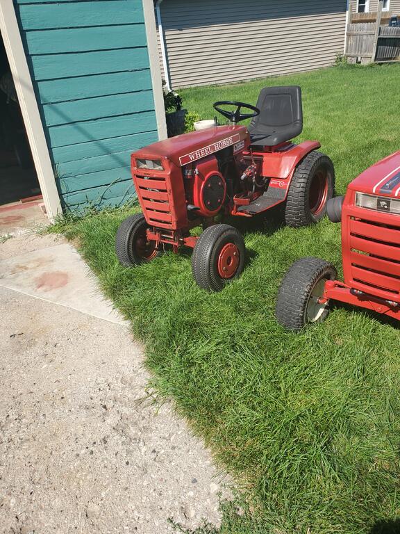

Edgee 12 #1 Posted August 14, 2020 Trying to keep the patina on my tractor but I'm also looking to keep rust to a minimum. What could l do to make that happen ?' 2 2 Share this post Link to post Share on other sites

Retired Wrencher 7,037 #3 Posted August 14, 2020 I just Marvel mystery oil wipe it down let it set for a while wipe of excess. DONE. Brings back the color. I just did this a month ago. 6 1 Share this post Link to post Share on other sites
953 nut 70,353 #4 Posted August 14, 2020 6 hours ago, Edgee said: keep the patina on my tractor but I'm also looking to keep rust to a minimum Your 857 will look showroom ready with just a little degreasing, automotive polishing compound and waxing. For the deck I would suggest some steel wool scrubbing with WD-40 and then a good waxing. 4 Share this post Link to post Share on other sites

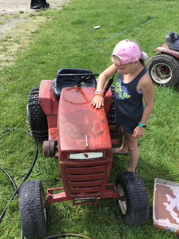

Pullstart 71,521 #5 Posted August 14, 2020 As @peter lena says, “feed the paint” Michigander! Your tractor looks pretty awesome the way it is, it doesn’t look like it needs too much work to keep it awesome! I have used soapy water for a 600-1000-1500 grit wet sand, or WD-40 and the same papers for the same treatment with great results. If you use sand paper, stay away from the sharp edges and bends of the body and frame just focus on the flat, smooth stuff. 5 1 Share this post Link to post Share on other sites
peter lena 10,109 #6 Posted August 14, 2020 pullstart, agree with you on the wd-40 or similar light lubricant. every time i see a neglected unit the first thing i think of is starting to help this back too life. , the other thing that i have really picked up on , is that the initial feeding of the pant with lubricant , gets better with time , often allowing the base paint to actually start to shine. glad to see someone else , helping another horse along , pete 3 Share this post Link to post Share on other sites

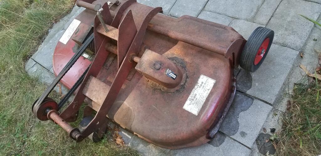

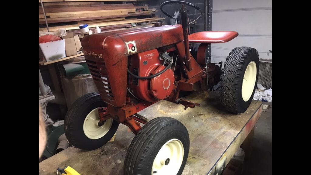

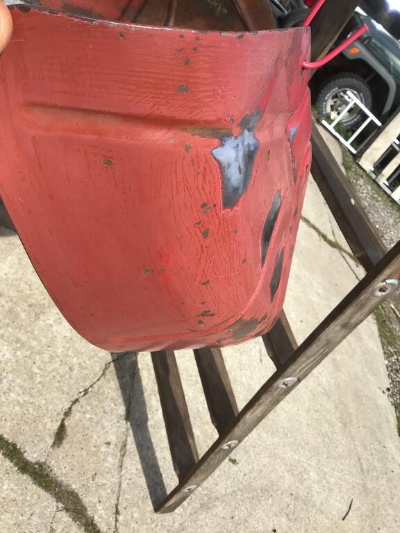

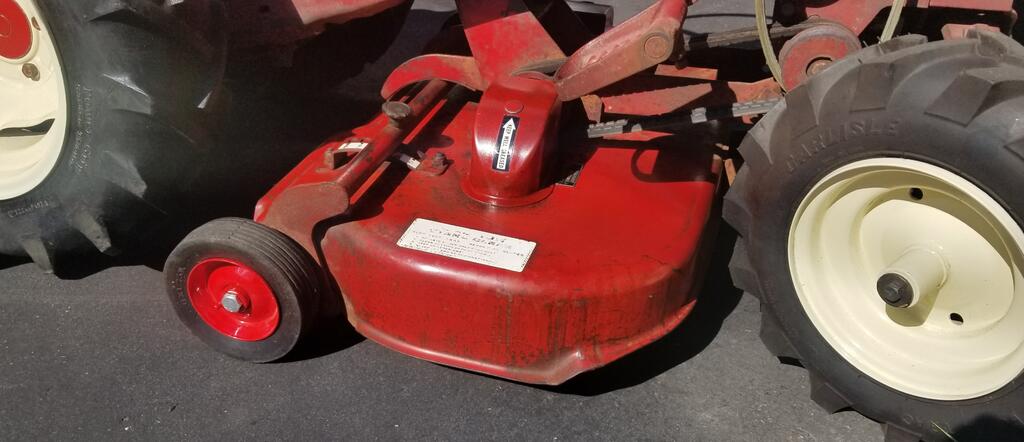

AMC RULES 37,260 #7 Posted August 14, 2020 (edited) I most recently discovered this. Yes Virginia, there is a Santa Claus! Edited August 14, 2020 by AMC RULES 4 Share this post Link to post Share on other sites
Skwerl58 843 #8 Posted August 14, 2020 AMC rules what method did you use to bring it back ??? Share this post Link to post Share on other sites
Edgee 12 #9 Posted August 14, 2020 2 hours ago, pullstart said: As @peter lena says, “feed the paint” Michigander! Your tractor looks pretty awesome the way it is, it doesn’t look like it needs too much work to keep it awesome! I have used soapy water for a 600-1000-1500 grit wet sand, or WD-40 and the same papers for the same treatment with great results. If you use sand paper, stay away from the sharp edges and bends of the body and frame just focus on the flat, smooth stuff. Wow ! What a difference 1 1 Share this post Link to post Share on other sites
Edgee 12 #10 Posted August 14, 2020 Would a spray of clear coat work ? Share this post Link to post Share on other sites

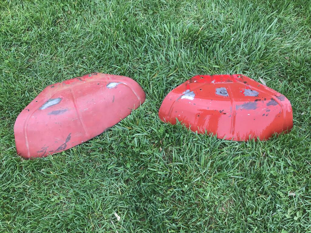

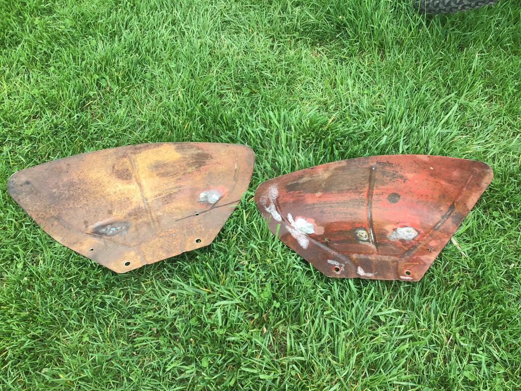

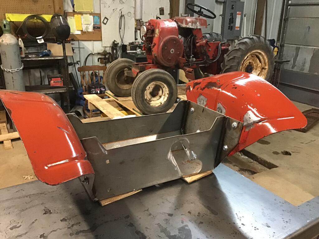

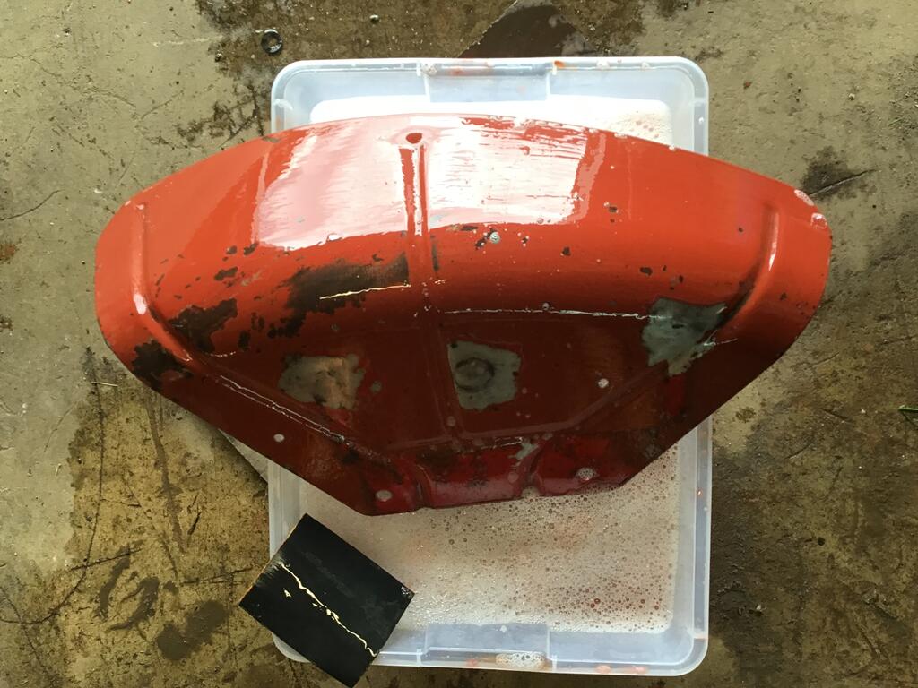

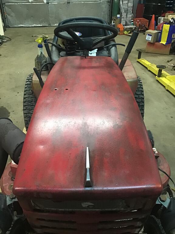

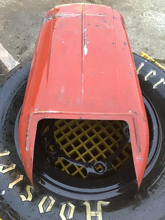

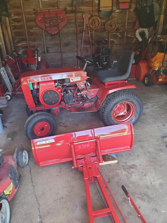

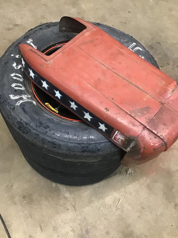

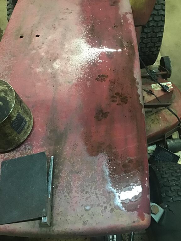

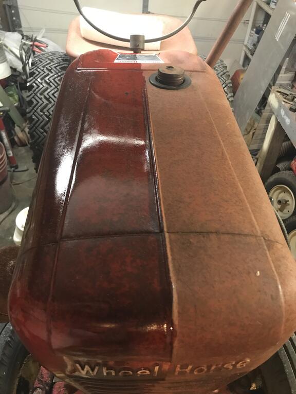

Pullstart 71,521 #11 Posted August 14, 2020 (edited) After a light wet sanding, a clear coat does wonders! I’d suggest using soapy water as a cutting compound if you plan to spray the clear. Satin and crystal both look awesome as clear! Here are some pics of soapy water wet sanding and Crystal Clear results. My “Frank” build for Mrs. Pullstart was very long but super detailed with all this info too Edited August 14, 2020 by pullstart Found some pictures for ya 3 Share this post Link to post Share on other sites

AMC RULES 37,260 #13 Posted August 14, 2020 1 hour ago, Skwerl58 said: AMC rules what method did you use to bring it back ??? Follow along, some of the process was documented here. Starting at post #5914...toggle forward through the pages there. Share this post Link to post Share on other sites
Pullstart 71,521 #14 Posted August 14, 2020 Here is the beginning of Frank... Click here beginning to wet sand... Click here hood work... Click here everything else getting wet sanded.... Click here final prep, final spraying... Click here near final assembly, pretty much wrapped up... You know what to do Share this post Link to post Share on other sites

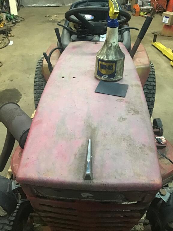

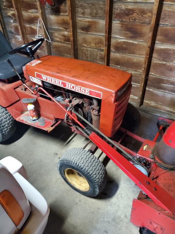

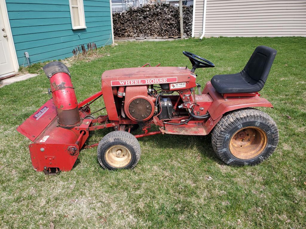

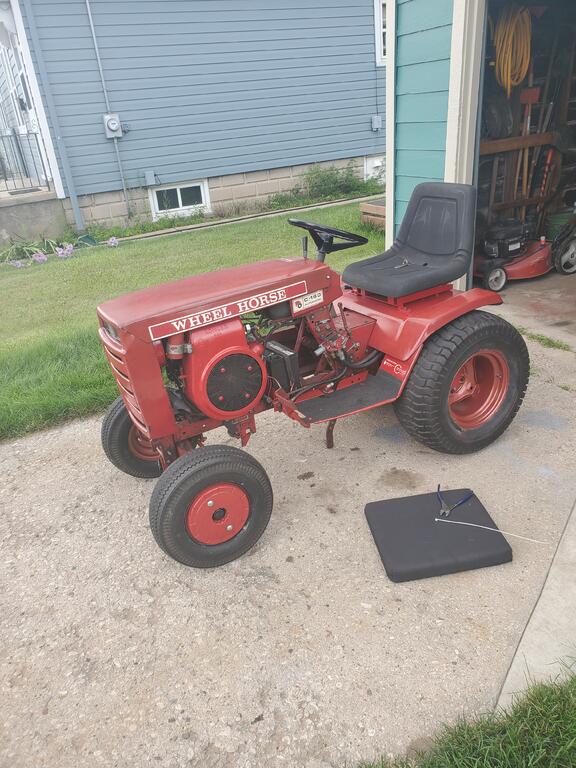

12Horse Paladin 1,038 #20 Posted August 16, 2020 On 8/14/2020 at 9:06 AM, pullstart said: After a light wet sanding, a clear coat does wonders! I’d suggest using soapy water as a cutting compound if you plan to spray the clear. Satin and crystal both look awesome as clear! Here are some pics of soapy water wet sanding and Crystal Clear results. My “Frank” build for Mrs. Pullstart was very long but super detailed with all this info too Not the best pics, but the method i more or less used on my c160; b4 n after (plus a lil Rustoleum Sunrise Red, applied by hand n rubbed on from the can)... AFTER: 3 Share this post Link to post Share on other sites
