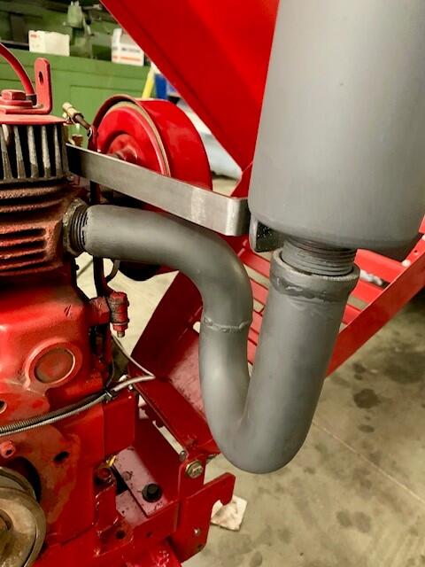

Greentored 3,221 #129 Posted January 20, 2021 On 1/19/2021 at 8:22 AM, pullstart said: If you haven’t mentioned yet, sorry for my ignorance... but how about opening that hood and showing off the rest of the exhaust? Looks like a loop before the stack? @pullstarthere ya go bud. 1 1/2" OD 14 gauge mandrel bends. Plan was to 'loop' the pipe all the way to the frame and back up, but will most likely see a PTO one day so I couldnt do it. Wanted as much pipe length as possible between the port and muffler without looking ridiculous and maybe pick up some scavenging help. On the same token, it oughtta have a long intake manifold as well, not getting into that either so I drew the line. Its a dang tractor, not a dragster Dont laugh at my ugly welds HA, never been good at 'going in a circle'...... 4 1 Share this post Link to post Share on other sites
DennisThornton 4,773 #130 Posted January 22, 2021 On 1/20/2021 at 10:12 AM, Greentored said: @pullstarthere ya go bud. 1 1/2" OD 14 gauge mandrel bends. Plan was to 'loop' the pipe all the way to the frame and back up, but will most likely see a PTO one day so I couldnt do it. Wanted as much pipe length as possible between the port and muffler without looking ridiculous and maybe pick up some scavenging help. On the same token, it oughtta have a long intake manifold as well, not getting into that either so I drew the line. Its a dang tractor, not a dragster Dont laugh at my ugly welds HA, never been good at 'going in a circle'...... Wet manifold? Water drain trap? You know, that could have a real use with a tall stack. Drill a little weep hole in the bottom of that trap. Could have saved many an engine! Coating? And the threaded end at the muffler has got me in pause mode. Share this post Link to post Share on other sites
ebinmaine 80,680 #131 Posted January 22, 2021 43 minutes ago, DennisThornton said: Coating? And the threaded end at the muffler has got me in pause mode. I'mma guess BBQ paint. And NPT thread to fit iron pipe. 2 Share this post Link to post Share on other sites
Greentored 3,221 #132 Posted January 22, 2021 9 hours ago, DennisThornton said: Wet manifold? Water drain trap? You know, that could have a real use with a tall stack. Drill a little weep hole in the bottom of that trap. Could have saved many an engine! Coating? And the threaded end at the muffler has got me in pause mode. That's actually something Im concerned with- these stacks like to 'blow' condensation when first fired up, and that 'trap' is a perfect place for it to collect. So far appears to be ok, but may end up needing a tiny weep hole. Coating is VHT 'flame proof'- we use it on the custom coleman lantern tops which hit 750-900 degrees- zero issues. @ebinmaine is correct on the fittings, and the one at the muffler is a plain old union I chucked in the lathe. This way I can stab anything I want on there, like a straight pipe if I want to tick off the neighbors once in awhile 1 1 Share this post Link to post Share on other sites

DennisThornton 4,773 #134 Posted January 22, 2021 2 hours ago, Greentored said: That's actually something Im concerned with- these stacks like to 'blow' condensation when first fired up, and that 'trap' is a perfect place for it to collect. So far appears to be ok, but may end up needing a tiny weep hole. Coating is VHT 'flame proof'- we use it on the custom coleman lantern tops which hit 750-900 degrees- zero issues. @ebinmaine is correct on the fittings, and the one at the muffler is a plain old union I chucked in the lathe. This way I can stab anything I want on there, like a straight pipe if I want to tick off the neighbors once in awhile Never seen such... I doubt it would need a weep hole. Run for a minute or two should deal with that. Thanks for the explanations! 1 Share this post Link to post Share on other sites
ebinmaine 80,680 #135 Posted January 22, 2021 1 minute ago, DennisThornton said: Never seen such... I doubt it would need a weep hole. Run for a minute or two should deal with that. Thanks for the explanations! Dennis my Cinnamon Horse c160 does that. For the first few minutes of runtime water comes out the seam between the top of the muffler and the bottom of the stack. I'm not worried about rust through because it's made out of black iron pipe but... I should probably do something like change a fitting so the water has a place to collect at the elbow. 1 Share this post Link to post Share on other sites
