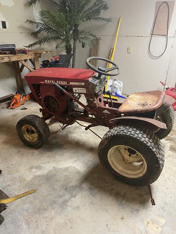

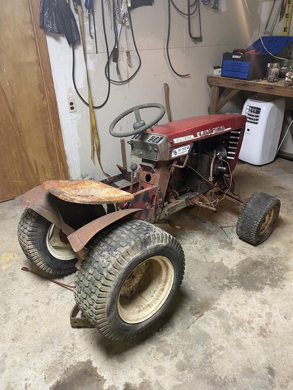

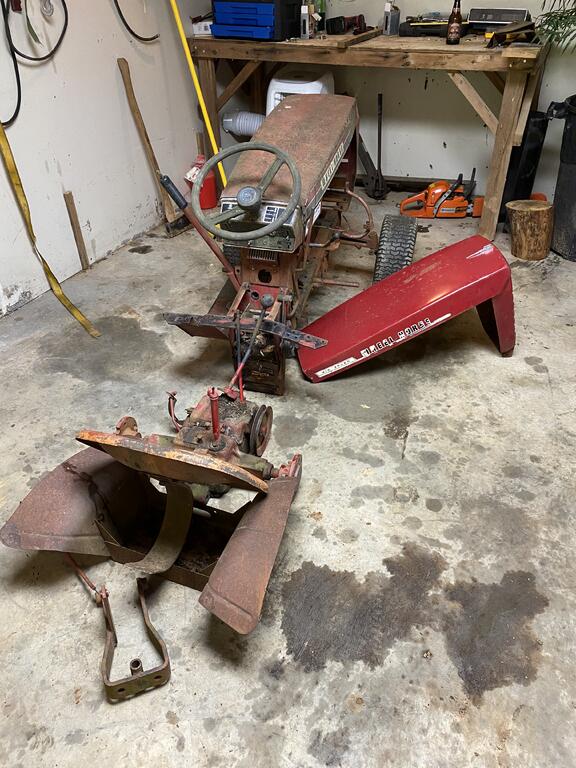

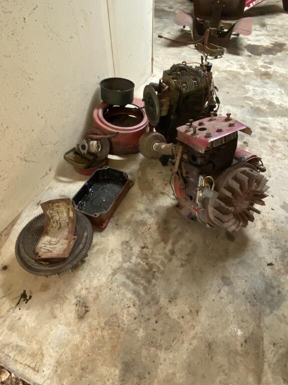

Greentored 3,220 #1 Posted May 24, 2020 Parts are suddenly accumulating fast, and scored a bunch more from fellow horseman @Bert on Friday. I started a ‘if you could build your ultimate horse’ thread awhile back and it put a fire under my rear, and with the 520 gone and 1277 running grass duty, now is the time. started mocking things up today: C120 parts machine (that I robbed the hydro out of for the 1277) 8 pinion 8 speed, round fenders, stirrups, late 60s long hood, Brinly hitch, and skipping the original plan for Onan power, going to run a 14hp Kohler, and it’ll probably get warmed up a touch. This one will be running ags and tri ribs for sure! Follow along and make sure I don’t do anything stupid😄 10 3 Share this post Link to post Share on other sites

SylvanLakeWH 31,629 #3 Posted May 24, 2020 But, by the looks of the last pic you’re done with it all ready!!!??? 5 Share this post Link to post Share on other sites

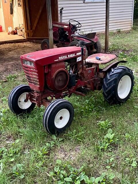

Greentored 3,220 #8 Posted May 26, 2020 2 hours ago, PeacemakerJack said: @Greentored I’m in on this restomod. This will be a fun build to watch...I like what I see already and you have the good fortune of Mike @prondzy‘s Beast to see roughly what it will look like all assembled. Now that I see @prondzy has already done it, Im gonna have to change something so folks dont see a pic and think he sold his to me he even has the same exact tires I plan to use! By the way, a large part of this build is being done with 'plow dog' in mind! Apparently I am building a whole tractor to plow a 50 x 50 garden, so its gonna have to attend a couple plow days to get some real use...... 3 Share this post Link to post Share on other sites

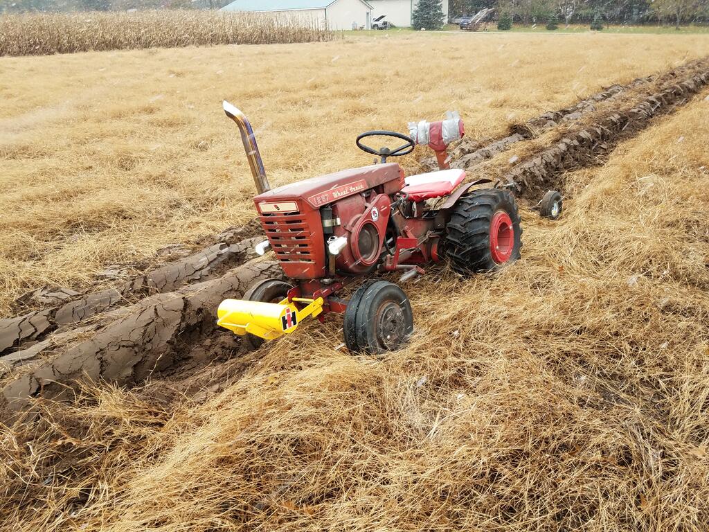

prondzy 3,889 #12 Posted May 26, 2020 I added 520 swept axle 2 years ago. I used parts from every style from 62 up to 93 1 4 3 Share this post Link to post Share on other sites

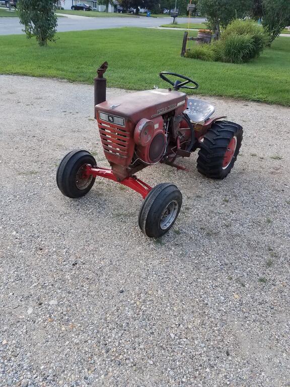

Shynon 7,601 #13 Posted May 26, 2020 The Machine 6 2 5 Share this post Link to post Share on other sites

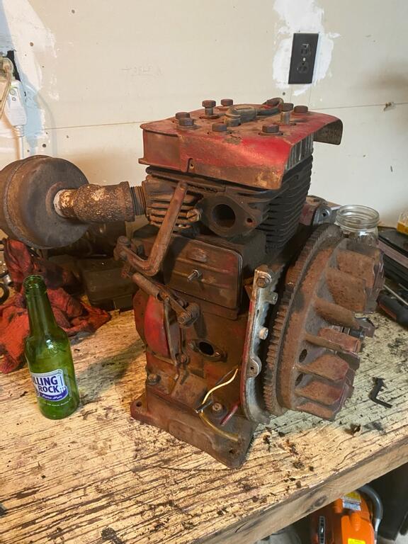

Greentored 3,220 #18 Posted June 4, 2020 Update: picked up a brand new set of Ags and tri ribs, snatched the cam out of a junk K241 and stabbed it into a K301 that had a broken cam. This will be the temporary powerplant so I can get this beast up and driving. Planning to put her right to work, and in the meantime, the K321 parts can start trickling in- its going to get the full '4000rpm max, puller style' build, including a cheater cam! I want this thing to yank a house down at 250rpms 6 Share this post Link to post Share on other sites

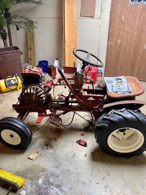

Greentored 3,220 #22 Posted June 10, 2020 Update: Blasted and painted a set of wheels Wimbledon white polyurethane, mounted up the tires and loaded the rears, then snuck out of work early yesterday and set a goal to get her together for a shakedown run. There's tools all over the shop, my parts tractor stash was raided to death, and theres a LOT more to be done, but she made her maiden voyage around the property without the slightest hiccup! Now to go back and replace all the nails with cotter pins, hook up a brake, install hitch and belt guards, fab up a hood hinge and get rid of the ratchet strap, etc.... ".......but I drove it" 3 5 Share this post Link to post Share on other sites
