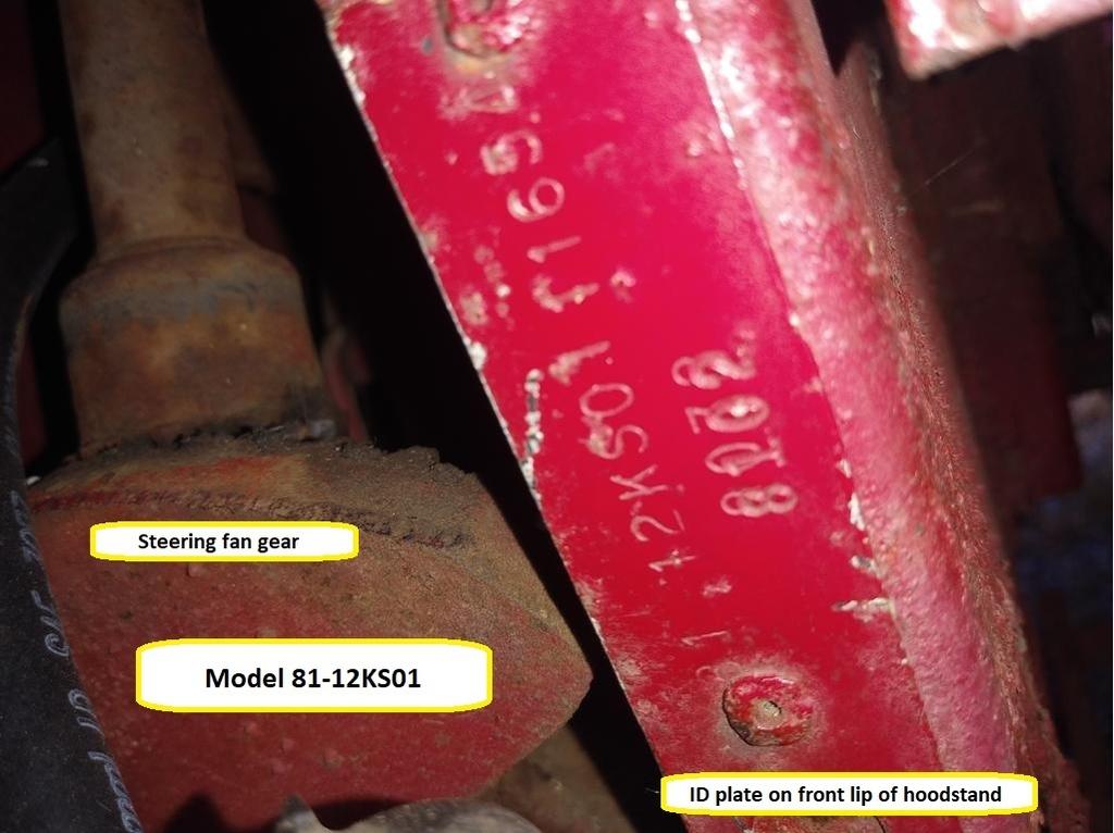

gwest_ca-(File Mod) 12,455 #9 Posted April 12, 2020 Welcome to the forum. Click on the pictures The C-101 ID plate may be seen standing on the left side of the tractor looking toward the rear. Garry 1 Share this post Link to post Share on other sites
