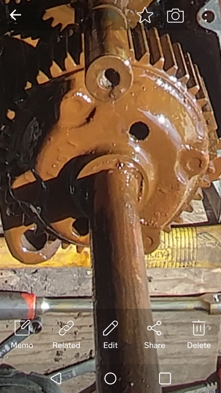

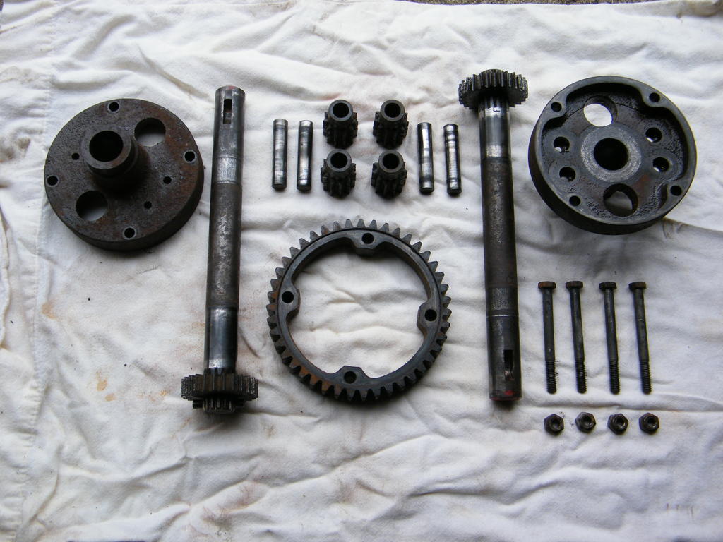

Steveasaurus I don't know what bevel gear looks. I know you mentioned something about 4 holes, tried blowing up picture and posting.  Couldn't find mics to measure axle and when found corresponding numbers on other case, I'm thinking someone, just changed out trans.  So guess I'll either try to find case for this one or find right trans. I'd rather try to find right one, gentleman I found on an other site that's selling 3 speeds for 100.  Just don't know which one, and if had consider shipping, but driving 6 hrs isn't out of question either. So we shall see just a little bummed.    Thanks again though for everything I would have been on a crazy goose chase.

Looks like a four pinion differential, probably one inch axles.

Okay, axles measure 1 1/8
So think i am going to try and find a 5058 trans.
Put it in save whatever parts can for kid and call it a day

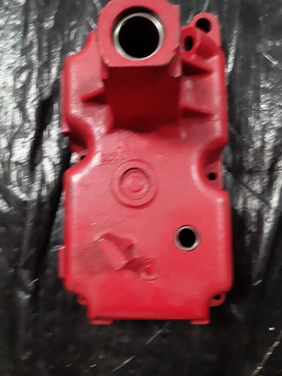

Understand this...the case you have there was made for 1" axles.  Someone drilled out the case to accept the 1 1/8" axles and seals.  Check trans picture for reference in this manual...also has part numbers for transmission parts.
OK...so that case is junk.  Pull out all of the gears and clean all of it, pull out and open the differential and clean all of that.  I'm sure you have the bevel gear differential.  See if a casting number is on the big 44/11 toothed gear...the one that looks like a mushroom..should be  #4166.  I'll check out the rest of what may be in the transmission for parts.  Go ahead and start looking for either another transmission or the case halves #6940 & #6941.

It depends yet.  I need you to pull out all of the gears, differential, shift rails and shift forks and clean the parts.  I need to know what is inside the differential.  If it is, then we need to see what gears they used...ie...the gears for the #5053 or the gears for the #5058.  I just looked a the  parts manuals for those 2 transmissions and the only parts that are common to both transmissions is the cluster gear, the cluster gear shaft, the reduction pinion gear and the reduction gear (the 2 gears on the cluster gear shaft).  That shaft is the smooth shaft...not the splined one.   Don't worry about taking it apart, I have step by step videos to put it back together.  So, if they used the #5058 gears, then you only need the case halves.  If they used the #5053 gears, you have a bucket full or parts that someone else on this site can use at some time...and you need to find a good working transmission.
   I think I would try to find a #5058 bevel gear transmission with everything in it.  I was wishing @953 nut might have a lead on finding one.  That transmission or versions of it was used on the 1963--953, 1964--1054, 1965--1054A, and the 1967--1057 & 1257.
   Option 3...find a #5060 or #5071 transmission.  These are the 10 pinion Limited Slip differential transmissions that have 1 1/8" axles and a hi/low range.
   Option 4...Find a regular 3 speed transmission with 1" axles...like the case you have in it.  Lots to think about.  I would look for  the right trans first...to keep the horse original.  :occasion-xmas:

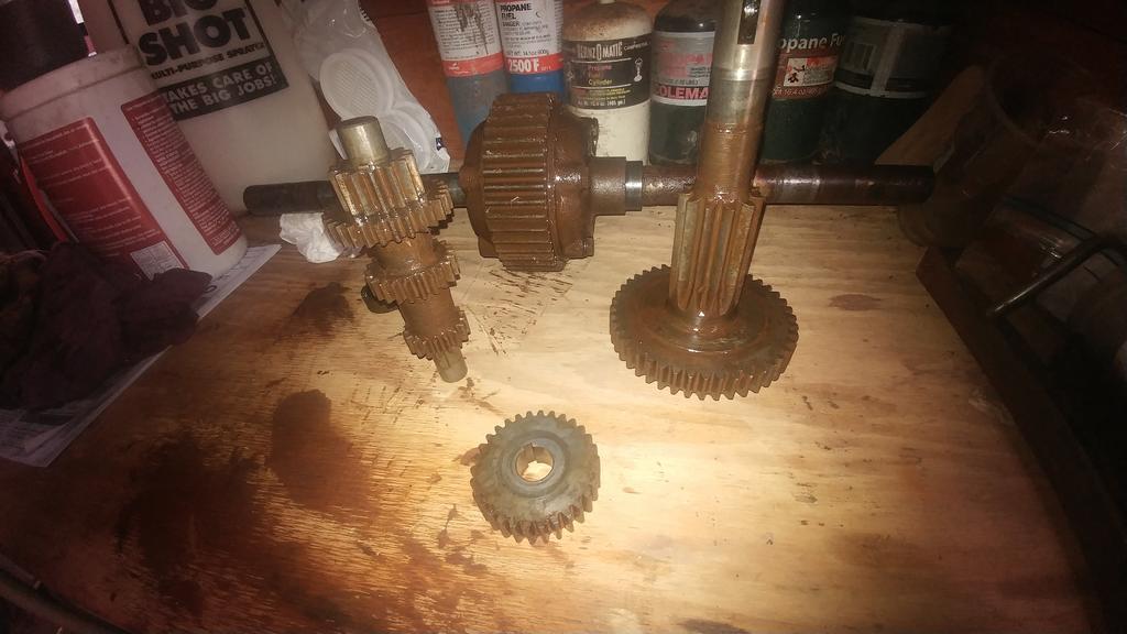

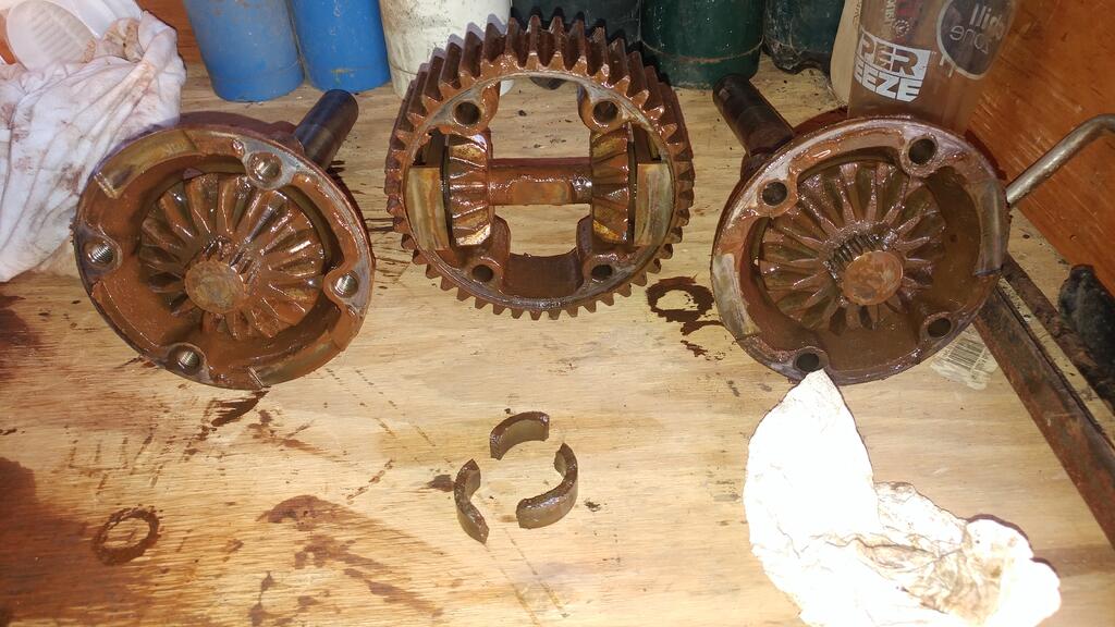

Okay guys able to do a little today, got differential out, 44 tooth, sramped on one side is E22 and other is E25, can't find any other numbers.  One slip collar was broken in pteces in case.  Gear standing on end in pic also 44 tooth. Assemply in front came out of narrow side like is, (just as other assembly did), and gear in front of pic was on top of this assembly, and I think it should be on other side, cause was never engaged in a key, and key on bottom didn't engage anything. So that's where at.  Can't find phone number, cause didn't save, but if free call 203 610 7418. I'll be here for another half hour. Thanks guys

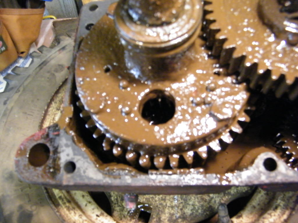

stevasaurus
  • Thanks 1

Finally split bull gear, pictures will follow. Steveasaurus, you were correct, are last conversation, what I thought was a slip/lock collar, is actually part of outside case.  So with everything wrong with what I have, I'm def looking for whole trans. I know I can get a least one half of correct case, but then I need 2 more pieces to make this correct.  So not on front burner as of now but definitely searching when can. Will update with my progress.  Thank you gentleman

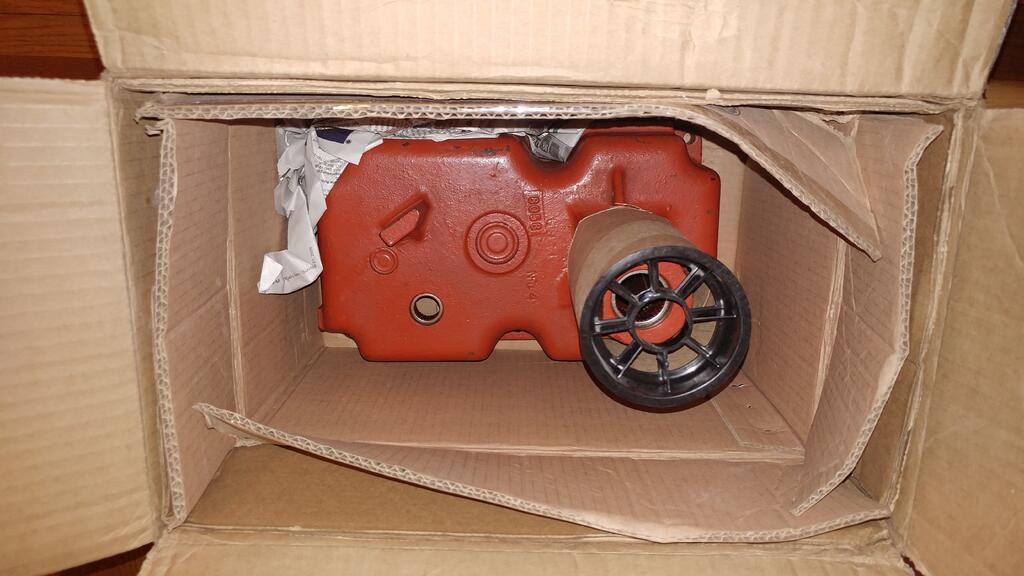

Well hello gentleman, I know ita been awhile, but am making some progress, just got a nos 6941 case half in mail other day, so I'm HALF way there. I'll have to find the other side but progress is progress. I'll keep you all up to date as things happen

76c12091520h
  That box looks somewhat familiar ..........
