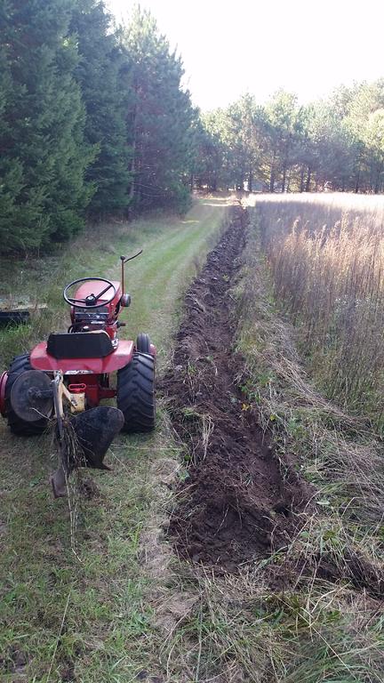

WHX24
Posted (edited)
4 hours ago, Darren Southard said:
 was thought tranny with hi-lo would be heavier duty then what is in it now.
I field plow with a 1257 with that tranny Darren and I don't treat it gently... it's bullet proof and if it does break I can fix it! :) BTW I learned most of what I know about :wh: trannies  from the Dino!

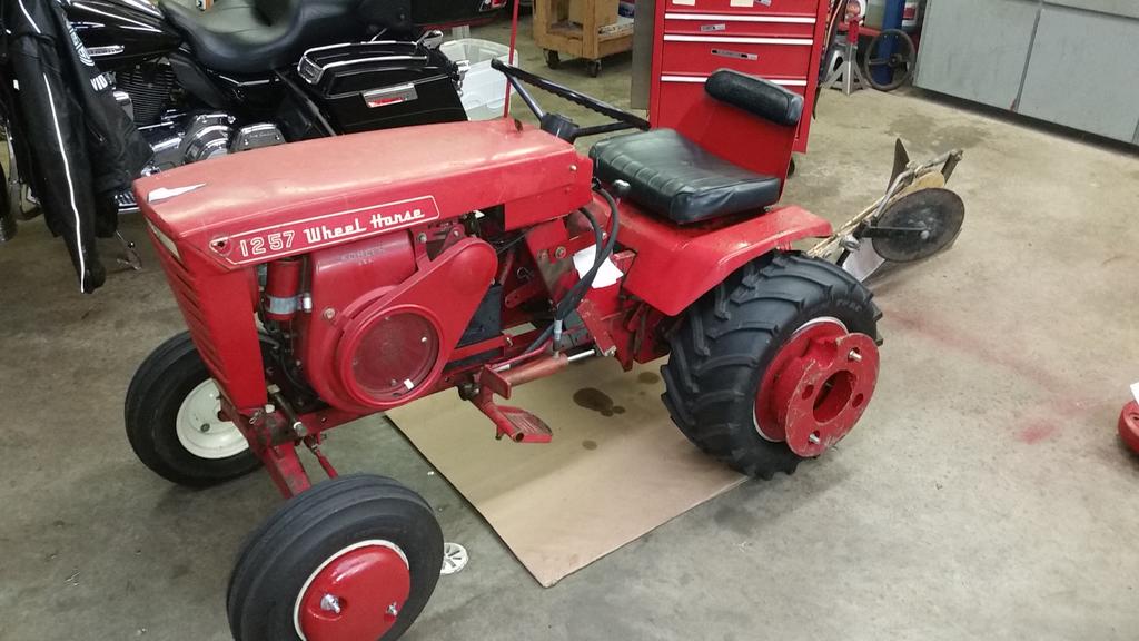

Here's tractor day my son brought home from school
Darren Southard
Tried posting a video, don't know if worked but here's tractor in current state

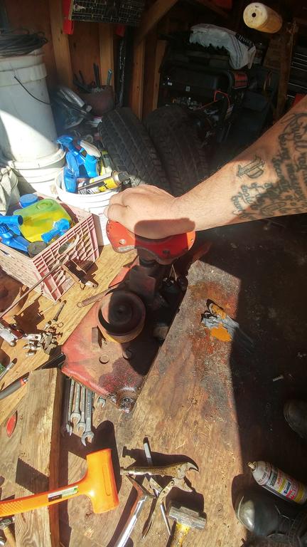

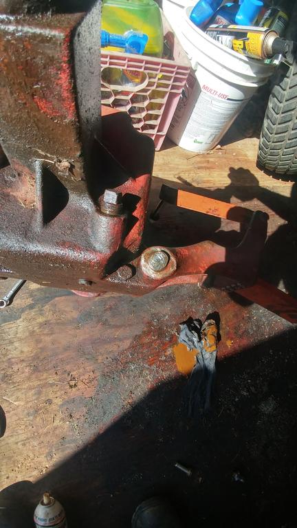

Ok guys, started working the old girl today, ya it's been a little while, thought going to be easy, nut after four hours this where I am at
Darren Southard
Broke a hub don't think that big of deal, but hitch pin that goes through case is frozen, was going to grind of both ends and beat down more since it is moving. Didn't want to sacrifice pin but figured a bolt or maybe find another pin down road after together.
ebinmaine
If the hub is already broke and you can obviously cut that off.
Hubs on these normally require a puller and many of us actually use an old hub as the puller mechanism.
That  hitch pin in the rear....
I've had to cut those into 3 pieces to separate the transmission halves.
You can get a hardened pin from TSC or whatever Farm supply.
  • Like 1
