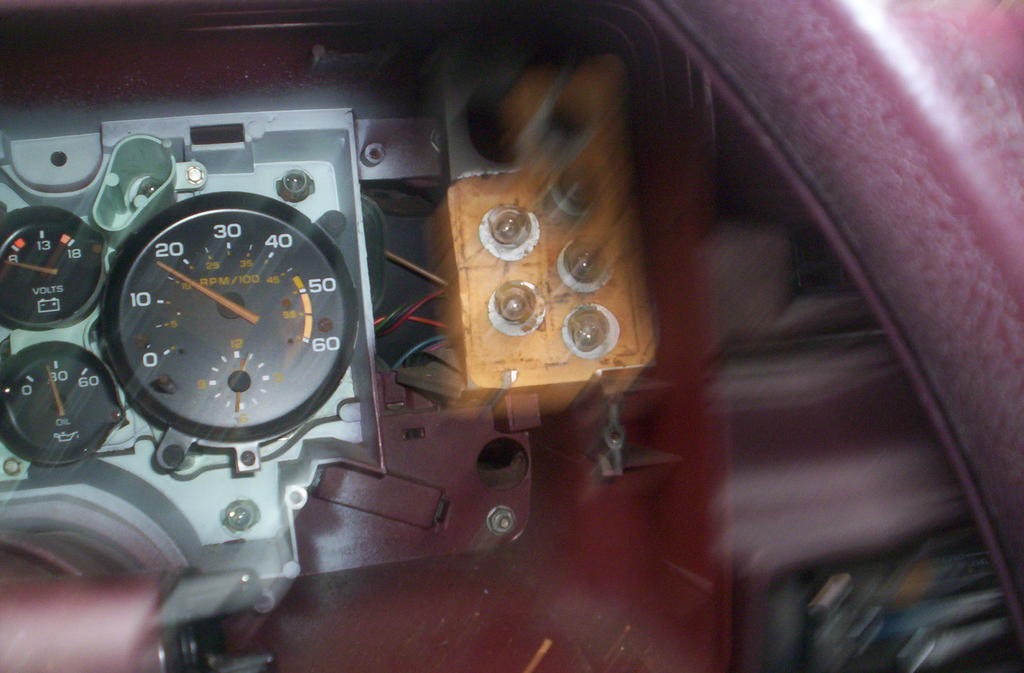

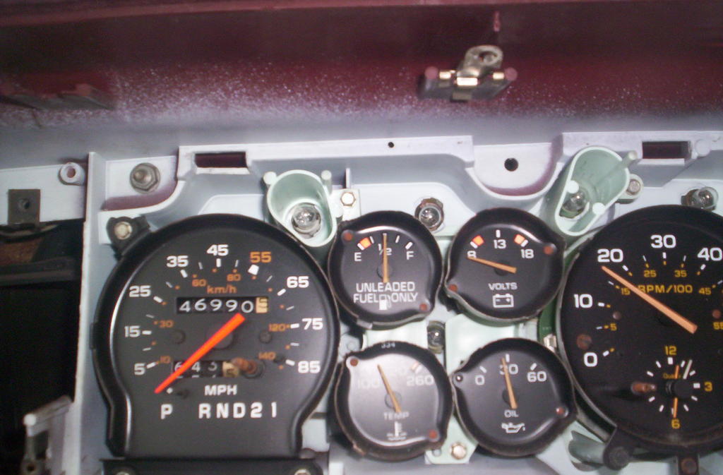

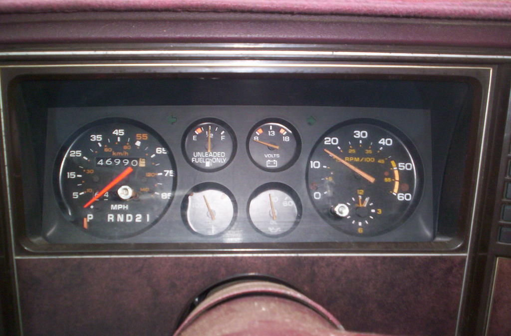

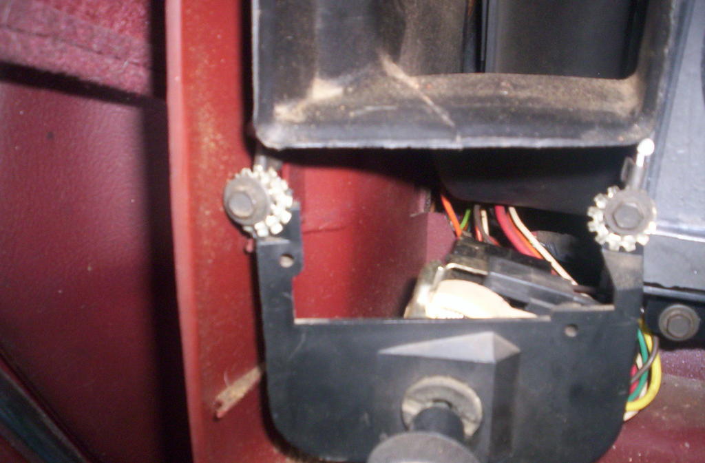

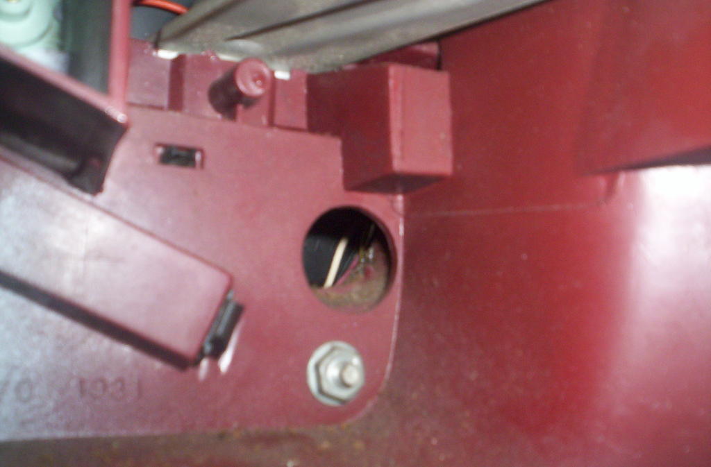

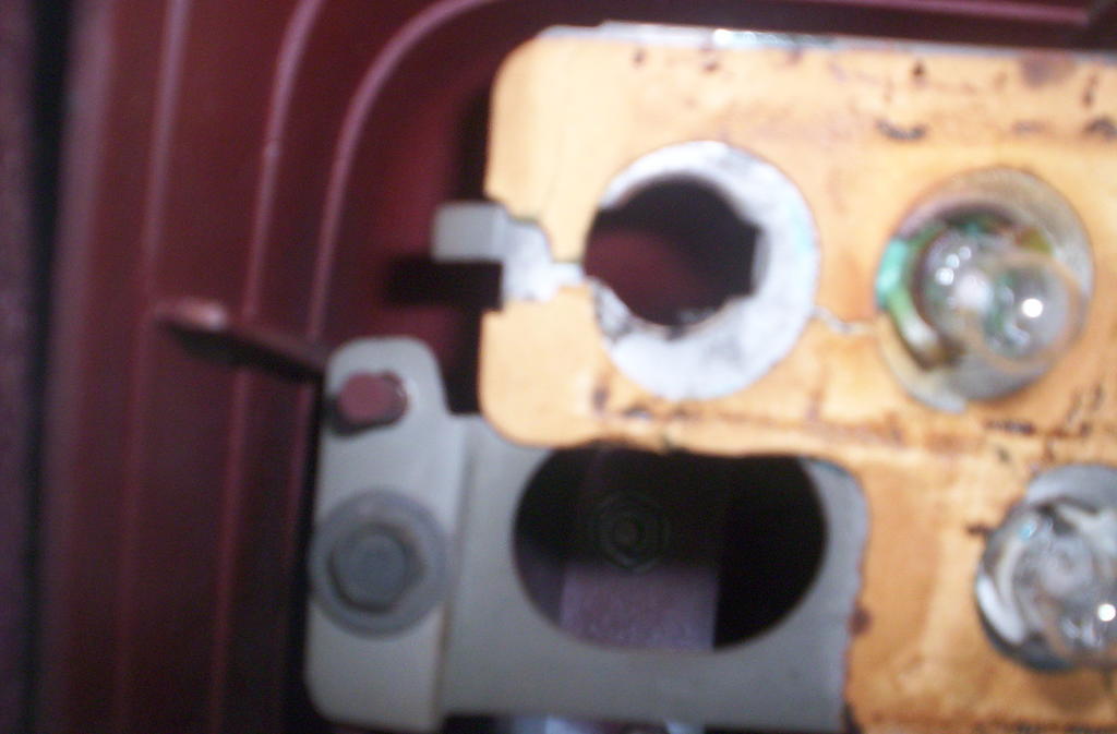

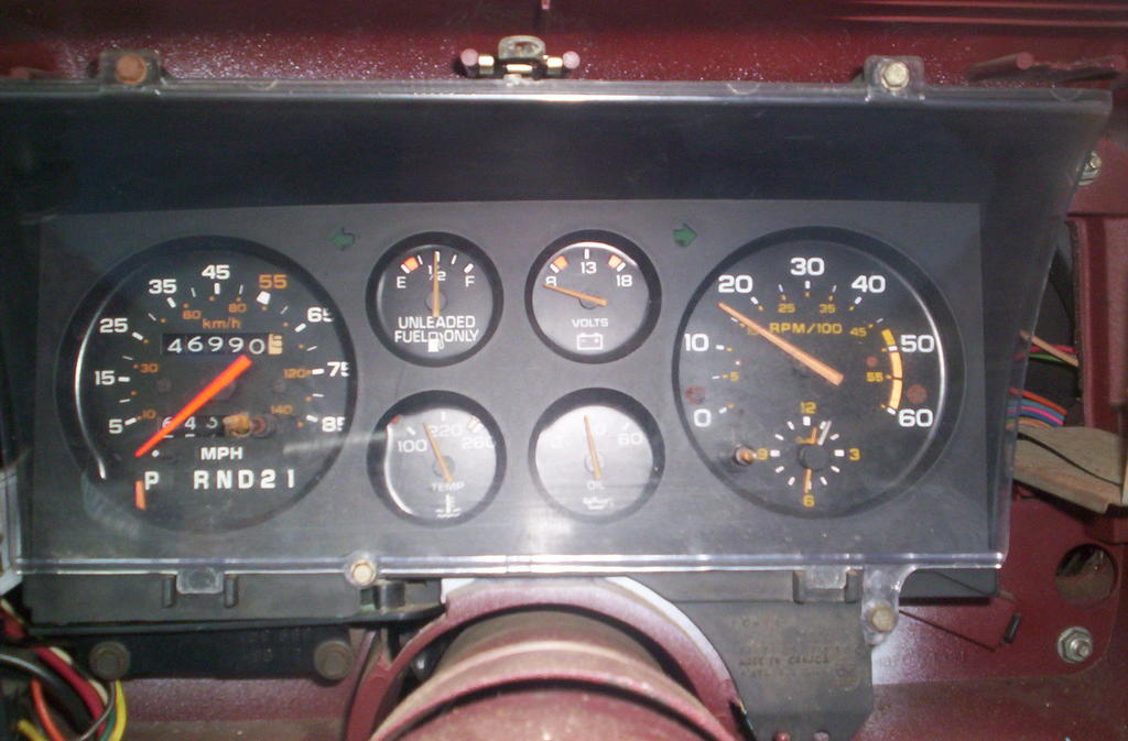

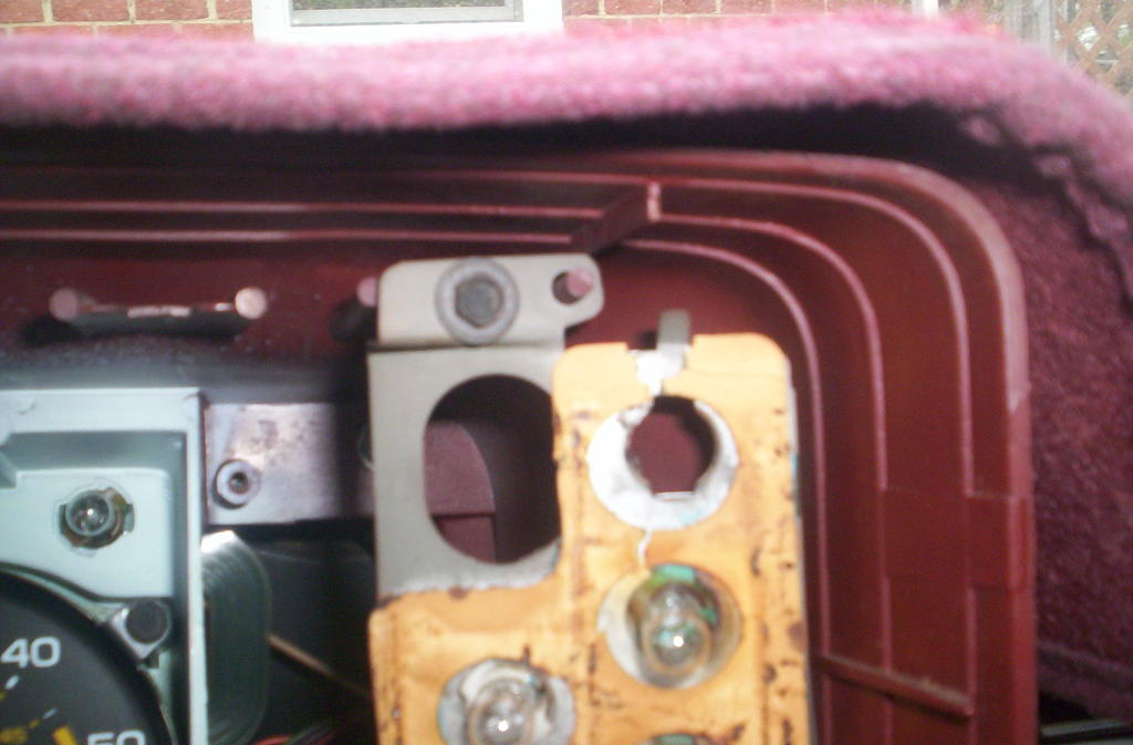

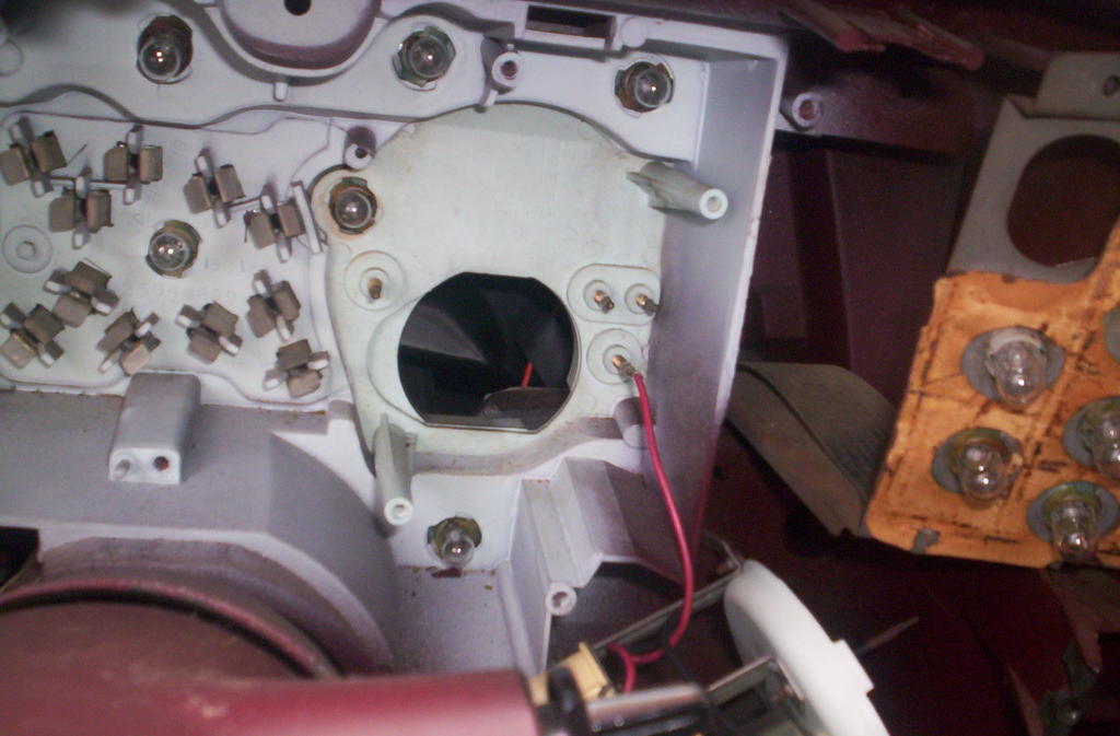

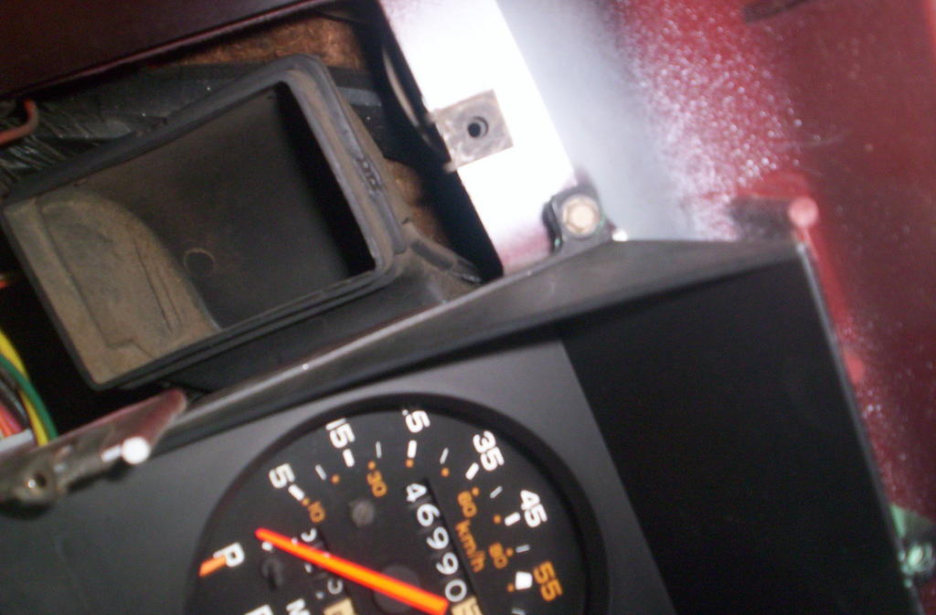

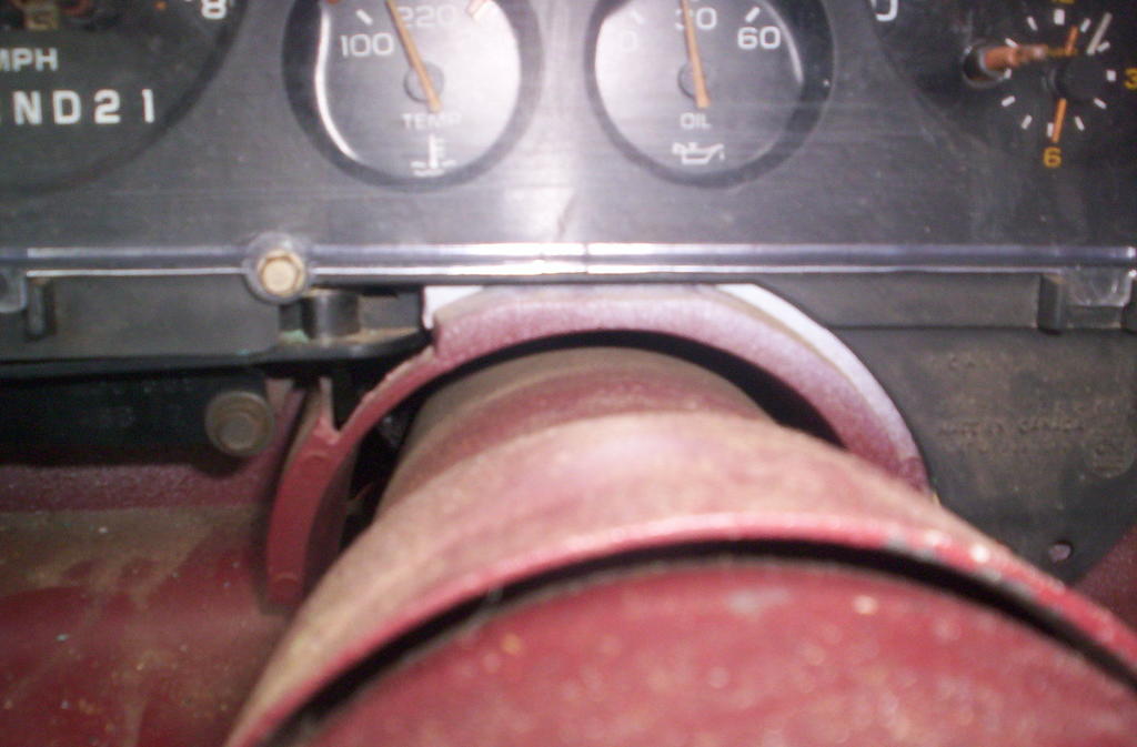

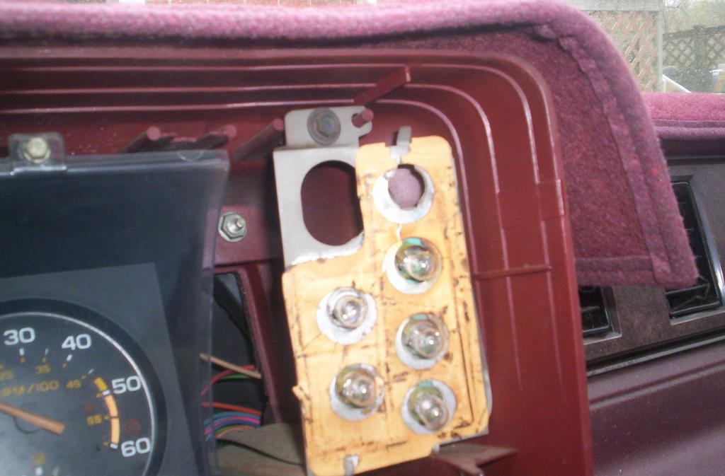

elcamino/wheelhorse 9,363 #1 Posted March 31, 2020 I decided today to remove the instrument cluster from my 1984 El Camino . I took pictures of each step for your view pleasure . I am not sure they are in order since I am still trying to figure Windows 10 . The goal of the removal was to find the item number of the printed circuit , so a new one could be ordered . Don't laugh to hard Skunky @squonk and @DougC . It a long 2 hour battle with metric and standard screws. Has anyone used a plastic welding do hickey from HF ? Yes there are breaks and cracks in the 36 year plastic. 8 1 3 Share this post Link to post Share on other sites

elcamino/wheelhorse 9,363 #8 Posted April 1, 2020 @WVHillbilly520H That is where some of the parts came from . Can't find NOS or good used stock . Took about a month and 1/2 to gather parts mainly due to costs. The 4 small gauges over $50.00 each with shipping. The new circuit for the TACH was $50.00 , plus new wire with condenser to TACH was $55.00 , bulbs was $65.00 and 14 bulb holders was about $40.00 . Going to use same old speedo. The printed circuit for the cluster was about $140.00 Hope the wife does not read this.Ha Ha You think 520 wiring is a pain, the El Camino is a whole worst. 2 Share this post Link to post Share on other sites

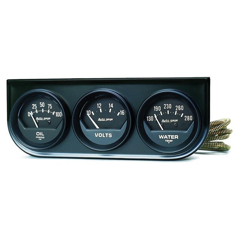

ZXT 2,401 #9 Posted April 1, 2020 56 minutes ago, elcamino/wheelhorse said: @WVHillbilly520H That is where some of the parts came from . Can't find NOS or good used stock . Took about a month and 1/2 to gather parts mainly due to costs. The 4 small gauges over $50.00 each with shipping. The new circuit for the TACH was $50.00 , plus new wire with condenser to TACH was $55.00 , bulbs was $65.00 and 14 bulb holders was about $40.00 . Going to use same old speedo. The printed circuit for the cluster was about $140.00 Hope the wife does not read this.Ha Ha You think 520 wiring is a pain, the El Camino is a whole worst. Man, that adds up quick! Were they all bad or are you just changing them since you're in there? Before I put $560+ into a stock instrument cover, as ugly as they are, I'd have to go for this $20 fix 2 Share this post Link to post Share on other sites

elcamino/wheelhorse 9,363 #15 Posted April 1, 2020 13 hours ago, ZXT said: Man, that adds up quick! Were they all bad or are you just changing them since you're in there? Before I put $560+ into a stock instrument cover, as ugly as they are, I'd have to go for this $20 fix The gas gauge was iffy and the tach was acting crazy , some of the bulbs were blown. Figured if I was going to tear apart to replace bulb might as well replace all of them. 1 1 Share this post Link to post Share on other sites

squonk 45,652 #24 Posted April 1, 2020 3 hours ago, elcamino/wheelhorse said: 146990 on the speedo EEEEWWWW!!! BETTER GET THAT CHANGED PRONTO! 1 Share this post Link to post Share on other sites
