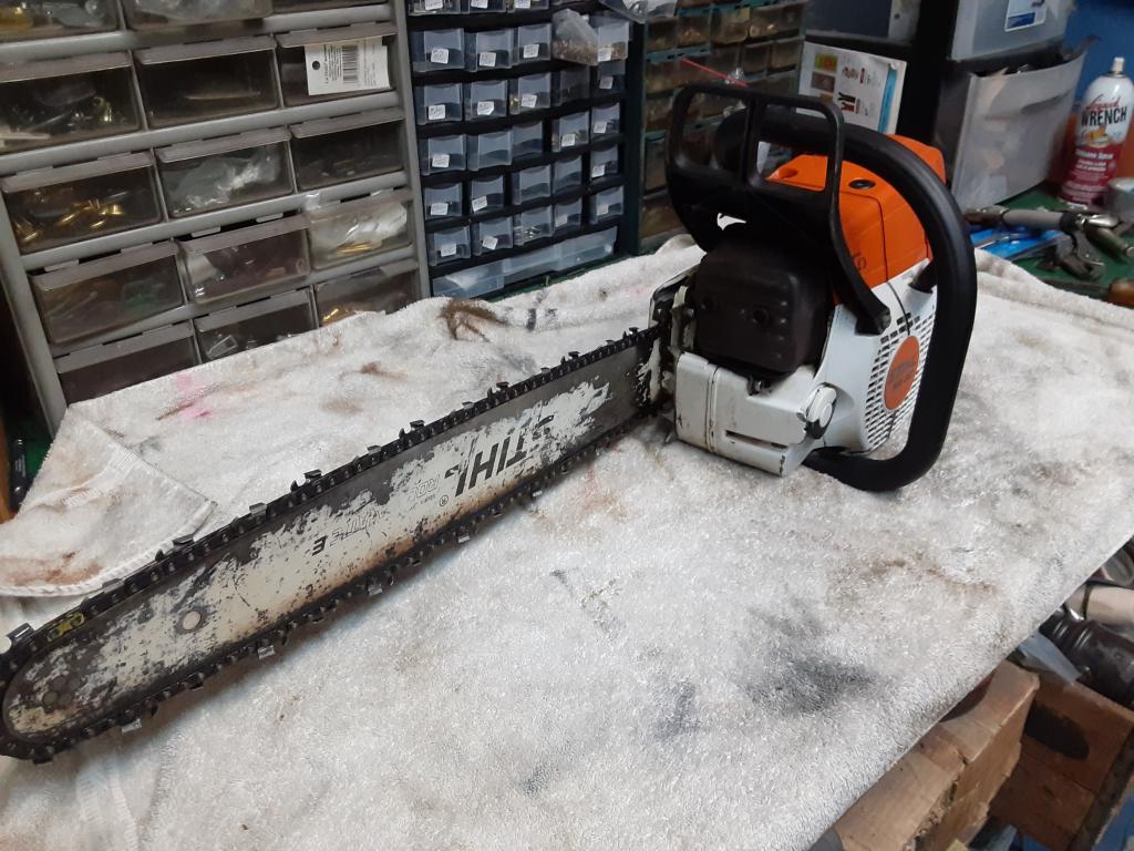

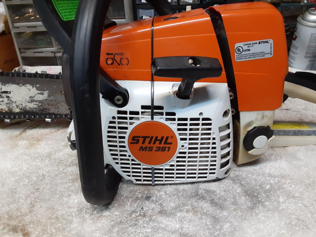

D_Mac 9,337 #1 Posted February 19, 2020 I went to purchase a generator from a fellow on craigslist and wound up purchasing a couple other items as well as the generator. One of the items was a Stihl MS 361 chainsaw. All I know about chainsaws is that I heard Stihl makes a good saw. After bringing everything home I wanted to do a little research on chainsaws and it just left me more confused. Trying to compare one saw from another or even one model Stihl saw from a different model Stihl saw. For some reason I just cant seem to tell them apart aside form bar length and engine displacement. I cant seem to follow the power to weight ratio thing. I am thinking this saw is more saw I would ever need. My thinking has always been better too much then too little. Any ones input on chainsaws I would like to listen too. Share this post Link to post Share on other sites

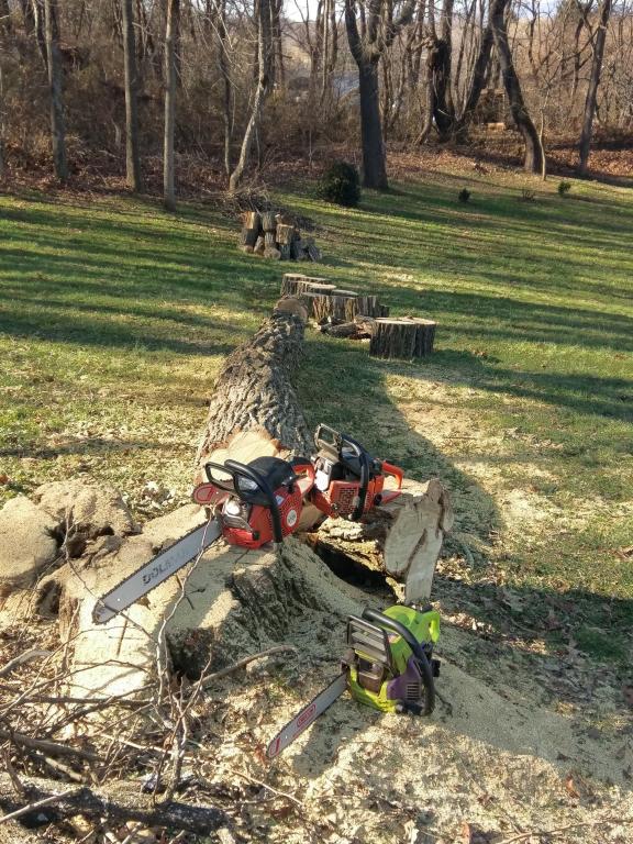

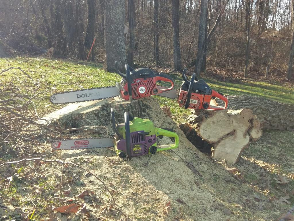

WVHillbilly520H 10,378 #3 Posted February 19, 2020 IDK if my opinion will be shared but if you got that saw fairly cheap (price you were very comfortable with) then like Eric said above get a 18-20" bar and chain and use it when you need it or trade it for something smaller and better suited to your needs, I have 2 Dolmar saws 1 18" 1 20" bar and then a Poulan Wildthing with a 14" bar does everything I need to do kinda like the horse one for each unique job. 3 2 Share this post Link to post Share on other sites
D_Mac 9,337 #4 Posted February 19, 2020 The saw came with a 20 inch bar. Bar looks beat up but it is straight. I thought about changing it to an 18 inch. I dont have a use for it at my property but from time time I need one at my mothers house. Not to take down trees or cut firewood but to clean up branches and limbs that fall from wind or ice. Its my understanding the saw will take 18 - 24 inch bar. It seems to run really well. I havent tried cutting anything with it so I am not sure how sharp the chain is. I dont know of any cleaning or maintenance I should do to it now other then the bar and chain. I got what I think is a great deal on the saw but as I said earlier I dont know anything about them. If the saw wont get a lot of use do you store them with or without gas in the tank? Any recommendations as to what to look for on it before I use it or make any changes to it? I just opened the back and cleaned the air filter off and thats it so far. 1 1 Share this post Link to post Share on other sites

D_Mac 9,337 #7 Posted February 19, 2020 Well maybe I will take it somewhere to have it checked out and tuned. Its cold up here in NY and I have had no trouble starting it. Fires up after a few pulls. The guy I got it from bought it brand new but as you can see from the photos its had its use. I got the saw, a generac 5000w generator, and a brand new mossberg turkey gun for $300 so I believe I did well. Zero use for the bird gun as I dont hunt but I would have paid the 300 for just the saw and generator. He told me he always used non ethanol gas in both. I always use it on all my small engines plus sta-bil fuel stabilizer. Thanks for the tips and advice. I like to listen to what everyone has to say, especially with things I have no experience with. 2 1 Share this post Link to post Share on other sites
ebinmaine 79,570 #8 Posted February 19, 2020 Wow! I would say you did all right. I'm no expert but I think EACH one of those things by itself is worth what you paid for the total of the three. As cold as it's been lately and if that thing is starting and running okay I don't know that I would do much of anything with it. Make sure when you mix your oil you are a little heavy on the oil side if anything. How often to get the chain sharpened depends what you're cutting. It's important to try to avoid cutting dirt. I can tell you from experience my saws are not fond of that. Normally I'll do a quick touch-up on the blade after every two or three tanks of fuel... Unless I touch dirt. When I do that I practice all of my expletives and then I go sharpen the saw. 1 1 Share this post Link to post Share on other sites

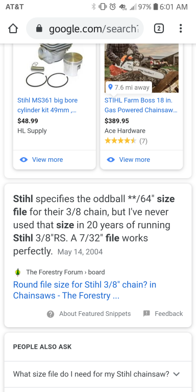

ebinmaine 79,570 #20 Posted February 20, 2020 5 hours ago, D_Mac said: Anyways back to the saw. I watched a video on sharpening chains. I see that I need a round file and a flat file. The video didnt mention the diameter of the round file and didnt mention the cut of either the round or flat file. I believe he was filing the teeth at a 30 degree angle but I think that depends on the chain? Said some chains have a small mark on the tooth to help with the angle File size is dictated by chain size. The small engine repair shop can tell you which you need. Most chains are sharpened at 30 or so. Yes. Also info the same shop will tell you. The mark on the chain teeth is a Max wear mark. There's a LOT of information out there. Don't let it overload you. 1 Share this post Link to post Share on other sites
WVHillbilly520H 10,378 #21 Posted February 20, 2020 7 hours ago, D_Mac said: Anyways back to the saw. I watched a video on sharpening chains. I see that I need a round file and a flat file. The video didnt mention the diameter of the round file and didnt mention the cut of either the round or flat file. I believe he was filing the teeth at a 30 degree angle but I think that depends on the chain? Said some chains have a small mark on the tooth to help with the angle? I never use the flat file (that is referred to above @pullstart about the rakers) by the time I get there the chain is usually done for me... Yes there is marks on on the teeth of the of the chain (Oregon) that 1) shows the appropriate angle you should try to follow while filing and 2) like Eric said max wear as the slot gets larger as you file you may also notice that the file cuts the drag links as well as the tooth this is from excessive down pressure on the file it all takes time and practice. 2 Share this post Link to post Share on other sites

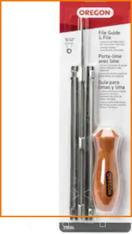

D_Mac 9,337 #24 Posted February 21, 2020 Well I know I dont have any round files so I will make a trip to Lowes and I will pick up a 7/32 file. I will practice on the chain thats on the saw now. I will always pick up a new chain just in case. As long as I am there I will price out a 18 inch bar and a chain. Called a gun shop today and I was told I didnt do anything wrong in purchasing the Mossberg but in order to resell it legally The buyer needs to find a gun shop that will do the background check. The state says they cant charge more then 10 dollars to do it but since its not worth the time to do it for only 10 bucks most gun shops dont do it. Some of the ones that do will charge and extra 15 bucks and call it a " safety inspection" . The shop I called dosnt bother with any of it unless of course you are buying the firearm from them. So looks like I am going to have to make a few more calls. Option two is sell it as is not registering it in my name since the new owner would have to go through the entire process all over again. Kinda of like jumping titles on a car. Anyways I thank you all for the help and info on the saw. I cant wait till a tree limb comes down at my mothers house to use it !!! While I am at Lowes I will pick up a 2x4 just to test it out. Oh I looked for cases on the internet.... Anyone have one of those nylon bag type case or stay with the hard plastic case? Share this post Link to post Share on other sites
ebinmaine 79,570 #25 Posted February 21, 2020 10 minutes ago, D_Mac said: make a trip to Lowes and I will pick up a 7/32 file Buy a file kit with file guide. Huge difference in learning to sharpen. Sorta like this.... Share this post Link to post Share on other sites
