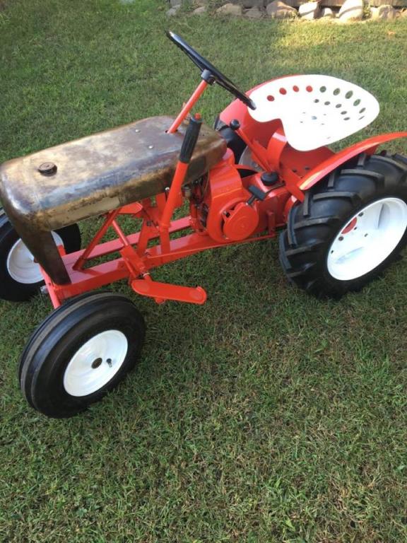

WHX?? 58,054 #51 Posted January 30, 2020 Gotta like this statement... I never painted the hood because people like to use them as little work benches sometimes …. Was he talking about you Kev??? I don't know @bottjernat1 1k ain't the worst but it better be somewhat complete, run good and the tranny needs no work. The foot rests although not correct are quickly becoming rare and command serious $$. Yes please refrain from posting CL links @Willlawre The idea behind that is the mods and members don't want the open forum to become a CL free for all! We let all newbies slide once tho. Any horse pics you happen to find on the internet may be posted for inspection. I like 'Apples suggestion of hunting for a C-160. should be able to find one in your price range. I know I have stupidly passed on a couple of dandies for way less than 1k. A C-160 is beast of a tractor and can handle anything you could throw at it for a chore tractor on your small farm and then some. Attachments are easy find as well. 1 2 Share this post Link to post Share on other sites
WHNJ701 4,173 #52 Posted January 30, 2020 19 minutes ago, WHX24 said: Gotta like this statement... I never painted the hood because people like to use them as little work benches sometimes …. @bottjernat1 @Willlawre I think it's more like he didn't mix enough paint to finish it. it looks out of place and unfinished, i would think it's hurting the value and sale of it 2 Share this post Link to post Share on other sites
Pullstart 71,207 #53 Posted January 30, 2020 1 hour ago, WHX24 said: Gotta like this statement... I never painted the hood because people like to use them as little work benches sometimes …. Was he talking about you Kev??? Yep, that’s why I’d paint an entire tractor and leave the hood bare. Share this post Link to post Share on other sites

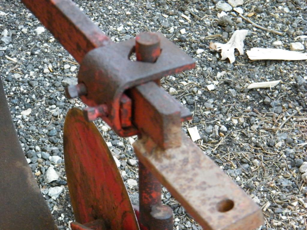

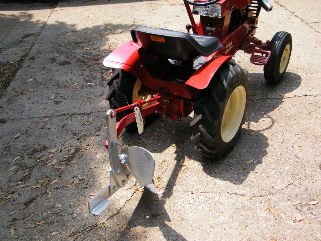

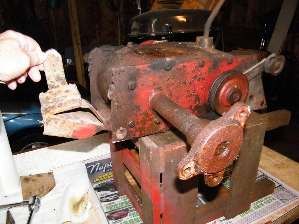

stevasaurus 23,844 #55 Posted January 30, 2020 @Willlawre I'm not sure what you are talking about with this receiver & hydraulic stuff...maybe this. The rear hitch for an RJ looks like this, and it is very possible that a member here may have one on a shelf. A cable is attached to the lift lever and goes to where my hand is holding the receiver. The side plates hold the receiver in place. I don't think I have ever seen hydraulics on an RJ. An HY-2 hydraulic set up came out for the front engine round hoods in 1962 and were available on the 7hsp models. They do make a belly blade and a single blade plow for the RJ's. Yes, they have enough power to do the job, but just know that it is like having a VW 4 cylinder compared to a Chevy with a 427 cu in 8 cylinder. Don't ever feel like you can't ask questions all day on this site. A lot of us just lurk here most of the day waiting to help someone. At times, it is like a race to give the answer first. 2 1 2 Share this post Link to post Share on other sites

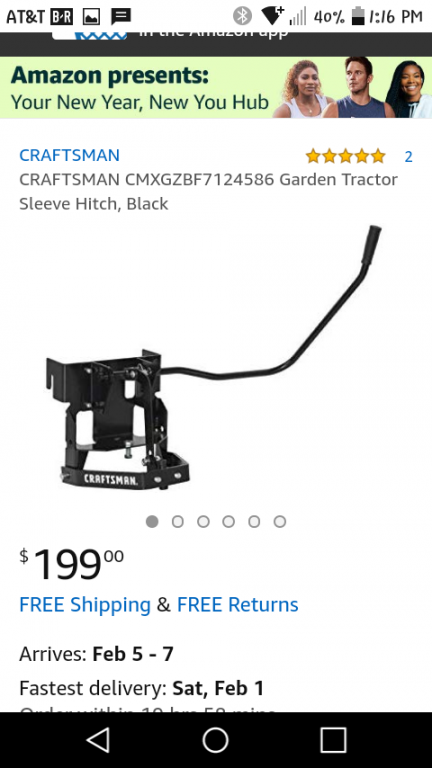

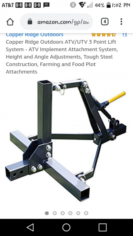

Willlawre 45 #56 Posted January 30, 2020 @stevasaurus I had pmed @Lane Ranger and ask him amd he said there was no rear hyd. And explained the hitch some but maybe I misunderstood. Okay so the rear hitch does have up and down movement with a cable that would be attached to it to make it do so? I thought it was a fixed hitch from what I could see in pictures mind you I've never seen and RJ before. So if it were a fixed hitch I was talking about something like this not quite as large as this one, that I could modify the the attachment to this to fit the RJ hitch and then attach the box scraper or rear garden plow to that. Did I make more sense there? Share this post Link to post Share on other sites
oilwell1415 563 #57 Posted January 30, 2020 I'm new to this stuff as well, but it doesn't sound like you really need hydraulics for what you are doing if you go with an RJ. Just mount a 3 point to the rear and connect a link from the original cable actuated hitch to the 3 point. I doubt any implement you are going to be able to use behind an RJ is going to be heavy enough to need hydraulics to raise and lower. 1 1 Share this post Link to post Share on other sites

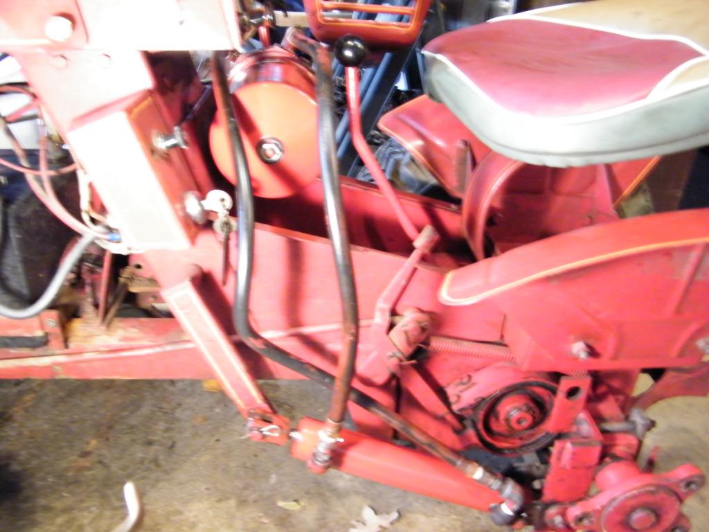

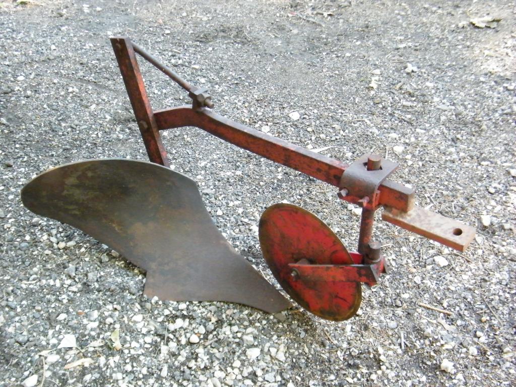

stevasaurus 23,844 #59 Posted January 30, 2020 Lane is correct about the hydraulics. The HY-2 unit, on a round hood, has a tank mounted on the tower and the hoses go down to a piston that is mounted to the transmission (with an adapter) on one end and the rock shaft (lift lever) on the other. You would just need the hitch I posted a pick of. The hitch is not stationary, but is lifted up by the lift lever with the cable. The belly blade would attach under the frame in the middle of the tractor, the garden plow just slips into the hitch and is pinned. You do not need a 3 point hitch on an RJ. The snow blade would attach in the same place as the belly blade. The lift lever would lift any and all attachments either through the rear cable or the rock shaft...they are attached in the same place. 1 Share this post Link to post Share on other sites

Willlawre 45 #61 Posted January 30, 2020 @stevasaurus gotcha now! So I really think the RJ would work for me at the moment I dont have a huge farm at the moment so I believe one would be enough for me until I start working the rest of my land down the road. Then I could go bigger for myself and my kids could putt around on the rj Share this post Link to post Share on other sites

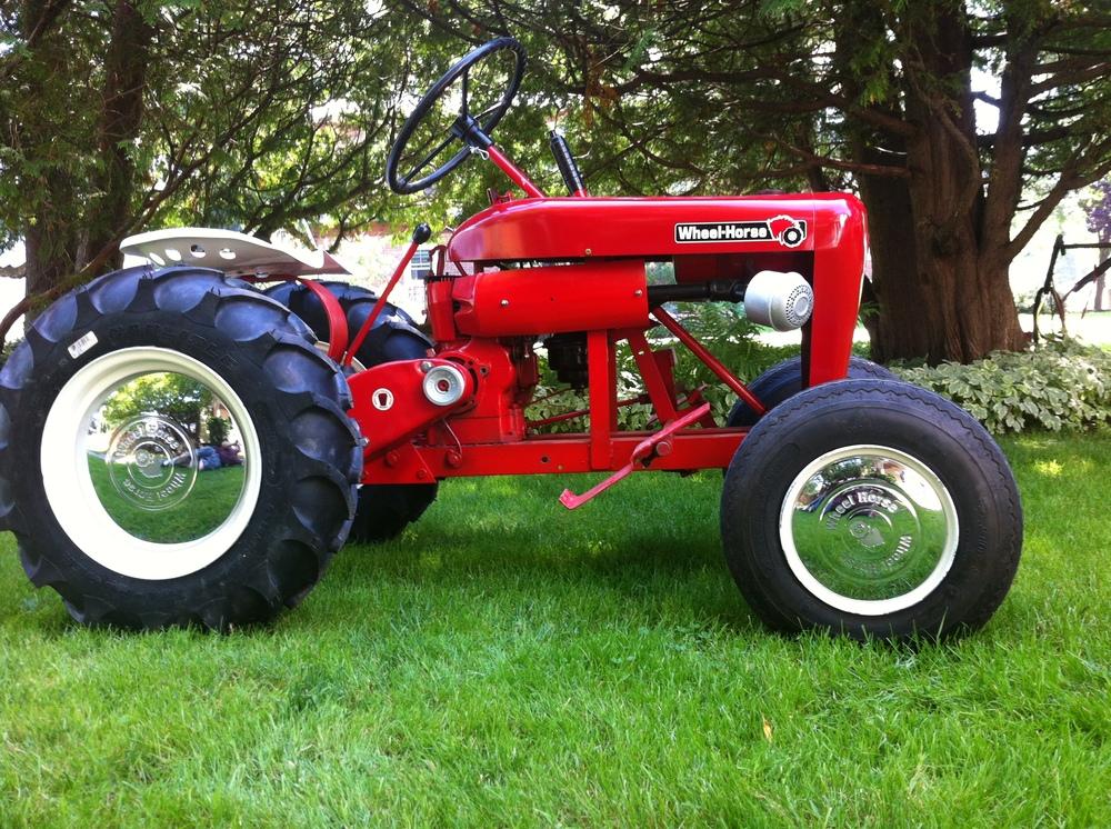

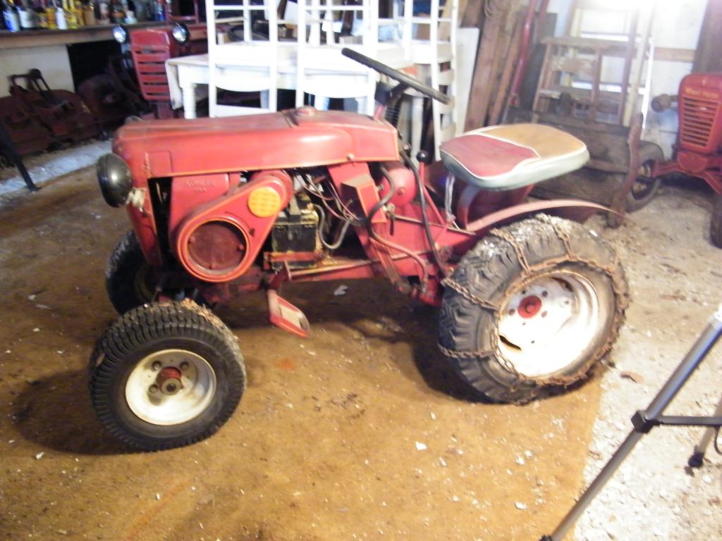

bottjernat1 2,197 #66 Posted January 30, 2020 Here is mine purrs like a kitten. I pushed snow one year just to say i did. no weights on it just my fat butt. i was very impressed. i will have to find the video! 1 2 Share this post Link to post Share on other sites

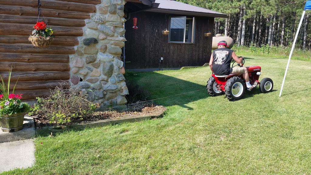

stevasaurus 23,844 #67 Posted January 30, 2020 Here is a video. This is my B-100...10 hsp Kohler. 2 Share this post Link to post Share on other sites
WHX?? 58,054 #68 Posted January 30, 2020 Sounds to me like your falling in love with RJ's Willa.. nothin wrong with that! Front end weighted down you'd be surprised what they can do for a little 4 hp! You do have one nice lookin one Nate.... thanks for the vid. Garden plowed & pulled bushes once with mine just to say I did! 1 Share this post Link to post Share on other sites
Willlawre 45 #69 Posted January 30, 2020 @bottjernat1 @stevasaurus @WHX24 those are all really nice rigs ya got there! @ebinmaine and everyone else in this thread thank you so much for all the help and explaining. I was seriously looking at the 520hc but then found the RJ and was debating between the two. I think the style of the RJ and all of your comments and advise I believe I'm gonna go with an RJ to start out with. I appreciate all of it and in gonna give him a call tomorrow. Talk to wife into taking a ride this weekend have a look. Its only an hour away! Thanks everybody! I will be most most days here now hah 3 Share this post Link to post Share on other sites

WHX?? 58,054 #71 Posted January 31, 2020 (edited) Good man Willa ... sounds like you got your heart set on an RJ ...so be it! Don't worry about the no hood color. .that's just paint. He might deny it but @pullstart uses hoods for welding tables! Look it over good. Lift up the rear, they are very light, and check for any movement up and down in the axles. Check for weeping seals in the tranny. Ask the seller to start it and look for smoke. Don't be too surprised if ther is some on startup. Gotta remember this is a 50+ YO tractor. Run it thru the gears seller allowing . Grille the seller like a sammich on what he knows about it and what he might have done to it. Scope out his facilities if possible just to clue yourself in on his mechanical abilities and if things have been just thrown together or the seller really has shown it some love. Ask him if he is a member here and uses our advise. ... heck maybe we even know him ..small world ya know. These and many more things are just dickering points. Don't lowball and offend the seller but don't overpay. An RJ unless it was well loved is not really the kind of tractor to do well unless it was loved. You mentioned earlier you would prefer to have a tractor you did not want to do alot of work to ... make sure that holds true. Don't be afraid to pass if things don't feel right, plenty of other horses in the pasture, and just chalk it up to a nice ride with the missus. Good luck and keep us posted. Edited January 31, 2020 by WHX24 1 2 Share this post Link to post Share on other sites
The Tuul Crib 7,354 #72 Posted January 31, 2020 6 hours ago, stevasaurus said: Here is a video. This is my B-100...10 hsp Kohler. That is one BIG city block !! Enjoyed the ride!! Thanx 1 Share this post Link to post Share on other sites

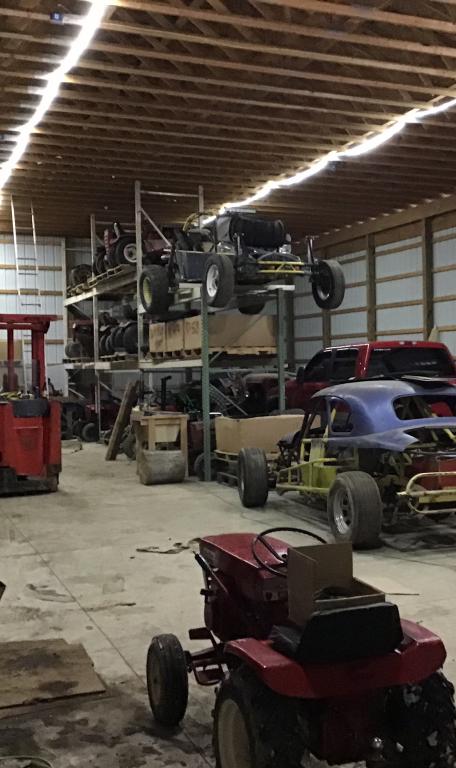

Pullstart 71,207 #73 Posted January 31, 2020 @Willlawre don’t listen to Jim @WHX24 about me... he’s got enough spare hoods he could send us all a welding table for our birthdays! Best of luck with your travels and decisions! My 502 was my first Wheel Horse, I bought it just to mow my lawn, not knowing a thing about this site or vintage tractors at all. Now between myself, my two daughters and my wife, we’re at some 16 and store them in racking... If you’re this into the old Wheel Horses and want a real fun time, block out June 25-27 and we’ll see you at the Big Show, in Arendtsville, PA just outside of Gettysburg. There’s good deals galore and all kinds of show happenings! 3 1 Share this post Link to post Share on other sites
