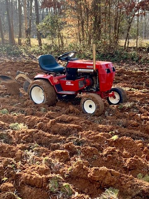

Greentored 3,221 #26 Posted January 24, 2020 9 minutes ago, pullstart said: I’ve been told by the plow veterans that you only go half as deep as the size of the plow... Normally it’s good to plow in 2nd gear... unless you’re from MN then you go third gear wide open... @wheelhorseman Lowell and Travis! I ran the engine about 3 grand and pinned the hydro lever on a couple passes and it laid the furrows over nice! Actually, that was an attempt to make that onan grunt but it never broke a sweat. Work was getting done too fast, had to slow down before the entire property got plowed haha. 1 5 Share this post Link to post Share on other sites

Pullstart 71,482 #30 Posted January 24, 2020 I missed the video until @Rob R mentioned the sound... that hood is so perfect! Looks better than new! 1 Share this post Link to post Share on other sites

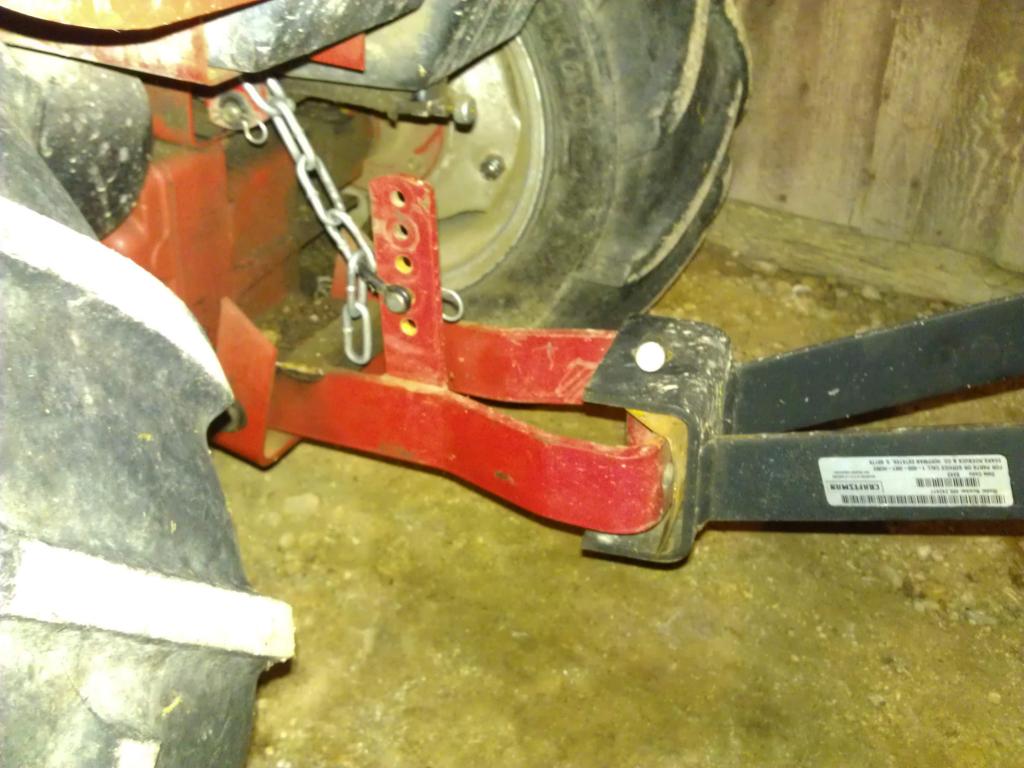

WVHillbilly520H 10,379 #31 Posted January 25, 2020 @Greentored, here's a better picture of my drag link mod... I added 3 extra holes not 4. 2 Share this post Link to post Share on other sites

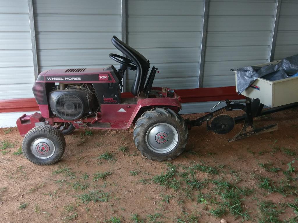

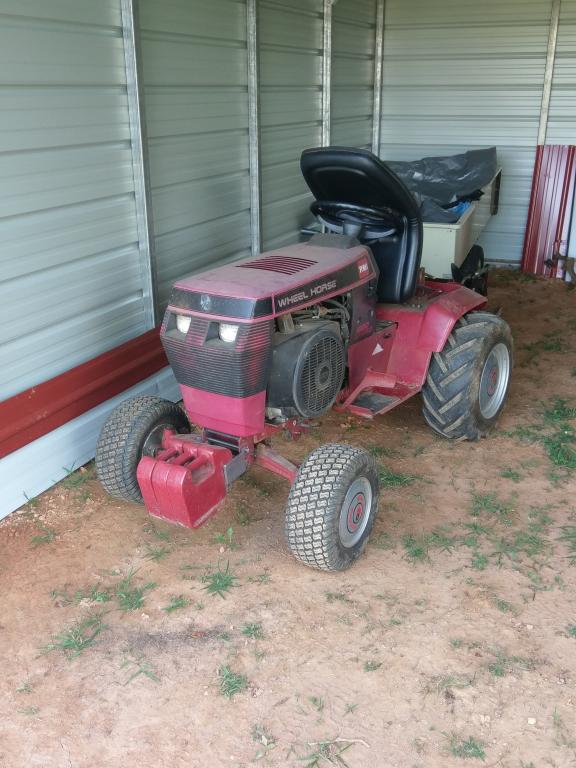

WVHillbilly520H 10,379 #33 Posted January 25, 2020 @Greentored here's a pic of the weighted box blade and my 520 outfitted turn sod... 2 Share this post Link to post Share on other sites
