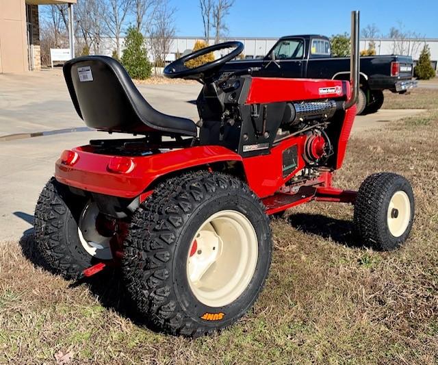

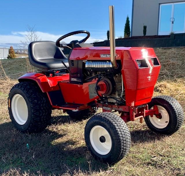

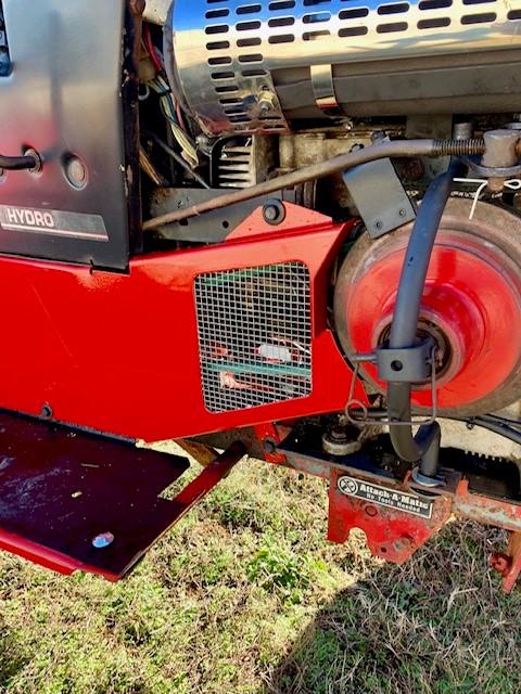

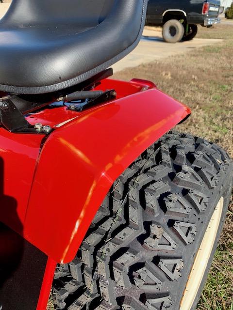

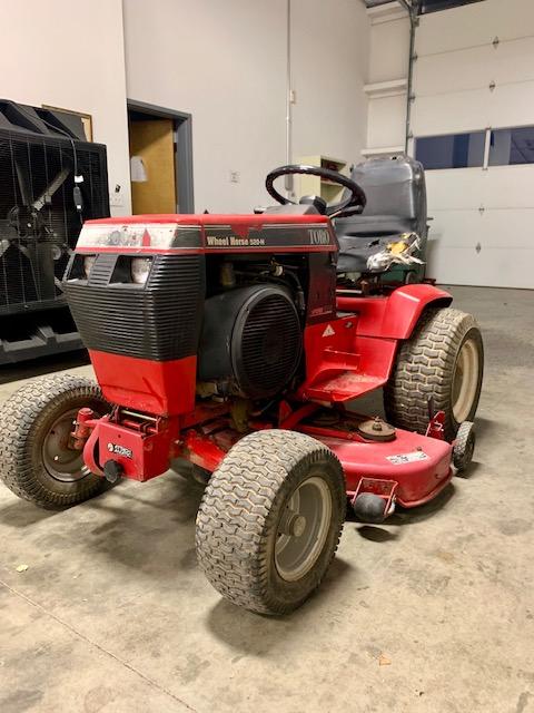

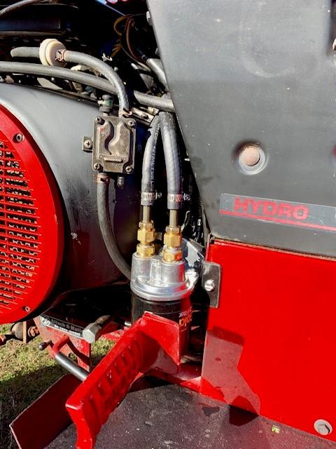

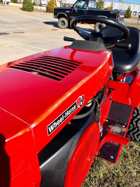

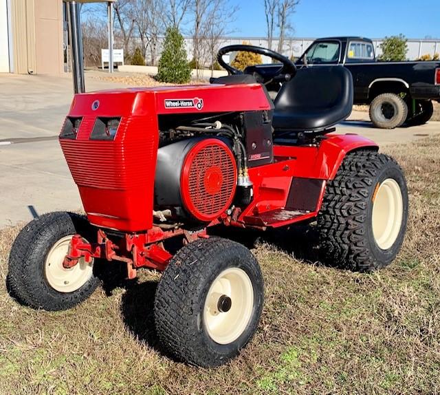

Greentored 3,221 #1 Posted January 12, 2020 For those who didnt catch the other restoration thread- this is my first red tractor, and first tractor restoration. I did not go TOO crazy, as this baby is going to get used as it should. Attempted to make it look like an older horse, and tried a little mild patina as well. BIG THANK YOU to you folks here who helped me along, especially when it came to research and mods to keep that big Onan cool down here in the south. It now has an oil filter relocation, belt guard vent, and blocked off air intake tube in the shroud. This was a lot of fun, and have a feeling it wont be my last Horse in the stable. How did I do for a tractor noob? 4 16 Share this post Link to post Share on other sites

edgro 680 #3 Posted January 12, 2020 The all red hood gives it a good look! Good job Share this post Link to post Share on other sites
Ed Kennell 47,751 #4 Posted January 12, 2020 Yep, all red and almond wheels. My favorite colors. Nice job and she looks anxious to go to work. Any chance to hear a video of that stacked Onan? 1 Share this post Link to post Share on other sites
Pullstart 71,482 #5 Posted January 13, 2020 Looks great! Share this post Link to post Share on other sites

peter lena 10,103 #10 Posted January 15, 2020 greentored, excellent ! your subtle detailing was what did it for me , the combination of wheel horse parts ,making it all come together. while i can understand making anything a show queen , its your practical view and common sense that really stands out. your work looks a lot like what i would do with the same issues , thanks for the pictures , pete 1 Share this post Link to post Share on other sites

WHX?? 58,326 #16 Posted January 24, 2020 Real nice Green... the red mask kinda grows on ya and the red intake really pops! I wanted to do that to one of mine but it was too busted up to stick time into so I just painted the screen behind it and thought that was the cats meow! You would like one of Matt's pedal kits. Guy with your talents could probably make his own. Ive also got seats like that on a couple of tractors ...they're a little firm but plant one's butt firmly for good control.... real nice 1 Share this post Link to post Share on other sites
Greentored 3,221 #17 Posted January 24, 2020 Thanks WHX! Wasnt sure if it would look ok or not (those black mask tractors ARE pretty sharp) but it grew on me fast. Good ole Tractor supply 45.00 seat, yep it works. 1 Share this post Link to post Share on other sites

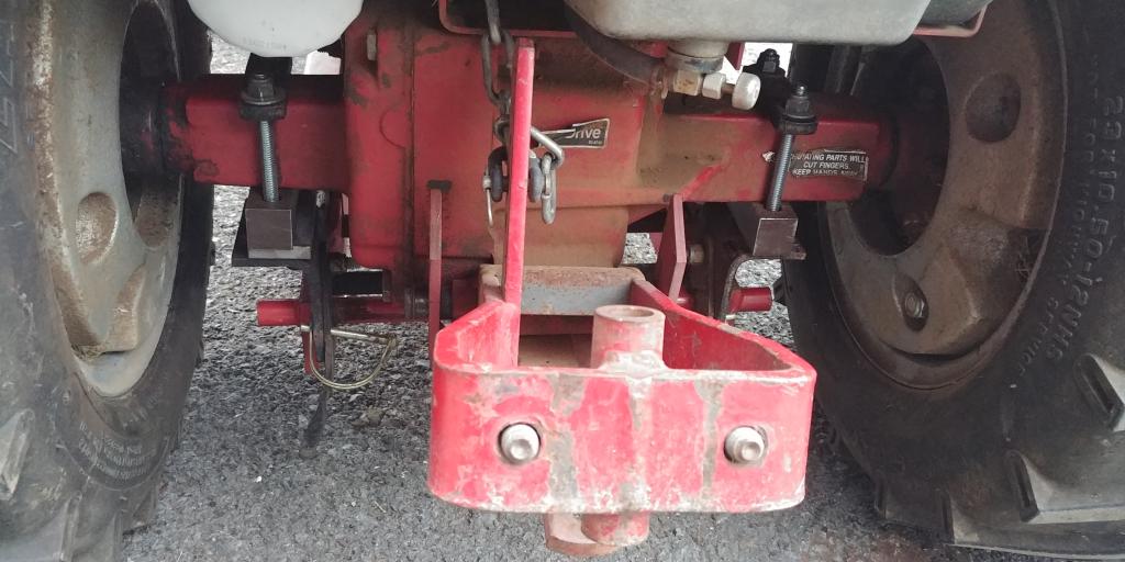

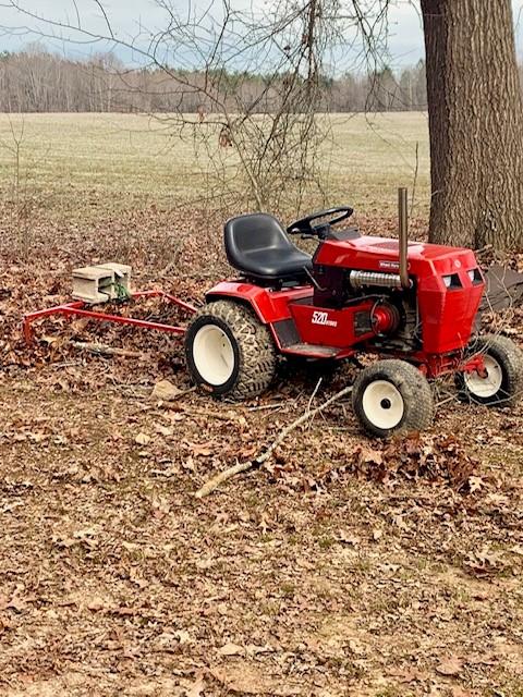

Greentored 3,221 #18 Posted January 24, 2020 Took yesterday afternoon off and put her to work for the first time. Drag is a home built piece for clearing brush out of the hedge rows, it works but needs more tines. First time ever running a plow on my own, so thats off the bucket list too. I cant get over the torque that big Onan has, my God I couldnt even make her snort a little. The rear tires bit excellent and the front end stayed on the ground, no doubt 18 gallons of washer fluid helped with that. Only thing I can think to whine about is that sleeve hitch design. Sure isnt much travel, is there? I had to adjust it so the plow share point was pretty much scraping the ground in the full 'up' position in order to get the depth I needed, and still didnt quite get down as far as I wanted to. I have a real good understanding of how linkage/mechanical advantage works. Can I punch a new attachment hole in the rock shaft and/or hitch for more travel, and will the lift cable be able to handle that extra strain? 2 Share this post Link to post Share on other sites
WHX?? 58,326 #19 Posted January 24, 2020 3 hours ago, Greentored said: cant get over the torque that big Onan has, Yes nothing like the power of a good running Onan. Sometimes a bugger to get running right when they aren't and that's why they have a love/hate relationship here. The lift cable will handle the load but I don't' think that more travel is is going to help. Put up a pic of your hitch work. You get a 6 to 8 inch furrow depth your in the money. looks like you weren't getting a good roll tho. Maybe a tad higher ground speed?? and the mold board should have a mirror finish. Looks like wetter soil and surprised you didn't have traction problems with the caked tires?? @PeacemakerJack @Achto @Shynon @prondzy calling all plow dogs.... anything to add? Share this post Link to post Share on other sites

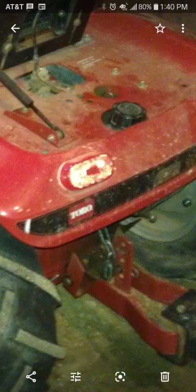

WVHillbilly520H 10,379 #20 Posted January 24, 2020 5 hours ago, Greentored said: Only thing I can think to whine about is that sleeve hitch design. Sure isnt much travel, is there? I had to adjust it so the plow share point was pretty much scraping the ground in the full 'up' position in order to get the depth I needed, and still didnt quite get down as far as I wanted to. I have a real good understanding of how linkage/mechanical advantage works. Can I punch a new attachment hole in the rock shaft and/or hitch for more travel, and will the lift cable be able to handle that extra strain? I know it's not the best pic but I just added 4 more holes down the drag arm on the hitch now I can vary it with the clevis or the chain or the rockshaft or combination there of... 2 Share this post Link to post Share on other sites
Greentored 3,221 #21 Posted January 24, 2020 (edited) WHX Oh hell, the moldboard had a pretty good coat of surface rust, I just let the dirt shine it up. Between that and being thrilled watching this dig with no effort, no doubt my ground speed was too slow- the furrows certainly arent arrow straight haha. The soil is a little damp, and actually we have a good couple months before its planting time, just couldnt stand waiting til then and had to try it out. This will most likely be turned again and disc'd up. Id say she was going down about 6", is that all I should expect? Thanks for tagging the guru's- Will take all the advice (and possible ball busting) I can get- A-1 plow virgin here Edited January 24, 2020 by Greentored 1 Share this post Link to post Share on other sites
Greentored 3,221 #22 Posted January 24, 2020 2 minutes ago, WVHillbilly520H said: I know it's not the best pic but I just added 4 more holes down the drag arm on the hitch now I can vary it with the clevis or the chain or the rockshaft or combination there of... Bingo! No issues with the extra strain on the lift cable? Picks a plow right up? 1 Share this post Link to post Share on other sites
WVHillbilly520H 10,379 #23 Posted January 24, 2020 Just now, Greentored said: Bingo! No issues with the extra strain on the lift cable? Picks a plow right up? Same cable since 1998/9.... No issues yet plus I have and 80-100# box blade I use as well. 1 Share this post Link to post Share on other sites

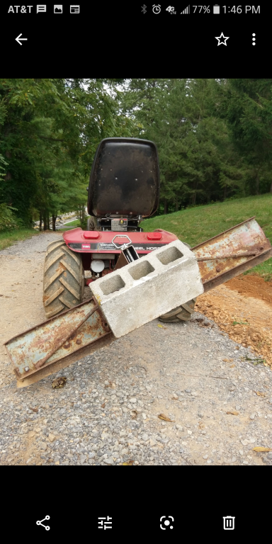

Greentored 3,221 #24 Posted January 24, 2020 Holy crap! and I was worried about putting that single concrete block on that 20lb brush rake I made. I need to give those cables a little more credit, eh? 1 Share this post Link to post Share on other sites
