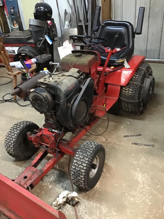

WHX?? 58,308 #32 Posted December 14, 2019 Yer such a hoot Richie. .. Nice to hear they got back to you Caddy... keep us posted on her efforts... bet she gets it done faster than Kev's @pullstart projects! 1 1 Share this post Link to post Share on other sites
Pullstart 71,466 #33 Posted December 14, 2019 Priorities, man! Carb’s cleaned, oil’s fresh, transmission is next! 7 Share this post Link to post Share on other sites
