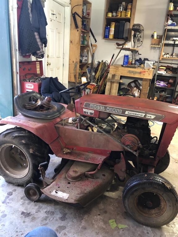

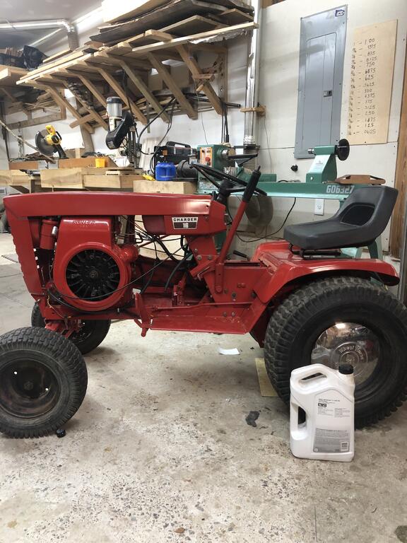

The Tuul Crib 7,354 #1 Posted November 26, 2019 So since I picked up these two charger 10s I brought the better one of the two in the shop and started to take things apart. By looking at it with all the grease that is on this tractor and the fact that it was kept inside it has no rust whatsoever. I took the dipstick out of the transmission and it had bright red fluid in it . This should be an easy cleanup and a patina machine is underway ! 2 8 Share this post Link to post Share on other sites

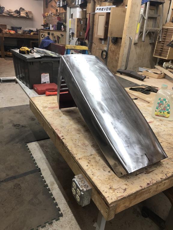

The Tuul Crib 7,354 #7 Posted November 27, 2019 I did the hood some already with wd 40 and some 360 grit l have and it doesnt look bad at all! Share this post Link to post Share on other sites

tom2p 2,396 #9 Posted November 27, 2019 anyone use scotchbrite pad instead of wet sandpaper ? I often use scotchbrite pad and WD-40 on metal surfaces ... unpainted motorcycle exhaust pipes ... etc ... scotchbrite pads are available in different levels of abrasiveness might work well on the Wheel Horse body parts ??? 1 Share this post Link to post Share on other sites
WHNJ701 4,173 #10 Posted November 27, 2019 1 hour ago, tom2p said: anyone use scotchbrite pad instead of wet sandpaper ? I often use scotchbrite pad and WD-40 on metal surfaces ... unpainted motorcycle exhaust pipes ... etc ... scotchbrite pads are available in different levels of abrasiveness might work well on the Wheel Horse body parts ??? I used scotch pads and paste wax on the 701 the following year I wiped all the metal down with old drain oil on a rag and left it sun. it's a sharp looking tractor Share this post Link to post Share on other sites

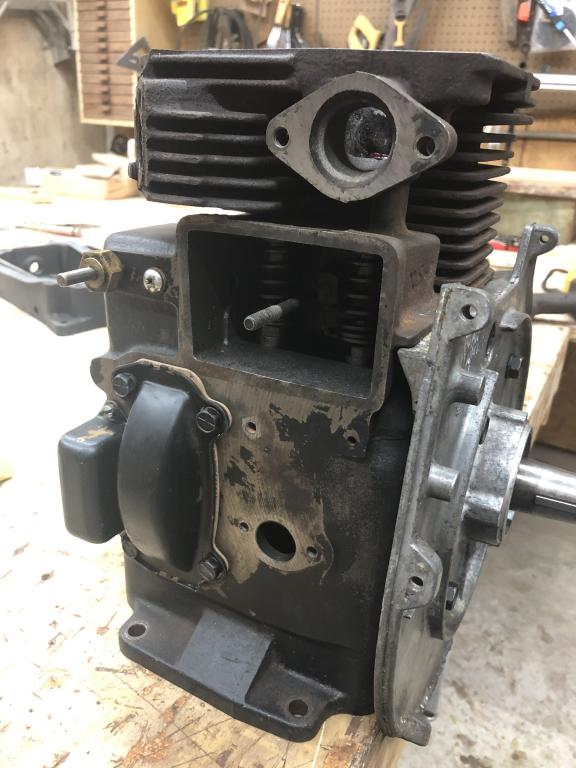

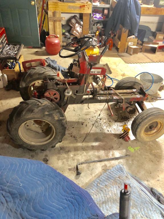

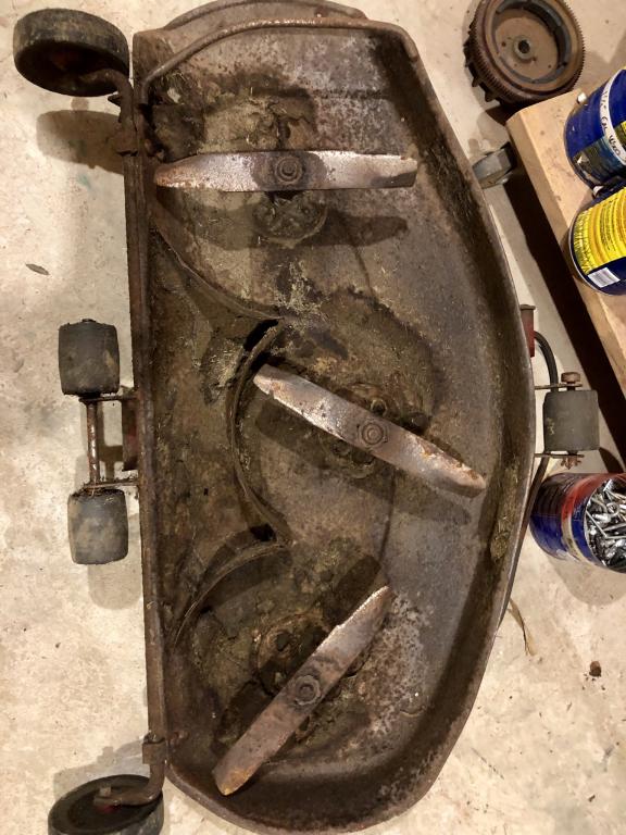

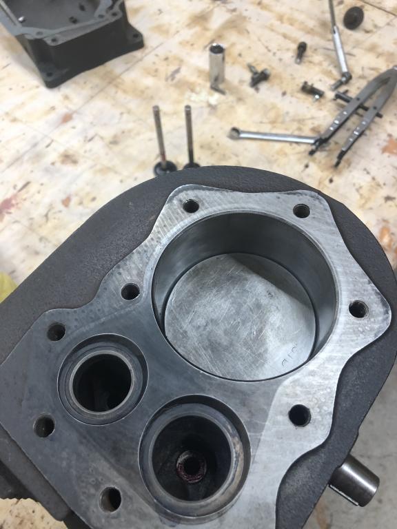

The Tuul Crib 7,354 #14 Posted November 29, 2019 OK so I making a little progress today I tightened up all the internals on this 12 horse. Honed it, new rings, lapped the valves. Should be good to go! I did clean it up some. The tires hold air. The deck for this one is solid. Absolutely no rust so a little clean up there should do it. Might need blades. 1 Share this post Link to post Share on other sites

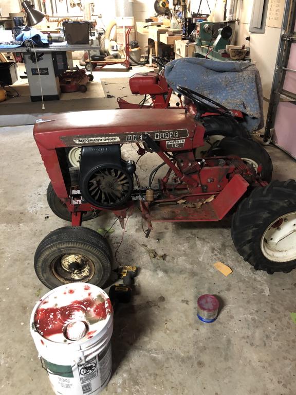

The Tuul Crib 7,354 #15 Posted December 1, 2019 I ended up tearing this tractor apart and today was 55° so I took it outside and pressure washed every piece. Now I've started the process of sanding with WD-40. Going to clear lacquer everything and put her back together ! 3 Share this post Link to post Share on other sites
Pullstart 71,482 #16 Posted December 2, 2019 Make sure to clean that WD40 real good before you spray the clear! Soapy water is a great wet medium too 1 Share this post Link to post Share on other sites
WHNJ701 4,173 #17 Posted December 2, 2019 4 minutes ago, pullstart said: Make sure to clean that WD40 real good before you spray the clear! Soapy water is a great wet medium too fish eyes! 1 Share this post Link to post Share on other sites

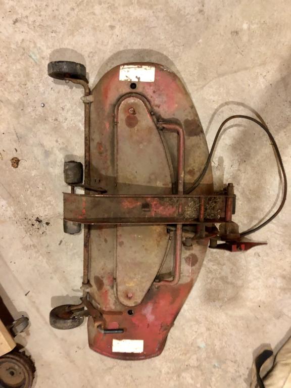

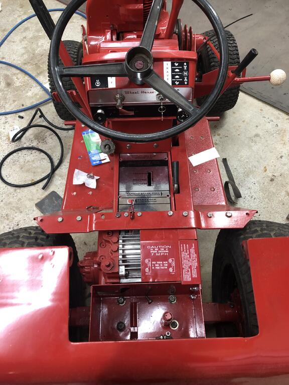

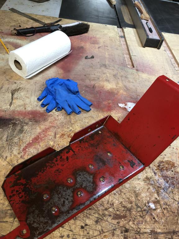

The Tuul Crib 7,354 #20 Posted January 18, 2020 OK so here's an update on the charger 10s . Was going to do a patina look but between the two tractors some of the parts needed some repairs. So in order to make the repairs I had to do some welding. So I figured I would have to do some repainting as well and decided to do a complete repaint got started cleaning parts today. Plus I have a 12 horse in my collection that I am going through and doing a quick cleanup with new rings and honing the cylinder and lapping the valves. 3 Share this post Link to post Share on other sites

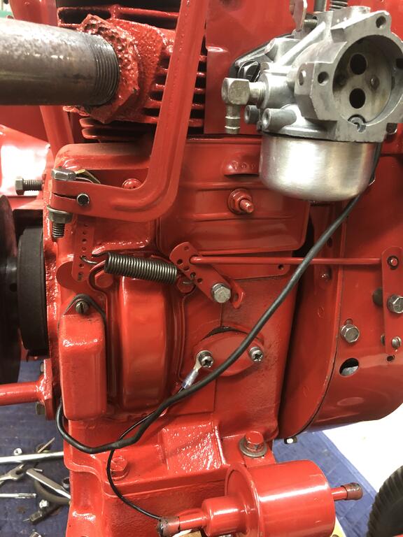

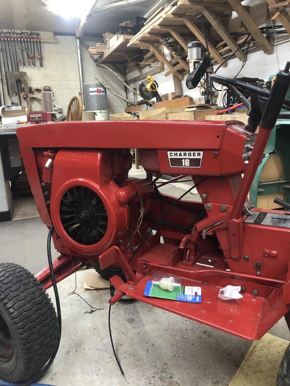

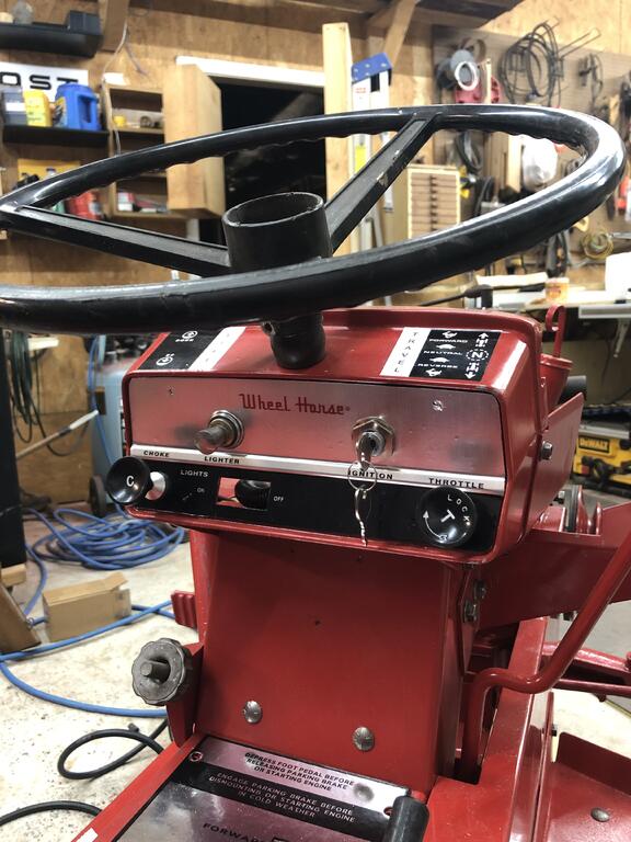

The Tuul Crib 7,354 #22 Posted October 2, 2020 (edited) Making a little progress slowly but surely on this one the transmission took the longest the motor was done before that now I just got my dash decals from @Vinylguy! Greatly appreciate it Terry. Got it all together and I actually have the original cigarette lighter in working condition! All I had to do was clean it up a little. Edited October 2, 2020 by The Tuul Crib 2 4 Share this post Link to post Share on other sites

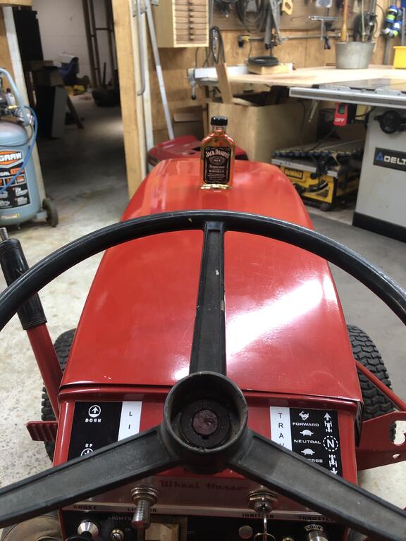

The Tuul Crib 7,354 #23 Posted October 10, 2020 Got everything buttoned up today as far as connections ground wires run throttle and choke are connected.Just finished on the wiring for the day and will have this thing running tomorrow. Totally psyched! so much so I broke out my small Bottle of Tennessee cheer!! 4 1 1 Share this post Link to post Share on other sites

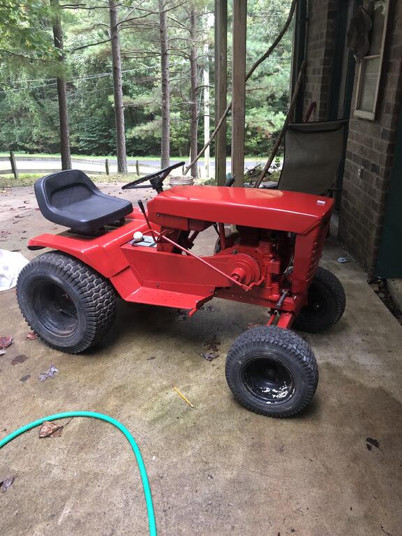

The Tuul Crib 7,354 #24 Posted October 17, 2020 Got er running on her own power today. My sweet 16 has come to life! And it moves!! IMG_8915.MOV 1 Share this post Link to post Share on other sites
