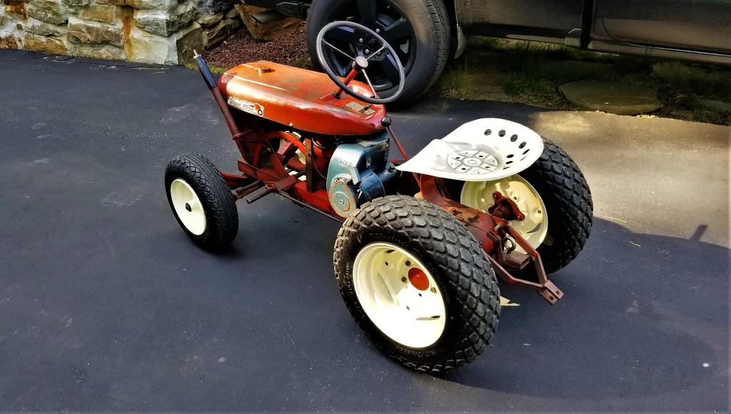

WHNJ701 4,173 #1 Posted May 23, 2018 (edited) it's finally ago, finished some major house work over the last few months, the rental property is rented and now I can get back to the fun stuff... awhile ago I picked up this pair, I posted before, I have decided after seeing others on here the 701 is getting a patina restoration. this is new to me, normally I tear down and paint. what are some tips, red scotch pad and Johnsons paste wax, or clear coat? I am going to keep this as the running thread for the pair. Edited May 23, 2018 by jabelman 4 Share this post Link to post Share on other sites

AMC RULES 37,259 #3 Posted May 23, 2018 Here's one of my paste wax specials. 2 Share this post Link to post Share on other sites

AMC RULES 37,259 #5 Posted May 25, 2018 (edited) Most probably it's original dealership decal. Think I'd start with a good scrubbing, then a liberal application of Mothers mag & aluminum polish. Then, finish with the Johnson's. Maybe test on a small, inconspicuous area first, see how you like it. Edited May 25, 2018 by AMC RULES 2 Share this post Link to post Share on other sites
WHNJ701 4,173 #6 Posted May 25, 2018 that's funny you mentioned I found a can of that with the paste wax I had. will try it. I do think I am going to spray the rims, I used and almond white on a simplicity 700 I restored (and sold) or maybe a satin black and white letter the tires. Share this post Link to post Share on other sites

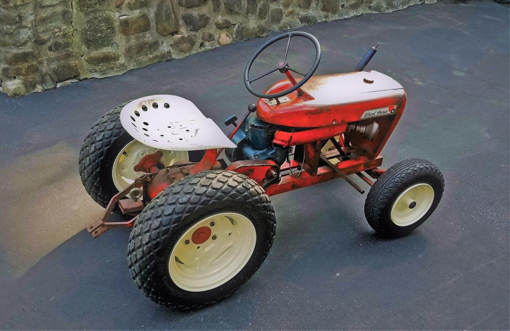

WHNJ701 4,173 #12 Posted May 26, 2018 (edited) it's amazing what you can get done when your off from work, pulled it out this morning. gave it a good wash and scrubbing. made a trip to the mower shop picked up a set of points and condenser and other parts, that's tomorrow get it running. got the old rotted muffler off, easiest way cut a line with the dremel cut off when give it whack with the screw driver off it pops off. so it's all washed, started rubbing in the wax! Edited May 26, 2018 by jabelman Share this post Link to post Share on other sites
WHNJ701 4,173 #13 Posted May 26, 2018 after the washing 1 1 Share this post Link to post Share on other sites
