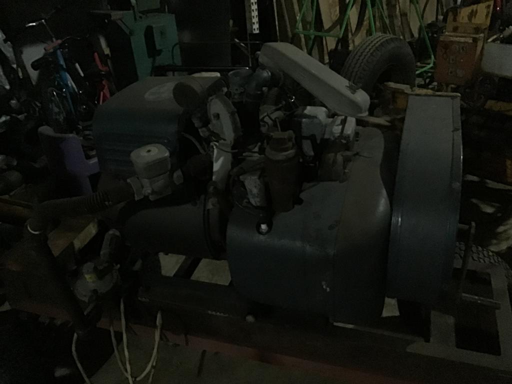

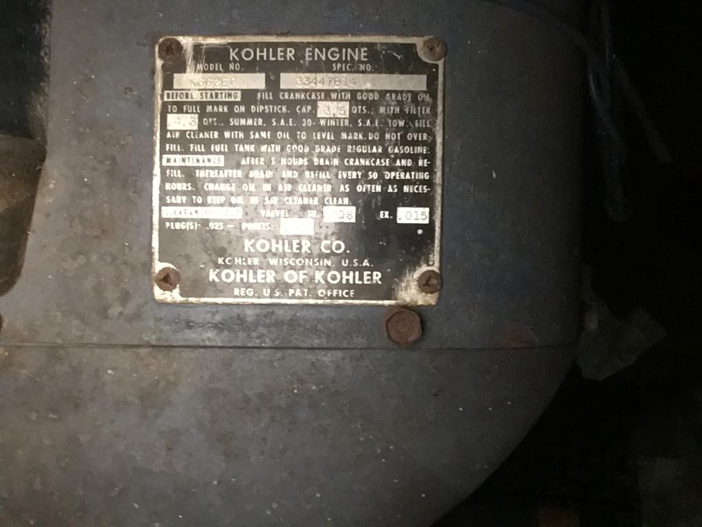

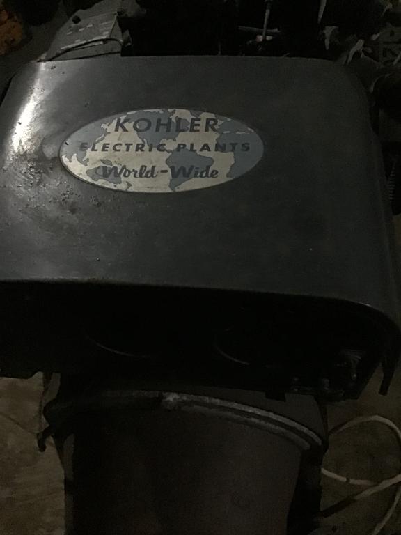

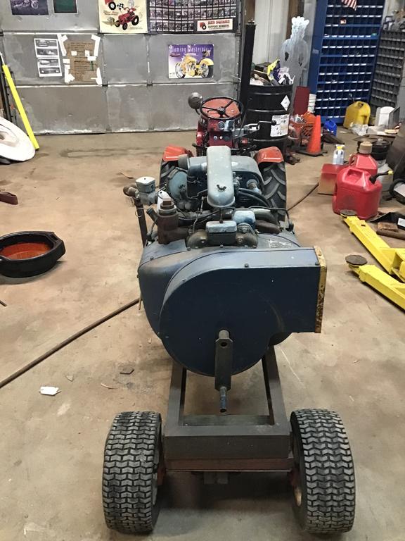

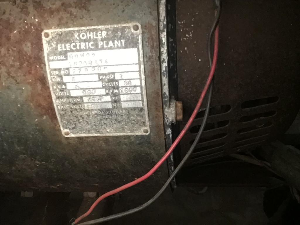

Pullstart 71,459 #1 Posted October 24, 2019 @ebinmaine found his K532 for the Colossus build by means of an auction genny. I also last year bought a big old dinosaur genny at the local auction and was amazed at the size when I went to pick it up. well tonight, I pulled it from the racking for some investigating. It’s a 24 horse power K662! The funny thing, the genny is rated at 5 kw and 120 volts! I figured due to the size that maybe it could be a whole house genny. Maybe not. it looks like it was set up as LP powered, but maybe it could convert to gas by a new carb... 3 Share this post Link to post Share on other sites

Achto 32,864 #6 Posted October 24, 2019 It's strange that it was only rated at 5kw. 24HP is enough for a 16kw gen. Unless... Because it is an 1800RPM / 4 pole generator, they grossly over rated the engine size to get enough power at the low RPM speed. Share this post Link to post Share on other sites

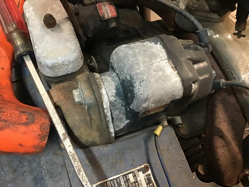

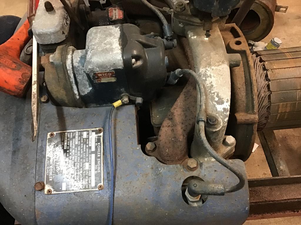

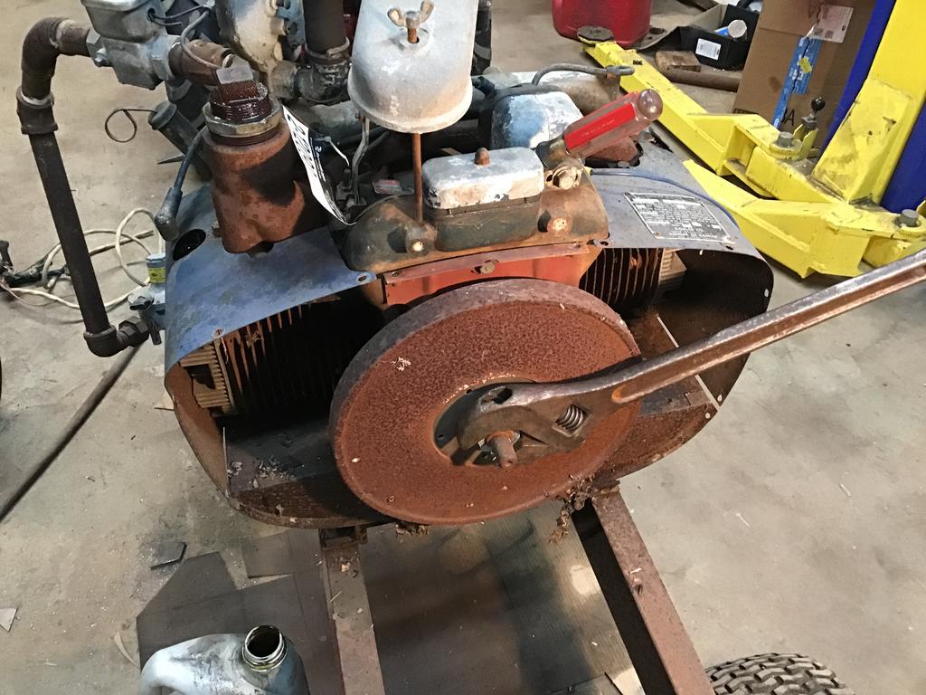

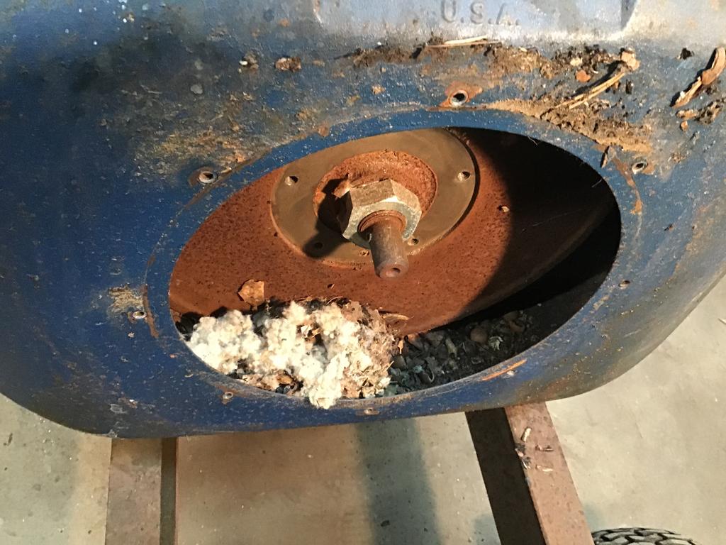

Pullstart 71,459 #7 Posted October 24, 2019 The oil looks clean, but so far it doesn’t roll over. Yay! Dan this thing has a distributor! 2 Share this post Link to post Share on other sites

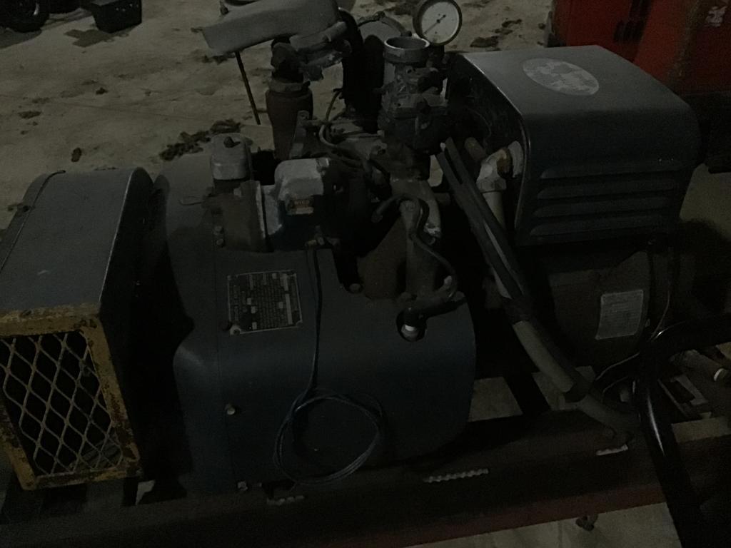

Achto 32,864 #8 Posted October 24, 2019 4 minutes ago, pullstart said: Dan this thing has a distributor! Looks like a WICO magneto. If there is a way to rotate it the the timing issue could solved. If I remember correctly the OHV LP engines were set to 26 degrees BTC and the gas engines were at 18 degrees BTC. Don't take these numbers a gospel I'd have to check my books at work to be sure. 2 Share this post Link to post Share on other sites

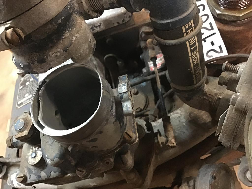

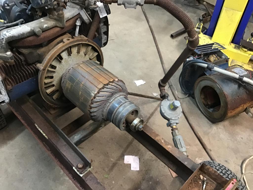

Pullstart 71,459 #9 Posted October 24, 2019 I also see it has a modified zenith carb and no electric start... just a hand crank. I pulled the plugs and tossed some WD-40 in the holes. The LP regulator appears to be vacuum operated and the LP just sprayed into the intake hat. Weird stuff! Share this post Link to post Share on other sites
Achto 32,864 #10 Posted October 24, 2019 (edited) 25 minutes ago, pullstart said: The LP regulator appears to be vacuum operated and the LP just sprayed into the intake hat. Weird stuff! Actually a quite common set up for small LP or natural gas engines that run at a constant speed. Briggs simply added a spacer with an inlet for the LP/NG under the carb and did not change anything else on the engine. The regulator regulates a constant fuel flow and the original carb is used to meter the air intake. There should also be a fuel solenoid in line to shut the fuel off when the engine is shut off. For an efficient variable speed engine you would need a liquid withdraw system with an evaporator and a mixer. Edited October 24, 2019 by Achto 1 1 Share this post Link to post Share on other sites

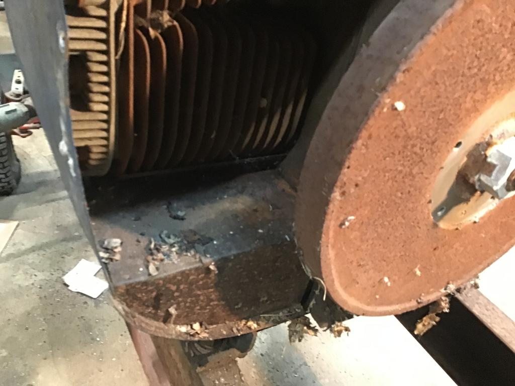

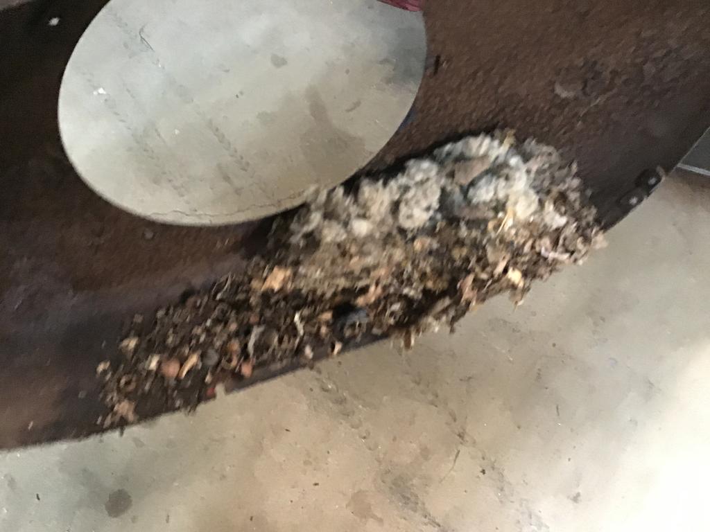

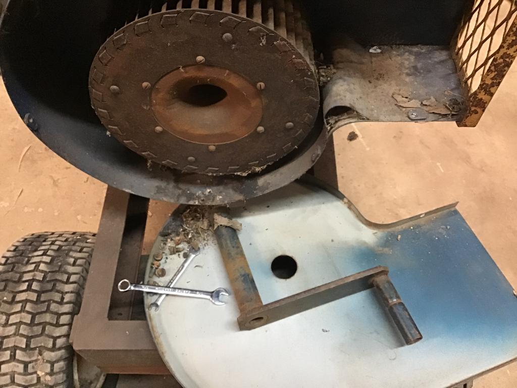

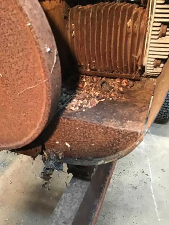

Pullstart 71,459 #11 Posted October 24, 2019 Well I pulled the built in pillow out and exposed the crank nut. It rolls over 1/2 way then feels like it hits rust in the cylinder. I filled the cylinders with used oil and will let it sit for a long while to soak in. I might just top off the cylinders once in a while and in maybe a month or two I’ll try to roll it over again. The roll pin for the hand crank was sheared off, so someone tried hard to get this thing to move! 2 Share this post Link to post Share on other sites

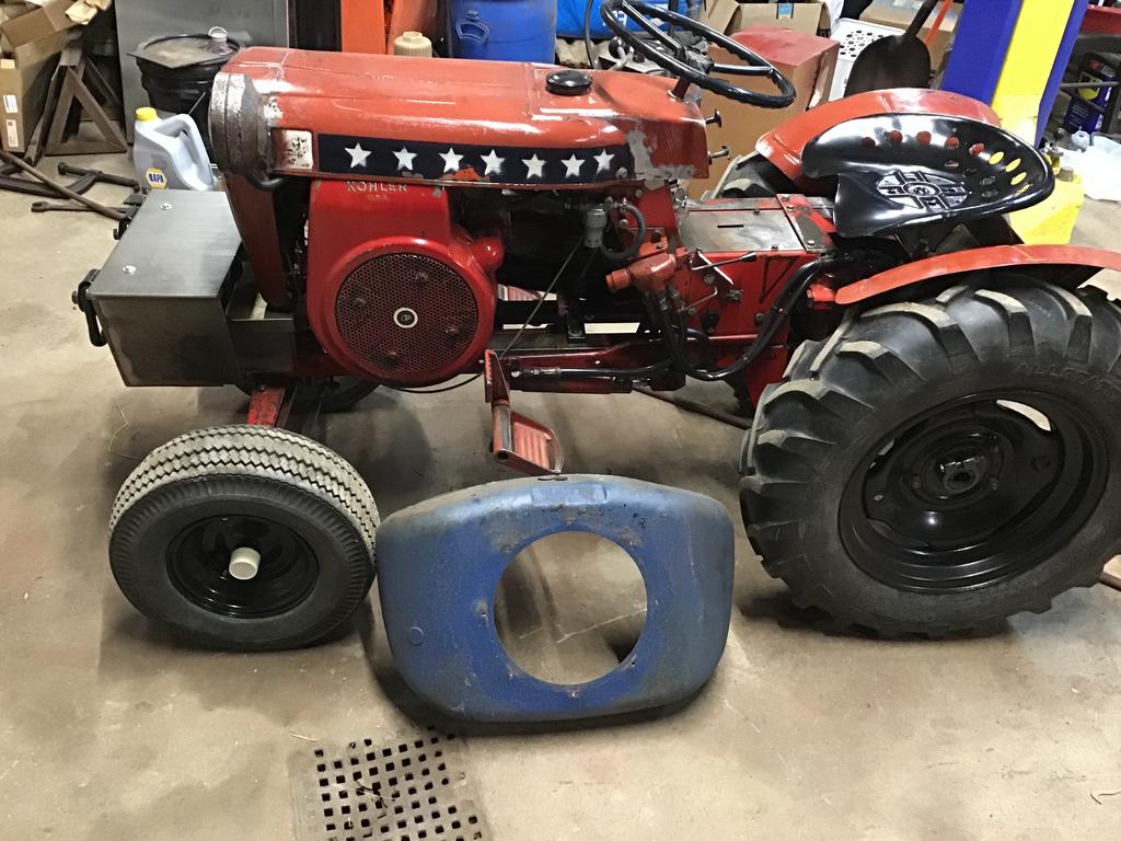

Pullstart 71,459 #12 Posted October 24, 2019 But seriously. Imagine that lunker under a Wheel Horse hood! 1 2 Share this post Link to post Share on other sites
Macwrench 133 #13 Posted October 24, 2019 Looks like an airplane motor to me with horizontally opposed air-cooled cylinders, and the magneto. Way cool! 1 1 Share this post Link to post Share on other sites
ebinmaine 81,003 #14 Posted October 24, 2019 6 hours ago, ZXT said: tapered cranksahft output that won't work with much of anything other than a generator. Curious how Eric is going to use his, Mine was a "counter engine" or possibly out of something like a bobcat. Lucky for me it has a straight crankshaft. 4 hours ago, Macwrench said: Looks like an airplane motor to me with horizontally opposed air-cooled cylinders, and the magneto. Way cool! Check out my Colossus thread. There's a few pics there to show the size of one of these monsters. @pullstart Gotta do it man. That's a Midwest Colossus brother waiting to happen. 2 1 Share this post Link to post Share on other sites
