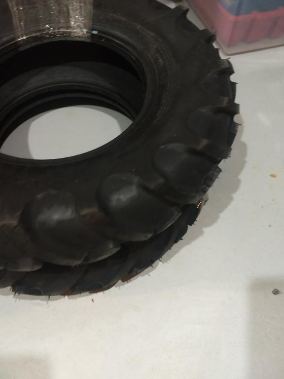

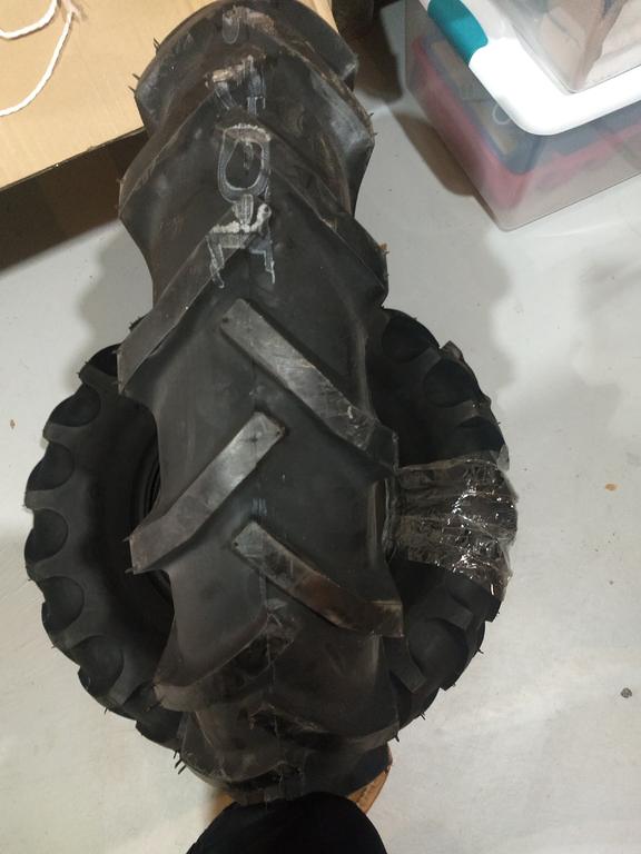

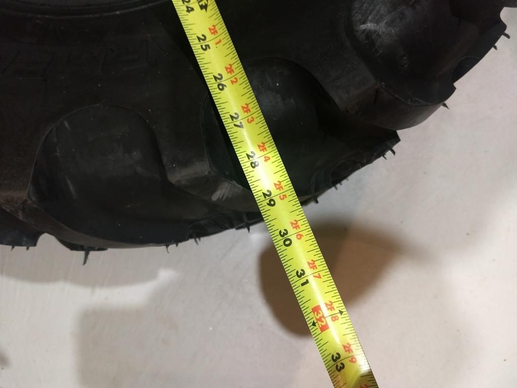

ebinmaine 80,979 #204 Posted November 20, 2019 @pullstart here's the tires that are going on the back. They'll be on a narrow rim so the cross section will end up around 7". 3 3 Share this post Link to post Share on other sites
Pullstart 71,387 #205 Posted November 21, 2019 Are those 12” or 15”? They look great! Share this post Link to post Share on other sites
ebinmaine 80,979 #206 Posted November 21, 2019 10 minutes ago, pullstart said: Are those 12” or 15”? They look great! 15" Thanks! They're going on an old set of camper rims I've had laying around. (The other 2 rims are on the monster wood splitter) Share this post Link to post Share on other sites
Pullstart 71,387 #207 Posted November 21, 2019 Same bolt pattern as your hubs, or adapters required? Share this post Link to post Share on other sites
ebinmaine 80,979 #208 Posted November 21, 2019 1 minute ago, pullstart said: Same bolt pattern as your hubs, or adapters required? Same same... 5 x 4.5. I may use adapters to widen the rear but not correct the bolt pattern. Share this post Link to post Share on other sites
Pullstart 71,387 #209 Posted November 21, 2019 Awesome stuff! 1 Share this post Link to post Share on other sites
PeacemakerJack 11,074 #210 Posted November 21, 2019 Those tires are going to look great on Colossus! Seem to be quite similar to the ones that Dad put on Clyde. They give a ton of bite when optimum traction is needed. Can wait to see those in place on the machine Share this post Link to post Share on other sites
ebinmaine 80,979 #211 Posted November 21, 2019 2 minutes ago, PeacemakerJack said: Seem to be quite similar to the ones that Dad put on Clyde That would be because they are exactly and precisely the same I was seriously considering going one size up - to an 8-16... which would have been less expensive on the tires but I would have needed rims. I really wanted to use what I had on hand like we always try to do. I'd like to be able to find some steel weights to go along with the fact that these tires will be fluid loaded. @Mows4three Dave has a set in Western Pennsylvania that would work out perfect but the shipping is a killer. I believe it was @Ralph S that had made up some hub mounted weight holders for his pulling tractor and perhaps I'll take advantage of a system such as that. 1 Share this post Link to post Share on other sites

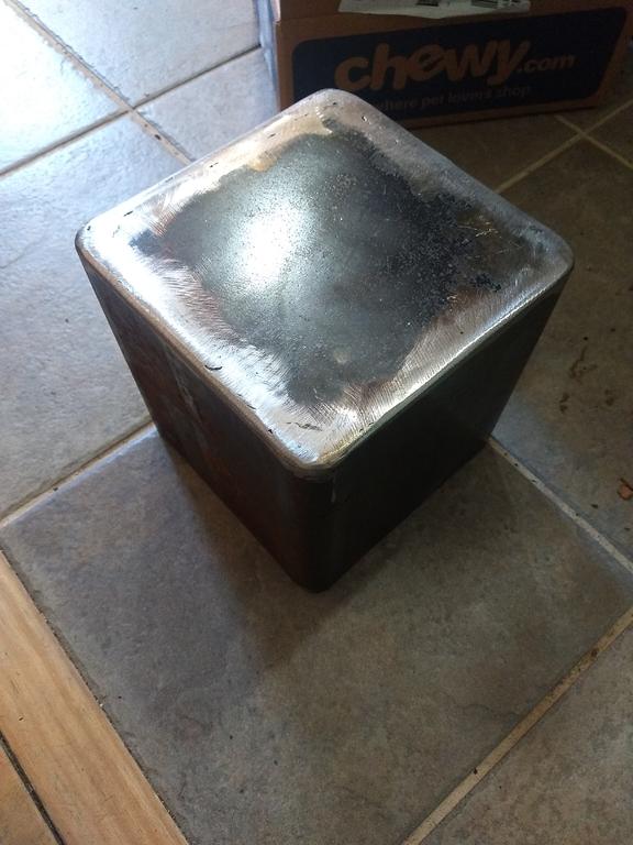

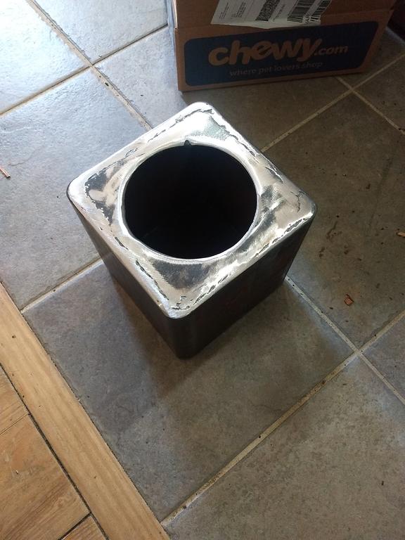

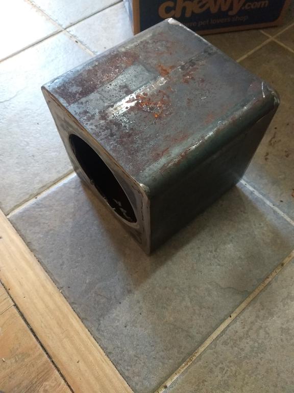

ebinmaine 80,979 #212 Posted November 23, 2019 One of our hiking friends is a fabricator by trade. She made up the spacer to go between the frame and transmission. It's 7 x 7 x 7. 5/16" thick. One side is solid capped and the other has a 5" hole to access the bolts. I was originally going to mount it "hole side" down but Trina and I have decided to keep it "hole side" up because it will be EXTREMELY handy for holding general items. Small tools. Gloves. Water bottle... Whatever..... For reference the tiles are 12" square. 4 1 1 Share this post Link to post Share on other sites
Stormin 9,988 #213 Posted November 23, 2019 Just a point, Eric. If your going to use it to put things in, I'd drill a hole or two in the bottom. You'll want dry gloves and water in a bottle. 3 2 Share this post Link to post Share on other sites
ebinmaine 80,979 #214 Posted November 23, 2019 25 minutes ago, Stormin said: Just a point, Eric. If your going to use it to put things in, I'd drill a hole or two in the bottom. You'll want dry gloves and water in a bottle. I may do that just for kicks but we pretty much never leave our machines outside. This one won't get used for snow plowing duty or any kind of inclement weather. Share this post Link to post Share on other sites
Stormin 9,988 #215 Posted November 23, 2019 2 minutes ago, ebinmaine said: I may do that just for kicks but we pretty much never leave our machines outside. Never say never. 1 1 1 Share this post Link to post Share on other sites

SylvanLakeWH 32,709 #217 Posted November 24, 2019 21 hours ago, ebinmaine said: One of our hiking friends is a fabricator by trade. She made up the spacer to go between the frame and transmission. It's 7 x 7 x 7. 5/16" thick. One side is solid capped and the other has a 5" hole to access the bolts. I was originally going to mount it "hole side" down but Trina and I have decided to keep it "hole side" up because it will be EXTREMELY handy for holding general items. Small tools. Gloves. Water bottle... Whatever..... Nice friend and nice job! You know, looks perfect size for a wine chiller... little ice, foam around edge to keep bottle snug, drain hole with drain tube, couple hooks for glasses off the side...very romantic for a date night...or you could add a compressor and go with a micro refrigerator unit off the PTO... 2 2 Share this post Link to post Share on other sites
ebinmaine 80,979 #218 Posted November 24, 2019 10 hours ago, pullstart said: Yeah... a breakdown might change the never to usually. Shows might be the same type of rule breaker. Breakdown here means we grab another horse and tow the nonrunner in the shop. But shows. Yes. No enclosed space/trailer...yet. Share this post Link to post Share on other sites
ebinmaine 80,979 #219 Posted November 24, 2019 1 hour ago, SylvanLakeWH said: Nice friend and nice job! You know, looks perfect size for a wine chiller... little ice, foam around edge to keep bottle snug, drain hole with drain tube, couple hooks for glasses off the side...very romantic for a date night...or you could add a compressor and go with a micro refrigerator unit off the PTO... She really is awesome. Second only to my amazing Trina as the nicest person I know. So that (adult beverage) cooler idea........ Hhhmmmmm...... We may have something there..... Not wine for us . But other drinks... This is what it's all about. Sharing great ideas amongst our fellowship. 2 2 1 Share this post Link to post Share on other sites
