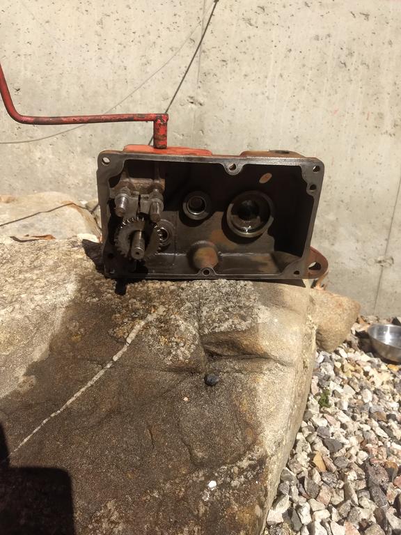

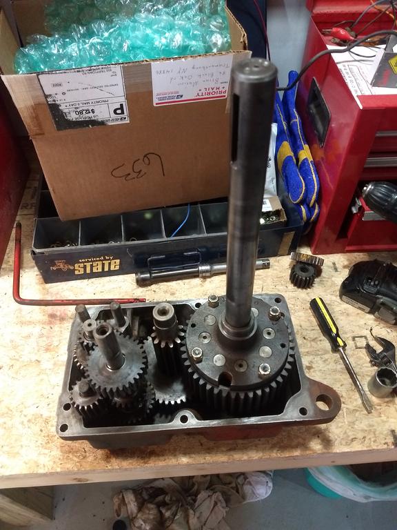

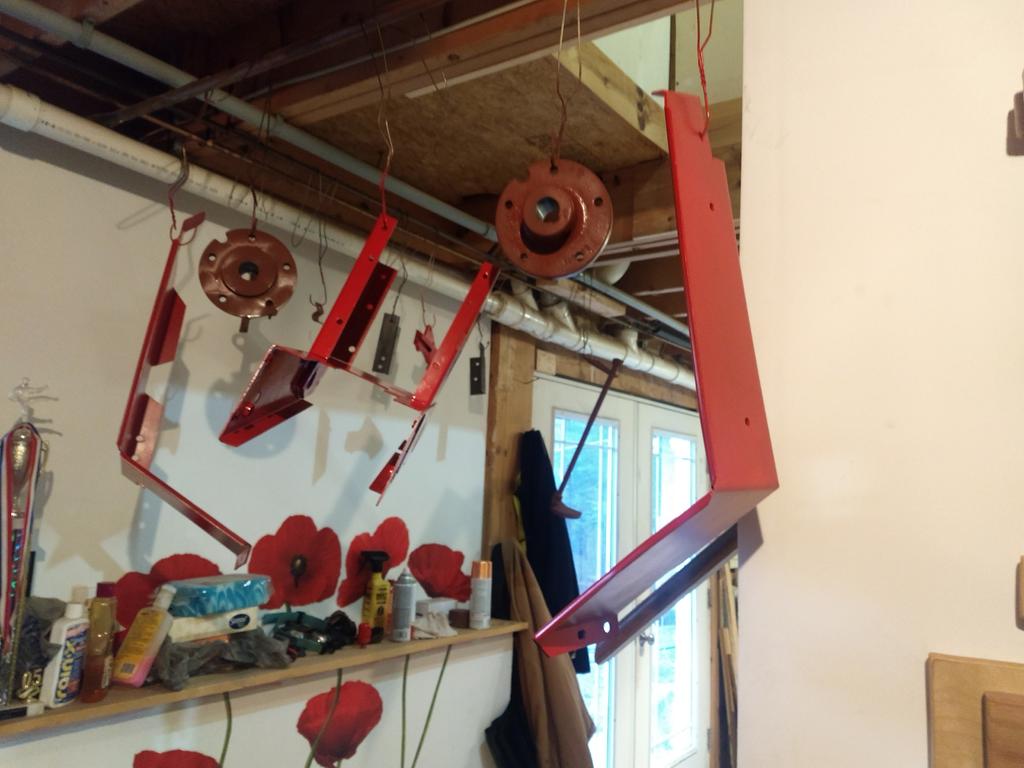

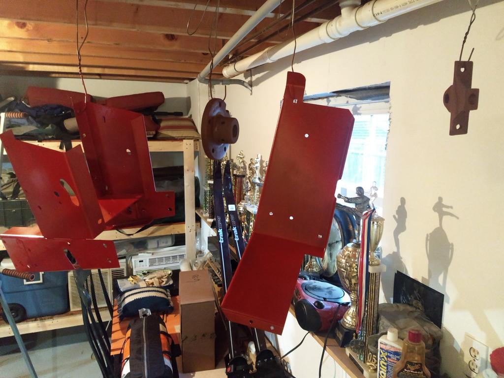

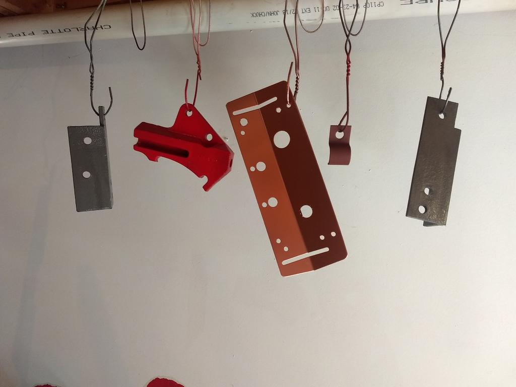

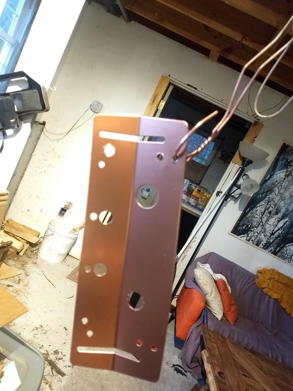

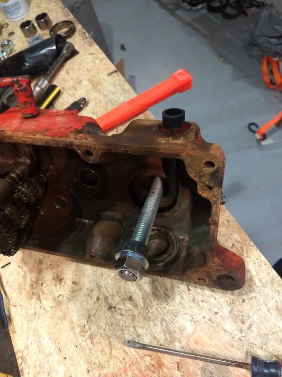

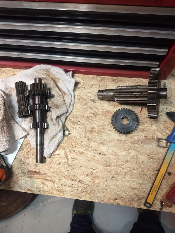

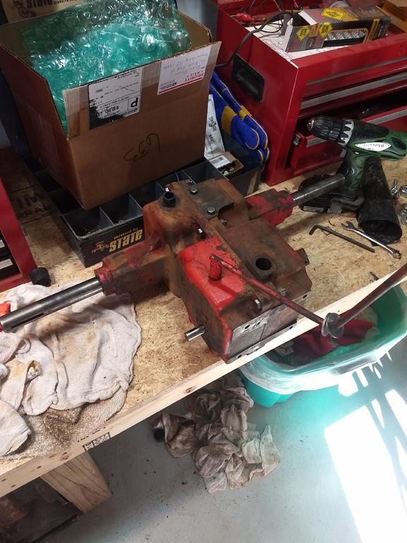

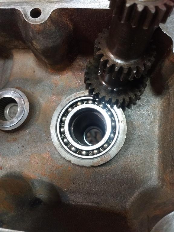

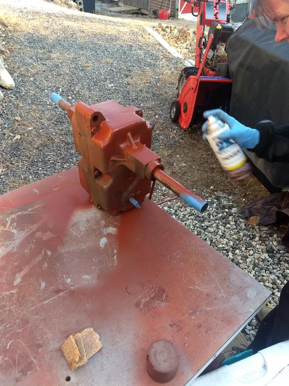

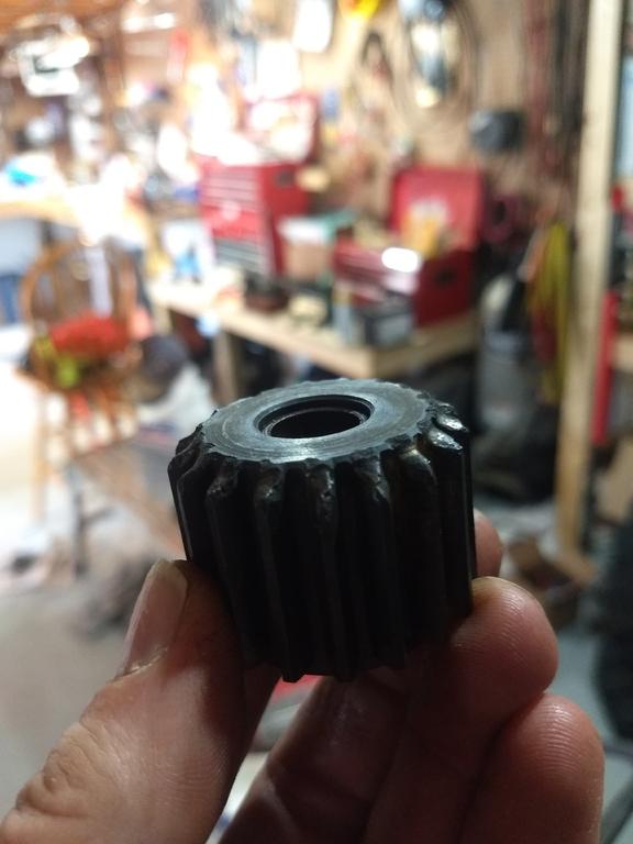

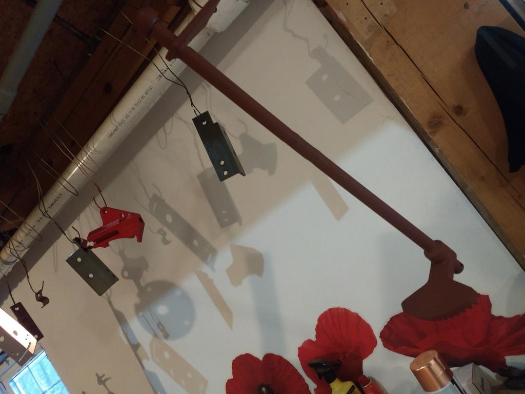

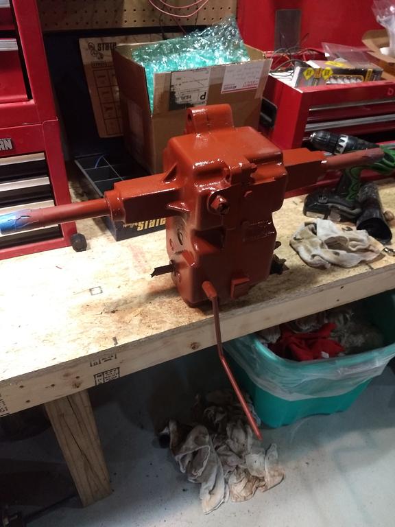

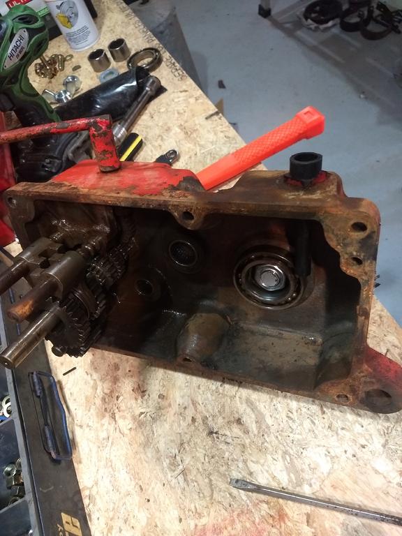

ebinmaine 80,975 #412 Posted March 15, 2020 Boy did we get a bunch done on the project today. We spent pert near 8 hours. Trina was disassembling, grinding and painting like a disassembling, grinding and painting madwoman. All to appease Mr. Norman @Stormin Here's proof of how much priming and painting she did today. Note the interesting sunburn like color tone of her arm. That's paint. Washed right off. She even had red hair for a little while this afternoon. I rebuilt the transmission... and helped her here and there moving things etc. I want to say thank you to @stevasaurus Steve for making your transmission videos. Here's a few pics of the transmission: Empty. Carrier and wheel bearings removed. Cleaned up and ready for reassembly. Gears all cleaned up and waiting to be reinstalled. I did have to grind about .002 off the side of a woodruff key so I would have the right size. Took me two attempts but the second one worked great. These next two pics show how I was able to remove the carrier bearing. I experimented with the bad one to make sure it would work before I screwed up a good one. I owe Lincoln at A to Z tractor I thank you for this idea. @A-Z Tractor Carrier installed. Wheel bearing installed. Ready for reassembly. Good to have extra parts laying around. When I got this bugger disassembled I discovered that this reverse idler gear has seen better days. It would have worked okay but I had another one in the shed that was in better condition. Here is all of the internal system reassembled. Ready to drop the top case half in place. Note the super long axle... Fully assembled and ready to be wire brushed. Part way through the priming stage. And here it sits on the bench happily drying overnight. And... here we have another Wheelhorse mobile hanging with paint drying. Note the copper dash plate. The pictures of this just can't do it justice. It looks fantastic. The two pieces on the outside are the reinforcement brackets for the frame. Trina painted those a hammered bronze color to keep with the theme. If this steering shaft looks a little long to anybody it's because it has a 1.5 inch extension welded into it. my little perfectionist wasn't happy with the roughness of the welds so she took some time to grind it a little smoother. I mentioned to her that we wouldn't be able to see it. Her response. "It's awful. It needs to be fixed." These next two shots show the steps and the bottom of the steering column support from a couple different positions. Really nice bright red. Hubs have been primed. Here's a better shot of the copper dash panel that Trina took specifically to try to bring out the color. 4 6 1 1 Share this post Link to post Share on other sites

Cvans 1,009 #416 Posted March 16, 2020 (edited) Your project is coming along nicely. Looking forward to seeing it completed. Where would we be without wire hooks to hang things on while painting? Been hand sharpening bits for most my life but now that the eyes aren't so good it's getting really hard to sharpen the little ones. Don't know what a drill doctor costs but I suspect that a bunch of small bits can be purchased for the price. Going to look into it though. Edited March 16, 2020 by Cvans 2 Share this post Link to post Share on other sites
Stormin 9,988 #417 Posted March 16, 2020 (edited) 8 hours ago, ebinmaine said: Boy did we get a bunch done on the project today. We spent pert near 8 hours. Trina was disassembling, grinding and painting like a disassembling, grinding and painting madwoman. Well done Trina. Quote Note the super long axle... Fully assembled and ready to be wire brushed. Just a thought on those longer axles, Eric. How about sliding some tight fitting tube over them for added strength.? Surprising what you can get done in 8hrs when you try. Well done Trina. Keep and Be finished by the end of the month. Edited March 16, 2020 by Stormin 1 3 Share this post Link to post Share on other sites
