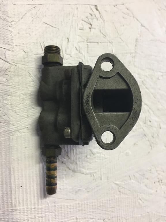

Steph 5 #5 Posted August 22, 2019 There is a rod in the fuel pump that is bent. Share this post Link to post Share on other sites

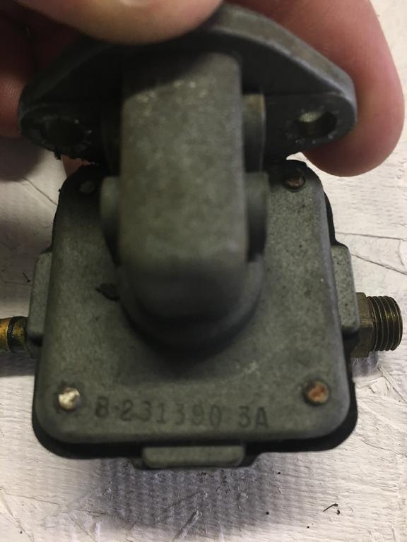

clueless 3,403 #8 Posted August 22, 2019 We need pictures of the fuel pump and the bent rod, as of right now we are only guessing. Share this post Link to post Share on other sites
Steph 5 #9 Posted August 22, 2019 I was mistaken on previous post. The rod is missing. Share this post Link to post Share on other sites

Steph 5 #15 Posted August 22, 2019 Ok upon further info from my husband there is a piece broken off in the current fuel pump. Is there a rebuild kit for the current pump? Share this post Link to post Share on other sites
ebinmaine 79,127 #16 Posted August 22, 2019 17 minutes ago, roadapples said: OK thanks..I think... I'm not positive with a Kohler pump but pulse pumps are used on many small engines all the way up into the 80s and 90s. As the piston in the engine goes up and down it creates pulses of flowing air which are transferred into a fuel pump. There is a diaphragm between the air half, and the fuel half. As a vacuum is created it pulls on the diaphragm which in turn pulls fuel into the pump. There are check valves in place to prevent fuel and air from flowing the wrong directions. 2 minutes ago, Steph said: Ok upon further info from my husband there is a piece broken off in the current fuel pump. Is there a rebuild kit for the current pump? Can you post a picture of the piece that is broken off? Brian, listed above, sells a replacement diaphragm but I'm not sure if anyone has any other parts for those pumps. 1 2 Share this post Link to post Share on other sites

rjg854 13,073 #18 Posted August 23, 2019 The pictures posted earlier are of the actual fuel pump you're talking about? I don't see anything structurally wrong with it, if it is from those pics., unless I'm missing something. It should be rebuildable. Share this post Link to post Share on other sites
