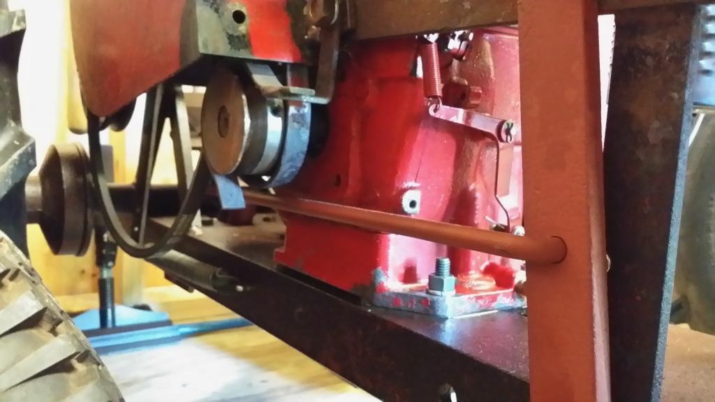

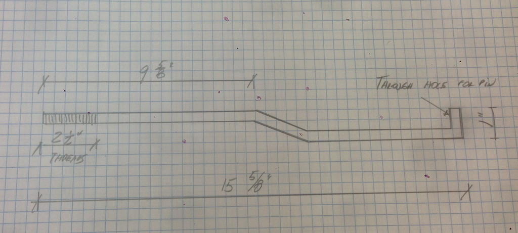

formariz 12,381 #3 Posted May 20, 2019 @WHGuy413 Here is what is on mine. 1 2 Share this post Link to post Share on other sites

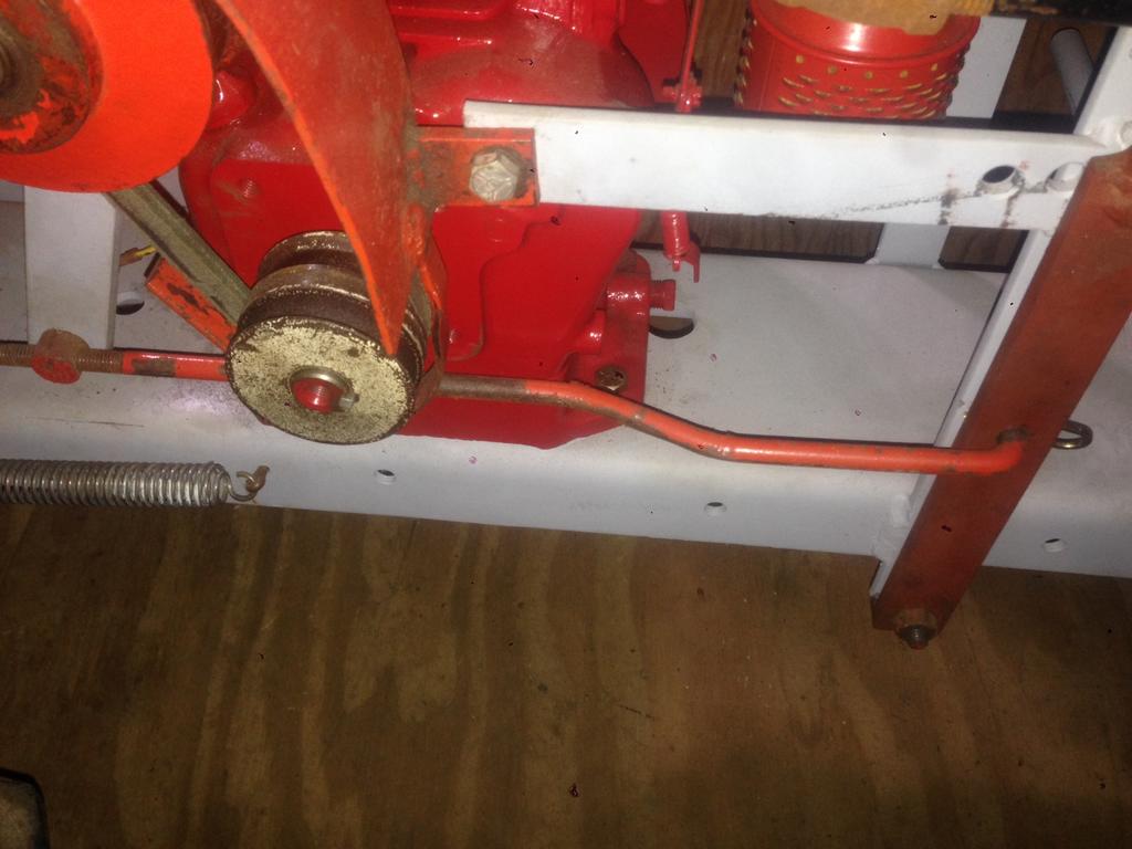

formariz 12,381 #10 Posted May 29, 2019 14 hours ago, WHGuy413 said: Ok thanks. For some reason the arm comes on contact with my engine pulley being straight? Any idea why? I have two here both came with bent arms. Not a haphazard bent but an intentional well done bent. Tried to replace it with the straight arm as it should be, and also had problems with them hitting pulley as speed is changed. Share this post Link to post Share on other sites

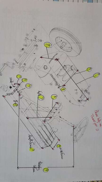

Jean of Normandy 1 #12 Posted May 12, 2020 Hello mr can you help me I live in France and I restore an RJ45 but the length of the steering column the length and width of the frame I send you a plan if you can give me the measurements thank you and protect yourself jean of normady Share this post Link to post Share on other sites

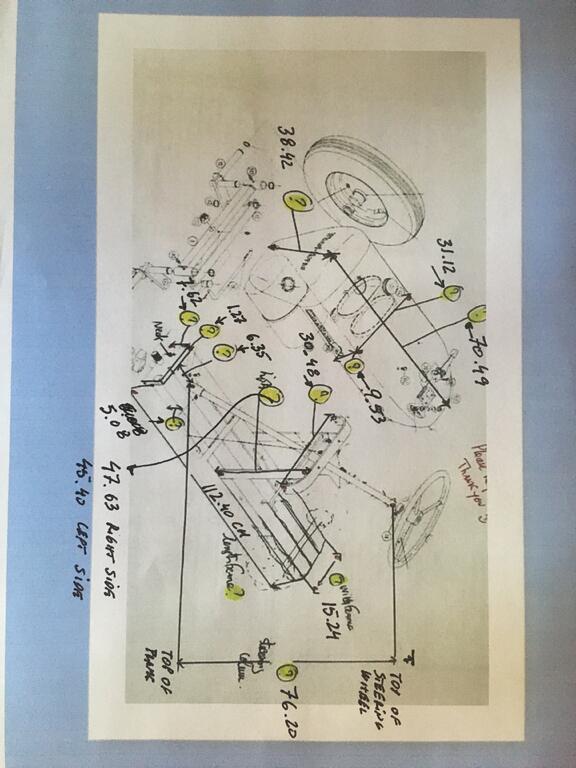

formariz 12,381 #14 Posted May 12, 2020 (edited) 3 hours ago, Jean of Normandy said: Hello mr can you help me I live in France and I restore an RJ45 but the length of the steering column the length and width of the frame I send you a plan if you can give me the measurements thank you and protect yourself jean of normady Hi Jean. Welcome to Red Square. Here they are converted to the metric system. Let us know if you need detailed photos. I have a couple of them accessible for that. Edited May 12, 2020 by formariz 1 Share this post Link to post Share on other sites

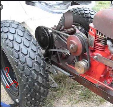

Jean of Normandy 1 #18 Posted May 15, 2020 Bonjour je ne comprends pas vraiment la taille des pneus pour le rj 35 avez-vous des références je sais que vous avez besoin de pneus 6: 00x12 à l'arrière mais je ne trouve pas la taille de la jante avec l'offset. what is the length of the rear rim deport ? photos jointes. Pareil pour l'avant? 4: 00x8 Merci pour votre aide Ps je pense qu'en France c'est différent Share this post Link to post Share on other sites
formariz 12,381 #19 Posted May 15, 2020 (edited) Jean Note that your tractor is not a RJ35. It is a Suburban 550. Frame dimensions I sent you are for a RJ35. Are you inquiring about the wheel offset? Edited May 15, 2020 by formariz Share this post Link to post Share on other sites
