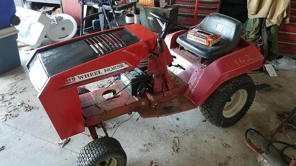

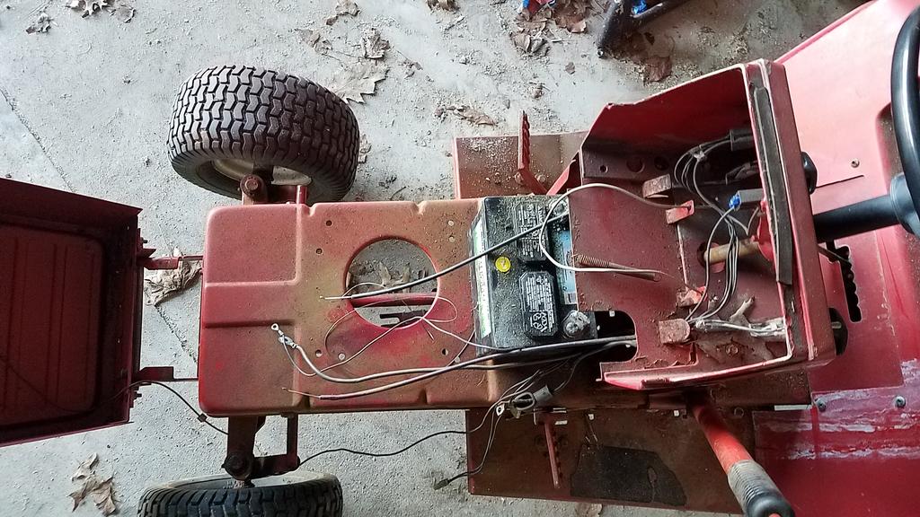

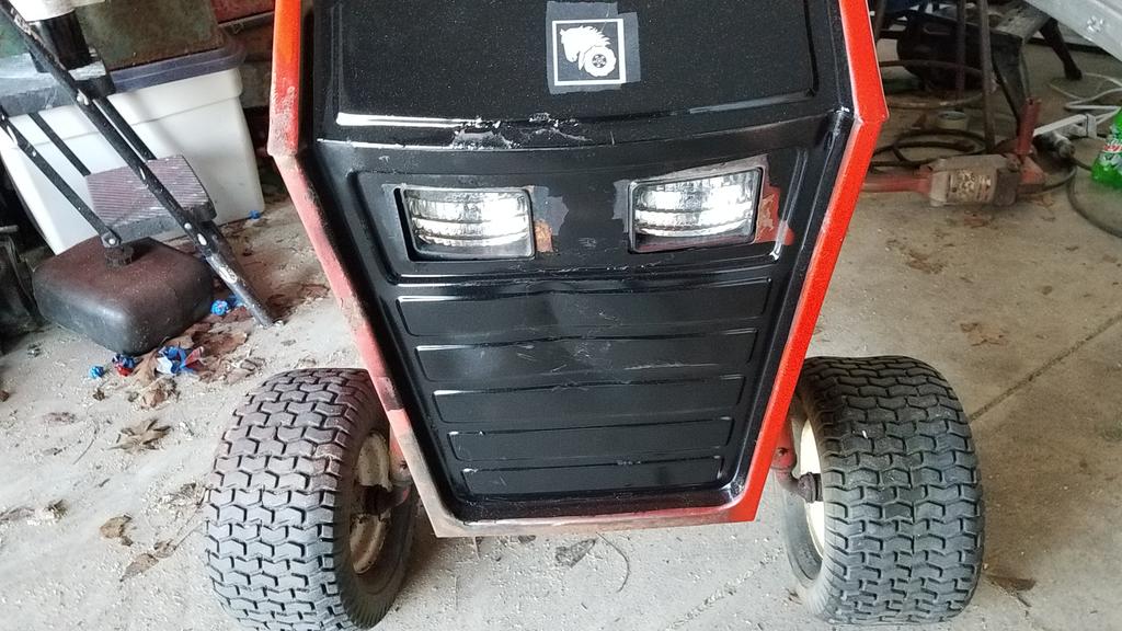

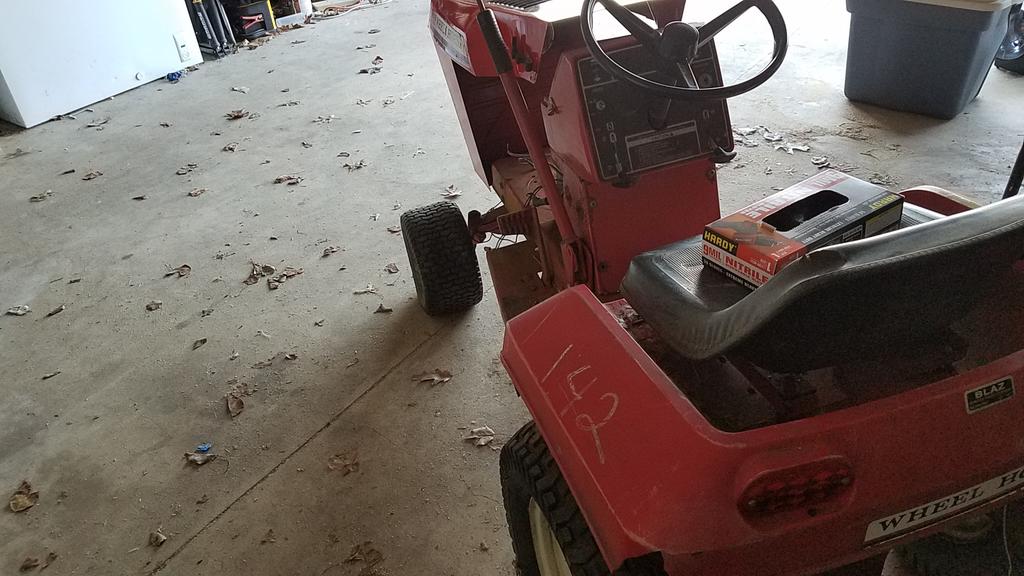

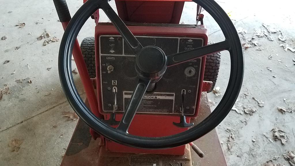

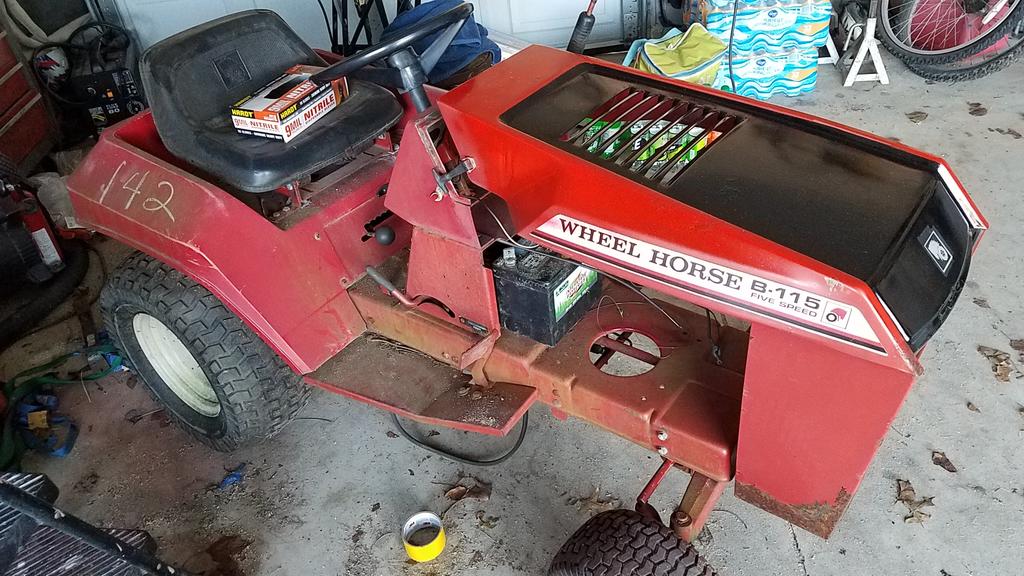

Hello all, I recently acquired a "new" B-115, and with the help of @ohiofarmer, I will be fixing her up, first with a engine he is trading me for my old Kohler engine off my '77 B-80 that I trashed when I was 13. I haven't been in the Wheel horse game long, as I am 16 now, I hopefully will be able to keep this project updated on here, especially in the spring when I will be completely repainting it! I am super excited for this project, and am ready for all the challenges that lay ahead with it. if you have any helpful information you are willing to share about my newly acquired project, please share! I haven't had tons of luck finding tons of information about it.

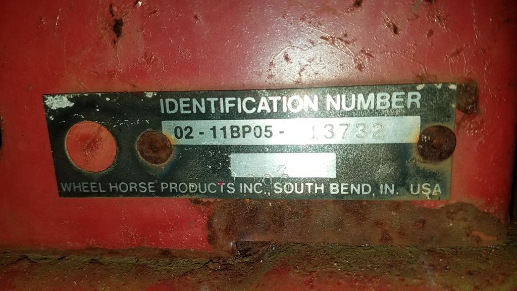

Looks like the ID plate is near the bottom of the battery on the right side at the bottom of the hoodstand. Model and serial will identify the tractor and with those we can provide more accurate info. The 2nd line on the plate may have the Julian build date. Let us know what they are.

Is the build date at the bottom on the plate 1296? Added it to the list so click on the picture.

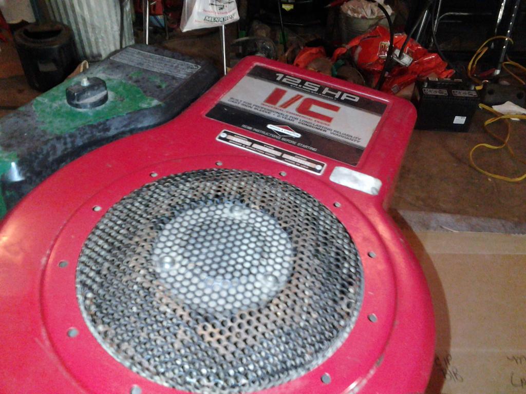

   I have not yet spoken to this young man except for PM messages..  I have a 12.5 IC Briggs that needs some parts that we are already chasing down. By the size of the engine bay, it certainly looks possible.

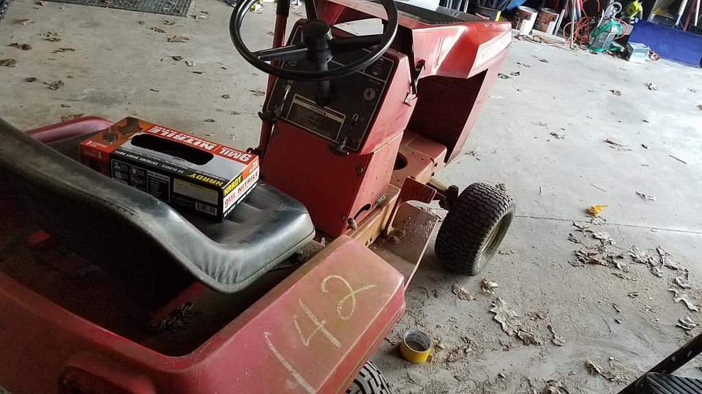

 Anyway, that tractor looks nice and straight...Just look at that seat!

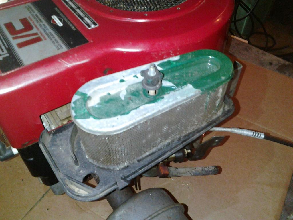

Pictures:

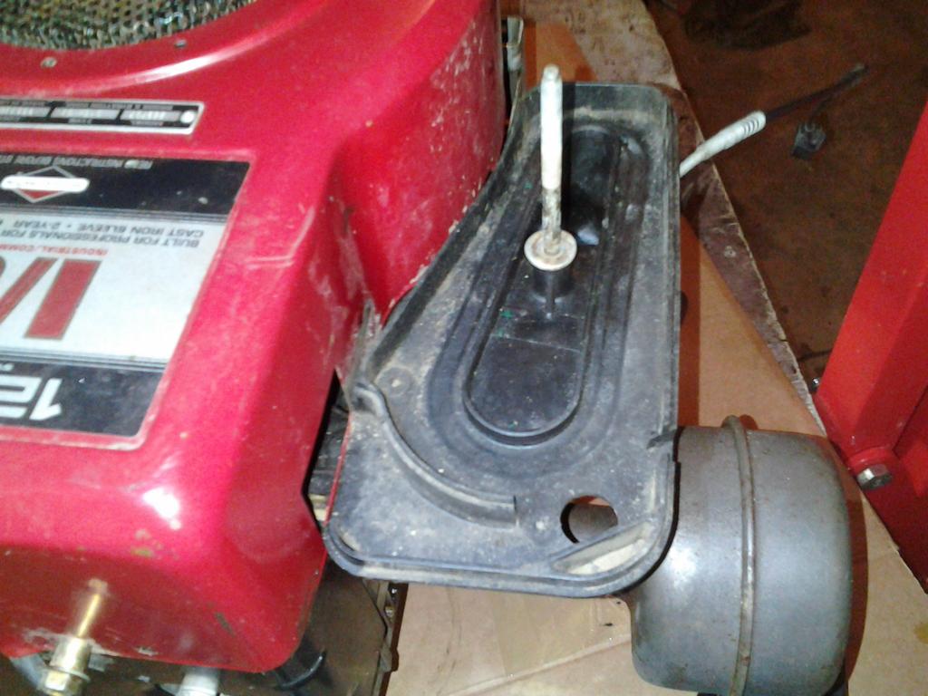

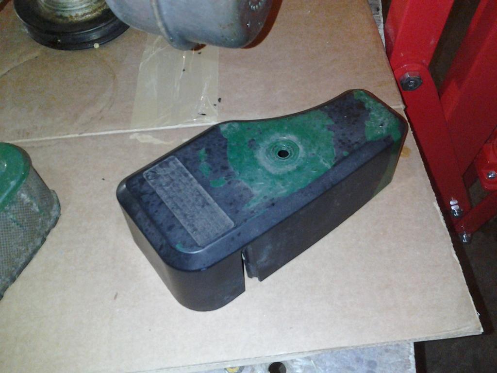

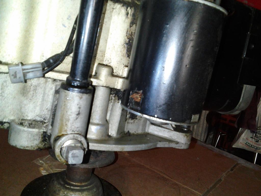

#16 shows that it is an IC engine with the magnetron ignigtion  #17 shows that the starter [positive] lug is broken off. The air cleaner housing is the type that has the wide to slim oval filter, and it is the base that the filter sits on that is cracked .  Excuse the green paint on the filter
Picture #20 shows the carb. There are two different carbs on this engine series.  One of them is a Walbro and I am not sure of the other one.

That starter could be fixed relatively easily. Briggs part number 691293. around 21 dollars.

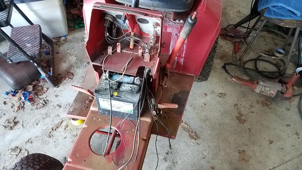

I am now having some issues with the starter (I got a new one), I am not sure whats up with it. I was just testing it out to see if it would turn over, and it will go up into the flywheel, but it wont turn over for some reason. I was using a 40A 12V jumper box, even that wont get her going. any help is greatly appreciated!
