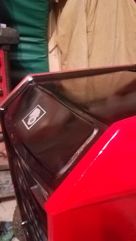

Thanks! I just did a little paint work tonight since I had some time lol

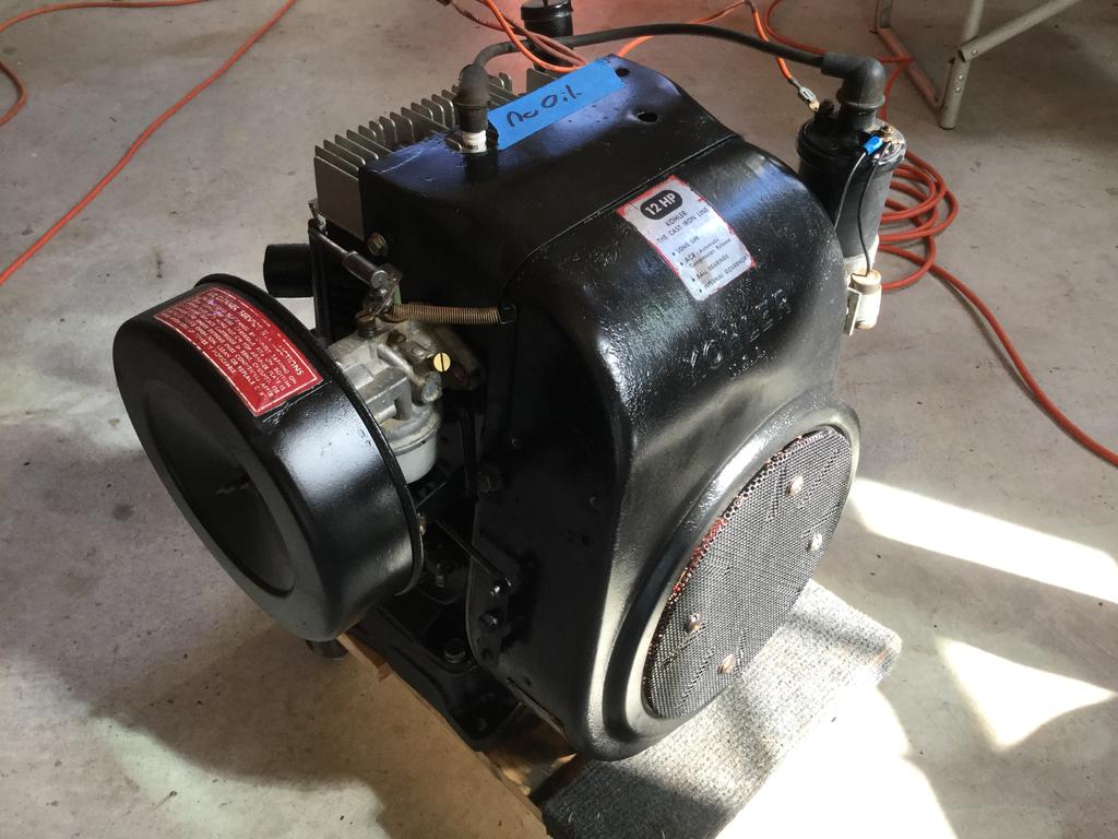

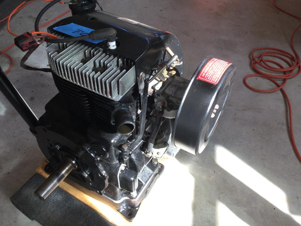

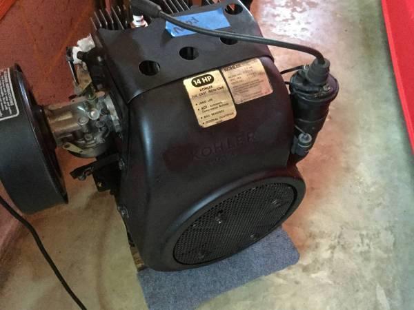

richmondred01
Ready to go complete rebuild.
Crank .010 under, bored .010 over, valve seats ground, new piston, rings, rod, rebuilt carb, all seal seals and gaskets.

nickjet67
36 minutes ago, richmondred01 said:
Thanks for the comment! But I need that vertical shaft Briggs 191707, it's a 1982 B-115 5-speed. But thank you for commenting
