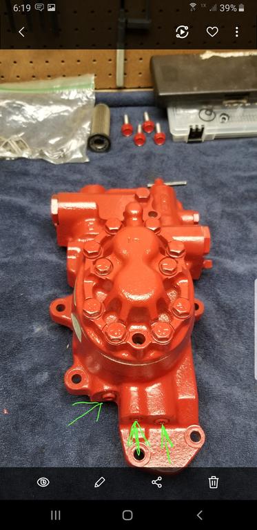

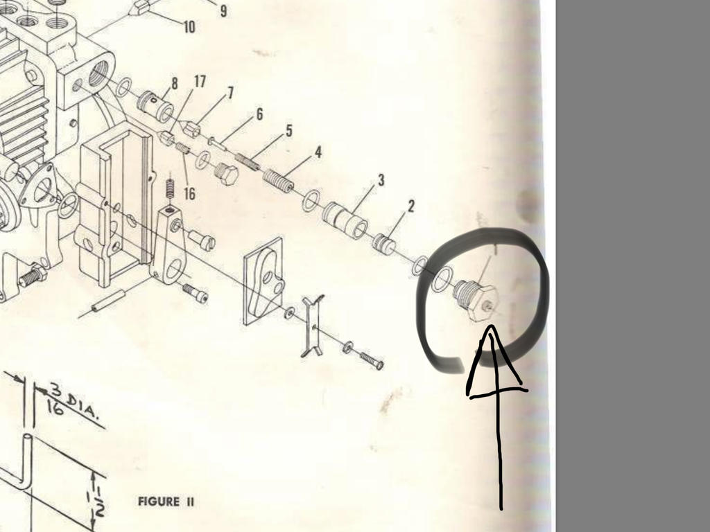

p38js 444 #80 Posted May 3, 2019 Does anyone know what this adjustment is for? Share this post Link to post Share on other sites
ebinmaine 81,281 #81 Posted May 3, 2019 9 hours ago, p38js said: Does anyone know what this adjustment is for? @daveoman1966 @pfrederi ? Share this post Link to post Share on other sites
gt14rider 1,291 #82 Posted May 3, 2019 That is a dampening valve, takes up pressure from acceleration valve to reverse valve, manual stats clean with solvent, check for damage to the pin or ball or if valve rattles when shaken, replace valve. Share this post Link to post Share on other sites
p38js 444 #83 Posted May 3, 2019 33 minutes ago, gt14rider said: That is a dampening valve, takes up pressure from acceleration valve to reverse valve, manual stats clean with solvent, check for damage to the pin or ball or if valve rattles when shaken, replace valve. Gt14rider do you think that will solve my problem, the transmission will take off in forward and almost pull the front end off the ground and barely move in reverse?. I’m in the process of changing out all the o-ring in the reverse circuit and polishing the valve seats, in the hopes that I have an internal leak Share this post Link to post Share on other sites

gt14rider 1,291 #87 Posted May 3, 2019 I think you are on the right track, check springs and orings, forward and reverse valves, also check valves and springs item 9 and 10. Trouble shooting chart, Erratic engagement...... follow flow chart, check towing valve / hydrogear tune - up. Sundstrand manual, Share this post Link to post Share on other sites
gt14rider 1,291 #88 Posted May 3, 2019 Also check speed control lever for full travel and tention, make sure cam plate moves all the way, so you get full forward and full reverse range Share this post Link to post Share on other sites
p38js 444 #89 Posted May 3, 2019 1 hour ago, gt14rider said: I think you are on the right track, check springs and orings, forward and reverse valves, also check valves and springs item 9 and 10. Trouble shooting chart, Erratic engagement...... follow flow chart, check towing valve / hydrogear tune - up. Sundstrand manual, That’s was my thought if none of that works I two extra rear ends to try Share this post Link to post Share on other sites

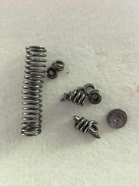

p38js 444 #91 Posted May 7, 2019 I think I found my transmission problem new o rings and robbed springs from another transmission, can’t ops check yet waiting on a pump out put shaft seal 7877 sound be here this week. Does any one have a source for new springs? Share this post Link to post Share on other sites
gt14rider 1,291 #92 Posted May 7, 2019 Nla, if you find some let us know, looks like most common problem, try to flush as best you can, pieces of spring will wreck pump. Share this post Link to post Share on other sites
953 nut 70,654 #93 Posted May 7, 2019 24 minutes ago, p38js said: Does any one have a source for new springs? Several years back @refracman had a source for the acceleration springs, send him a PM and see if he can help. 1 Share this post Link to post Share on other sites
p38js 444 #94 Posted May 7, 2019 25 minutes ago, gt14rider said: Nla, if you find some let us know, looks like most common problem, try to flush as best you can, pieces of spring will wreck pump. I flushed out the passages with some brake clean ran a magnet in all the bores and was getting some fine metal. Drained the fluid and installed a new filter, I hope I got all of it Share this post Link to post Share on other sites
gt14rider 1,291 #95 Posted May 7, 2019 Check plugs on bottom of the pump housing, Allen heads. 1 Share this post Link to post Share on other sites

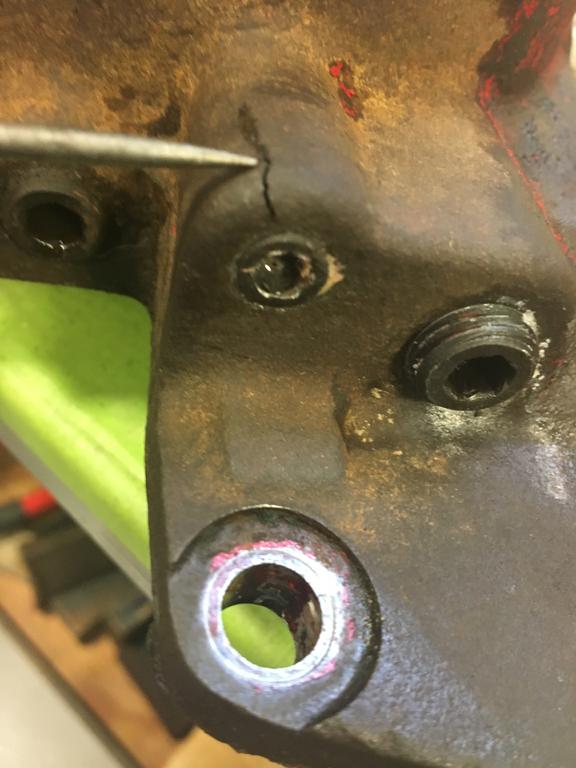

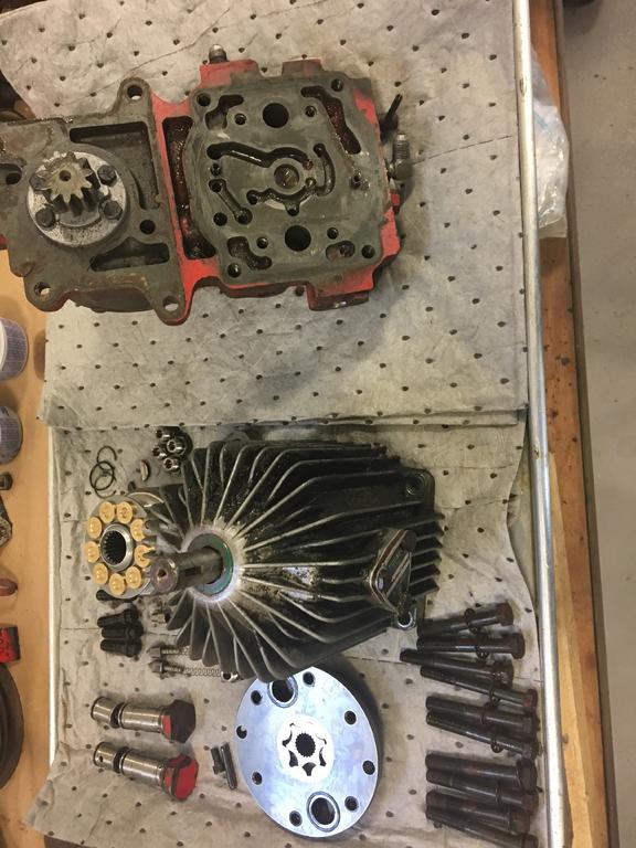

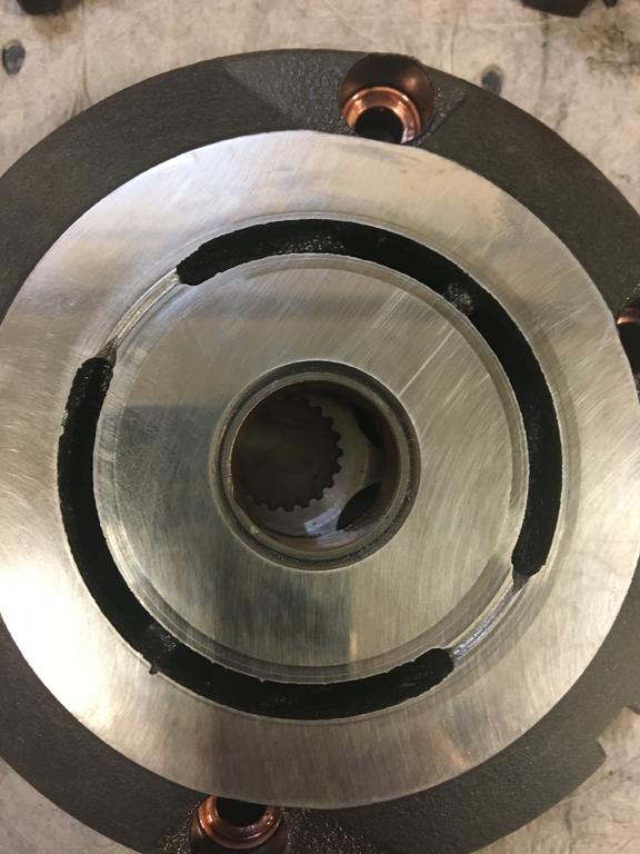

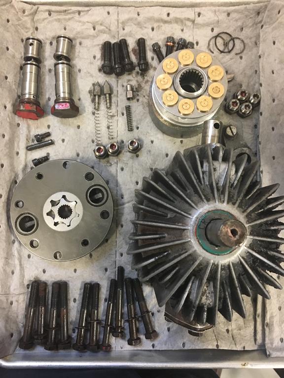

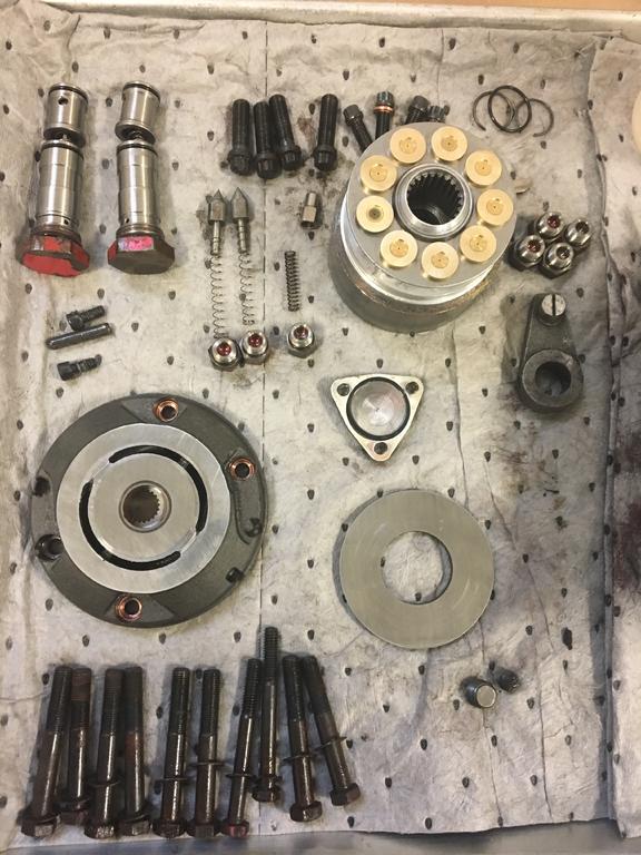

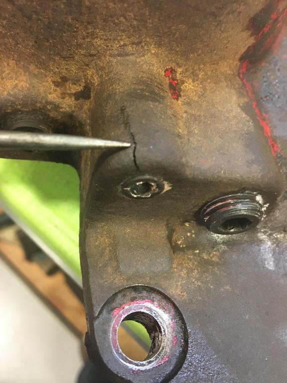

p38js 444 #97 Posted June 12, 2019 I swear this little tractor doesn’t want to go to the show, so I was trouble shooting the very slow in reverse motion and jerk your head off your shoulder and pull the front end off the ground. I noticed that when in reverse there was a trail of fluid, so here is the problem Share this post Link to post Share on other sites

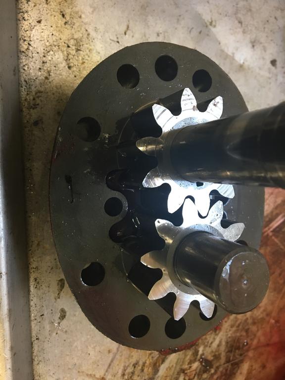

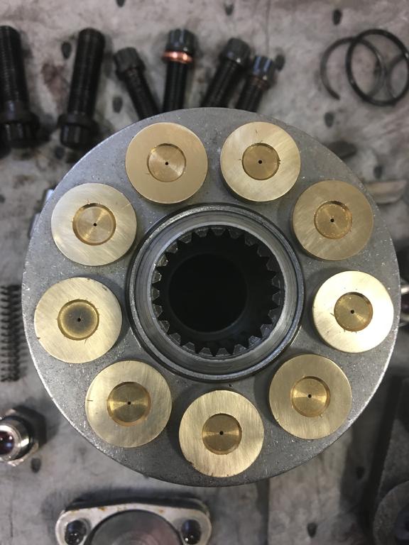

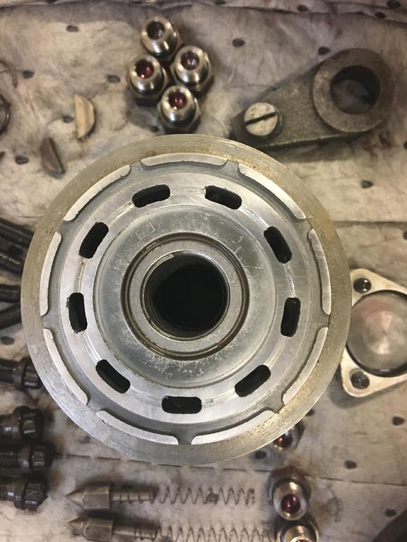

p38js 444 #98 Posted June 12, 2019 Lucky me I have 4 hydro units from several Gt14, I took one apart and inside was completely trashed but the housing for the drive gear is in good shape, I now have two cuted hydros now to make a Frankenstein hydro hoping for the best 2 Share this post Link to post Share on other sites

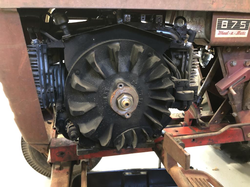

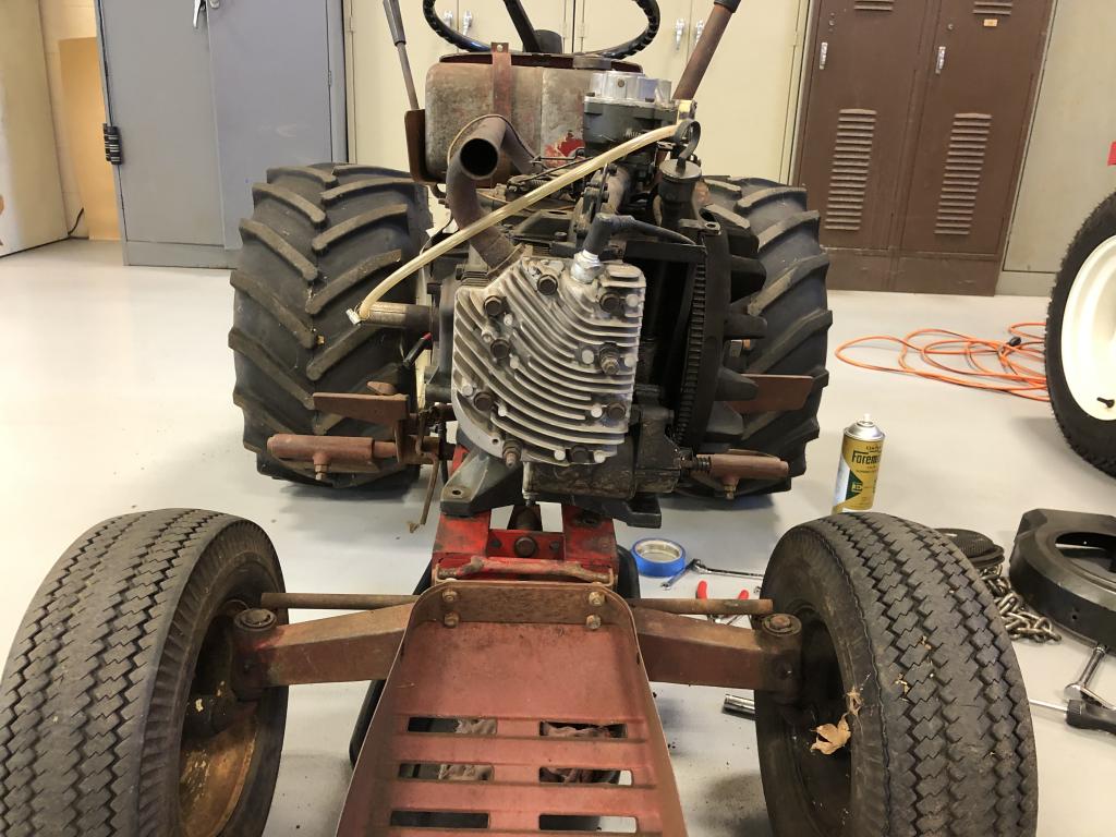

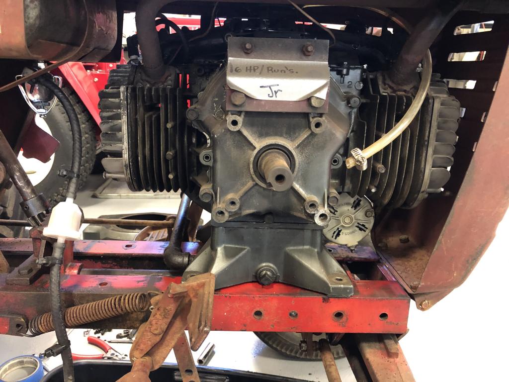

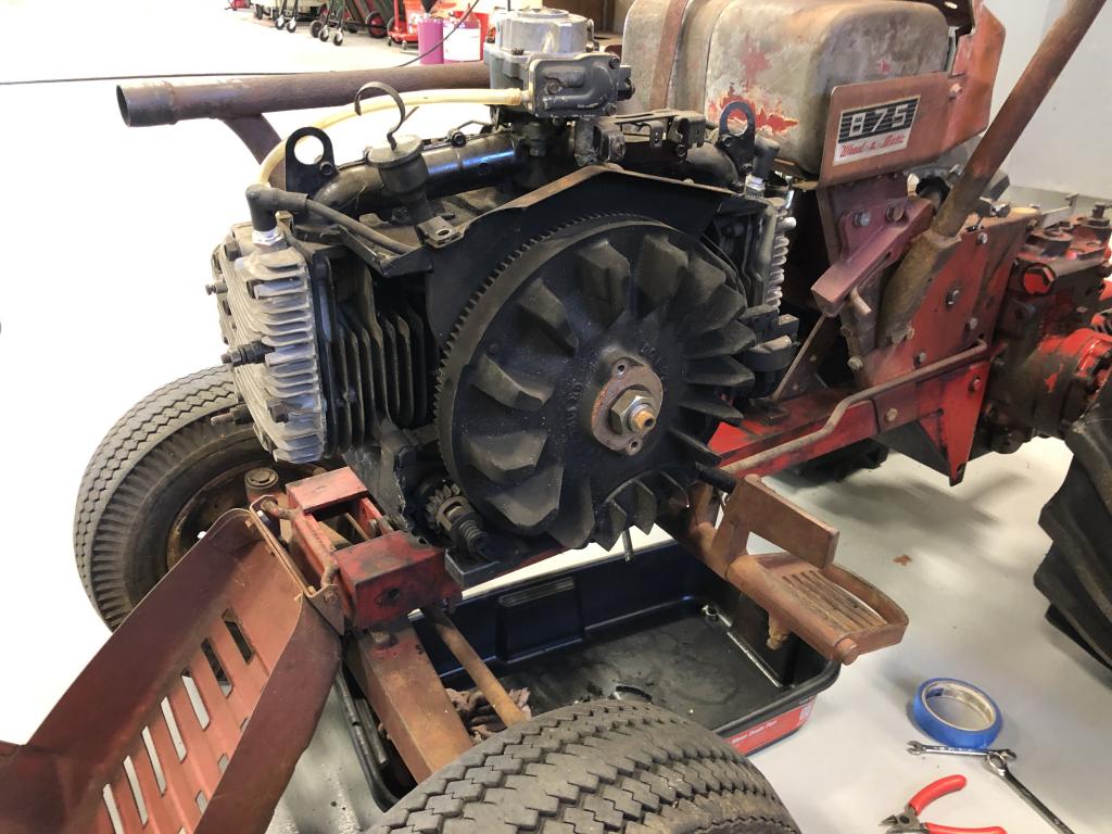

p38js 444 #99 Posted December 3, 2019 Ok guys here it is twin Briggs on a 875, has anyone tried this yet need a little help, looking for options on an air filter, and trying to cut as little as possible out of the hood here is what I got so far, I’m going to get a 1/4inch piece of flat steel to mount the engine on so I can move it around on the frame 1 3 Share this post Link to post Share on other sites
Pullstart 71,561 #100 Posted December 3, 2019 So cool! Once you get the 1/4” plate under the engine, try cutting various blocks of wood at a certain thickness to sit on the carb and see if the hood clears. In die making we used modeling clay to run a die over in the press to see where the stop blocks needed to be. Maybe you could build a carb hat to relocate the filter like the GT-14? 1 1 Share this post Link to post Share on other sites
