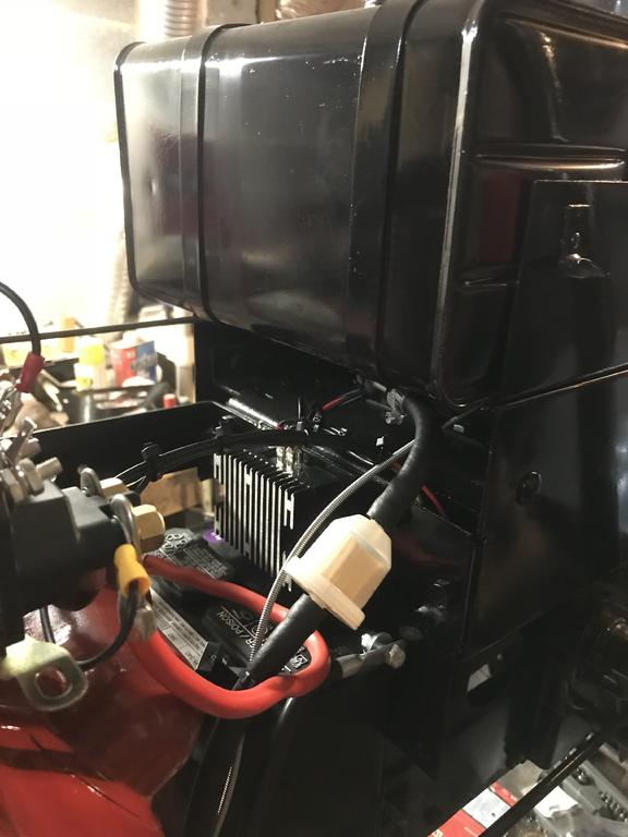

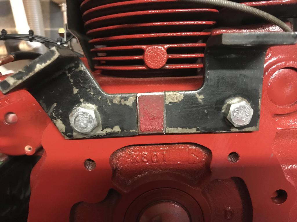

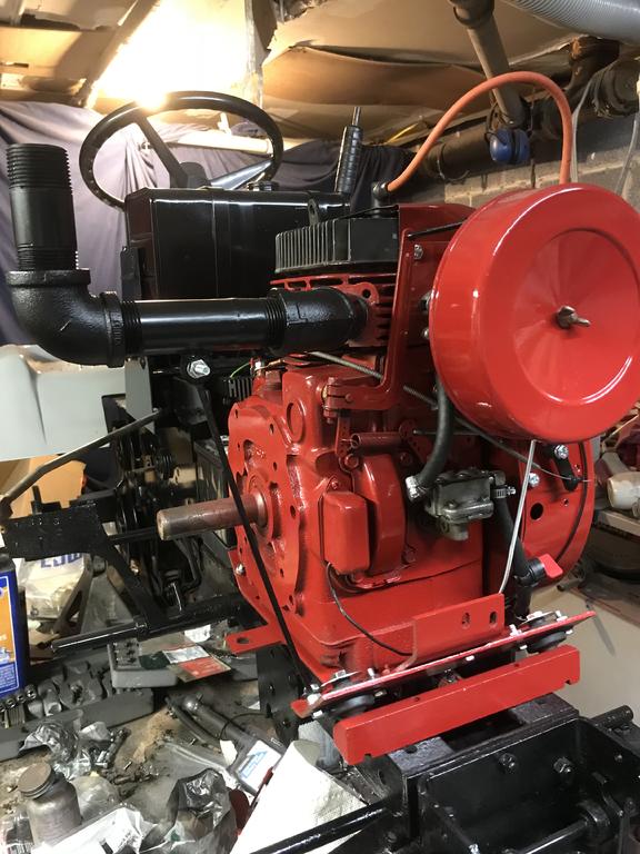

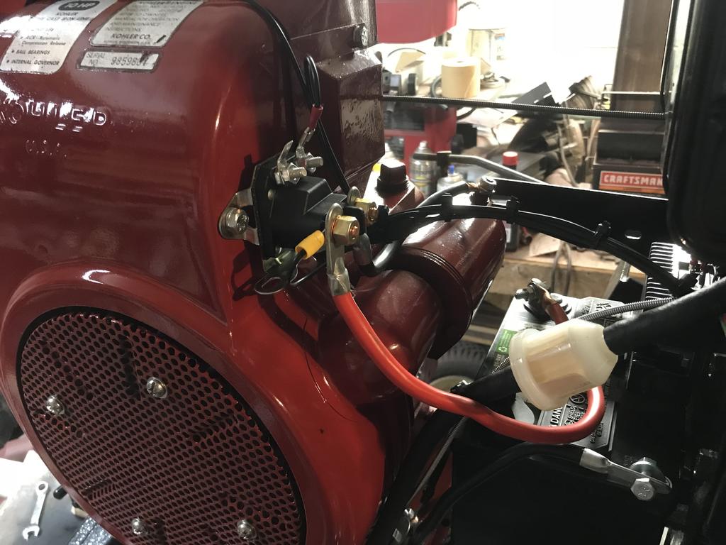

dells68 7,499 #54 Posted December 23, 2018 12:35 am. Stopping for a few hours. Tomorrow looks like putting the tin back on, seat on, floor boards, pto setup, and decals. Then comes the fun of cleaning up the mess I’ve made. You’d die @WHX21! Here are a few shots I took earlier tonight. The last one shows how much I had to stretch the upper pto mount to fit the Kohler - it was on the Briggs. All the engine needs is gas and a whole lot of luck! 2 6 Share this post Link to post Share on other sites

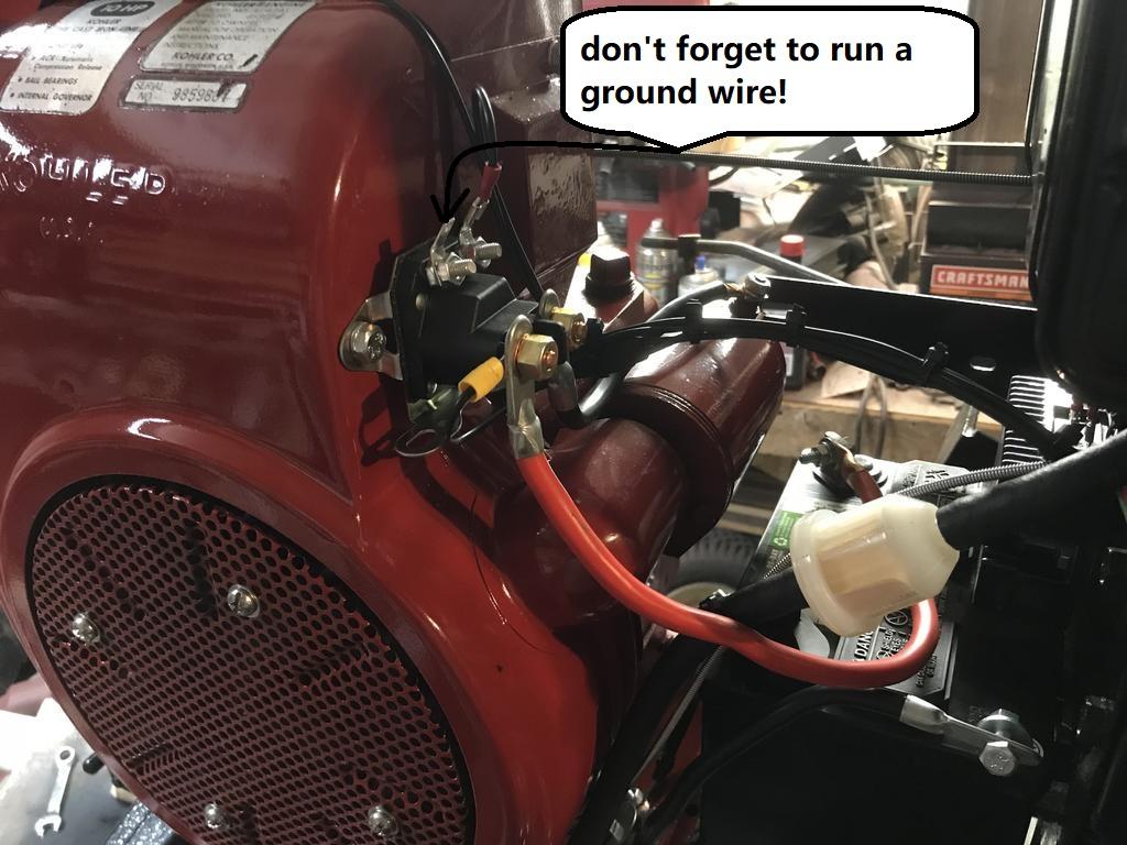

953 nut 68,869 #55 Posted December 23, 2018 Looking good! There is one little thing. 3 Share this post Link to post Share on other sites

dells68 7,499 #57 Posted December 23, 2018 Thanks Richard! I was so tired when I quit last night that I overlooked that! I would have been saying a few choice words wondering why it wouldn’t start and trying to figure out what was wrong! Time to go back again! Fingers crossed I’ll get her done today! 2 2 Share this post Link to post Share on other sites

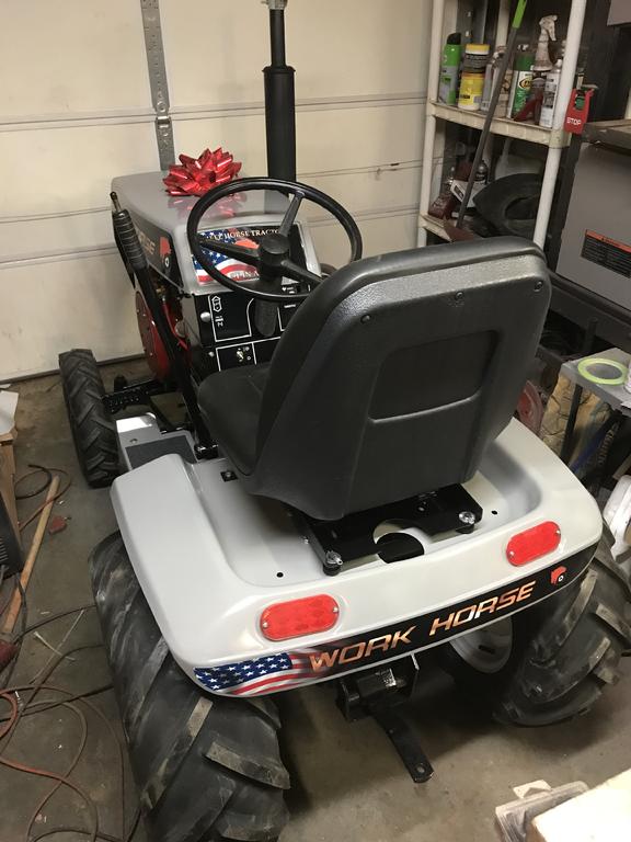

dells68 7,499 #60 Posted December 24, 2018 Well, it’s got wheels and a seat now. Fought it all day long trying to get it to run. Finally after changing points and carb got it to run for a while. Carb doesn’t seem quite right. Very hard to start. Disassembled it and will rebuild it tomorrow night. Not gonna make it all together, but maybe I can get it running. This one has fought me all around from the sheet metal on! 2 1 Share this post Link to post Share on other sites

dells68 7,499 #67 Posted December 25, 2018 Little Emory asked me on the way home if I would work on his tractor tonight. I couldn’t tell him no. I rebuilt the carb and that helped a little. There is still a little something with the ignition or fuel. It’s hard to start and searches as it runs. I’ve tried two sets of points, two condensers, and two fuel pumps. I’m sure it is something simple that my exhausted brain can’t understand. I may have to make a little trip to see @oldredrider soon and get him to help diagnose it and work his magic. I don’t mind a trip for Emory at this point. I’ve almost got all of his decals and finishing touches on, so he can see it in the morning. I told Dad that the only thing that matters to me now is that Emory enjoy his Christmas. Today has put a whole new perspective on everything! Gotta go finish before Santa catches me. Merry Christmas! Pics to come tomorrow. 1 3 Share this post Link to post Share on other sites

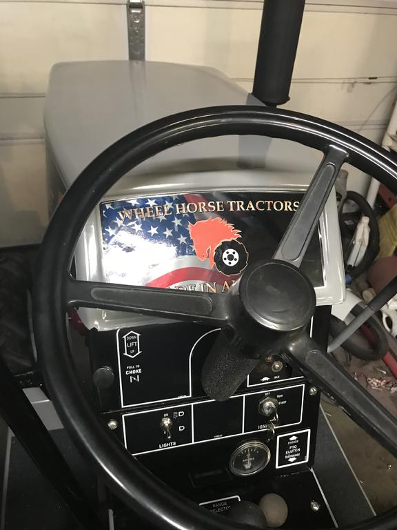

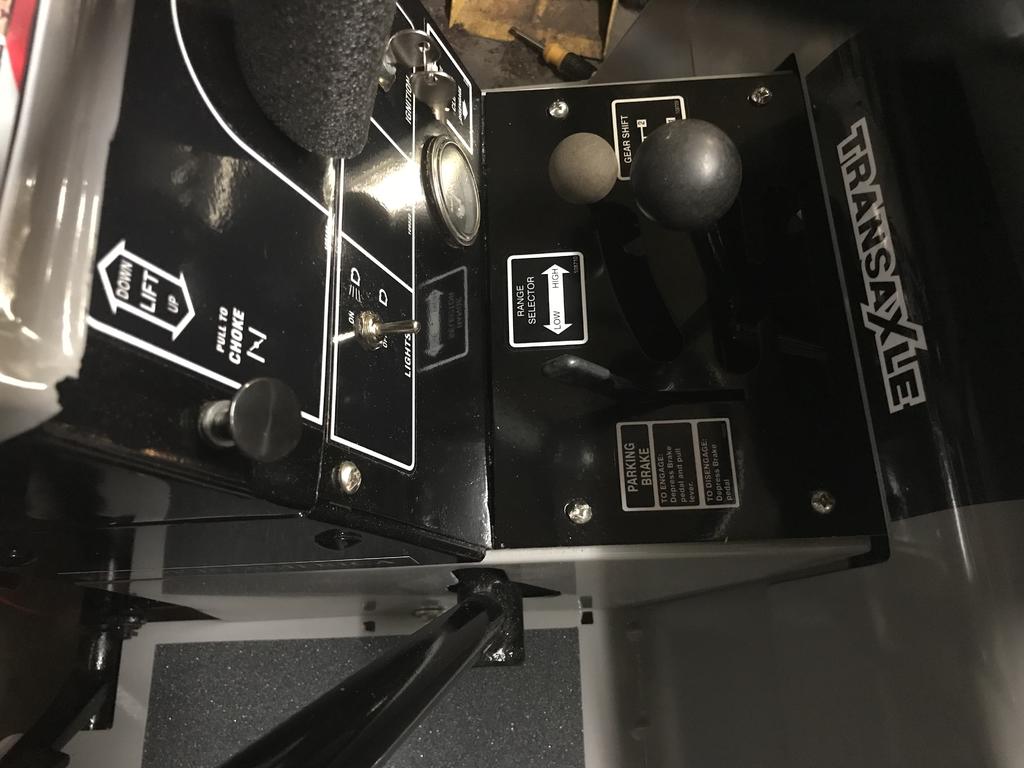

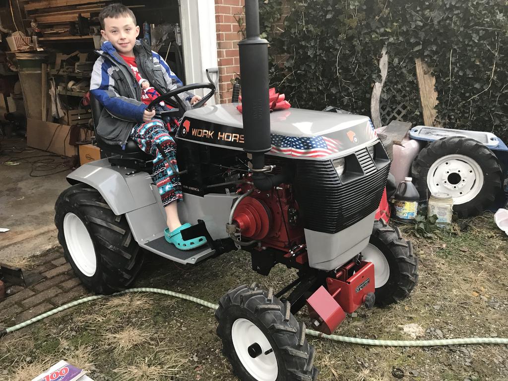

dells68 7,499 #69 Posted December 25, 2018 Thanks Ritchie. I’m just happy to have him here this morning. That was the scariest thing I’ve ever been through! I did finish assembly this morning on the tractor in time to get a few hours sleep. He’s happy, even if it’s not running. I’m sure it’s something simple, I’m just not sure what. Engine charges good and is strong, just a hard start and surging issue. I’ll check it a little more later this week. Here are a couple of pics of him on it. Thanks to everybody who has helped me on this project, @oliver2-44, @oldredrider, @Vinylguy, and many others! 5 14 1 3 Share this post Link to post Share on other sites
ebinmaine 80,465 #70 Posted December 25, 2018 Well played Dell. Some impressive. 2 1 Share this post Link to post Share on other sites
rjg854 13,331 #71 Posted December 25, 2018 For someone that was so hard pressed for time on this project, that is one fine looking tractor, for sure! 2 2 Share this post Link to post Share on other sites

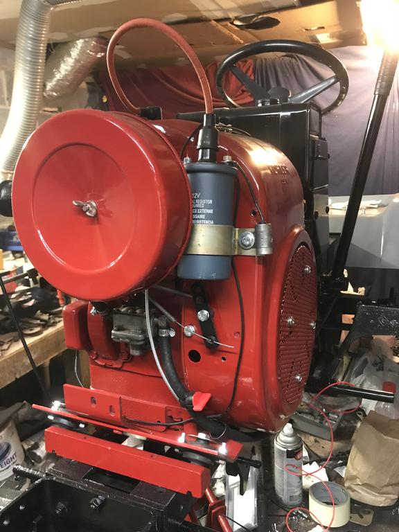

Achto 32,539 #72 Posted December 25, 2018 Extremely sorry to hear about Emory's health issues and I'm very glad to see that he could be home for Christmas. May God keep him healthy & safe. He looks quite proud of his tractor, what a great gift. Excellent work on it. As for your running issue, I noticed something in this pic that may or may not be the issue. I can't quite make out the wording written on the coil, but does it say that it requires a resistor wire or external resistor? If it does say that then you either need to add the resistor or replace the coil with one that has an internal resistor. Merry Christmas!! On 12/22/2018 at 11:43 PM, dells68 said: 2 1 Share this post Link to post Share on other sites

dells68 7,499 #74 Posted December 25, 2018 I’ll check that on the coil @Achto. It was supposed to have an internal resistor, it with parts places today, who knows! For now, off to the inlaws and Dad’s for Christmas there! 3 Share this post Link to post Share on other sites
