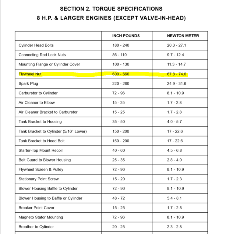

Tractorhead 9,217 #26 Posted November 22, 2018 Honestly i dont know the specific torque at your Engine, think Garry has an Datasheet therefore where you can get your Enginespecific torques. But as far as i meant, it shall be 60-65 lbf ft thats about 81-89 nm. that are common values, i know about. Share this post Link to post Share on other sites
SimonC 35 #27 Posted November 22, 2018 I took the number from the Tecumseh engine manual. Nut was rather easy to unbolt with the impact. Just not sure how I'll put it back now. I sure hope I'm wrong. Share this post Link to post Share on other sites
Tractorhead 9,217 #28 Posted November 22, 2018 It seems to me on your Pic, that the thread is a finethread - think ist called a unf thread- this is for me a indicator, that the torque is not as strong as a normal thread. 800 nm seems to me too much. I had only once 800 nm, that was on a old mercedes Truck used by Piston rod. It was in 4 steps - first 90nm than 180 nm then 2x 90 dregrees. I need a lot of force and a special torquewrench to realize that. but i will not believe, this torque is used on a flywheel. Share this post Link to post Share on other sites
Tractorhead 9,217 #29 Posted November 22, 2018 (edited) It seems to me on your Pic, that the thread is a finethread - think ist called a unf thread- this is for me a indicator, that the torque is not as strong as a normal thread. 800 nm seems to me too much. I had only once 800 nm, that was on a Truck. Added: Found a technical Service Tecumseh manual for Lan mower Engines -12HP. in German, in wich the Flywheel torque at 50 Nm or 35 ft pds is given. Edited November 22, 2018 by Tractorhead Added info Share this post Link to post Share on other sites
pfrederi 21,183 #30 Posted November 22, 2018 21 hours ago, SimonC said: do I see this right,, 600-650 ft pound torque for the flywheel nut. What you guys do, I think my impact only goes up to 500 or 550 in that direction, and my 1/2 inch torque wrench only does 250 .. thanks Simon Think you misread the manual it is 600-660 Inch lbs or 50-55 ft lbs 1 Share this post Link to post Share on other sites
SimonC 35 #31 Posted November 22, 2018 (edited) ohhh ... inch pounds .. I see my mistake thanks Simon Edited November 22, 2018 by SimonC Share this post Link to post Share on other sites
