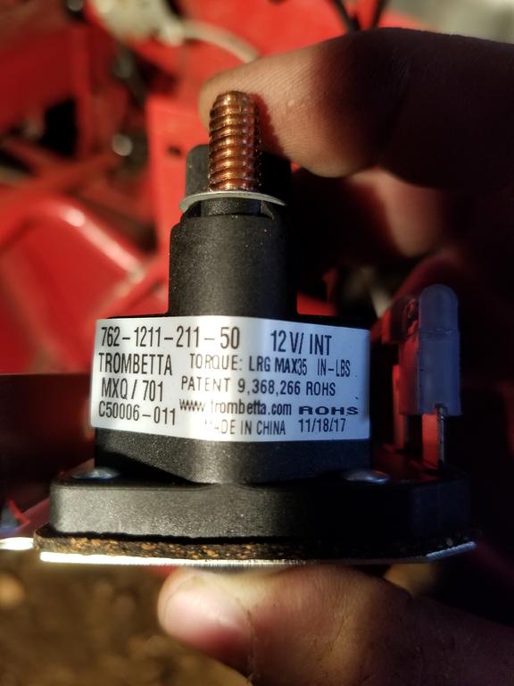

SimonC 35 #5 Posted November 13, 2018 behavior was happening before I replaced the switch, actually made me think it was the culprit as I had other issues with the switch. The switch I installed is this one: https://www.stens.com/430-070-ignition-switch I went to the local store and got a tractor and lawn solenoid (https://www.canadiantire.ca/en/pdp/mtd-replacement-tractor-solenoid-0607533p.html#srp), it is however quite a lot smaller than my current one. attaching a picture of the sticker on it. Just wondering if it'll be good enough. The terminal size are also quite smaller on it. thanks Simon Share this post Link to post Share on other sites
ebinmaine 79,518 #6 Posted November 13, 2018 Looks like you got the right ignition switch. So you should be okay there. I'll let somebody with more expertise answer as to whether you could use that solenoid. I don't see any ratings for amperage on it. 1 Share this post Link to post Share on other sites
pfrederi 20,828 #7 Posted November 13, 2018 We aren't starting a 12 cylinder diesel here. That solenoid will work just fine. 1 3 Share this post Link to post Share on other sites
SimonC 35 #8 Posted November 13, 2018 1 minute ago, pfrederi said: We aren't starting a 12 cylinder diesel here. That solenoid will work just fine. doh!, there goes my next planned upgrade... thanks guys, I'll have to go source some nuts because everything from the old dont fit on the new, plus the new has flat connector for the small terminal instead of screwed in... Simon 1 1 Share this post Link to post Share on other sites

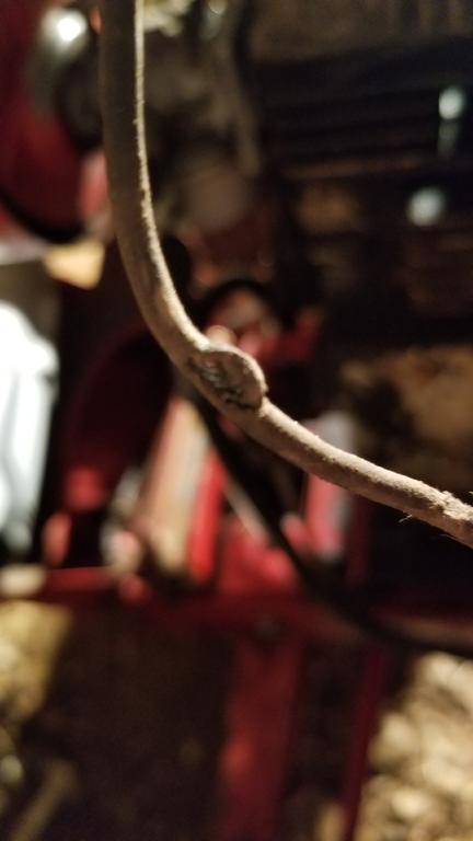

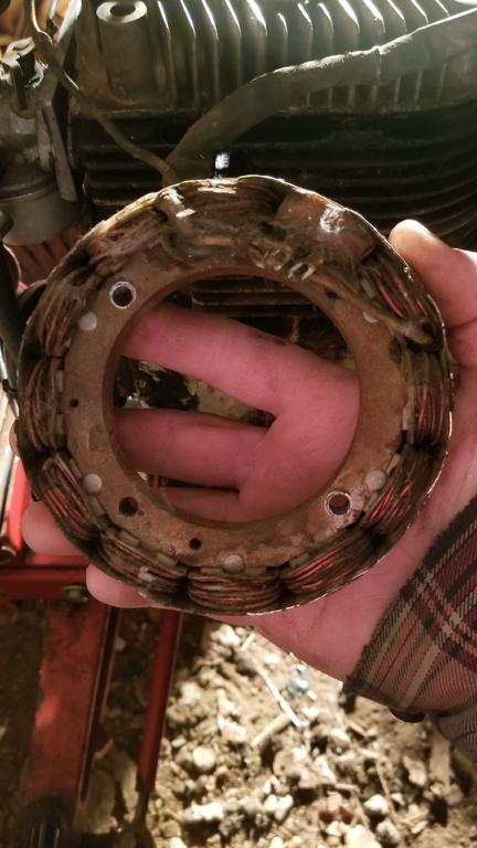

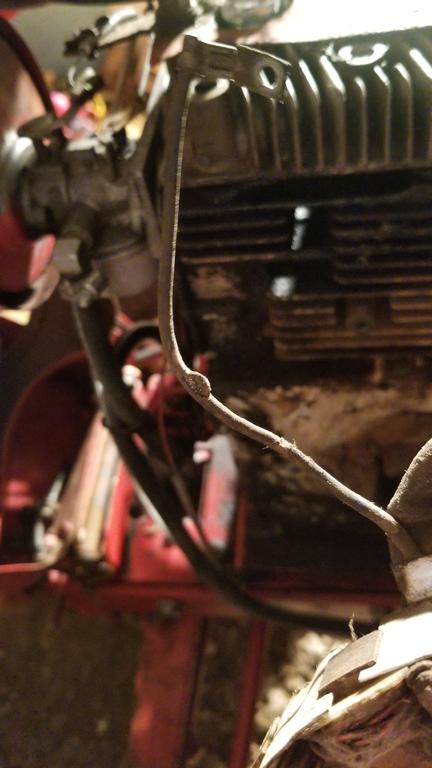

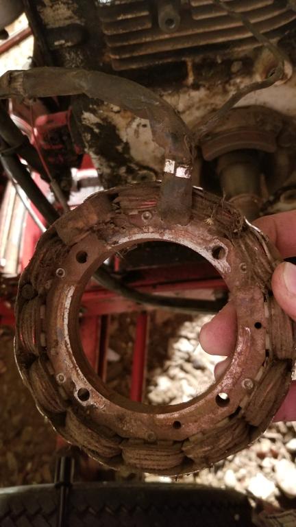

SimonC 35 #21 Posted November 21, 2018 Hi, just started taking things apart to do a visual inspection first. WOW, never seen so much spider nest (white balls) in such a small space. I found a pinched wire, it doesn't seem to be cut, but I'll let you guys tell me what you think. some pictures Share this post Link to post Share on other sites
SimonC 35 #22 Posted November 21, 2018 in addition, the metal under the ignition unit (which reads the trigger pin position) was damaged a bit, surface is not fully flat. Simon Share this post Link to post Share on other sites
pfrederi 20,828 #23 Posted November 21, 2018 Did you check the coil lead (smushed wire) IAW test f. above? if it passes the test 400 ohms the put some friction tape over the bad place reinstall and check the air gap. 1 Share this post Link to post Share on other sites
Tractorhead 9,217 #24 Posted November 21, 2018 (edited) 6 hours ago, pfrederi said: Did you check the coil lead (smushed wire) IAW test f. above? if it passes the test 400 ohms the put some friction tape over the bad place reinstall and check the air gap. I would prefer a shrinktube instead of friction Tape. a cautional cleaning with a smooth brush under water with bit of soap. dry by carefully blown with Hairdryer max airlevel light heat level - never use a heat Gun, because it can be quickly too hot. After dry, take a closer look also to the cable harness in your second Pic upper left side, that it was not squeezed by mounting at all. it seems to me, here is also the insulation bit squeezed and lightly ripped. Please check. control also there are no sharp edges on the covers where cable harness will be passed thru, they can cause shorts. By the Way, control please the whole Wire Harness at the Tractor, especially where harness will be covered by Metal, that nothing scraps the insulation. If so, reseal the insulation and remove sharp edges by a file. You must prevent anything can harm any insulation. because of the age and the state i have seen i your pics, if all connectors are well crimped and still have good conductive. If the contacts have verdigris, clean them and protect the contacts by petroleum jelly with a brush. About the Metal surface under the Ignition, use carefully a steelbrush if possible and after that a steelwool to remove rust and dirt. Make it metallic blank, to get good conduction. if needed use a piece of sandpaper with about 240 grain size, to bring it metallic blank. on my old Onan, i have at the beginning also bit troubles with missfire while the Magneto was strong corroded. After i cleaned it with sandpaper and correct the gap, it fires much better as before and missfires was eliminated. Hope i can help you, to bring your Engine quick back to work. Edited November 21, 2018 by Tractorhead Addon 1 Share this post Link to post Share on other sites

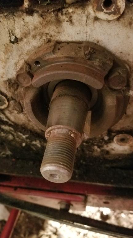

SimonC 35 #25 Posted November 21, 2018 do I see this right,, 600-650 ft pound torque for the flywheel nut. What you guys do, I think my impact only goes up to 500 or 550 in that direction, and my 1/2 inch torque wrench only does 250 .. thanks Simon Share this post Link to post Share on other sites
