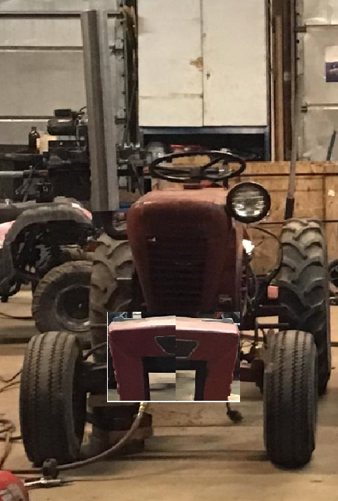

Pullstart 71,350 #176 Posted October 28, 2018 My crude Microsoft Paint doings... 1 1 Share this post Link to post Share on other sites
953 nut 69,719 #177 Posted October 29, 2018 You do nice work Kevin, but I think having it lower like the front weight on "Put-Put" looks better and doesn't compete with the grill. 1 Share this post Link to post Share on other sites
Pullstart 71,350 #178 Posted October 29, 2018 26 minutes ago, 953 nut said: I think having it lower like the front weight on "Put-Put" looks better and doesn't compete with the grill. I agree. I successfully convinced my wife that I should start over too. 2 Share this post Link to post Share on other sites
ebinmaine 80,867 #179 Posted October 29, 2018 31 minutes ago, 953 nut said: You do nice work Kevin, but I think having it lower like the front weight on "Put-Put" looks better and doesn't compete with the grill. 3 minutes ago, pullstart said: I agree. I successfully convinced my wife that I should start over too. Agreed. I like the idea you have in the Microsoft paint pic. 1 Share this post Link to post Share on other sites
Pullstart 71,350 #180 Posted October 30, 2018 I showed Rylee this morning what I had built, she says “that looks like a trash can.” And there we have it! I’m a good trash can builder! 4 Share this post Link to post Share on other sites

LengerichKA88 1,885 #183 Posted October 30, 2018 (edited) 18 minutes ago, ebinmaine said: she and I jokingly tell people that we are anywhere between 5 and 12 years old on a pretty regular basis. I tell people all the time that I’m just a hairy 12 year old 😂 id pay good money for a trashcan like that 😉😂 i liked the first battery box, but this one does seem to fit more. Edited October 30, 2018 by Lengerich8 Didn’t finish my thought 1 Share this post Link to post Share on other sites

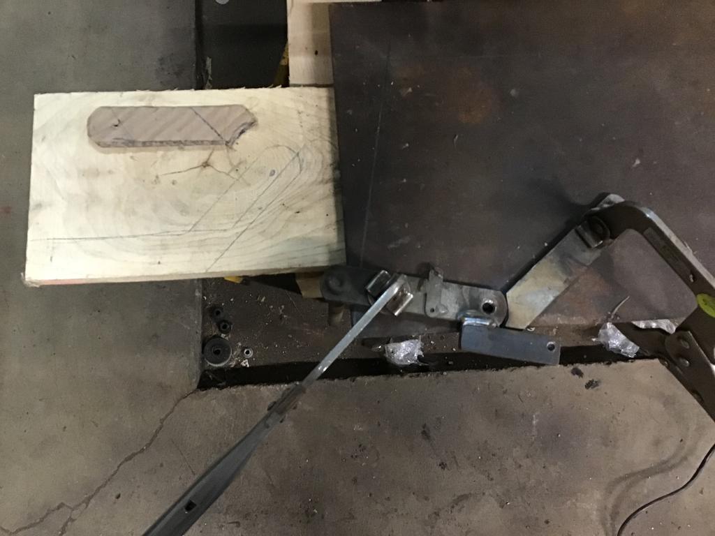

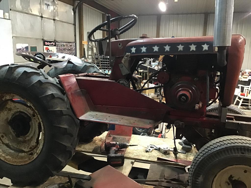

Pullstart 71,350 #186 Posted October 31, 2018 Switching gears for a bit, while I think of something better for the battery box. I’ll need to customize the belt guard and I didn’t like the parking break setup. From what I hear, it’s just a good way to tear up the insides of the transmission and pump if it gets jammed while in motion? I have a question for @19richie66 or @daveoman1966, or anyone else who knows these sunstrand transmissions: What lever position activates the parking break on the trans? I assume up is engaged, down is free? I want to set it in the free position and put a solid link in place. I modified the tensioner and the motion control lever a bit, now I can begin working on the belt guard. 1 Share this post Link to post Share on other sites

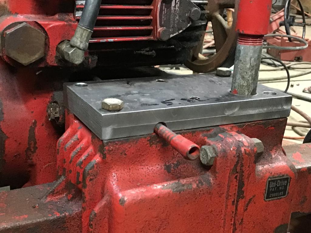

Pullstart 71,350 #187 Posted October 31, 2018 Used a ball end mill and clearances a groove for the lift cable to pass under the seat spacer. 2 2 Share this post Link to post Share on other sites

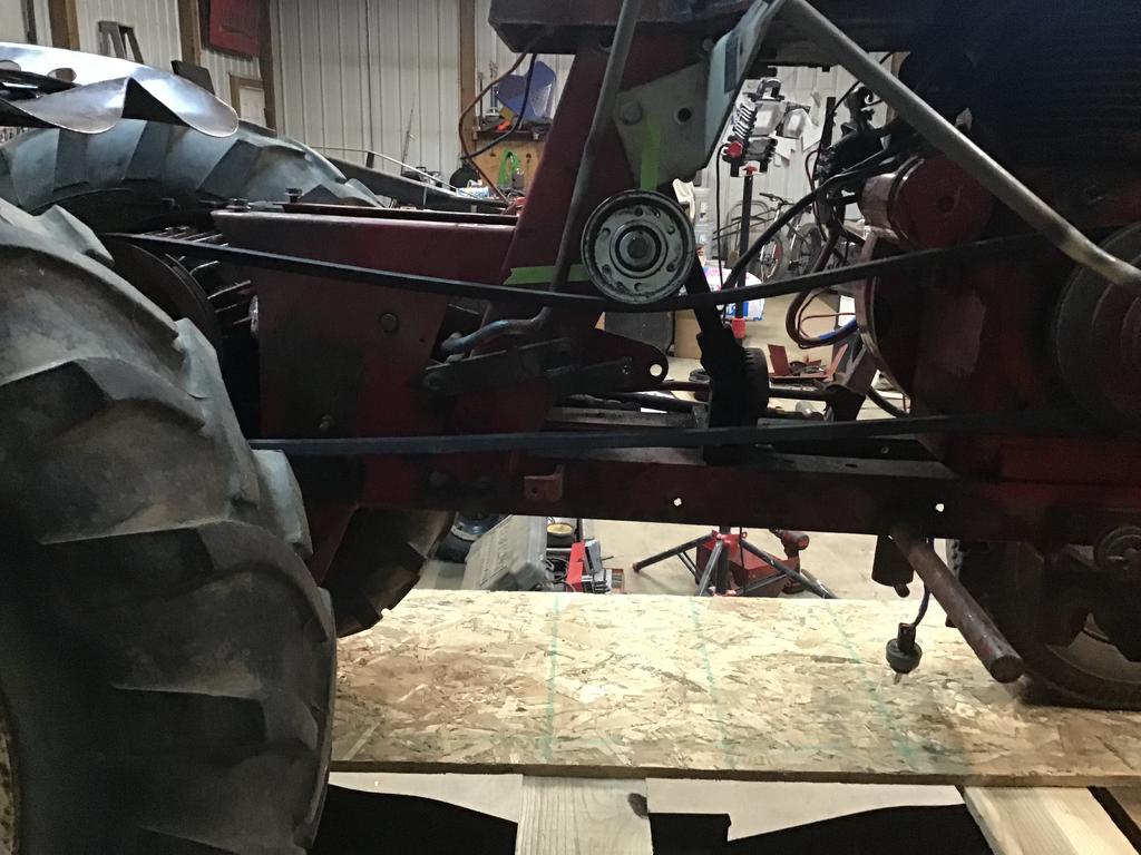

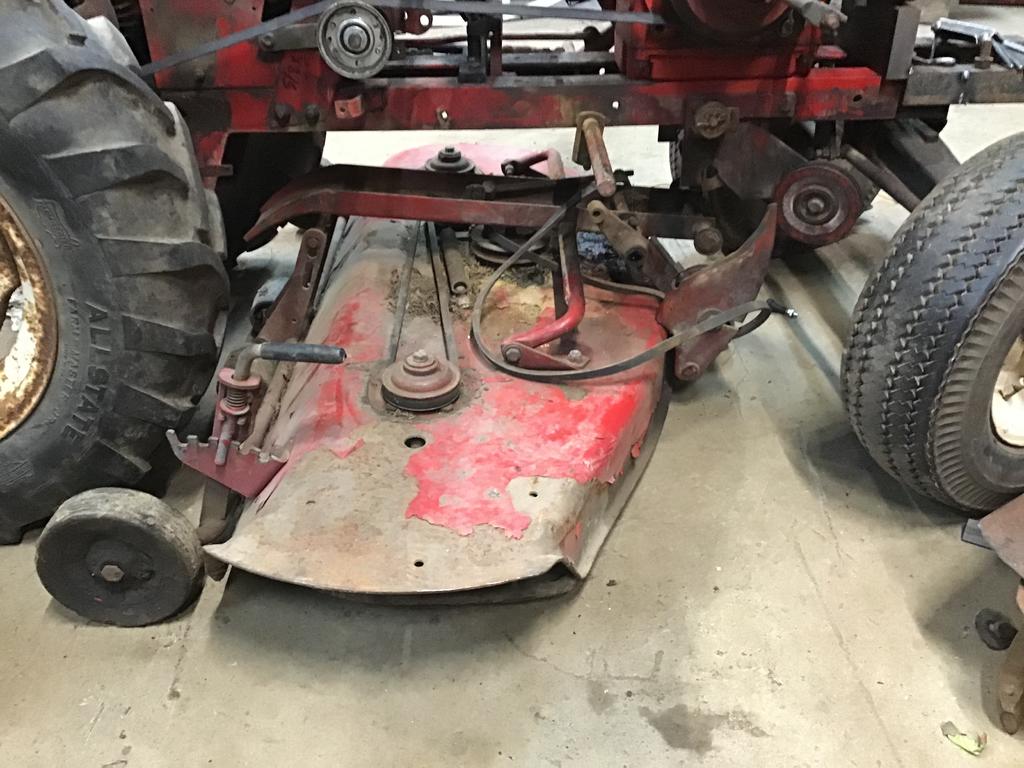

Pullstart 71,350 #188 Posted November 1, 2018 Well @953 nut it looks like I’ll still be able to run the deck under this with the big wheels. I might need to adjust the lift link to reach the ground of course! 1 1 Share this post Link to post Share on other sites

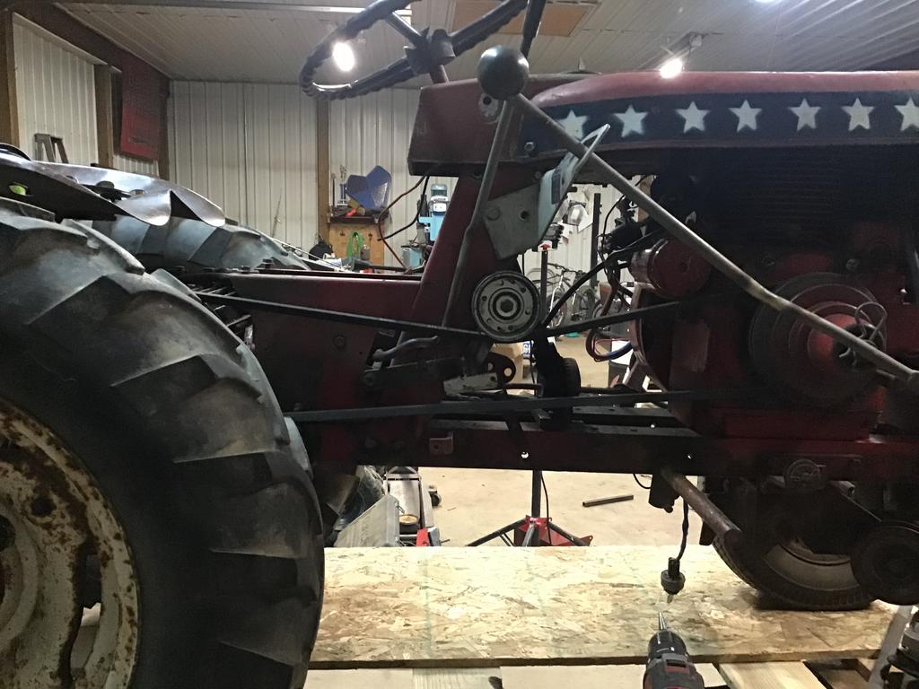

gwest_ca-(File Mod) 12,504 #189 Posted November 1, 2018 Is there a reason you have the idler pulley below the bottom span of belt? It is usually above the top span. Garry Share this post Link to post Share on other sites
Pullstart 71,350 #190 Posted November 1, 2018 3 hours ago, gwest_ca said: Is there a reason you have the idler pulley below the bottom span of belt? It is usually above the top span. Garry Space more than anything, I suppose. @pfrederi pointed out that it’s usually after the load instead of before. My thought was there will be tension regardless, so it wouldn’t matter. BUT, I’m in the trial and error period of the build and am not opposed to reworking a bit here or there. 1 Share this post Link to post Share on other sites
Tractorhead 9,217 #191 Posted November 2, 2018 9 hours ago, pullstart said: Space more than anything, I suppose. @pfrederi pointed out that it’s usually after the load instead of before. My thought was there will be tension regardless, so it wouldn’t matter. BUT, I’m in the trial and error period of the build and am not opposed to reworking a bit here or there. I'll think it would working, maybe needs a bit stronger spring, because of slip. On the other side if it must be changed, it could be solved by a pressing spring with a guide internally. As far as i see on the Pics, the tensioner roll will short be below or at same level as the belt when it's under load. Only the Swingarm of tensioner self, seems to be a bit to short therefore. Share this post Link to post Share on other sites
Pullstart 71,350 #192 Posted November 2, 2018 2 hours ago, Tractorhead said: I'll think it would working, maybe needs a bit stronger spring, because of slip. On the other side if it must be changed, it could be solved by a pressing spring with a guide internally. As far as i see on the Pics, the tensioner roll will short be below or at same level as the belt when it's under load. Only the Swingarm of tensioner self, seems to be a bit to short therefore. That’s a good idea Stefan, maybe I’ll have to upgrade to a pump driven hydraulic tensioner like timing belts in cars 1 Share this post Link to post Share on other sites
gwest_ca-(File Mod) 12,504 #193 Posted November 2, 2018 As a load is applied to the belt the bottom span will get real tight and the top span will get looser. With the idler on the bottom that will apply a lot of pressure on the idler and the spring holding it there will lose it's tension as the idler is pushed down by a tighter belt. With the idler on the top the spring only has to take up the lose belt that the increased load generates. A V-idler inside the belt at the bottom would still get a lot of pressure but the spring tension would increase in your favor. Problem with that is the amount of belt in the pulley grooves is reduced and increases the chance of belt slippage. A belt guard must support the tight or drive side of the belt when the belt is loose for the clutch to be effective. Doing so leaves the top span of belt with lots of slack so it leaves the engine pulley and ceases to drive. Garry 3 1 Share this post Link to post Share on other sites
Pullstart 71,350 #194 Posted November 2, 2018 I’ll plan to change this as soon as I get out to the shop again, thanks again for the explanations guys! 2 Share this post Link to post Share on other sites

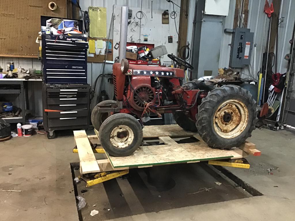

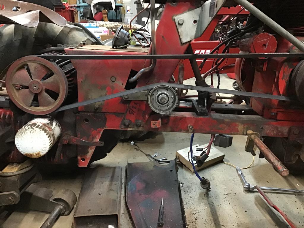

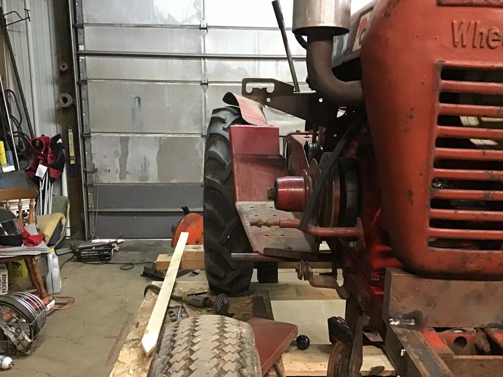

Pullstart 71,350 #195 Posted November 3, 2018 @gwest_ca, @pfrederi, this look a little better? I’ll extend the tensioner bracket to get to the pulley. Working with my new tractor pallet on the lift! 2 1 Share this post Link to post Share on other sites
Tractorhead 9,217 #196 Posted November 3, 2018 Looks much better, wish to have a workshop like you. so i allway's must wait for bigger changes.👍 1 Share this post Link to post Share on other sites

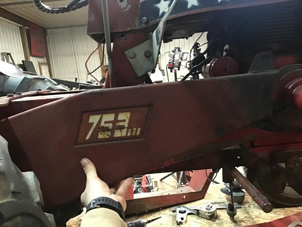

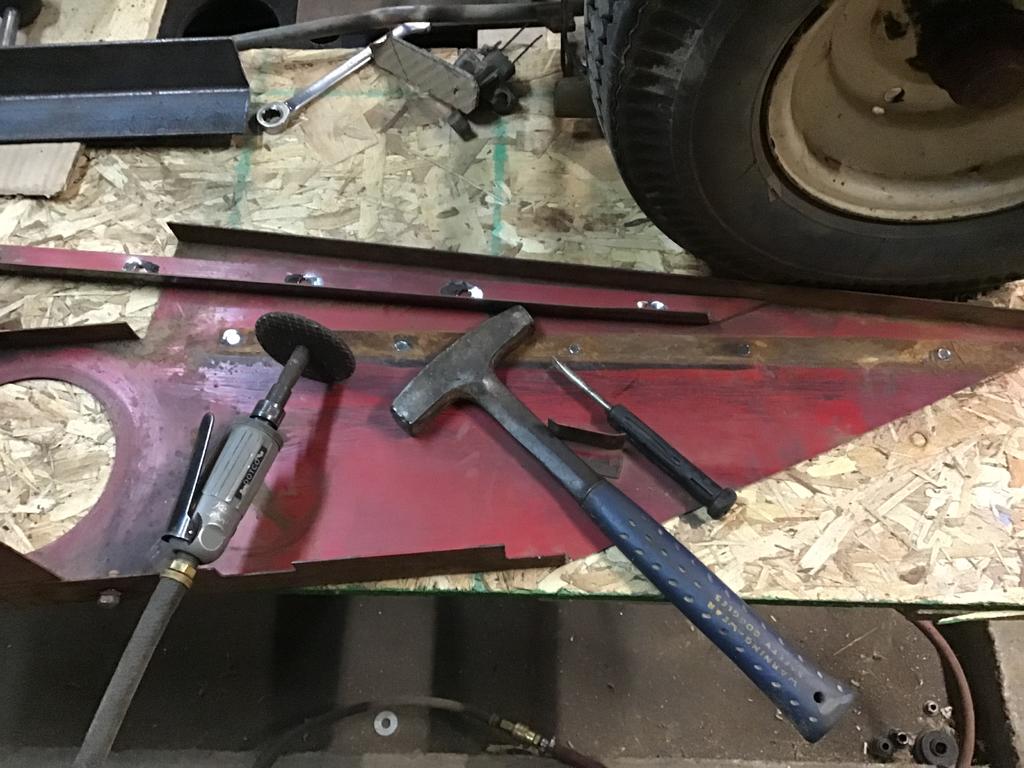

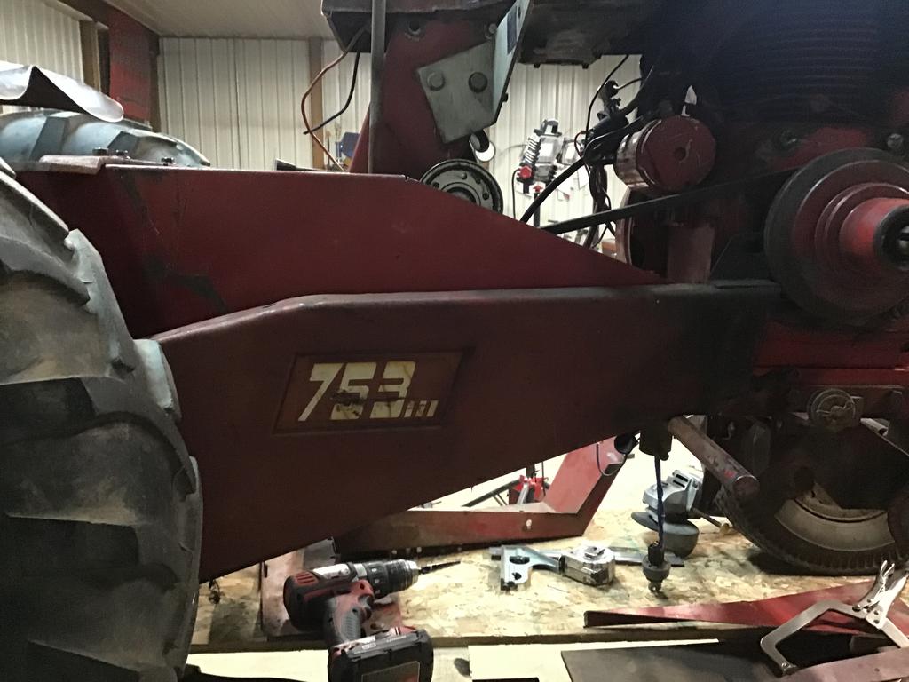

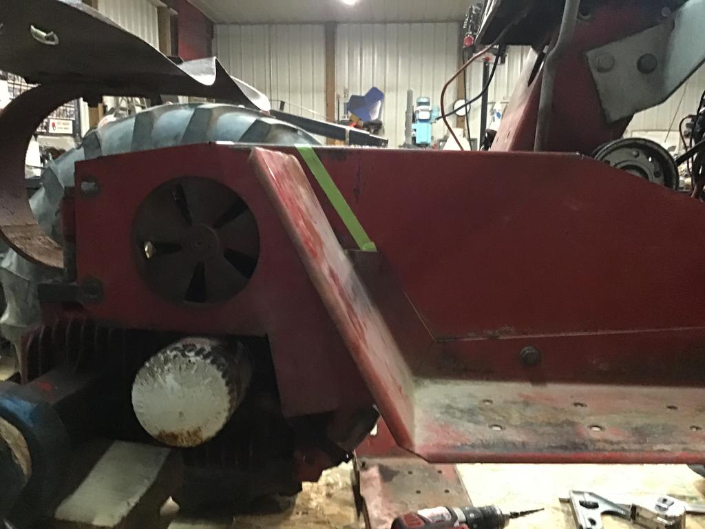

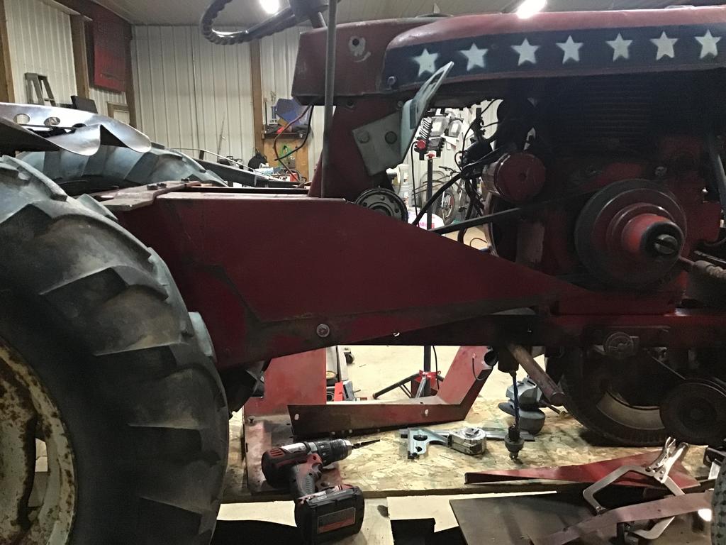

Pullstart 71,350 #198 Posted November 3, 2018 Belt guard work... starting with Charger 12, contemplating using the 753 tin too. I like the indentation for a “1073” decal and I think the overall shape would be period correct. 1 Share this post Link to post Share on other sites

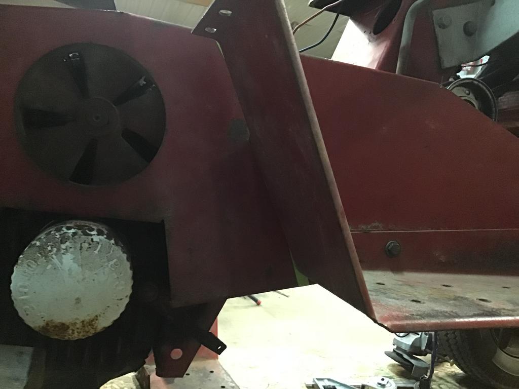

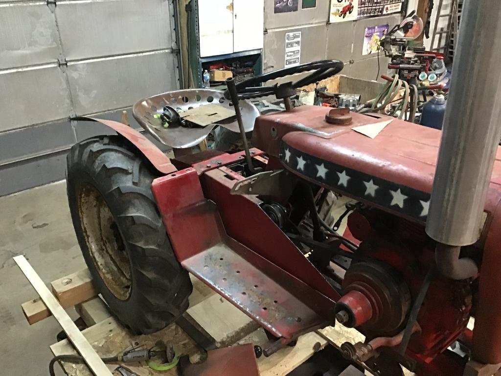

Pullstart 71,350 #199 Posted November 3, 2018 Now, I know I just said period correct, but I’m committing a crime even posting these next pictures. I think I want to use floor boards. I want to keep this comfortable and easy to use / get on and off. I know they don’t look great the way the are and they don’t even fit with the big wheels, but I’m up for suggestions. Narrow them? Cut the back off and use just the bottom surface? Both? 2 Share this post Link to post Share on other sites

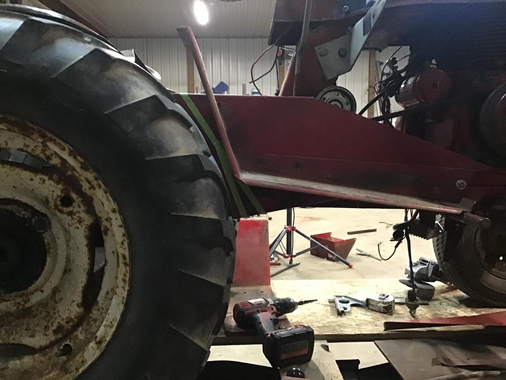

Pullstart 71,350 #200 Posted November 3, 2018 Using some tape as a reference, you can see the interference between the tire and floorboard. Without the upper “fender” support bar, there is a lot of deflection with me stepping on it, I’d need to add a rear support under the bottom, but I’m leaning towards using the bottom only instead of narrowing them up to clear the tire. Share this post Link to post Share on other sites
