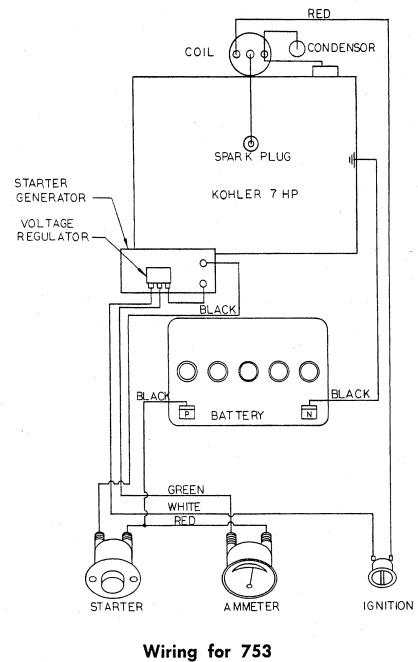

Pullstart 70,549 #26 Posted October 10, 2018 First things first, trying to get it to run and move by itself. The coil is missing and the top of the voltage regulator is loose, making me question it’s integrity. I popped a battery in, got a new s/g belt and pushed the button. From what I can tell on the wiring diagram, I shouldn’t need a key to get it to roll over, correct? I get a click out of the reg, but no starter movement. Of course, the wiring looks a tad hokey, so the next logical move is to pull the switches and ammeter out of the dash and check the wiring. Share this post Link to post Share on other sites
953 nut 67,328 #27 Posted October 10, 2018 4 minutes ago, pullstart said: I shouldn’t need a key to get it to roll over, correct? I get a click out of the reg, but no starter movement. Of course, the wiring looks a tad hokey, so the next logical move is to pull t You are correct. You do need good wiring and a good S/G. Jumper cables directly to the S/G will let you know if it will turn over. 1 Share this post Link to post Share on other sites
Pullstart 70,549 #28 Posted October 10, 2018 4 minutes ago, 953 nut said: You are correct. You do need good wiring and a good S/G. Jumper cables directly to the S/G will let you know if it will turn over. Wouldn’t ya know, there’s a pair of cables right next to the tractor... 1 Share this post Link to post Share on other sites

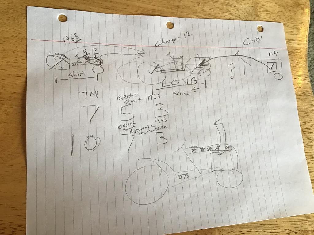

Pullstart 70,549 #29 Posted October 17, 2018 Ok, please shoot me down if I’m off my rocker. I have a C-101 that lost the trans to a project and has a spare 8 speed sitting under a bench waiting to be re-assembled. Runs great, but is starting to become a parts rig after yanking the trans. I picked up that Charger 12 with a broken connecting rod. I have no reason to believe the trans isn’t fine, if it was parked because the rod broke. and Momma’s 753. I jumped the generator straight from the battery and it only barely budges the belt, maybe 1/16”. Trans is locked up. Now... my evil mind hit me tonight when I was arranging the garage. 753 tins, Charger 12 auto trans (has hydraulic lift too), 10 horse thumper. I think with some creativity, I might-could shoehorn the 10 under the round hood without cutting the hood with an exhaust stack OR mandrel bent header and creative engine placement... even if I have to channel or Z-notch the frame. I’ve got the spare 502 frame if I screw it up too bad. I’m sure a belt guard would have to be modified heavily. I bet Momma would love the auto trans, if it worked correctly! Ideas, input, rotten tomatoes? Toss whatever you have my way... worse that can happen is I dream about tractors for no good reason yet another night. 1053-A? Other model number ideas that would make sense? 1 Share this post Link to post Share on other sites
ebinmaine 79,593 #30 Posted October 17, 2018 With the right amount of persistence anything can and will work. 2 Share this post Link to post Share on other sites
953 nut 67,328 #32 Posted October 17, 2018 7 hours ago, pullstart said: 1053-A? Other model number ideas that would make sense? I like the direction you are going with this. Best bet may be to adapt the sheet metal from the 753 to the Charger 12 chassis to avoid having to recreate the speed control/direction control mechanism. It would end up being a 1073. First digit/digits = HP Center digit = 5; electric start, 7; hydro-static with electric start Last digit = Year. 2 Share this post Link to post Share on other sites

82Caddy 851 #36 Posted October 17, 2018 (edited) If you want to stuff a big block kohler under a short frame hood, you'll need a few things: -Short oil pan (available on eBay ~30$), will need to trim the oil dipper for the short pan -Fill gap on bottom of big block engine where pan doesn't cover the overhang. There is a thread made by Kelly about identifying kohler block styles. Check that out for more details about what needs to be done on the small pan big block engines. -Your belt guards will not line up correctly (block spacing is different on small vs big engines for pullies/trans comobos). I'm not sure how the idler pulley is on a hydro, so you'll have to check that belt spacing as well. -Belt length, I don't remember if I used the short frame belt or had to get a different one. That's all I can think of right now from my short frame big block project. Edited October 17, 2018 by 82Caddy 1 Share this post Link to post Share on other sites
Pullstart 70,549 #37 Posted October 17, 2018 59 minutes ago, 82Caddy said: If you want to stuff a big block kohler under a short frame hood, you'll need a few things: -Short oil pan (available on eBay ~30$), will need to trim the oil dipper for the short pan -Fill gap on bottom of big block engine where pan doesn't cover the overhang. There is a thread made by Kelly about identifying kohler block styles. Check that out for more details about what needs to be done on the small pan big block engines. -Your belt guards will not line up correctly (block spacing is different on small vs big engines for pullies/trans comobos). I'm not sure how the idler pulley is on a hydro, so you'll have to check that belt spacing as well. -Belt length, I don't remember if I used the short frame belt or had to get a different one. That's all I can think of right now from my short frame big block project. Thanks @82Caddy! I recall @Kelly‘s post about identifying blocks and pans, I’ll have to look for that. If anyone finds it, feel free to post a link in here... @953 nut? I know you’re a search engine machine! Did some sketching today to explain my idea to Jada and Rylee. My girls and I figure we’re gonna have to pull off the build before the unveiling to Momma. And figure a name too. @PeacemakerJack I know you like names.. we were thinking of: Mrs. Putt Putt, Monster Putt, Liberty, Freedom (stars and stripes ideas) but nothing is really sticking right now. It would be awesome if some day it ended up with either Hoosiers (she’s a racer girl, it’s in her blood) or the High Lifter Outlaw UTV tires (she also loves a good mud boggin’), but I don’t want to get too far ahead of myself yet. 1 Share this post Link to post Share on other sites

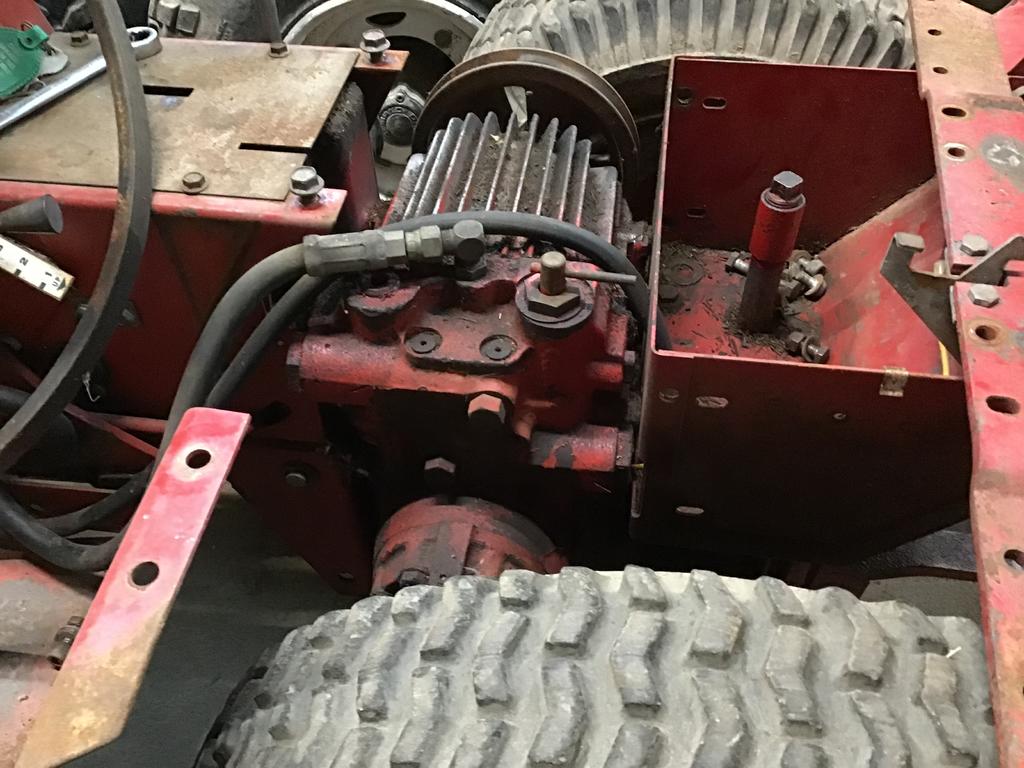

953 nut 67,328 #39 Posted October 17, 2018 The Charger shift tunnel will probably need to stay and a seat support box of some sort to go over the hydro pump. Not too sure about having to shorten the frame. I would think the hood could need to be lengthened as needed but space will be an issue if the frame was shortened. 1 Share this post Link to post Share on other sites
Pullstart 70,549 #40 Posted October 18, 2018 I can see what you mean about the tunnel or box needing to go over the hydro trans. It’s a good 6” taller than a gear box! 1 Share this post Link to post Share on other sites
