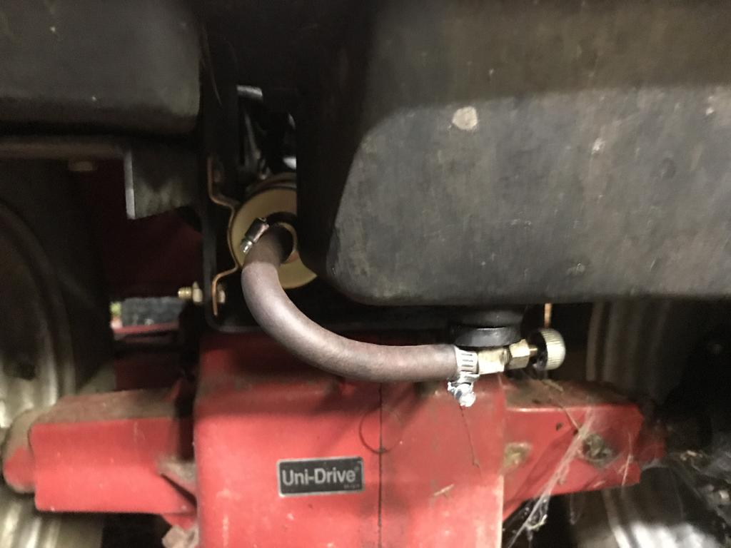

dells68 7,499 #27 Posted September 23, 2018 Well, I ordered another cheap pump and am going to give it another try. Im going to put this one just below the tank on the fender pan mount and see if there is any improvement. I will check the voltage as soon as it starts to see how much is going to it. I'm just aggravated with this thing! 1 Share this post Link to post Share on other sites

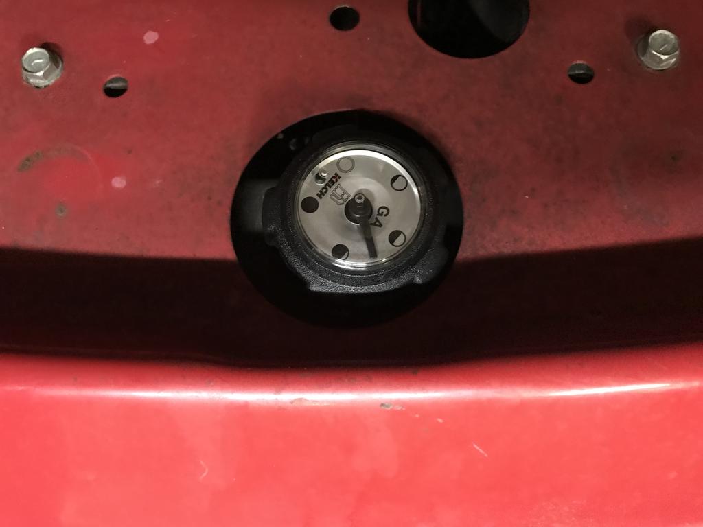

dells68 7,499 #40 Posted September 23, 2018 Thanks Gary. Honestly I've never checked to see if the lights work without it running. Only needed them a couple of times at night. Also, I'm going to put new fuel line on it as I replace the pump to check the fuel flow. It does have a non gauge cap, so it may not be venting? I've got a new gauge style cap that I may try too. 4 Share this post Link to post Share on other sites

clueless 3,376 #43 Posted September 23, 2018 1 hour ago, dells68 said: Thanks Gary. Honestly I've never checked to see if the lights work without it running. Only needed them a couple of times at night. Also, I'm going to put new fuel line on it as I replace the pump to check the fuel flow. It does have a non gauge cap, so it may not be venting? I've got a new gauge style cap that I may try too. If your tank is not venting an electric pump won't last long. 5 Share this post Link to post Share on other sites

dells68 7,499 #46 Posted September 25, 2018 Ok, round 5! I relocated the pump to under the fuel tank, put new fuel line on, new fuel cap/gauge, and checked fuel flow from the tank valve. Starts and purrs like a kitten. Gotta get my multimeter from Dad's and check the voltage going to it. Hope this will cure my woes! Gonna rain for the foreseeable future, so it may be a while before I get to try her out. Keep your fingers crossed🤞! 7 Share this post Link to post Share on other sites
