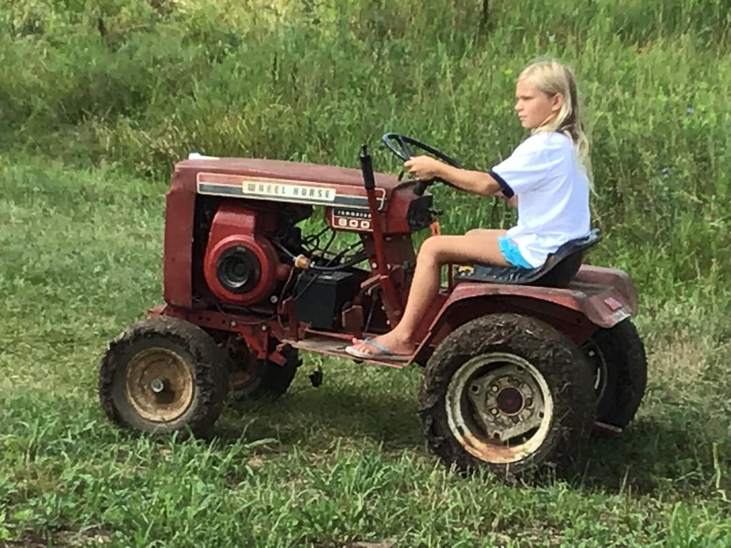

Pullstart 71,207 #7 Posted September 4, 2018 (edited) 1 hour ago, RandyLittrell said: Eric, someone bought a tractor recently that had put the running boards on an earlier tractor I wish I could remember who that was. I bought an 857 at the big show that most guys said belonged to a set of stirrups originally but came with running boards... it doesn’t have the second round bar out back but considering her weight, I doubt that is a concern. The rear of the running board bolts to the front fender support/latch bar. Edited September 4, 2018 by pullstart Wrong picture, but kept the Commando 800 for comparison 5 Share this post Link to post Share on other sites
RandyLittrell 3,945 #8 Posted September 4, 2018 Yup, that's the one I was thinking about!! Randy 1 Share this post Link to post Share on other sites

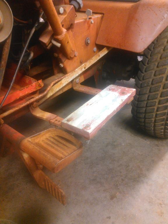

Mikey the Monkey 701 #10 Posted September 4, 2018 3 Share this post Link to post Share on other sites
ebinmaine 80,600 #11 Posted September 4, 2018 1 hour ago, JAinVA said: The c120 had running board foot rests and no 3/4" rear bars.There was a bracket bolted to the hood stand and the rear portion of the rests bolt to this bracket. Go to parts tree and look up the c120 parts list. I have several B and C series rigs here to compare. I'd like something flat but without the rear attachment point I'm going to be pretty limited I think... Main issue is. Well ... Me. EACH step needs to support over 250 pounds when I'm getting on/off the tractor. 2 Share this post Link to post Share on other sites
Machineguy 877 #12 Posted September 4, 2018 44 minutes ago, ebinmaine said: I have several B and C series rigs here to compare. I'd like something flat but without the rear attachment point I'm going to be pretty limited I think... Main issue is. Well ... Me. EACH step needs to support over 250 pounds when I'm getting on/off the tractor. We have the same concern with structural support. 1 Share this post Link to post Share on other sites
ebinmaine 80,600 #13 Posted September 5, 2018 3 hours ago, Mikey the Monkey said: Mike thanks for posting that pic. Those wooden running boards could be the ticket.... Plain varnish.... Share this post Link to post Share on other sites
RandyLittrell 3,945 #14 Posted September 5, 2018 (edited) 3 hours ago, Mikey the Monkey said: My concern would be just how much weight that would hold? Its strap bent at an angle bolted to angle iron. I am closer to 280 and I am thinking it would go to the ground with me. How about it @Mikey the Monkey, whats the rating? I think if you used some 1" tubing that went all the way across underneath, that would be pretty sturdy. Would it be in the way if it did? I don't have a deck on an older Horse. But if I take the loader off my 1277, I am gonna want to do something like that. Randy Edited September 5, 2018 by RandyLittrell Share this post Link to post Share on other sites

Racinbob 13,133 #18 Posted September 5, 2018 I've never really thought about this but I'm thinking like @pullstart that the rear bar isn't needed. I had to pull up a picture of the Commando 800 I restored for my grandson and it doesn't look like there's a rear bar unless I can't see it in the picture. That tractor was original when we got it in the early 80's and still going strong today with no stress issues. Then again, it hasn't had a 'full grown' operator as all of us are in the mid 100's. Having the bar would certainly add strength. 3 Share this post Link to post Share on other sites
Racinbob 13,133 #19 Posted September 5, 2018 (edited) I just looked at a picture of my 76 and don't see one there either. I should know because I just had that one apart but I'd have to look to make sure. Edit: The parts manual doesn't show a rear bar on the 76 so apparently it isn't needed. My 2005 does have one so I guess it's based on the year and how the sheet metal is attached to the frame. Edited September 5, 2018 by Racinbob 1 1 Share this post Link to post Share on other sites

Mikey the Monkey 701 #22 Posted September 5, 2018 (edited) The steel is 1.5 inches wide by 1/4 inch thick. I can put all 199 lbs on it no problem. I like how they look. Interesting add on by original owner who's been gone a long time. Edited September 5, 2018 by Mikey the Monkey 1 Share this post Link to post Share on other sites
Mikey the Monkey 701 #23 Posted September 5, 2018 20 hours ago, RandyLittrell said: My concern would be just how much weight that would hold? Its strap bent at an angle bolted to angle iron. I am closer to 280 and I am thinking it would go to the ground with me. How about it @Mikey the Monkey, whats the rating? I think if you used some 1" tubing that went all the way across underneath, that would be pretty sturdy. Would it be in the way if it did? I don't have a deck on an older Horse. But if I take the loader off my 1277, I am gonna want to do something like that. Randy Share this post Link to post Share on other sites

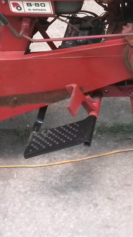

Chris G 3,392 #24 Posted September 6, 2018 You could use some old cub foot rest as I did. Then I just fabricated a bracket holding the rear of them up and bolted to the frame. I made the bracket to hold them at the position I wanted. I'm only around 185 pounds and they hold up to me pushing on them and all the abuse I put to them. 3 Share this post Link to post Share on other sites
