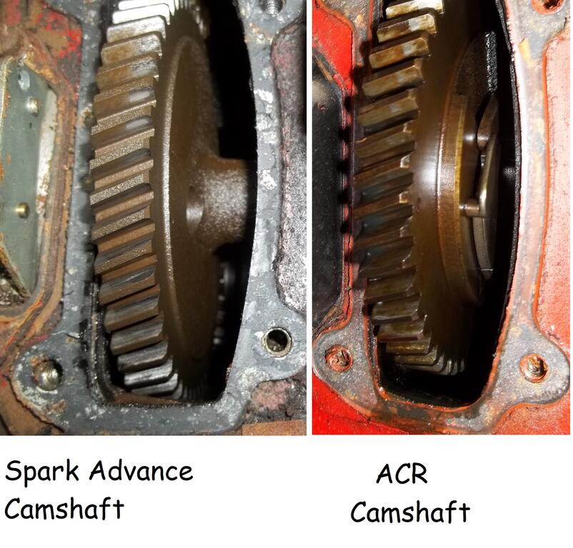

The exhaust valve momentarily opening just before TDC will give a bad compression reading if you have ACR.
There are a couple ways to determine what camshaft you have. Presuming the camshaft in your engine is the one it was born with the data plate on the engine has a suffix that can tell you what camshaft was used. The table below will tell you the suffix applicable to your engine. The other way to determine what camshaft you have is to remove the cam gear cover and take a look. If you see a mechanism attached to the cam gear it is the ACR cam.
The following engines have the spark advance camshaft;
K-141, Suffix prior to “C”
K-161, Suffix prior to “J”
K-181, Suffix prior to “D”
K-241, Suffix prior to “D”
WHX??
Excellent info ther Richard...now if I could just remember it!
When I went through the 1055 241 it had the advance cam in it so I just made sure the advance hair springs were doing their job and put it back as was.
I had no idea what the suffix should have been since this all came from two motors both of which the plates were missing. Terry came through with some placebo numbers and all is good.
Hindsight being what it is I had a ACR cam I should have used  on the shelf. She always hangs up the SG on the compression stroke when starting now but but a couple of seconds off the switch she will roll her over. Except if the belt is wet like after her bath!
I forget about that ACR business all too often.
