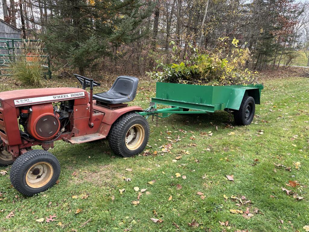

TonyToro Jr. 2,547 #24926 Posted November 12, 2025 Hauled some brush with the C-121 today 8 4 Share this post Link to post Share on other sites

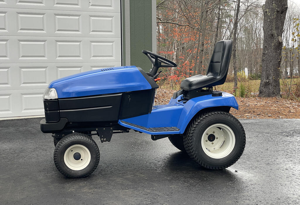

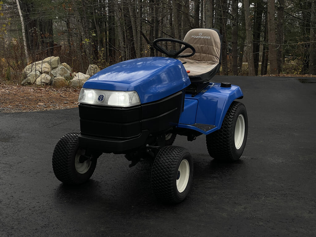

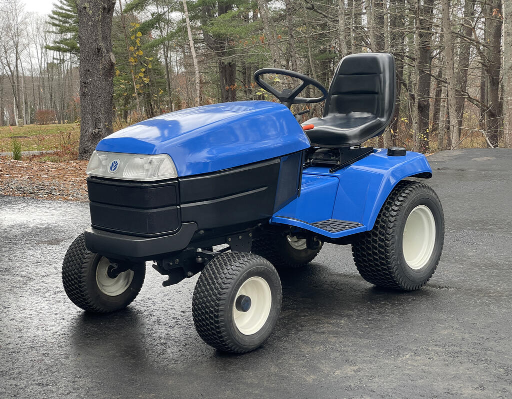

Blue Chips 881 #24927 Posted November 13, 2025 (edited) I'm almost done refurbishing my GT18. I added fresh fuel today, changed all of the oil and filters, and took it for a longer test drive. The fresh fuel eliminated the slight lag from idle to a sudden wide-open throttle, and it's running great. I slipped an old seat cover over the original seat, which is still in pretty good shape, with only a couple of small hairline cracks that don't go all the way through. I may try some vinyl conditioner on it to see if it softens up a bit. There are still a few tweaks left to do on it: I need to make the final adjustments to the brake and motion-control linkages. The battery light is always on (it's charging fine) so I need to address that, either with a different battery light module or going to a voltmeter instead of a warning light. There's a wobble in the left front wheel, which I plan to replace with a rim that I got from @JoeM. I haven't decided about decals yet. It's a GT18, but I believe I've bumped up the CH18 to 20HP, so I don't know if I want a GT18 decal or not. Maybe I'll just skip the decals. Edited November 14, 2025 by Blue Chips 2 4 Share this post Link to post Share on other sites
Handy Don 17,634 #24928 Posted November 13, 2025 GT-18+ 3 Share this post Link to post Share on other sites
JoeM 10,317 #24929 Posted November 13, 2025 1 hour ago, Blue Chips said: I'm almost done refurbishing my GT18. Nice work Chips! 1 1 Share this post Link to post Share on other sites
kpinnc 19,036 #24930 Posted November 13, 2025 1 hour ago, Blue Chips said: haven't decided about decals yet. It's a GT18, but I believe I've bumped up the CH18 to 20HP, so I don't know if I want a GT18 decal or not. Maybe I'll just skip the decals. Terry (Vinylguy in the vendor section) can make you some decals any way you like, and everyone here can vouch for his work and how nice the decals are. Almost everything I've purchased from him has been custom work. I think he has some 5xi stuff anyway, so he already has size templates to work with. Your tractor looks great! Even if it isn't red it is still a beauty! 3 1 Share this post Link to post Share on other sites

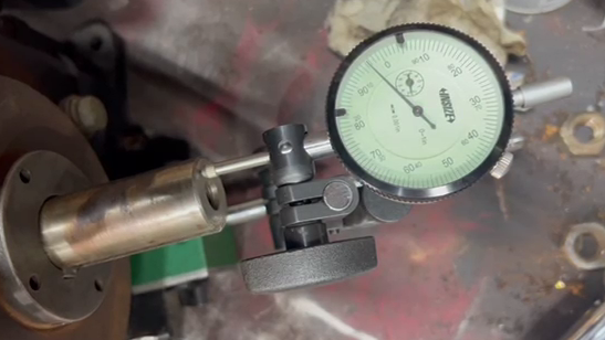

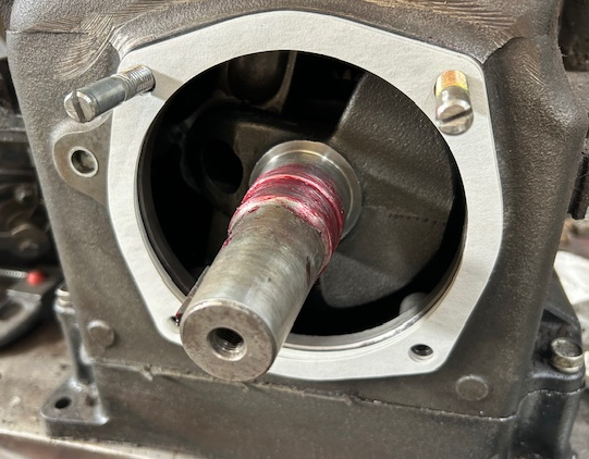

JoeM 10,317 #24931 Posted November 14, 2025 (edited) I got new shims and gasket for the M12 that was leaking oil. Reinstalled the bearing cover and checked the end play, Made some dowels to hold the 4 shims and gasket. Shims were .003 and gasket was .010. Used longer bolts to pull cover in while I tapped on it with a plastic dead blow. Whet smooth until the purple wire decided it wanted in on the action and drooped in between. I removed it probably going to reroute anyway. I did notice once the plate was seated there was no end play, I tapped the crank with the dead blow back and forth a few times and that loosened her up. Total was .008 I checked it before I took it apart and it was .004. I did add the same number of shims. Edited November 14, 2025 by JoeM 9 Share this post Link to post Share on other sites

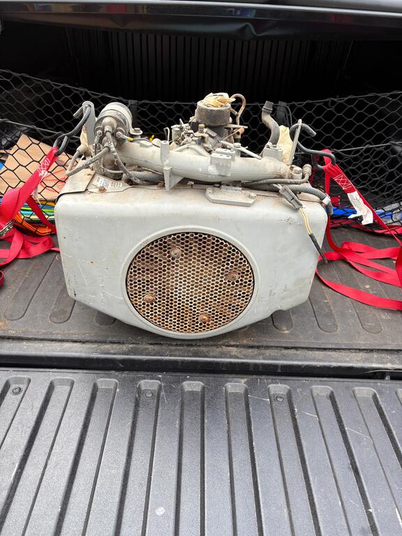

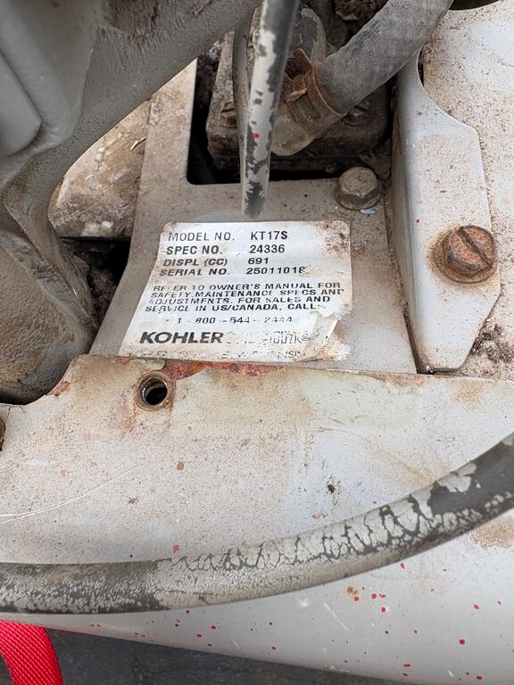

Sodaking27 1,391 #24932 Posted November 14, 2025 Heart beat replacement for the C175. Met up with Lincoln from A to Z and picked up this KT17 series 2. Most likely will be after the holidays before I get the chance to install it. Looks to be a 1995. 6 7 Share this post Link to post Share on other sites
pfrederi 21,274 #24933 Posted November 14, 2025 1 hour ago, Sodaking27 said: Heart beat replacement for the C175. Met up with Lincoln from A to Z and picked up this KT17 series 2. Most likely will be after the holidays before I get the chance to install it. Looks to be a 1995. I have a Gray KT17-2 also. same spec number (Wheel Horse) but by serial number 1987. Always figured WH ordered replacement engines to go in place of failed KT-17-1... 5 Share this post Link to post Share on other sites

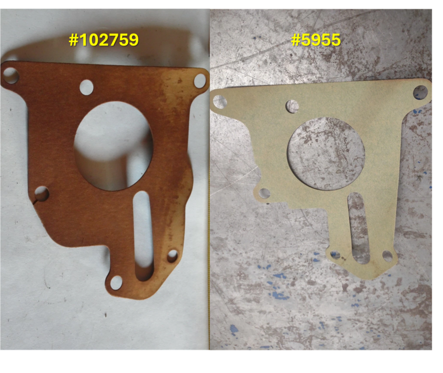

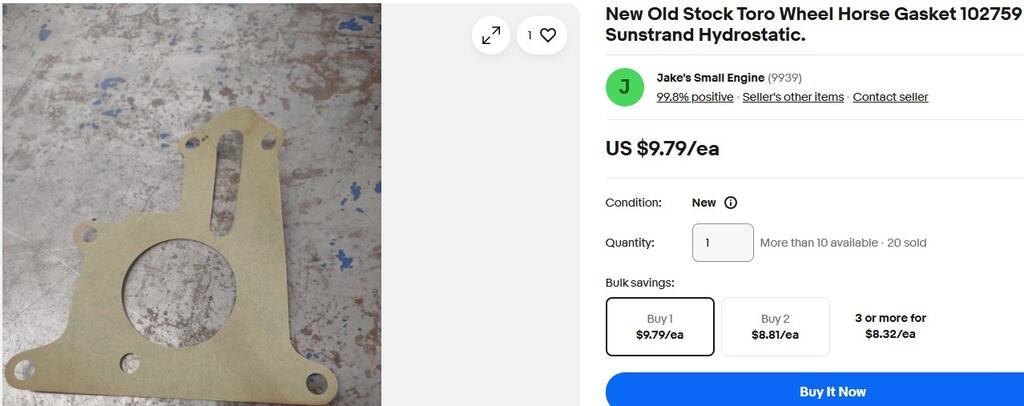

Bar Nuthin 3,445 #24938 Posted November 15, 2025 Today, I changed the name of the tractor, formerly known as Frankenhorse, to Johnny Cash. It's a '73 16-auto, with a '72 14 Horse Kohler, a '74 (or later) Sundstrand Hydro, and a '71 hydraulic lift. Even though I knew the Sundstrand was newer, I brain farted when looking up the mounting gasket to the transaxle and ordered the gasket for a 1973 (#5955) from @daveoman1966, who even noted that they were for hydrogear only, but it didn't register in my tiny brain. To make it more confusing you can substitute the #102759 for the #5955, but not the other way around. Additionally, there's a seller on eBay listing #5955 gaskets as #102759 - so my first picture reference was misleading I'm only out a few bucks, but having to wait on parts is torture. Anyone needing gasket #5955 let me know. 3 1 Share this post Link to post Share on other sites

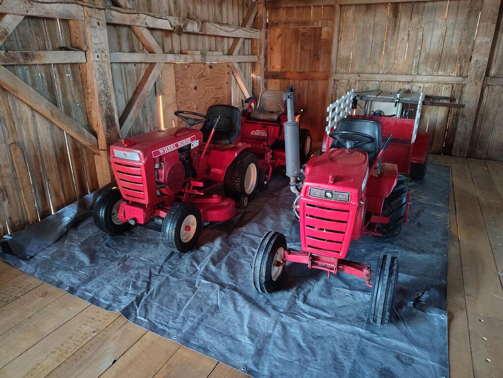

AlexR 3,136 #24940 Posted November 15, 2025 Got them washed up and parked in the barn for winter, still need to get the snow blower on one sometime. 4 9 Share this post Link to post Share on other sites

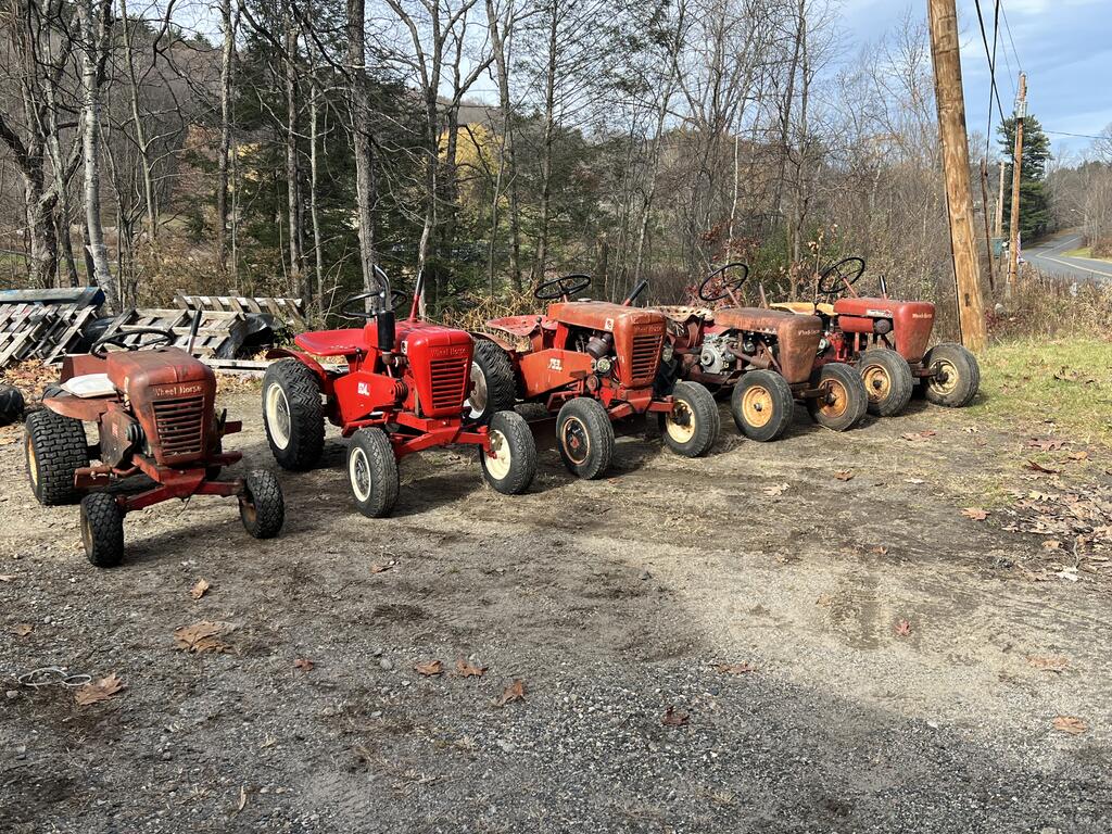

WHGuy413 2,859 #24941 Posted November 16, 2025 @WheelHorse_Kid and I have been working on getting stuff squared away for winter. Had these 5 out of the garage so decided to snap a photo. 3 8 Share this post Link to post Share on other sites

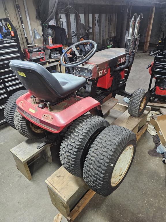

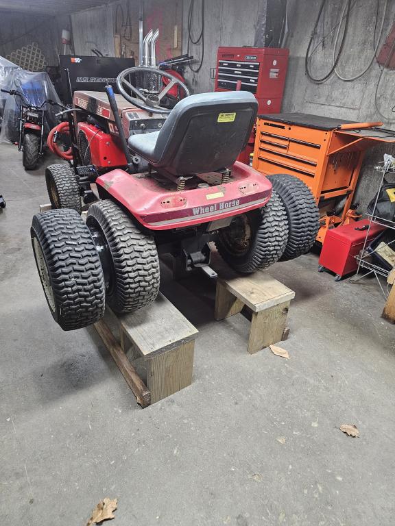

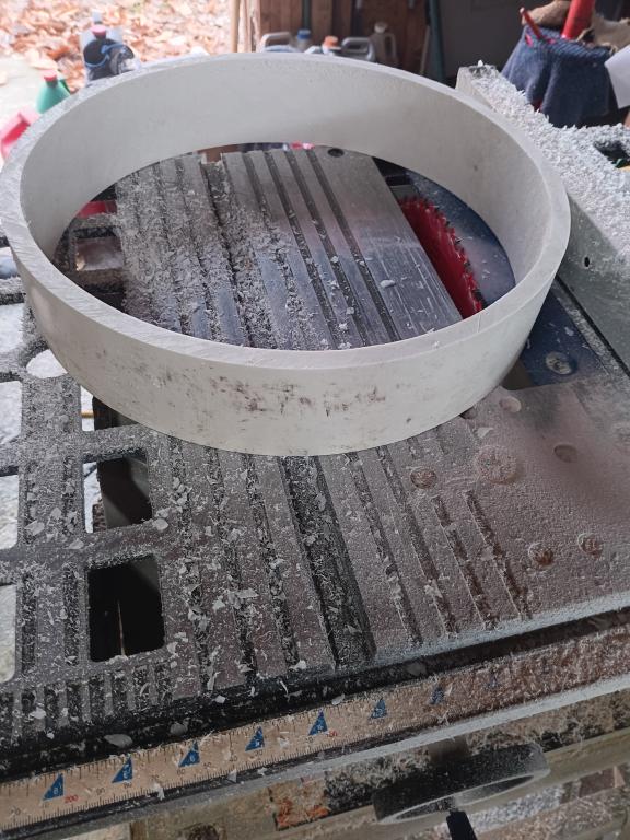

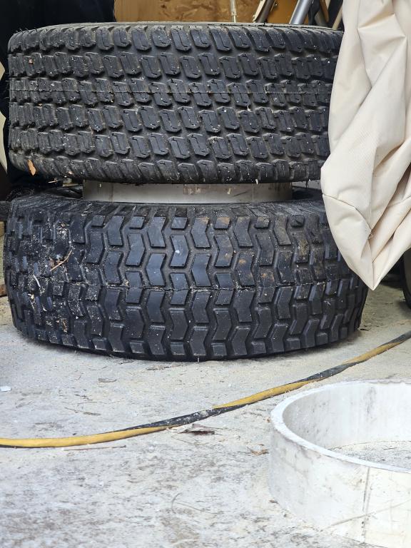

ebinmaine 81,046 #24948 Posted November 17, 2025 @OldWorkHorse came byfor a visit. 3 YEARS ago he and I had @Pullstart send us a chunk of pvc to make dual wheel spacers. Steve and I used a table saw and some patience to cut several slices about 2.25" wide. 6 3 Share this post Link to post Share on other sites
OldWorkHorse 3,156 #24949 Posted November 17, 2025 19 minutes ago, ebinmaine said: @OldWorkHorse came byfor a visit. 3 YEARS ago he and I had @Pullstart send us a chunk of pvc to make dual wheel spacers. Steve and I used a table saw and some patience to cut several slices about 2.25" wide. Like @ebinmaine said we finally remembered to finish a project only took 3 ish years . The spacers fit nice and came out good. Thanks to @Pullstart for the material to make them. Going to clean them up a bit and fine tune them but had to see what the C-170 could possibly look like after all this time! 5 1 Share this post Link to post Share on other sites
