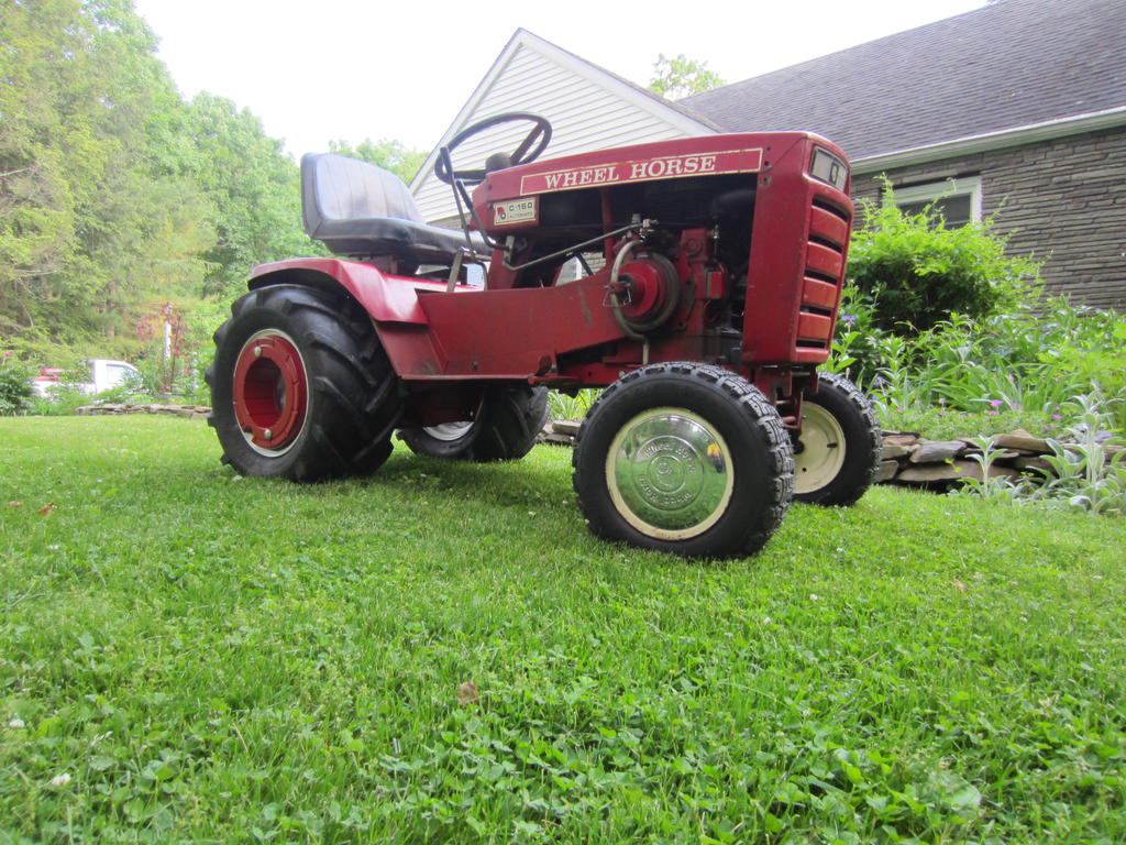

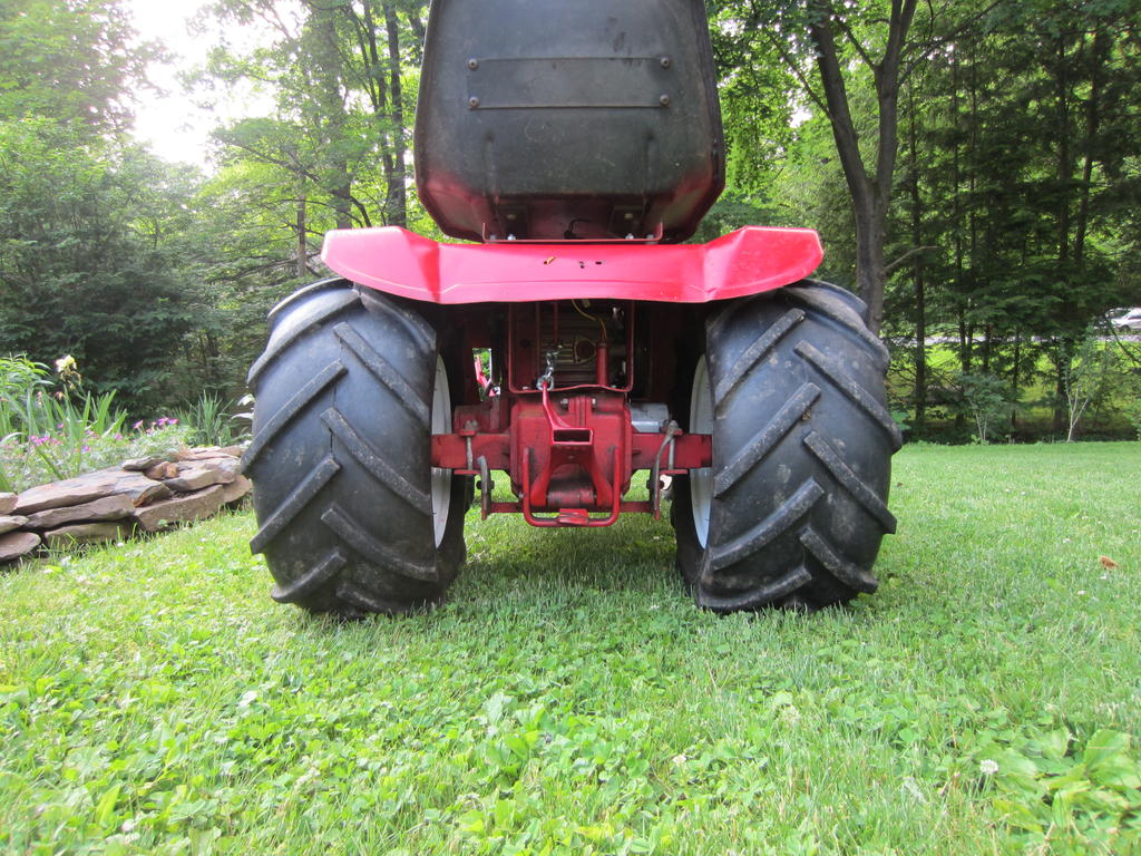

Herder 2,356 #2377 Posted May 31, 2019 Fired up the 1976 C-160 and pulled her into the shop for a hydro service and quick wipe down. She still had the snow thrower attached. It was nice to put that away. This is the WH that it all started with about 15 years ago. 2 3 Share this post Link to post Share on other sites

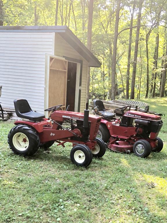

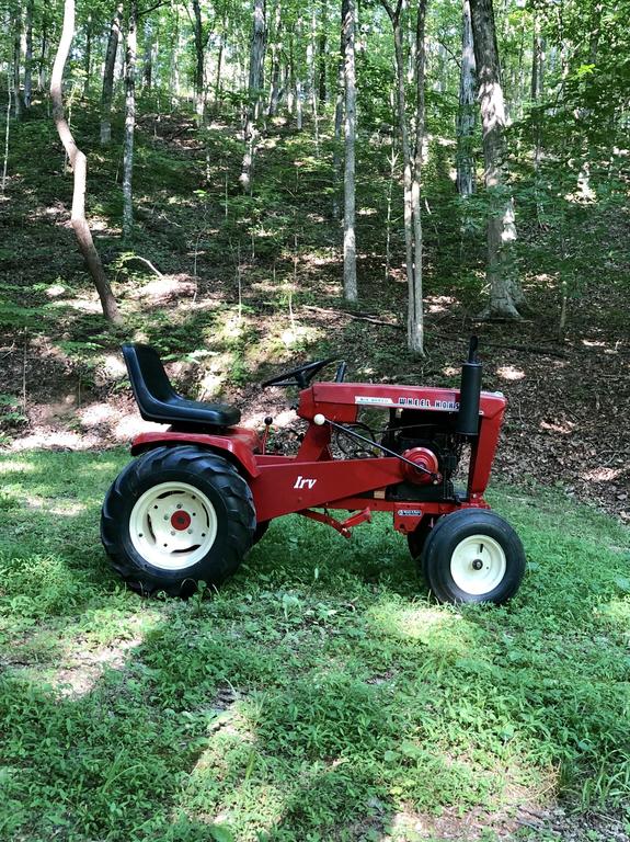

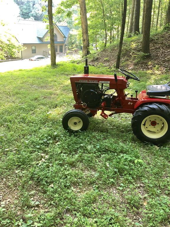

The Tuul Crib 7,354 #2378 Posted May 31, 2019 I took IRV and my first born out if the barn and took em’ for a ride ! Of course not at the same time . We are in a dry spell as usual here will no rain so cruising is all l can do for now !!!! 3 3 Share this post Link to post Share on other sites

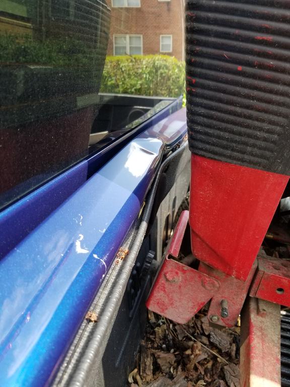

MIGHTYMO 50 #2397 Posted June 1, 2019 Today I learned that the front of a 314-8 is stronger than the bed of a Silverado... 6 Share this post Link to post Share on other sites
ericj 1,580 #2398 Posted June 1, 2019 18 minutes ago, MIGHTYMO said: Today I learned that the front of a 314-8 is stronger than the bed of a Silverado... I learned years ago to put a 4x4 across the front of the truck to help keep the tractor from doing just that eric j Share this post Link to post Share on other sites
MIGHTYMO 50 #2399 Posted June 1, 2019 14 minutes ago, ericj said: I learned years ago to put a 4x4 across the front of the truck to help keep the tractor from doing just that eric j I was in a car accident today and the strap broke 2 Share this post Link to post Share on other sites
ericj 1,580 #2400 Posted June 1, 2019 56 minutes ago, MIGHTYMO said: I was in a car accident today and the strap broke sorry to hear that hope everybody is okay, stronger strap ?? eric j Share this post Link to post Share on other sites
