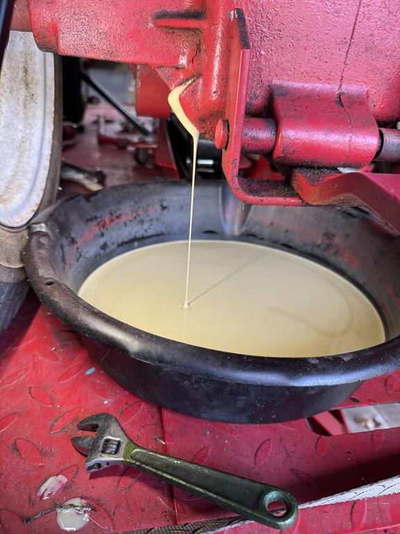

kpinnc 19,036 #23326 Posted April 16, 2025 3 hours ago, PWL216 said: drained the transmission gear oil, Did you drain from the plug on the bottom? The side plug leaves about 1.5 quarts of old oil still in the case. You should drain at the 1/4 Allen plug on the bottom of the case. 1 2 Share this post Link to post Share on other sites
oliver2-44 11,792 #23327 Posted April 16, 2025 4 hours ago, PWL216 said: - drained the transmission gear oil That oil looks very milky which means it has water in it. You might want to flush the transmission with diesel or kerosene to clean it out. There is a hump in the middle of the bottom of the transmission. Lift the front end to drain it completely from the bottom plug. 3 Share this post Link to post Share on other sites
Ed Kennell 47,754 #23328 Posted April 16, 2025 7 hours ago, oliver2-44 said: That oil looks very milky which means it has water in it. You might want to flush the transmission with diesel or kerosene to clean it out. There is a hump in the middle of the bottom of the transmission. Lift the front end to drain it completely from the bottom plug. Ed Kennell 40,378 Replied: April 3 If your transmission shows any sign of water (a tan milky look) or dark thick oil, you should definitely flush it with kerosene or diesel. Raise the front of the tractor as high as safely possible when draining to get the oil over the center hump to the drain hole. 1. Drain the old oil 2. Fill with kero or diesel 3. If it is running, drive it slowly in tight figure 8s using all forward and reverse gears. If it is not running, jack up one wheel and rotate that wheel by hand both directions while using all the gears. Repeat this with the other wheel raised. The goal is to rotate and wash all the gears and bearings. 4. Raise the front and drain the kero. If it is really black and dirty, I would repeat steps 2. and 3. till the kero comes out clean. 5. Then I like to fill with cheap low viscosity motor oil and repeat step 3. 6. Drain the light oil and fill with 90 wt rear oil. BTW, I save the drained kero for washing parts. And the drained motor oil for rubbing down to preserve the patina on the tins. While each wheel is jacked up, this is a good time to check the axle bearings for movement. There should be no up/down or front/back movement. In and out movement is normal up to about 1/16". The axle seals may leak some of the thin kero.,but should stop with the 90wt oil. If the bearings check OK and the axle seals do leak oil, the seals can easily be replaced. 2 2 Share this post Link to post Share on other sites

PWL216 1,309 #23330 Posted April 16, 2025 (edited) 8 hours ago, oliver2-44 said: That oil looks very milky which means it has water in it. You might want to flush the transmission with diesel or kerosene to clean it out. There is a hump in the middle of the bottom of the transmission. Lift the front end to drain it completely from the bottom plug. Hi @oliver2-44 @Ed Kennell @kpinncI drained it only from the side plug. I jacked up the opposite side rear to tilt it and get as much out as I could. I didn’t realize that there was another plug underneath. I’ll do that today. I had also intended to do the diesel flush, so I’ll do both now! Thanks again and much appreciated! Edited April 16, 2025 by PWL216 5 Share this post Link to post Share on other sites

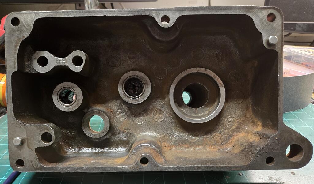

kpinnc 19,036 #23331 Posted April 16, 2025 2 hours ago, PWL216 said: I jacked up the opposite side rear to tilt it and get as much out as I could. I didn’t realize that there was another plug underneath. The "hump" that you'll hear about is pictured below. So drain from the bottom but also raise the nose of the tractor as far as you can. That will help everything drain from the bottom so you don't have to flush multiple times. 6 1 Share this post Link to post Share on other sites

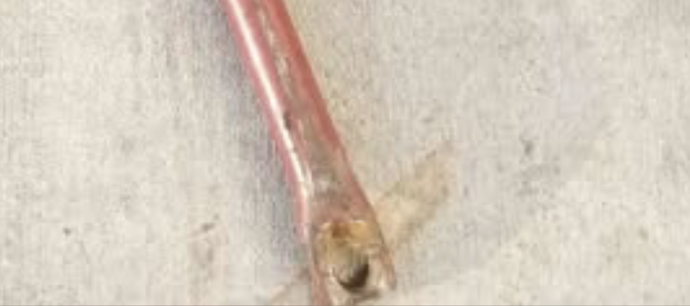

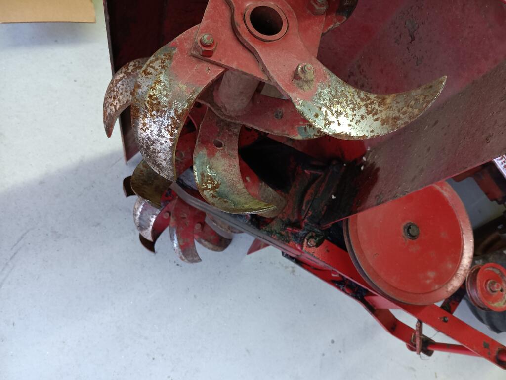

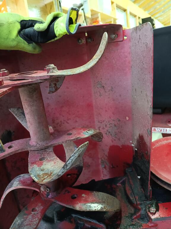

BenvonCamp 22 #23340 Posted April 17, 2025 On 1/8/2024 at 6:28 PM, Ed Kennell said: John has answered your questions. Yes, the forward force on the lift/push rod is what lifts the blower as it can not move forward but pivots where it is attached to the tractor and is forced to rotate up. I tend to use the material I have to do my fab work. I no longer have single stage snow throwers but in the past I have made missing flags and push rods from unistrut that I had on my scrap pile. It is important to note the flag device must be inserted in the top hole of the lower lift lever. This gives the correct amount of forward motion so the blower lifts with minimum amount of force and the correct rotation of the rock shaft and correct lift of the blower. With the blower and the rock shaft lowered, the distance from the center of the top hole in the rock shaft to the center of the bent lug on the bottom of the blower is the dimension you must use to build a connecting device. It doesn't really matter how you get there, but this length must be correct. When I built mine, drilled the unistrut and attached it to the blower lug. Made two plates from flat bar that were attached by a bolt to each side of the lower rock shaft lever. With the blower and the rock shaft lowered, clamped the side plates to the unistrut bar. Took it off and welded it. A crude sketch. of my redneck blower lifter. The X dim is not important. I made mine longer than the WH flag. It worked fine. I'm knocking around trying to find a lift rod for my 875 WH with a single stage and saw this lift rod attached to a complete unit for sale. The OEM price for the rod itself is half of what I paid for the tractor a few weeks ago. Thanks for your diagram. Instead of firing up the Lincoln tombstone welder and doing terrible work to weld the strap steel on the end, do you think pounding tube stock flat, putting in the bend and then drilling the hole would suffice like the photo below? 1 Share this post Link to post Share on other sites
ebinmaine 81,050 #23341 Posted April 17, 2025 31 minutes ago, BenvonCamp said: I'm knocking around trying to find a lift rod for my 875 WH with a single stage and saw this lift rod attached to a complete unit for sale. The OEM price for the rod itself is half of what I paid for the tractor a few weeks ago. Thanks for your diagram. Instead of firing up the Lincoln tombstone welder and doing terrible work to weld the strap steel on the end, do you think pounding tube stock flat, putting in the bend and then drilling the hole would suffice like the photo below? IMHO... As long as the tube stock you're using is of sufficient thickness, I'd try it. Share this post Link to post Share on other sites
Ed Kennell 47,754 #23342 Posted April 17, 2025 1 hour ago, BenvonCamp said: I'm knocking around trying to find a lift rod for my 875 WH with a single stage and saw this lift rod attached to a complete unit for sale. The OEM price for the rod itself is half of what I paid for the tractor a few weeks ago. Thanks for your diagram. Instead of firing up the Lincoln tombstone welder and doing terrible work to weld the strap steel on the end, do you think pounding tube stock flat, putting in the bend and then drilling the hole would suffice like the photo below? Try it ...use what you have to make it work Share this post Link to post Share on other sites
Handy Don 17,634 #23343 Posted April 17, 2025 3 hours ago, BenvonCamp said: pounding tube stock flat, putting in the bend and then drilling the hole would suffice like the photo below I’m 90% sure that’s how WH manufactured them, but using a press instead of a hammer. Share this post Link to post Share on other sites

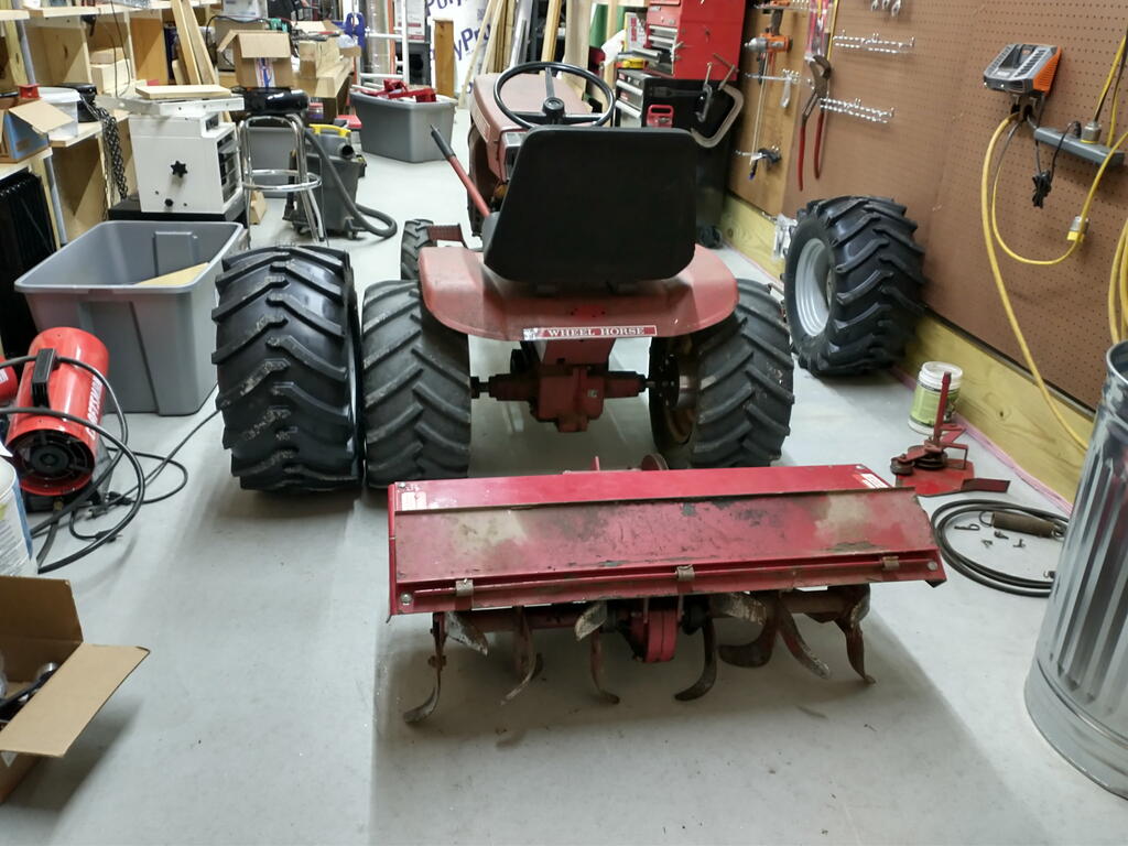

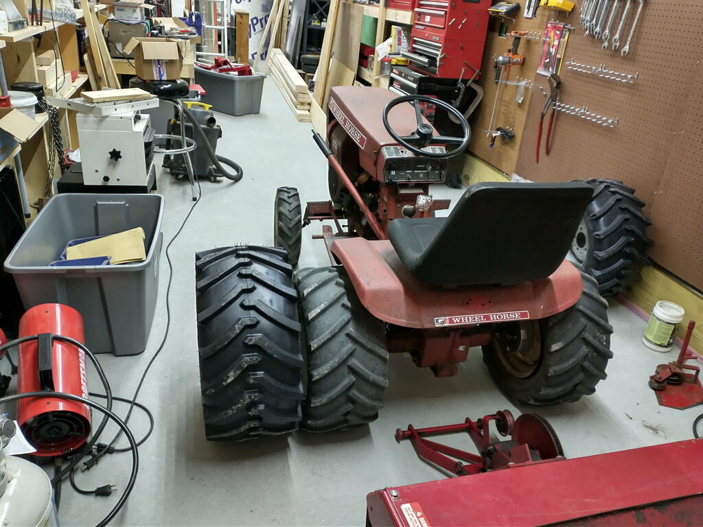

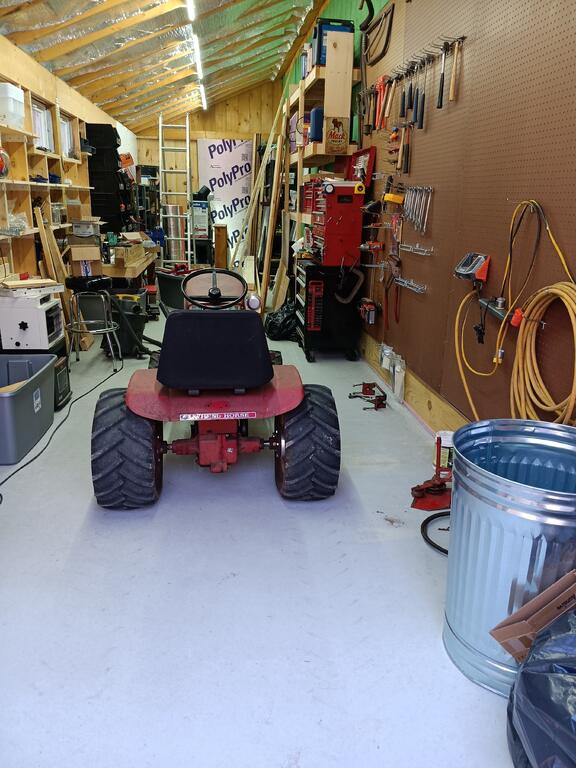

ebinmaine 81,050 #23346 Posted April 17, 2025 I got the BIG OTR Lawn Trac 24x12.00-12 tires on the wheels from @midpack Also got the Tecumsehorse in the new workshop space. FIRST TRACTOR IN THERE! That's in there specifically for mounting the rototiller up. @76c12091520h Hitch. My own rear Tach-o-matic. Some tiller pics... 3 5 Share this post Link to post Share on other sites
midpack 1,148 #23348 Posted April 18, 2025 Are the fenders going to fit? Those are monsters! 1 Share this post Link to post Share on other sites
ebinmaine 81,050 #23349 Posted April 18, 2025 2 minutes ago, midpack said: Are the fenders going to fit? Those are monsters! Man they are tall! If you look at the bottom of the tire here.. You may be able to see they're completely flat. The fender is setting lower than normal because of that. I believe once the tractor is jacked up there should be JUST enough room. Probably. I hope. 2 Share this post Link to post Share on other sites
JDMiller 16 #23350 Posted April 18, 2025 On 4/16/2025 at 11:57 AM, PWL216 said: “I can fix that hump”. “What hump?” sorry, I can never resist a reference to Young Frankenstein😂 Just made my day, gotta go watch it now! @ebinmaineThose tires are HUGE, you can always add spacers under the fender panel and seat mount holes, easy fender lift to get that clearance. 3 Share this post Link to post Share on other sites
