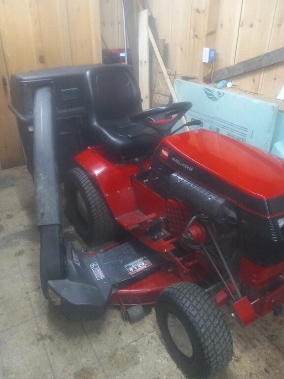

Cee245 861 #16484 Posted August 5, 2022 Put on the bagger attachment I picked up at the show and cleaned it up a bit. 3 3 Share this post Link to post Share on other sites
