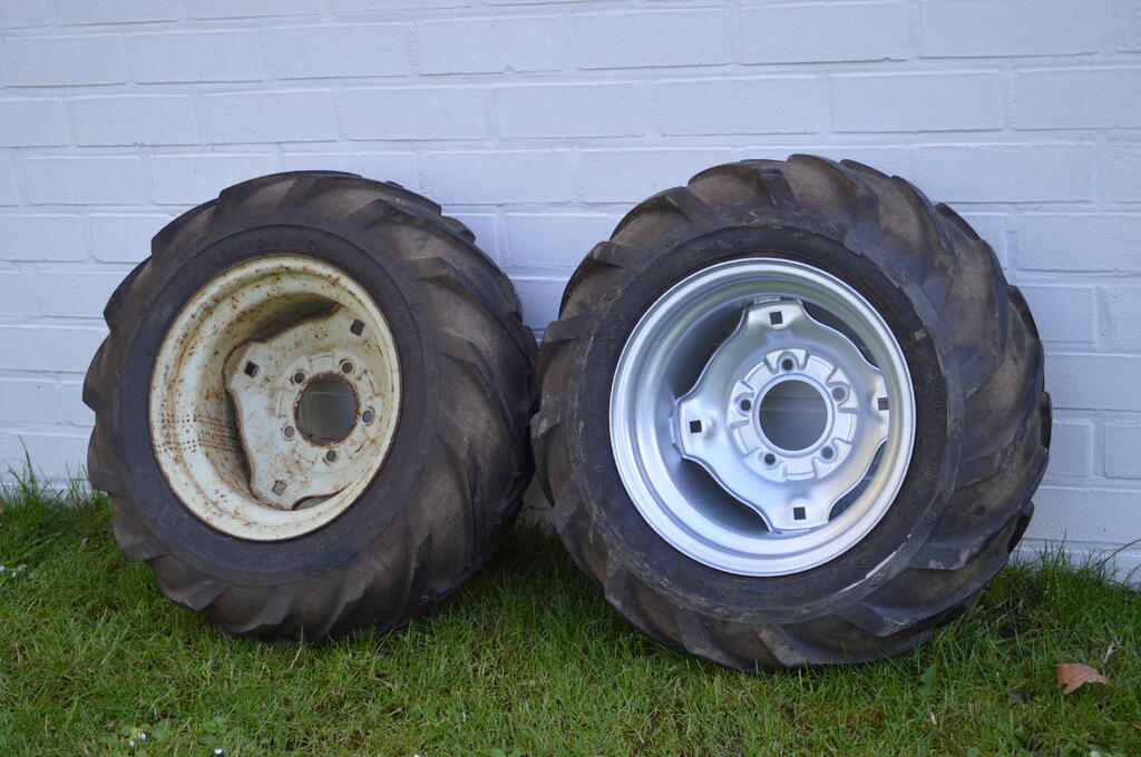

Maxwell-8 4,371 #11403 Posted May 17, 2021 (edited) After I read that the Sears-forum is gone shut down because have financial concerns. I finally got around to buy my "support" member ship. Wich allows me to show a pic of my work today. Got some spare time and had these old WH rims with Goodyear AG's laying around. Probably not gone keep them, but I think the "test"-one turned out very well. If tomorrow there is no rain, It's the other one's turn. Edited May 17, 2021 by Maxwell-8 3 13 Share this post Link to post Share on other sites

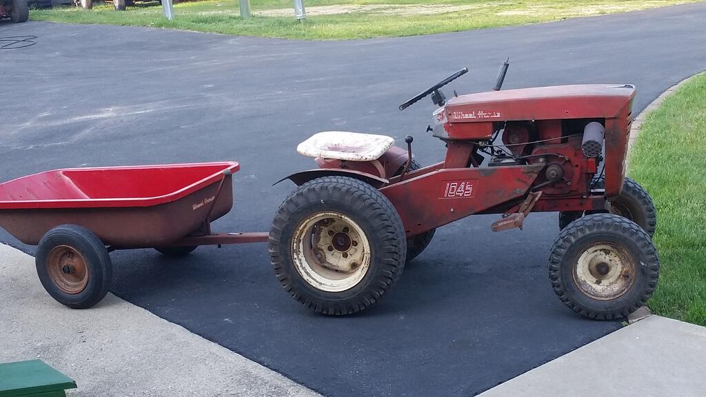

WHX?? 58,307 #11406 Posted May 17, 2021 7 hours ago, Bailey855 said: Hey Ed, this is a 1055. Right up my ally Bailey... 855 is bucket lister. Be careful of that PTO @c-series don is on the hunt for one! 2 2 3 Share this post Link to post Share on other sites
Bailey855 167 #11407 Posted May 17, 2021 Nice horse! 1965 is my year. I’ve decided to focus on that year alone. I just let my 84 c-195 go, killed me but it didn’t fit in the short frame crew lol. And maybe he would trade for a 4 wheel cart lol that’s about the only thing I would swap for. And cash of course. I don’t beleive the pto is worth as much as the cart?? 3 Share this post Link to post Share on other sites
ebinmaine 80,987 #11408 Posted May 17, 2021 4 minutes ago, WHX24 said: . Be careful of that PTO @c-series don is on the hunt for one! If a really well mannered fellow from Long Island shows up mumbling Wheel Horse Wheel Horse Wheel Horse over and over again.... Well I don't know nothing... 5 Share this post Link to post Share on other sites
WHX?? 58,307 #11409 Posted May 17, 2021 3 minutes ago, Bailey855 said: 1965 is my year. '67 is actually my year... Two 1055's - Restorations, Modifications, & Customizations - RedSquare Wheel Horse Forum I got sidetracked on that one! @wheelhorseman has a video of his PTO-66 in action. Using it to move grain to to a gravity box at a show. Sry .. no pics... Yes quite rare Ed ...that why Lowell has one! Now I know two guys that do! 1 Share this post Link to post Share on other sites
Bailey855 167 #11410 Posted May 17, 2021 7 minutes ago, WHX24 said: '67 is actually my year... Two 1055's - Restorations, Modifications, & Customizations - RedSquare Wheel Horse Forum I got sidetracked on that one! @wheelhorseman has a video of his PTO-66 in action. Using it to move grain to to a gravity box at a show. Sry .. no pics... Yes quite rare Ed ...that why Lowell has one! Now I know two guys that do! It was wild where I found it. I barley saw it through all the weeds. And I’ve seen the video you speak of. Mines all ready to go. Just need to find somthing to run one of these days 1 1 Share this post Link to post Share on other sites

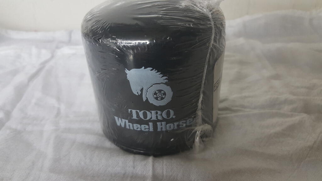

squonk 48,231 #11413 Posted May 17, 2021 5 hours ago, Gregor said: As it turns out, Terry doesn't need to make decals. You can still buy this filter. Kind-a cashy though @ $17 Buy a Napa 1410 or Wix51410. Better filter Share this post Link to post Share on other sites

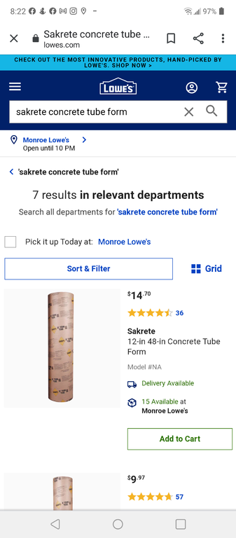

Horse Newbie 7,405 #11422 Posted May 18, 2021 (edited) 8 hours ago, ebinmaine said: Maybe refine it a little bit and put your own touches to it. I believe I would get one of those concrete form tubes from a home improvement store that was of a suitable diameter, cut to desired depth or "height", hot glue a cardboard bottom in it with suitable bolts in place, pour concrete while poking to make all air pockets rise and ensure smooth sides... so on and so on... Edited May 18, 2021 by Horse Newbie 1 Share this post Link to post Share on other sites
