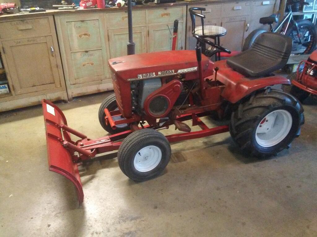

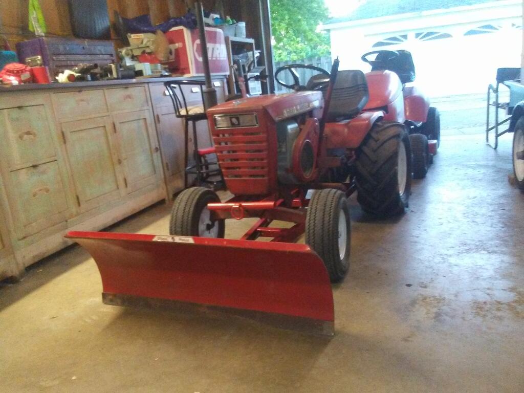

Sam Pasch 450 #5182 Posted June 12, 2020 Got the snow blade out on. It works perfect! 5 3 Share this post Link to post Share on other sites
Sam Pasch 450 #5183 Posted June 12, 2020 6 hours ago, johnnymag3 said: Put her up for sale ….. she is a beauty !!! No way man! I have been looking for one since I got my 867. I'm keeping this one for winter! 2 1 Share this post Link to post Share on other sites
