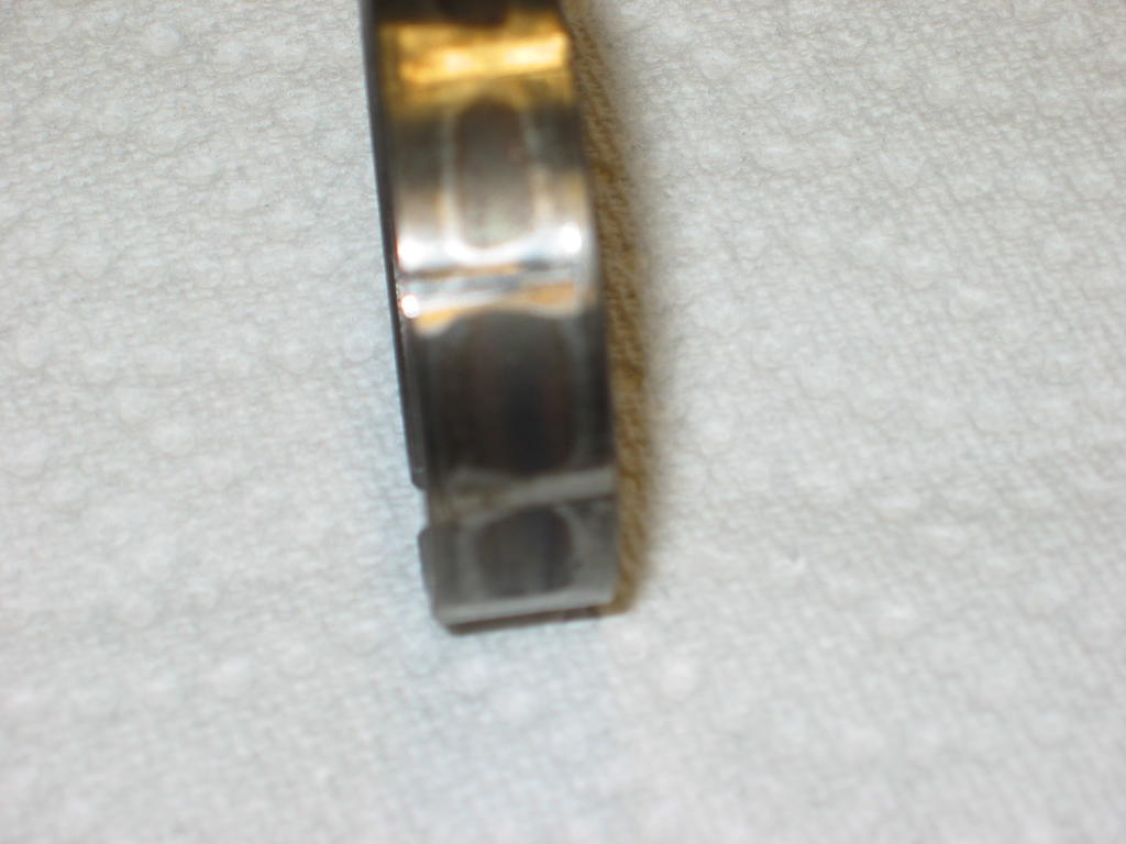

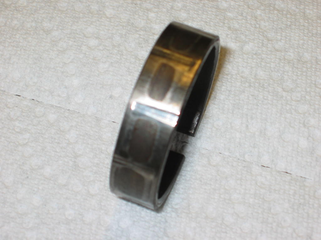

pfrederi 18,771 #1 Posted December 28, 2017 Working on a 10 pinion Limited slip differential. The cylindrical spring that make the limited slip work has deep gouges in it that matchs the pinion gear teeth. Since these parts mine in relation to each other in nomal use I am wondering what causes the gouges. Share this post Link to post Share on other sites
Sarge 3,470 #2 Posted December 29, 2017 I'd almost say they are getting caught and running in the same spot all the time - despite being spring steel the gear teeth are harder and are wearing the ring instead . I assume by design that thing has to be able to "float" just a little - maybe it's doing it too much and getting tipped a bit in that recessed area around the outside ? Are there any wear marks on any other parts in contact with the rings at all ? Sarge Share this post Link to post Share on other sites
pfrederi 18,771 #3 Posted December 29, 2017 The teeth on the pinion gears all looked near perfect. as did the gears on the end of the axles... The inside of teh transaxle as very clean just some metal bits in teh suction screen and magnet...courtesy of the parking brake being ground down. Share this post Link to post Share on other sites

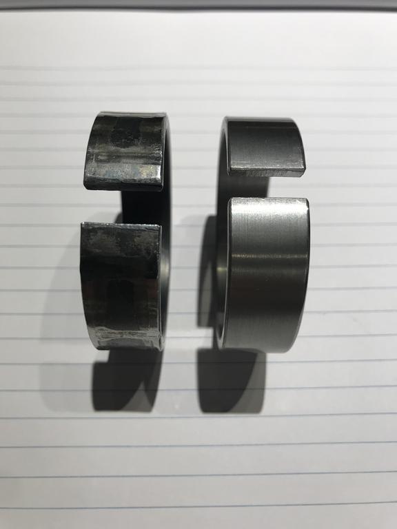

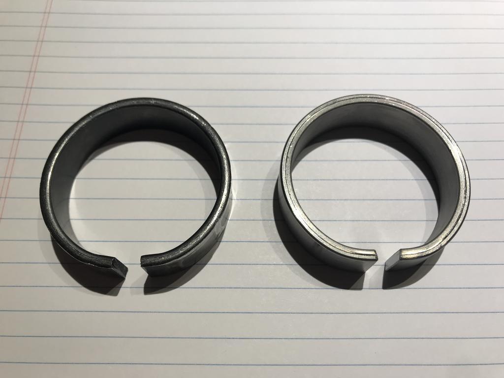

stevasaurus 23,336 #4 Posted December 29, 2017 You are in luck Paul if you want to change out that spring. I have been in contact with @sfjohnson722 (Shawn) about his transmission. He went to a machine shop and had some made. He had some extras made so if someone needed one he would sell one. Here is a picture. new one on the right the metal is made of 4150 3 2 Share this post Link to post Share on other sites

sfjohnson722 26 #10 Posted December 31, 2017 Thanks for the shout out @stevasaurus! I have a few folks interested and have 5 remaining. I started with 10 of these; but I can see if we can get more made if there is a lot of interest. I tried 3 machine shops and it ended up one of the foreman decided to do it at home on the side. I don’t know how these will wear - 4150 was chosen for it’s hardness properties, workability, and cost - if someone more knowledgeable about metals can suggest something else I can inquire. I’m currently asking $20 each shipped to US addresses to cover my costs in it. PM me for payment info and address, etc. 1 Share this post Link to post Share on other sites
sfjohnson722 26 #11 Posted December 31, 2017 Quick update on the spring and clicking - I just put my diff back together with the new (perfectly smooth) spring, and it clicks. I will post a video later to my thread on the 71 Bronco rebuild. But be forewarned a perfectly smooth spring may not stop the clicking - I think it’s *supposed* to click a little. 1 Share this post Link to post Share on other sites

sfjohnson722 26 #19 Posted January 9, 2018 To those I've shipped springs to, it seems like the metal isn't springy enough for our purposes. As I tried to elude to in post 10, we may not have the metallurgy correct for this application. @Skipper has an interesting point, but the consensus I got from the 3 machine shops I went to was that it would be cost prohibitive to get it right. 3 Share this post Link to post Share on other sites
