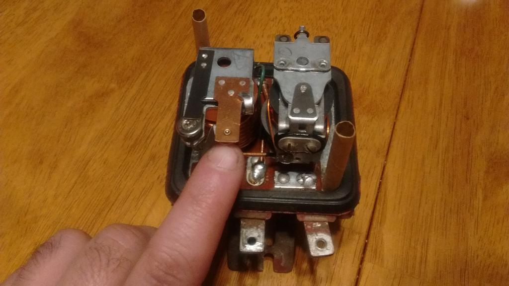

bunson70 51 #9 Posted January 20, 2018 (edited) Hello everyone, it's me again. I went to start my tractor. It barely turned over. Then, when I tried it again, it wouldn't turn over at all. I checked the connections. Everything is good I took out my voltmeter, and I have power going into the voltage regulator, but not going out. If I push down on the copper contact, with the key on (see picture) the engine will turn over. My Dad and I looked it over. We cannot see anything physically wrong. My question is, if I start the tractor by pushing on the copper contact, will I do any harm by running the tractor this way? Edited January 21, 2018 by bunson70 Share this post Link to post Share on other sites
Sarge 3,473 #10 Posted January 21, 2018 The starting relay side of that unit is probably either corroded on it's silver contact or the coil could be burned out. Trace out the connections to both ends of the coil on that contact and check it with an ohm meter to see if the coil is burned out (open circuit). There are some guides online about how to test the different functions of these - hunt around on YouTube or Google. One very common issue I've found is a lack of a case ground - it's got to be grounded properly through the starter-gen case , engine block and back to the battery. Get a points file and gently clean the silver contacts - then polish them with a clean strip of paper and make certain to remove any debris or filings - otherwise it will damage the contacts again. There are settings that need to be done once you remove any material from those contact points since it changes the gap - I know I've found the specs for them somewhere on the 'net. The most important ones are the high limit on the charge voltage and low limit cutout switch, just fyi. Sarge 1 Share this post Link to post Share on other sites
bunson70 51 #11 Posted January 21, 2018 I just replaced the ignition switch. It is back running again. 2 Share this post Link to post Share on other sites
Sarge 3,473 #12 Posted January 22, 2018 I should have brought that up - been tired and foggy from the flu lately. The stock Cole-Hersee heavy duty switches are tough to get now as they were designed to carry the entire load of the starting current to the engine. Not sure what the little Commando 8 had used, but finding NOS C/H switches is pretty tough. If yours has one, might want to upgrade it to a relay instead to move the draw away from the switch and using those heavy cables in the dash - if that's how it's built. Sarge 1 Share this post Link to post Share on other sites
