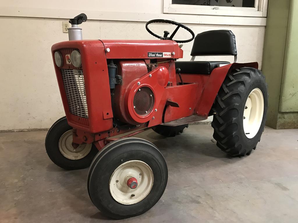

PeacemakerJack 11,096 #51 Posted November 11, 2017 We got the tires on Clyde tonight and both of us were more than pleased with how they look! Looks like a tractor! Like my favorite Dino @stevasaurusonce said, “you aren’t going to want to wrap your fingers around those fenders while plowing with that clearance!” even though they aren’t period correct, I really like the extra rim depth on the GT-14 rims. Dad has now decided to repaint the hood, grill, visible engine parts, tower, and fender pan next spring! Pure coolness! For my plow dog buddies out there: the business end of Clyde! Check out the 14” of ground clearance. Dad won’t have to worry about hanging up on the furrow wall or soybean trash clogging his fenders up like I have on GhostRider. Soon, I’ll hopefully have my first plow pictures and maybe a video of it! I’m so glad I got this gift for Dad—he really likes it! 6 6 1 Share this post Link to post Share on other sites
AMC RULES 37,261 #52 Posted November 11, 2017 I for one... will be sad to see it's original patina go. 1 Share this post Link to post Share on other sites
WHX?? 58,388 #53 Posted November 11, 2017 Owwww I duuno......I'm with Craig on this one Josh.... Tom's gonna be mad you know how much he likes his patinas & originals! 1 Share this post Link to post Share on other sites
AMC RULES 37,261 #54 Posted November 11, 2017 With some concentrated effort... one could easily make that thing glow just as is. 1 1 Share this post Link to post Share on other sites
WHX?? 58,388 #55 Posted November 11, 2017 (edited) Agreed AMC ... Josh you should talk to @prondzy on how he made an old patina come alive. Was a lot of of work he claims but the results were spectacular. Forgot to ask Josh has paint every been messed with before? That's kinda important here. Edited November 11, 2017 by WHX12 1 Share this post Link to post Share on other sites
Shynon 7,730 #56 Posted November 11, 2017 21 minutes ago, AMC RULES said: I for one... will be sad to see it's original patina go. 8 minutes ago, WHX12 said: Agreed AMC ... Josh you should talk to @prondzy on how he made an old patina come alive. Was a lot of of work he claims but the results were spectacular. Forgot to ask Josh has paint every been messed with before? That's kinda important here. No original patina left on that one, someone had painted It before I got it, so I decided it was time to replace it. 2 1 Share this post Link to post Share on other sites
PeacemakerJack 11,096 #57 Posted November 11, 2017 The tractor has been repainted several times through its life. In that case, preserving “patina” isn’t really important. If this tractor was in the condition that it is with the original coat of red from South Bend, there is no way on earth that I’d let dad paint it. However, for those of you that have seen it in person, you know how thick the existing—three or four coats of paint really are. Some of it even looks brush painted. However, it still looks plenty good to be a “plow mule” but I know my dad well enough to know that he likes everything he has—pristine! Dad with his show winning ‘67 Goat that we restored in 2004-6. Granted, he understands that if he makes Clyde to sharp, he won’t want to plow with him and that defeats the purpose. But thank you for all your feedback. 1 5 Share this post Link to post Share on other sites

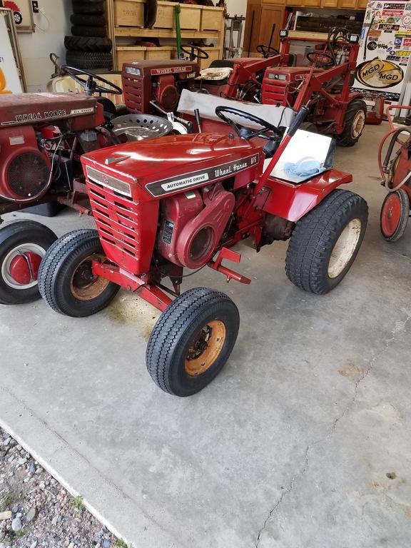

prondzy 3,891 #58 Posted November 11, 2017 38 minutes ago, WHX12 said: Agreed AMC ... Josh you should talk to @prondzy on how he made an old patina come alive. Was a lot of of work he claims but the results were spectacular. Forgot to ask Josh has paint every been messed with before? That's kinda important here. Thanks Jim, but that 953 is due for a beauty make over... I like the way its going Josh. Jim your not referring to this old worker are ya? 2 2 Share this post Link to post Share on other sites
PeacemakerJack 11,096 #59 Posted November 11, 2017 That thing turned out AMAZING Mike. If I would’ve had the coin, I would’ve kept that thing here in Cheddar Country. I wish Dad could’ve seen that in person at Jim’s plow day. It is a patina “work of art”! 1 Share this post Link to post Share on other sites

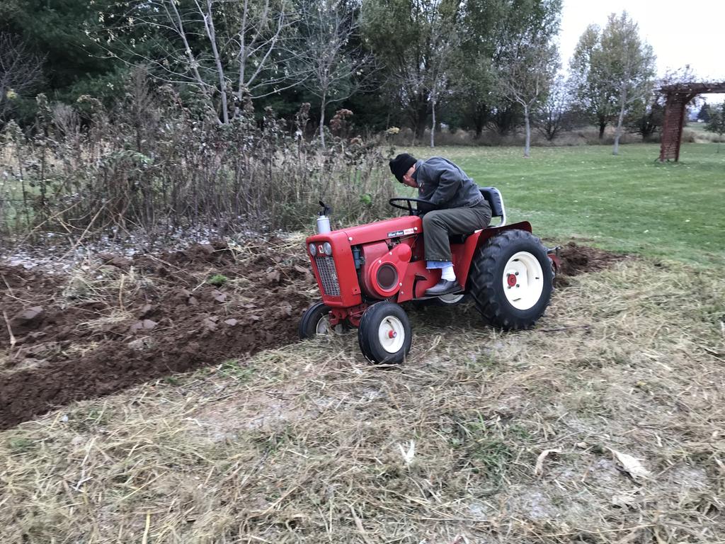

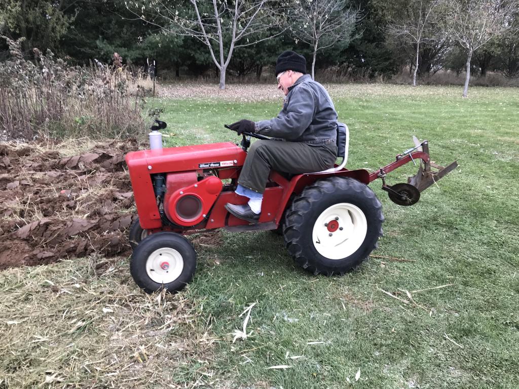

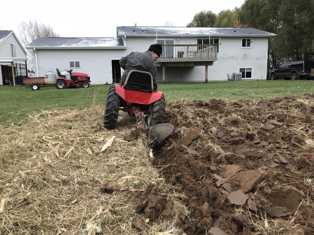

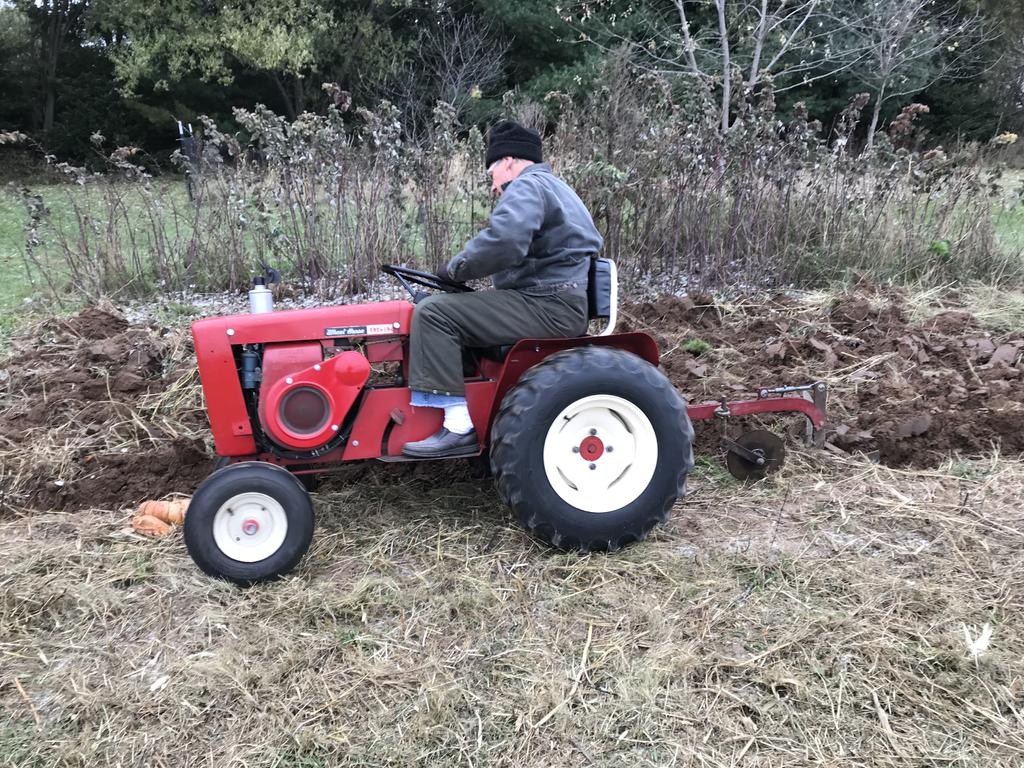

PeacemakerJack 11,096 #61 Posted November 11, 2017 Well—we finally got Clyde to cut a furrow and test it in the soil. we were plowing my garden which is very sandy soil and so it is traditionally easy to plow. However, this week we had several 24 hours periods where the temperature didn’t rise above 32 degrees. So there was about an inch or two of frozen soil on top. The plow just wasn’t sucking in good. If one of us pushed down on it, it was ok but not good. Dad suggested setting the Coulter lower to cut deeper thinking it would help—it didn’t! Dad was enjoying himself anyway! Dad is loving that hydraulic lift! Then uncle Roger showed up. He watched dad make a round and said, “The ground is frozen and that Coulter isn’t allowing the plow to drop in, it is pushing the plow up like a land wheel would do!” So, we pulled the Coulter and voila—it sucked deep and plowed great! 7 3 Share this post Link to post Share on other sites
AMC RULES 37,261 #62 Posted November 11, 2017 Always fun to watch someone who's mastered the process... when they make it look easy. 1 Share this post Link to post Share on other sites
PeacemakerJack 11,096 #63 Posted November 11, 2017 Dad’s been turning soil since he was about 10 years old—that was a long time ago! He has a lot of insights and I’ve been running 10 and 12” Brinly’s for about 6 years and have learned a few things about the little tractors and plows. However, I don’t ever want to stop learning. I love going to the big plow days and seeing what other guys are doing with their rigs. I have a couple more videos uploaded... Here you can see how deep this thing is really plowing. If I was doing this with the GhostRider, he’d be dragging the land side wall with the tranny. Clyde shows air space! I Love dad’s smile! Thank you Tom @Shynon for selling me such a cool tractor which made a great gift for dad! I took several rounds on this tractor and with dad’s new seat, it is a VERY COMFORTABLE tractor to plow on. The engine runs smooth and seems to make good power. The rear end/tranny is pretty noisy. I don’t know if that is typical for the 953 or if this one is on borrowed time. However, I’m glad I was able to truly surprise dad with this tractor after all the wonderful things that he has sacrificially done for me! He’s a GREAT GUY and the best role model that I could ever have. He loves God, loves his wife of 43 years, loves his kids/grandkids, and is an unselfish man. Thank you to my “RS local circle” for helping me make this dream a reality for him! 4 4 Share this post Link to post Share on other sites
