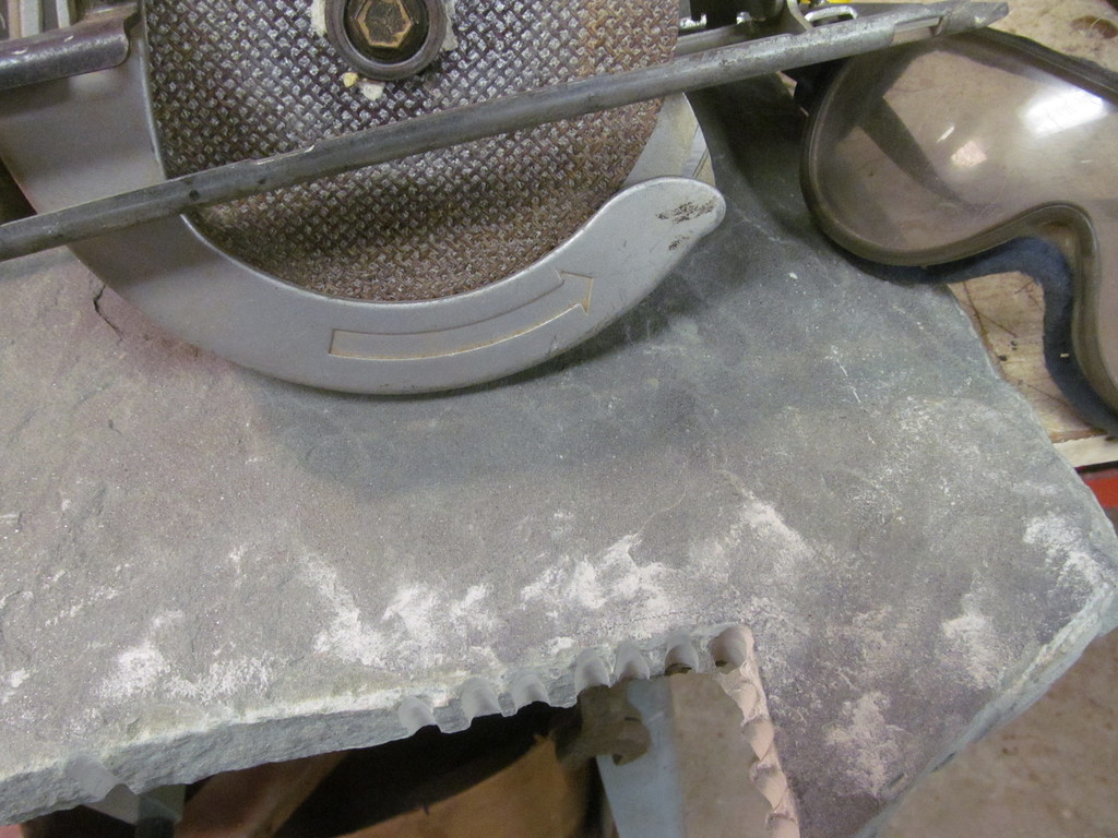

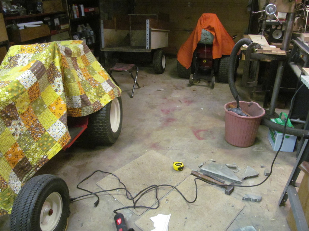

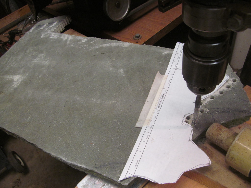

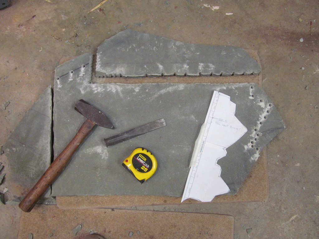

Ed Kennell 47,667 #1 Posted March 31, 2017 I had this piece of slate that I picked up about 3 years ago at the quarry on our camp in Potter Co. I had good intensions of making a Pa shaped stone sign. Well, today was a cold rainy day and both my WH projects in my heated shop were finished, so out came the slate. This was my first attempt at stone cutting and carving so I proceeded with caution and drilled a lot of holes with the masonry bit at the critical locations. Now you geography purists will probably notice ...Philadelphia is missing. I wanted to use as much of the stone as possible, and after stepping a map down to scale to fit the stone, I had to sacrifice a corner. Sorry Philly Fans, but you had to go. I still need to grind the edges, but that is too dust to do inside. Then I could use some advice on the lettering. I could drill a series of dimples, or use the router, but an not sure if a carbide bit would cut the slate or if the dust would kill the router motor. ???? 9 Share this post Link to post Share on other sites
