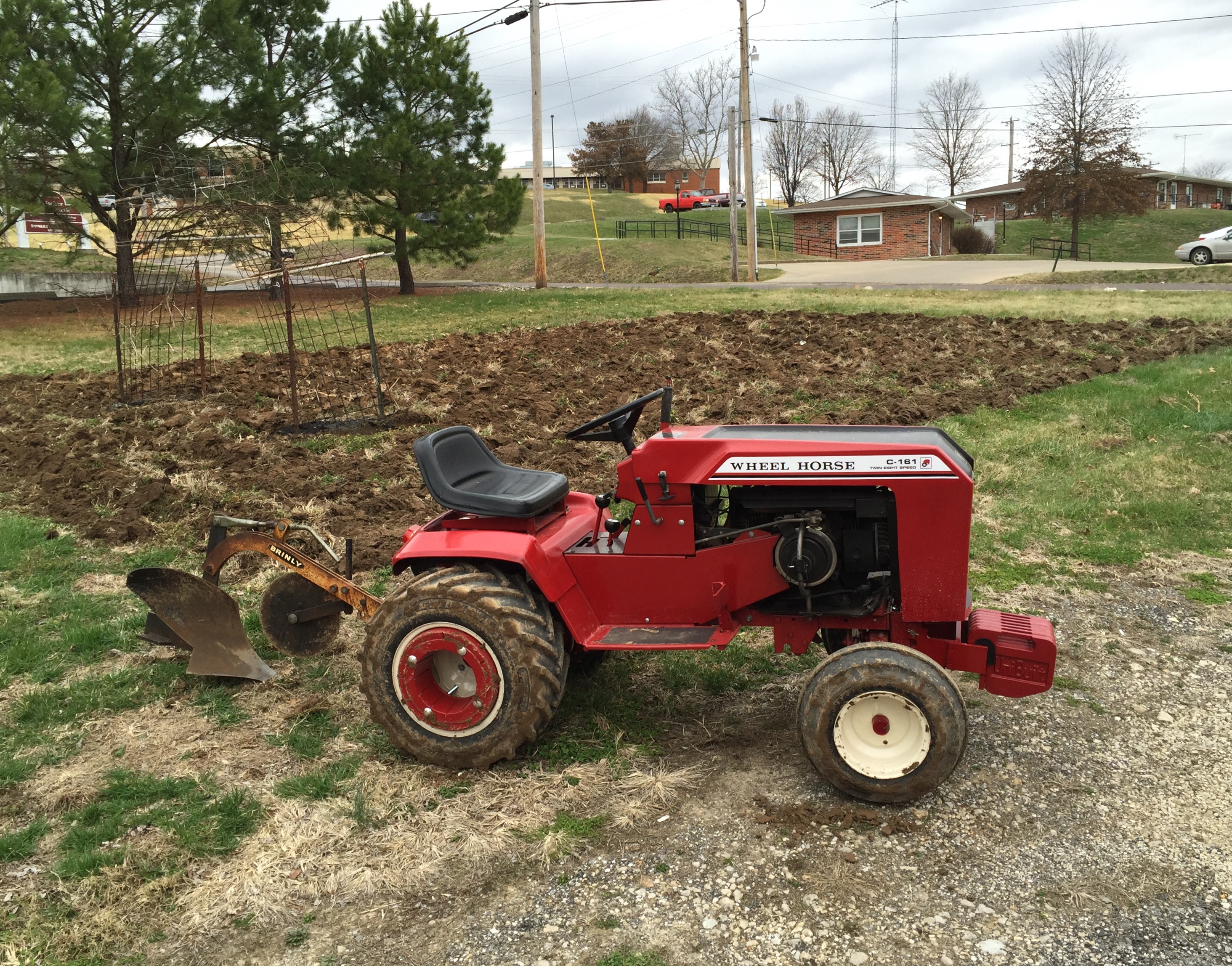

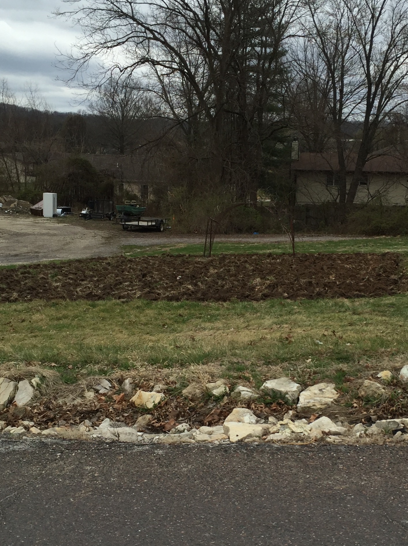

cschannuth 3,821 #1 Posted March 6, 2017 Not really a big deal but I got the plow out and used it on my neighbors garden. It was a lot of fun but I quickly realized that my right tire is too wide for plowing. I can plow about 6 inches deep but the furrow isn't wide enough for my 10.5" true powers to fit into. Consequently my tractor stays fairly level and I don't get the soil to turnover like I would like it to. I may put one of my narrow tires on from another tractor the next time I try to see if that improves anything. 10 Share this post Link to post Share on other sites
WHX?? 57,381 #2 Posted March 6, 2017 Did you try increasing your ground speed or try setting up plow angles different? Looks like it did a fair to middlin job! What kind of hitch are you running? Looks to be a 10 incher? Type of soil? Sorry for all the questions just trying to learn. Signed A Newbie Plower and TP 23-8.50-12 on order. Nothin like a black hood with those weights 2 Share this post Link to post Share on other sites
cschannuth 3,821 #3 Posted March 6, 2017 53 minutes ago, WHX9 said: Did you try increasing your ground speed or try setting up plow angles different? Looks like it did a fair to middlin job! What kind of hitch are you running? Looks to be a 10 incher? Type of soil? Sorry for all the questions just trying to learn. Signed A Newbie Plower and TP 23-8.50-12 on order. Nothin like a black hood with those weights I'm a newbie myself. I was plowing in hi range/2nd gear. I'm not sure how to change the angle. For the depth I put the tractor on a 6" platform and set the plow on the ground that was 6" below so it was level. I'm using a sleeve hitch and it is a 10" plow. The soil is clay but it's an existing garden so it wasn't too tough. 2 Share this post Link to post Share on other sites
WHX?? 57,381 #4 Posted March 6, 2017 Sounds about right from what the masters told me @cschannuth ....6in might be a little much ...I was told 4 with some discretion. High/2nd sounds good. Plow angle is a science in inself and the end matter is that you got good seat time! The Prodinsky clan @Shynonand @prondzy know way much more than I as well as @PeacemakerJack Just glad to see you are givin it a shot! The only thing I really know about GT plowing is is alls good as long as you are having fun! 2 Share this post Link to post Share on other sites

squonk 47,363 #6 Posted March 6, 2017 Even more fun with hyd lift! I run loaded 6-12's on the rear of my 1267 for plowin. along with wheel weights and front suitcase weights. The narrow tires put more weight down in the furrow. Share this post Link to post Share on other sites

cschannuth 3,821 #8 Posted March 6, 2017 5 hours ago, T-Mo said: Craig, We will be trying again to have a plow day event near Marthasville this fall. We had one the end of October last year, and one Wheel Horse made it there. There should be some guys there to help you set up the plow correctly and it's a lot of fun to boot. I look forward to it. I couldn't make it last year. 7 hours ago, squonk said: Even more fun with hyd lift! I run loaded 6-12's on the rear of my 1267 for plowin. along with wheel weights and front suitcase weights. The narrow tires put more weight down in the furrow. I actually have one good 6–12 Ag that's already loaded. The next time I plow I will put that on the right side. It happens to be the same diameter as the larger tires that I have on there now so I think it'll work out fine. My current tires are loaded and I have the heavyweights installed so they are a bear to switch out. Otherwise I would probably try to find another 6–12 and change them both for plowing. Share this post Link to post Share on other sites

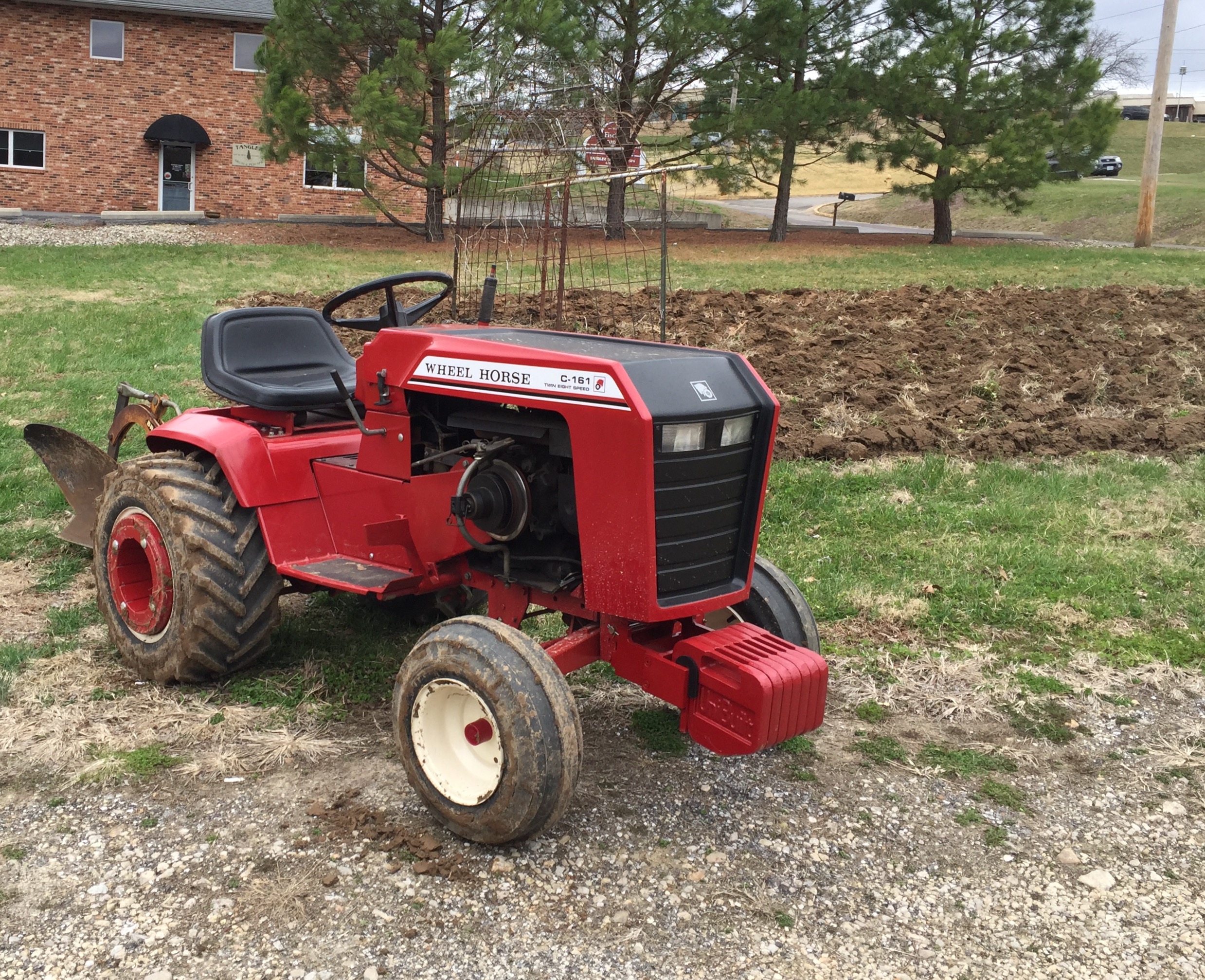

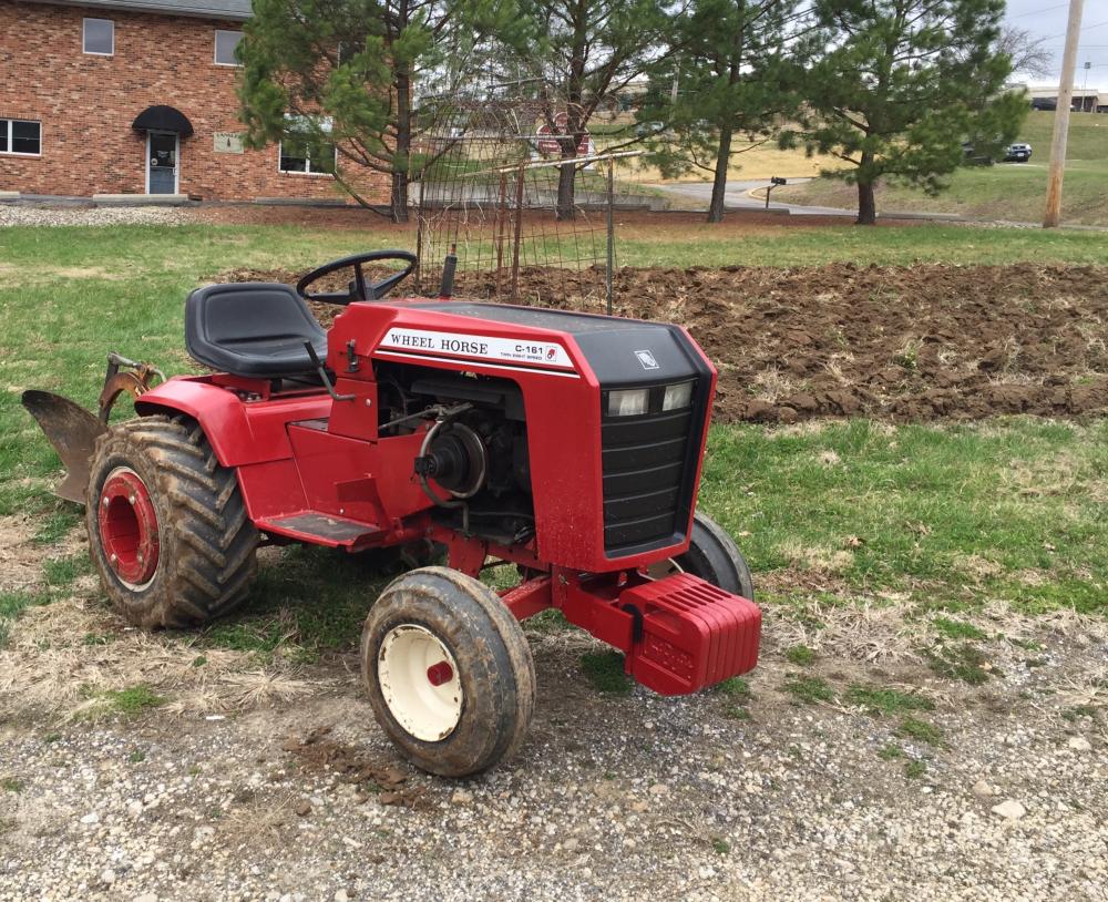

WVHillbilly520H 10,378 #10 Posted March 6, 2017 @cschannuth, those brand suitcase weights look really good on there, did they actually help keep your front end planted while plowing, I know my 120# does decent, Jeff. 1 Share this post Link to post Share on other sites
c-series don 12,108 #11 Posted March 6, 2017 Yes, I'm really diggin those weights! 1 Share this post Link to post Share on other sites

cschannuth 3,821 #13 Posted March 7, 2017 7 hours ago, WVHillbilly520H said: @cschannuth, those brand suitcase weights look really good on there, did they actually help keep your front end planted while plowing, I know my 120# does decent, Jeff. Yeah, it stays planted really well. They are only 10 lbs a piece times 7 plus the weight bracket. I think it helps that the weights are pushed further forward because of the longer nose of the 161 twin. 29 minutes ago, ericj said: i plow with a 520-H with a 12" plow. it does good. i can cover my tire tracks fairly well. I use it at the little guy's show's plowing contest. usually a tractor with a 6" plow wins. go figure lol eric j A 12" plow would be better for the 10.5" rears I have but the 10" plow is all I have. It's fun to play around with this stuff. 7 hours ago, c-series don said: Yes, I'm really diggin those weights! Thanks. I like them because they are easy to handle because of their small size. Share this post Link to post Share on other sites
squonk 47,363 #14 Posted March 7, 2017 Bigger isn't always better. I tried a 10" in a 73 12. Had to back up to lift the plow. PITA and hurt my back too. Plus it's harder on the lift equipment. I run an 8" now and it's well balanced and lifts easily. 1 Share this post Link to post Share on other sites
Brian33 4 #15 Posted January 16, 2019 Great looking tractor! What kind/size tires do you have on the front Share this post Link to post Share on other sites
