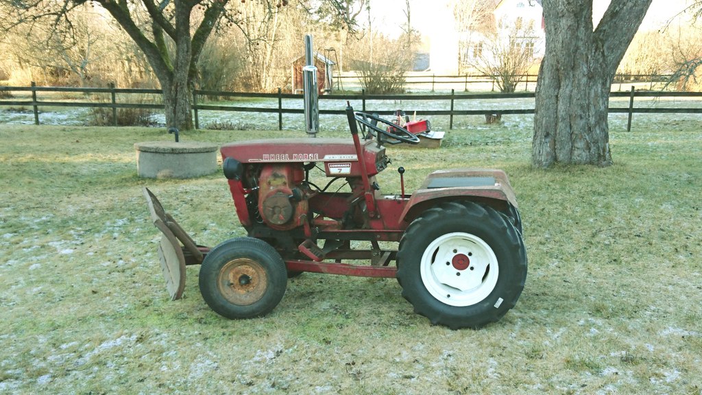

She is a pretty little thing , welcome to to the party

Yes, She does look proud of her new rear and shiny stack.    :text-welcomeconfetti:

Welcome Johan!.  A great 'Little Giant' you have there. Enjoy the project and look forward to seeing your progress.

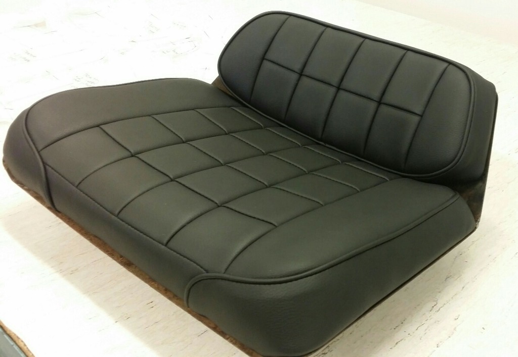

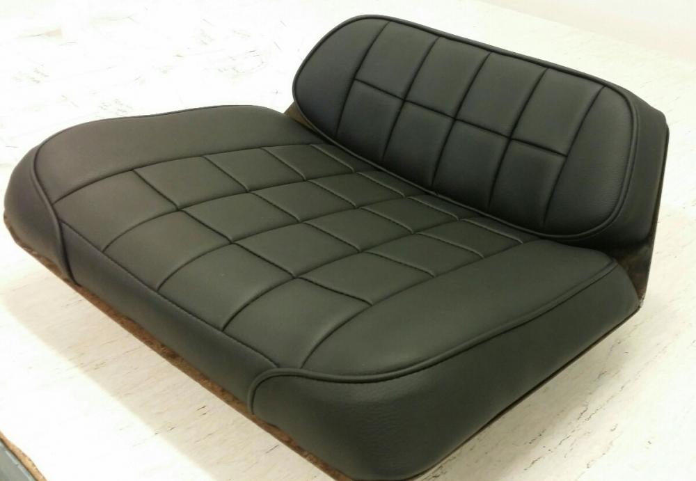

My upholsterer gave me a sneak preview today, I now waiting for the delivery...

Looks good, and expensive.  :handgestures-thumbsup:
neil
Quality made seat , I wonder if they could do them in leather
isak_svart
Thank you all for the warm welcome greetings!
Neil, I asked my upholsterer about doing the same work in leather, but they said they would not recommend it mainly because of the risk of exposure to water, and also, it would be more expensive.
Currently I preparing the seat pan for paint, it will be done in a wrinkle black finish.

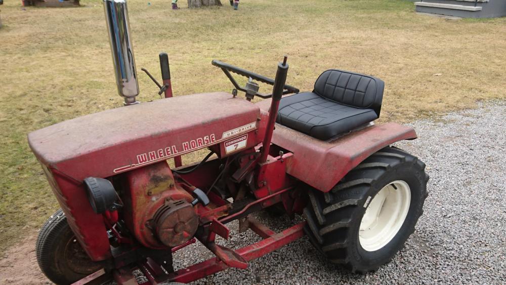

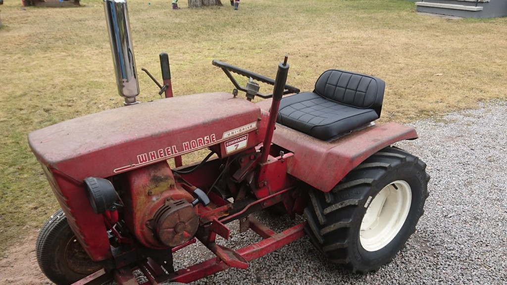

Seat is finally back in place. Onto next project...

Looks great.

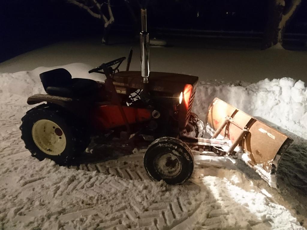

Last week we had some snow, the old commando had to fight a bit, I think I found the limit for what can be accomplished without wheel weights... I'm glad i did the starter/generator last year, I never became friend with the pullstart.

You could gain several pounds very inexpensively by filling your tires with Recreational Vehicle Antifreeze or other liquid that will not freeze.
SIZE                 GALLONS Per Tire                WEIGHT in POUNDS
  • 16x6.50-8               2.0                            21.4
  • 18x7.00-8               3.0                            32.1
  • 18x8.50-8               3.4                            36.4
  • 18x9.50-8               4.0                            42.8
  • 23x8.50-12             5.5                            58.9
  • 23x10.50-12           6.8                            72.8
  • 6-12                        3.6                            38.5
isak_svart
Thank you. Do the table values correspond to a 100% fill ratio? ...or do you have to leave some air for the comfort?
  • Thanks 1
953 nut
There needs to be some air in the tire. With the valve stem at the top of the wheel, the ones I have filled have a liquid level all the way up to the valve, then the air is added primarily to keep the tire seated firmly on the rim. Tire dealers who work on industrial or agricultural vehicles can probably do the job for you.
