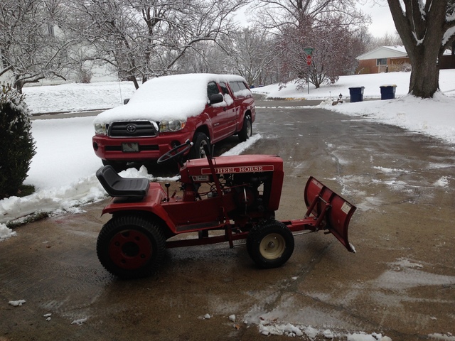

I'm a little late to the party, but I've had my WH out in it 3 of the last 5 days.  Admittedly the first day was really just playing around but Saturday, Sunday, and yesterday were to do real work.  This is my first year with a blower.   I love it.  It worked great on the powered stuff we got last week and then yesterday it did a fine job throwing much wetter stuff.  Looks like we're getting more as I type so I might have cause to get her out again tomorrow.  Seeing those cabs makes me very jealous.  I've got a 700' drive where the wind dependably blows from the house toward the road.  I can get 1/2 way down the drive in either direction, but the more exposed half (closer to the house) seems to give me a face full every time I try to blow snow as I approach the house.  I'm too stubborn to just drive back to the house with the blower off so I get one of those ice-cream headaches every time I crest the small hill approaching the house....
Here's a not great photo clearing out in front of the neighbor's mailbox.

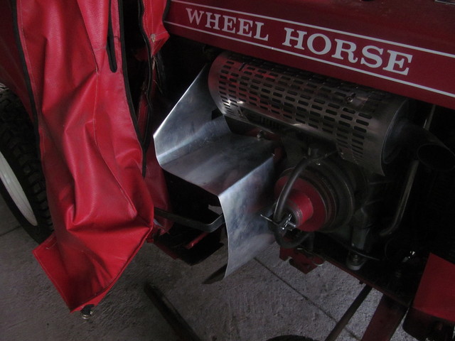

Here's my heat houser design.   Just captures the rear cylinder heat which is quite a lot on the Onan.  Had to modify the canvas and add grommets to attach to the metal houser.
  I keep the cab zipper open at the rear for good air flow. The cab stays 35-40 F warmer than outside temp and the windows do not fog.
I use aluminum flashing to make patterns, then transfer it to 1/32 or 1/16 steel.

Nice idea , I'll keep that in mind if I ever go with a cab which is getting more likely all the time .

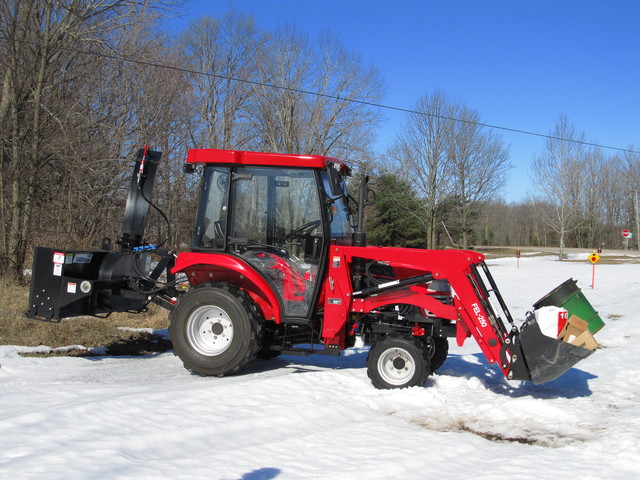

Even my diesel tractor with the factory cab with a conventional coolant heater only has some heat.
Enough to keep the windshield clear but not really the rest of the windows.
Diesel engine just does not get very hot, even when working it to blow snow.
But, keeping out of the elements is the main thing. I still wear a jacket in the cab but can take my mitts and hat off.
Once or twice I may need to get out and clear the back window if snow is blowing onto it (still beats getting that snow in the face).

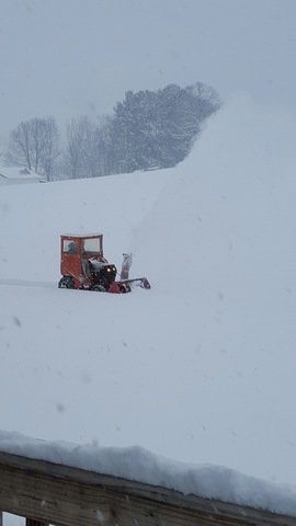

Let me add a little video of January,...can't get them to rotate but you kinda get the idea why it's so much better with than without a cab blowing snow,Jeff.

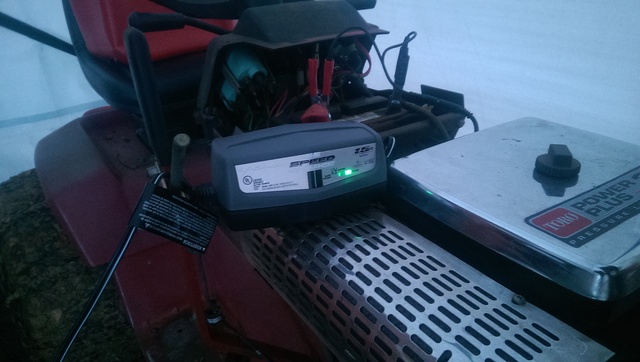

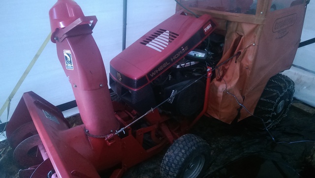

Another tip for the cold weather even if your rig is in a climate controlled shed/garage, use a battery maintainer is really helps out on those sub freezing days and keeps it healthy longer, I'm a firm believer in them,Jeff.

@cleat you may already know this, but what is your engine temp at when your pushing it hard . If it's not running up to your normal operating summer temp try blocking your grill to allow your temp to come up , especially on very cold windy days . Just keep a eye on that temp gauge . We do this on our 130HP AC with 8' plow on the farm .
  • Like 2
cleat
I have thought about that.
Tractor has a screen in front of the rad that lifts out.
I could make up a plate of some sort and slide it into the screen tracks.
Even in the summer when bush hogging or wood chipping the engine never goes over 60 C (140 F).
In winter the gauge never moves off the bottom unless blowing heavy snow for some time.
Thermostat was replaced and tested in hot water. Everything seems fine, this engine just cools too well I guess.

Doesn't have to be fancy.  On my DC3 I slide a piece of cardboard in behind the grill up against the radiator.. Farmall M gets a feed sack wrapped around the grill held by 2bungie cords
