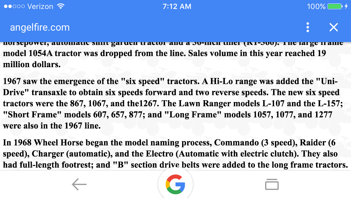

Al C. 1,429 #3 Posted June 30, 2016 Al C. 373 Supporter 127 posts ID: 1 Posted October 2, 2015 · Does anyone know the difference between "long frame" and "short frame" Wheel Horses? If so, is the 1067 a long or short frame? Quote DennisThornton 860 Supporter 1,158 posts ID: 2 Posted October 2, 2015 · From my notes gathered from folks who know! Long frames 45.5" Short frames 41.25" Mid Frames 43" 1972 to 1975 Wheel Horse 8 horse powered models had a wheel base of 43 inches "A short frame will have a wheel base of 41-1/4 inches and a long frame has a wheel base of 45-1/2 inches. The 1972 to 1975 Wheel Horse 8 horse powered models had a wheel base of 43 inches but the C-series and 300 series 8 hp models were long frames . Another way to tell is by horse power , any Wheel Horse model with 10 hp or more has a long frame starting from the 1966 model 1056 . In 1969 the last short frame model was built , the Workhorse 700 had a 7 hp horziontal shaft Tecumseh engine and three speed transmission . Any old round hood will be a short frame and all but one six speed model was a long frame (the 1967 model 867 was a short frame)" The first long framed Wheel Horse models came out in 1966. Here is a list of short frame Wheel Horses. 1961 - 701 1962 - 502, 552, 702, Lawn Ranger 1963 - 603, 633, 653, 753, Lawn Ranger 1964 - 604, 654, 704, 754, 854, 1045, Lawn Ranger 1965 - 605, 655, 855, 875, 1075, 1055, Lawn Ranger 1966 - 606, 656, 856, 876, Lawn Ranger 1967 - 607, 657, 857, 867, Lawn Ranger 1968 - Commando 6, Commando 8, '500' SPECIAL, Lawn Ranger 1969 - WORKHORSE 700 Other tractors like the 1974 and 1975 model B-80 were considered a mid frame. KC9KAS, Thor27, TDF5G and 4 others like this Like this Quote RedRanger 1,089 Supporter 1,034 posts ID: 3 Posted October 2, 2015 · I assume the purpose of long frames was to move the weight balance further forward and to allow for larger mowing decks???? The larger big block engines probably need a bit more space as well. Just my guess. Ed Kennell likes this Like this Quote WHX7 2,270 Supporter 1,663 posts ID: 4 Posted October 2, 2015 · and to move the heat a little farther away from the family jewels..... elcamino/wheelhorse likes this Like this Quote 3 Share this post Link to post Share on other sites
Indiana_Steve 125 #4 Posted June 30, 2016 Thanks for the info dennis.... by measurement my 953 is a long frame although by HP standards I come up a little short.. 9.6. Steve.... I don't know if I would call it madness but you all are a little crazy. Glad to have such knowledge available. I live about 40 minutes from where the red horse was made. 1 Share this post Link to post Share on other sites
