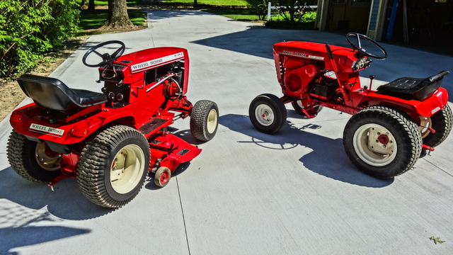

Al C. 1,480 #1 Posted October 2, 2015 Does anyone know the difference between "long frame" and "short frame" Wheel Horses? If so, is the 1067 a long or short frame? Share this post Link to post Share on other sites

WHX?? 58,307 #8 Posted October 3, 2015 @Al C.Love that 1067 Al, looks much better than mine but someday I am going to make mine look like yours. If you don't mind I will be needing lots of pics to see what I am missing and how it is supposed to look! 2 Share this post Link to post Share on other sites
Al C. 1,480 #9 Posted October 3, 2015 I'll be glad to help with your restoration. I have all the manuals and parts lists for both models. Pics are easy. Good luck! 2 Share this post Link to post Share on other sites

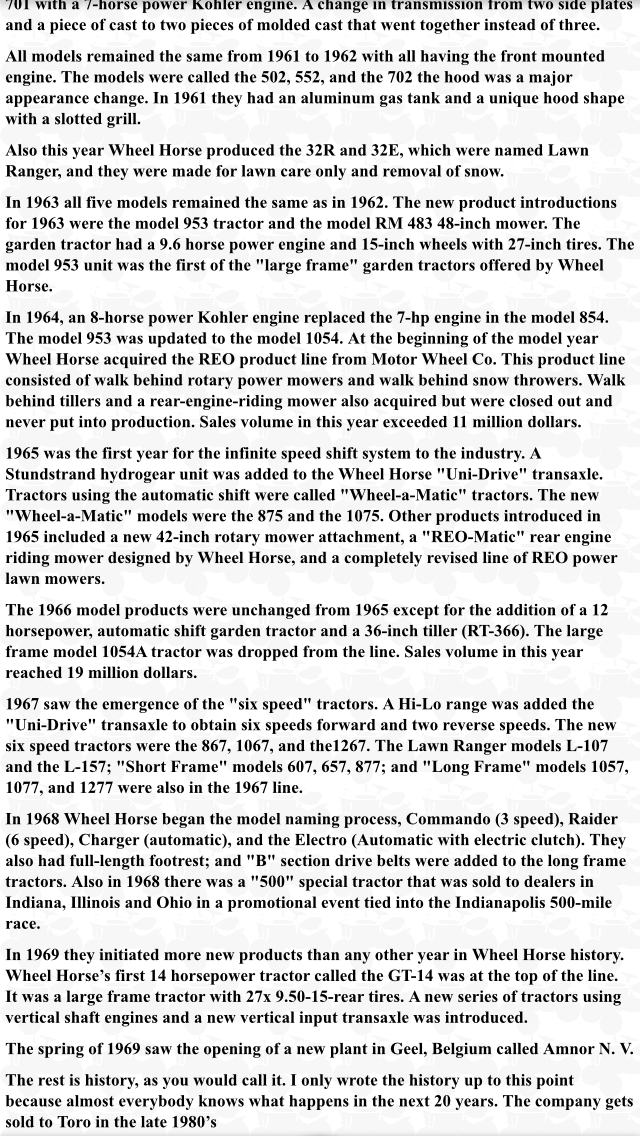

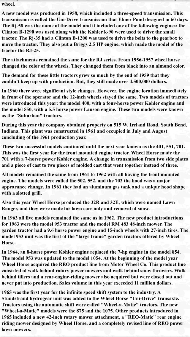

953 nut 69,837 #10 Posted October 3, 2015 Al, Is the document in post # 1 a part of our downloads? I would be interested in reading more of it. Share this post Link to post Share on other sites
KC9KAS 4,746 #11 Posted October 3, 2015 @Al C. you have a couple of nice looking Wheel Horse tractors. 1 Share this post Link to post Share on other sites
Al C. 1,480 #12 Posted October 4, 2015 Here is the complete document from post#1. Not sure if it is in the download library. 2 Share this post Link to post Share on other sites
WHX?? 58,307 #13 Posted October 4, 2015 (edited) Cool Al....Thanks ....if it's not there is should be. .. Edited October 4, 2015 by WHX5 Share this post Link to post Share on other sites
