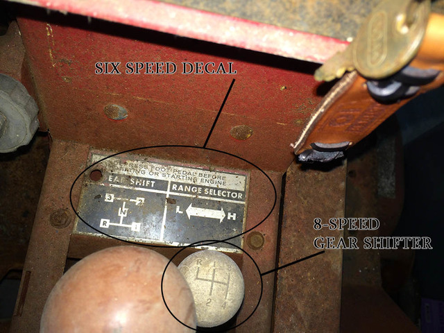

I just noticed this...  Six speed pattern decal but an 8 speed pattern on the shifter knob.  I'm going to go check that out in a second to see which it is.  I'd say maybe the parts were swapped into a 1973 Raider 10 frame?  But the ID tag is riveted in there.  What do  you guys think?

that hi low shifter isnt wheel horse, 6 and 8 speed are the same, somewhere in time they started counting the reverse gears too which makes a 6 an 8

Gotcha... I just went back and looked at it and realized it was the Hi-Low lever... Lol... Should've looked closer at my picture.  So do you think maybe just the hood was swapped or something?  But then they would've also had to swap the gas tank support...

:WRS:     The shift knob is from a 4 speed car or truck. Most '73s were referred to as "nonames", hard to say what has been changed around by previous owners.

The visual difference, on the out side, of the 6 and 8 speed transmissions is which shaft the brake drum is on.  If the brake drum is on the hole closest to the axle housing (the 11/44 toothed gear), it is a 6 speed.  If the brake drum is on the shaft coming out the next hole toward the front of the transmission, (the cluster gear shaft), it is an 8 speed.  They both shift the same...3 gears forward, 1 reverse, and the hi/low separate shifter.  :)
    OK, now if it is the 6 speed, it is either a 68 or 69 and has the 10 pinion, limited slip transmission.  WH #5060 or #5071.
    If it is an 8 speed and 1.  the axles are 1"...it is a 1972 with a 4 pinion differential.  WH #5086
                                         2.  the axles are 1 1/8"...it is a 1970/1971/1972 with the 10 pinion limited slip differential.  WH #5073
